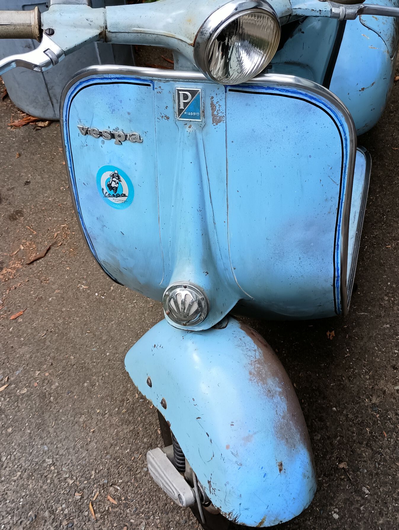

Thanks to bernietime, a P200E is now in my care! It runs strong, but is definitely a project. I'll be posting here with questions, etc. during the process.
The title has it an a 1980, but the dates on the data stickers show it was mfg in 1979. What parts can I look at to know which version I'm dealing with? Ignition switch? Carb?
Also, is there an ideal order of operations when restoring? I do want to get it fully re-painted, does it make sense to do that first? Any ideas on where to start would be greatly appreciated.
Thanks in advance for all your help! Looking forward to this journey!

Congrats!! P2's are great first scoots!!
I would advise to get it running reliably and ride it for 1 year atleast. Tires, brakes, spark plug, maybe clutch plates,
maybe battery, maybe carb clean and rebuild. All done in a weekend, then enjoy!
Enjoy it on the road while the weather is good. Before doing any major work like paint, which is a very long involved process. Break it down in winter if you want
If the factory sticker says 79, its a 79. Typical to have a dmv registration a year or so after mfc date.

do not, I repeat, do not take it apart to restore it, or paint it.
do minor repairs and just make work and be safe and reliable and ride it thru the summer and into fall. in winter when the weather gets crappy undertake some of the bigger projects it may need, say an engine rebuild or refresh or maybe a wiring harness or something. but a project that can be completed in a few months.
then ride it all next spring and summer and thru the fall. then when the weather gets junk again, that's when you decide if you want to pull it all apart and paint it.
I always advise to ride something for at least a year before restoring or a paint job. otherwise it seems as though every body falls into the vortex of it taking way longer, being way more expensive and/or difficult, losing motivation because they never really rode and enjoyed the bike and then either the project gets back burnered or abandoned all together.
never go full exploded view from the jump. unless you already have another bike to ride while that one is in pieces!

Is there anything I should/can do to clean up what is left of the paint for the time being? Also, anything to do about the surface rust?
I just went over my scruffy AllState that has mostly original paint and I tried a new technique I picked up on YouTube from that nutty guy on Vice Grip Garage. I used fine steel wool all over and Ospho on the surface rust before applying the linseed oil.
Another thing I might try is spraying matte clearcoat on the shiny chrome cowls & horncast, but that's just me...Who knows, you may come to like it as is? I do like the shark detail regardless.
So easy and the original paint now gleams so nicely.                            I modified my license plate bracket to show off lovely 1958 style round tail fanny!
Works well on the original paint like the mudguard & headset, but where I welded the legshield and touched up w/ 3 different shades of rattle can blue it really does nothing to help.

Just curious but why did you want to paint your scoot? Do you want it a different color and if so, what color were you thinking? The other reason being did you want a super shiny new paint job or to have a smooth body and no rust? I will say that restoring a scoot with a new paint job is time consuming to say the least! Either way I'm glad you got a scoot!

I'd rock all those stickers on there, I wanted to buy it just for the shark mouth, but the bee with a bomb - superb.

ride imo. Sound info about enjoying it the way it is: That ´patina` is priceless.
Just keep it in good running order.
That nice rear light btw was very soon after replaced by a massive red thing hugging the rear.

I'm not looking to paint the scooter now, it will happen eventually. I've never been in to the rat rod look so much, but the paint/restoration is de-prioritized for the next few years. I do want to clean it up and get the patina shining as much as I can as well as prevent any further rust development and damage from happening.

I get it, but it's not my style. I'll add some different stickers and such after I get it cleaned up so it has some personality!

That sounds like a good plan. You would be surprised how good you could get the paint with cleaning, buffing and touching up. A lot of surface rust on paint can also be removed.

I feel like this original paint would look great with just a clean, buff, and a few coats of good wax. Maybe skip the oil and other coatings
