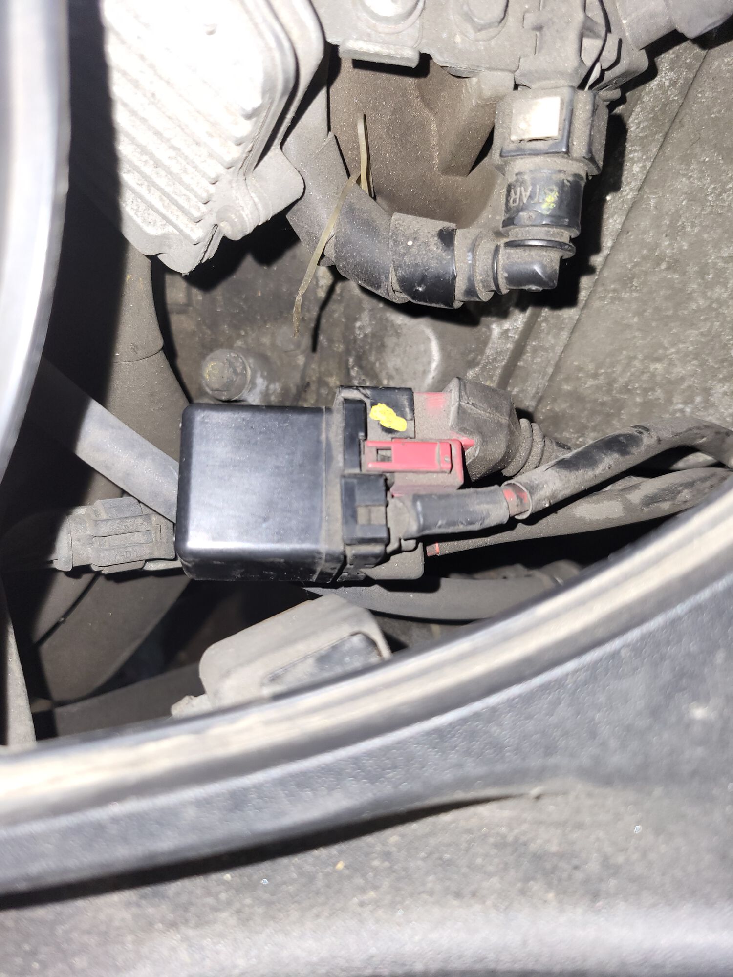

The brakes do not come on when pressed, I think your right about the starter relay. Just double checking, is the relay under the seat on the right side? Also, any leads on where to find a new one?
