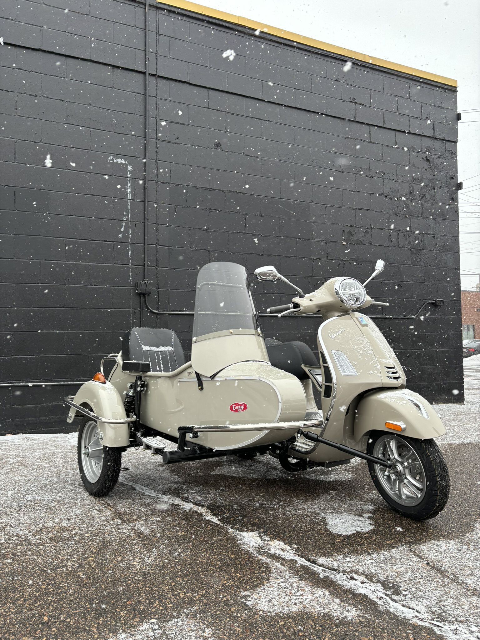

Scooterville Minnesota has them in development and are taking preorders for upcoming shipment of sidecars. Available for the GTS300 and Primavera 150, in red, white, black, or Verde Amiable

This sounds interesting and worth following. Especially interesting that they have sorted out a proprietary steering damper.

I don't like the way that front strut connects to the front wheel. It looks pretty wonk-able (Is that a word?) to me.
C125 Cub, Vespa GTS, Helix
Posts: 7
Location: Shenandoah Valley, VA USA
Posts: 7
That's probably just a steering damper vs wobble/shimmy, which sidecar rigs are otherwise prone to.

Upon closer inspection, I would agree with you. But, I still think it's pretty wonky.

Yes, it's a steering dampener- we designed it for Stella/P Sidecars years ago and it works quite well. It was difficult to manage the steep angles and retain full steering, but the heim joints take care of that and are very robust. Hence the wonky look. Effect is slightly heavier steering at 0-5mph but with zero shimmy at speed. Adapting to the hub was a fun trick too.

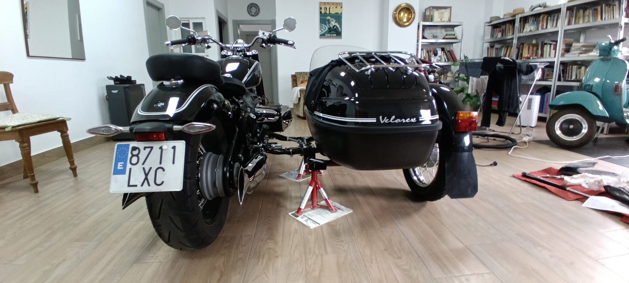

In general yes. On a traditional motorcycle rig it is essential and the experience based rule is that it should be on or as close as possible to the steering head.
Currently in the process of building a BMW R18 rig myself and have an hydraulic one under the bottom yoke. It makes NO noticeable difference in steering.
For scooters ... doubt it is needed.
Over here, AndalucĂ­a, Spain, the Vespa with sidecar is not uncommon. Never seen one with steering damper.
The one I drove was a 150cl with Inder and no shimmy whatsoever.
There are several about on 'new'250-300 GTV's and none has a steering damper.
