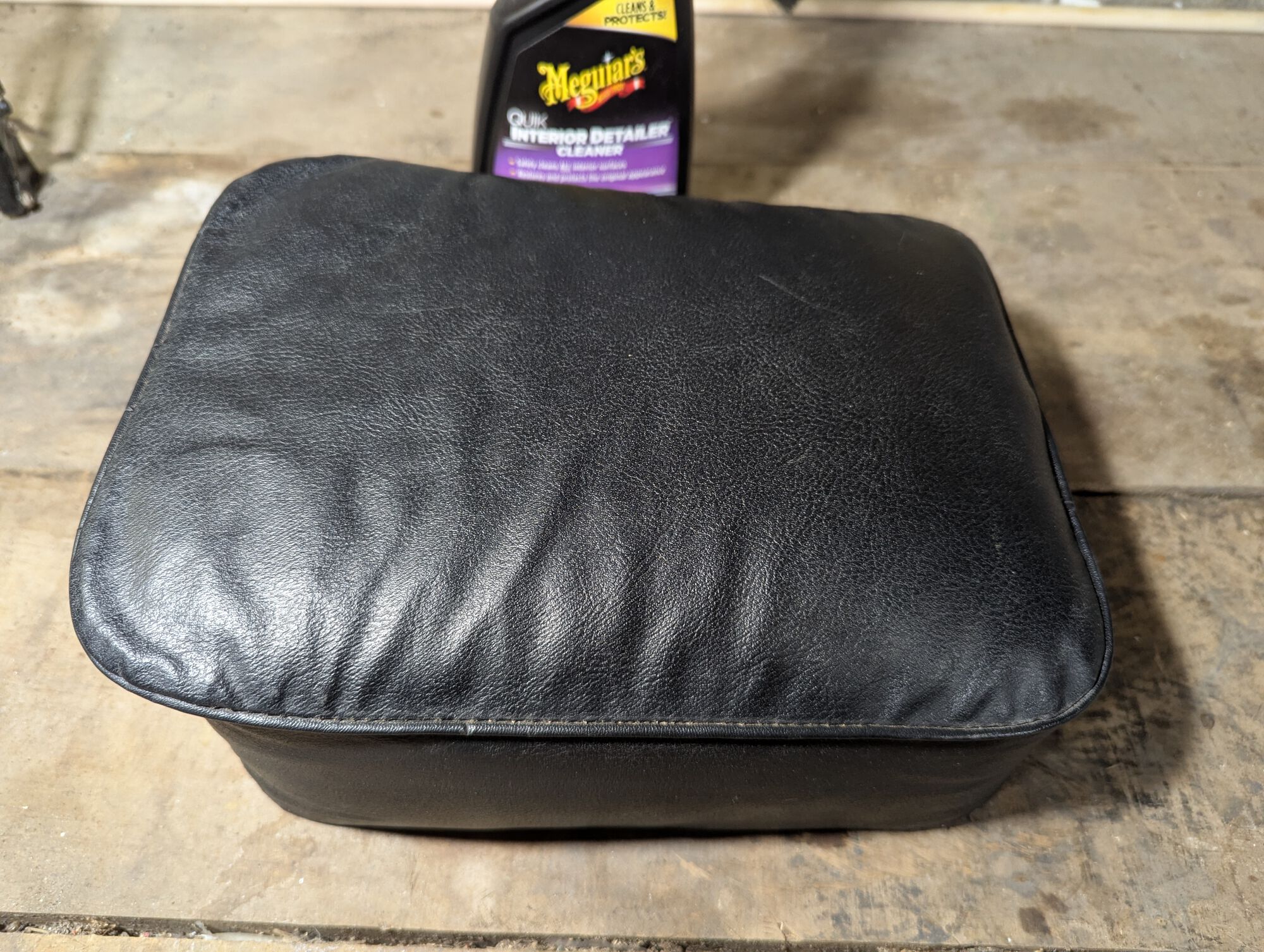

While I clean this thing, that buddy seat, should I pop the staples and put some new foam in there or leave it?

The rear seat pad, looks like it started life as 3" thick and is now ~ 2 1/2" thick. The vinyl is in good shape, do I carefully remove some staples and add a new cushion? Leave it in the simple solution but not much cushion left if my brother wants to take his grandkids for rides.
I want the scoot to look good and be original as possible. Any opinions?

yeah that's easy peasy, remove the staples, pad to your heart's desire, restaple, done.

+1. Find some firm upholstery foam and go to town...

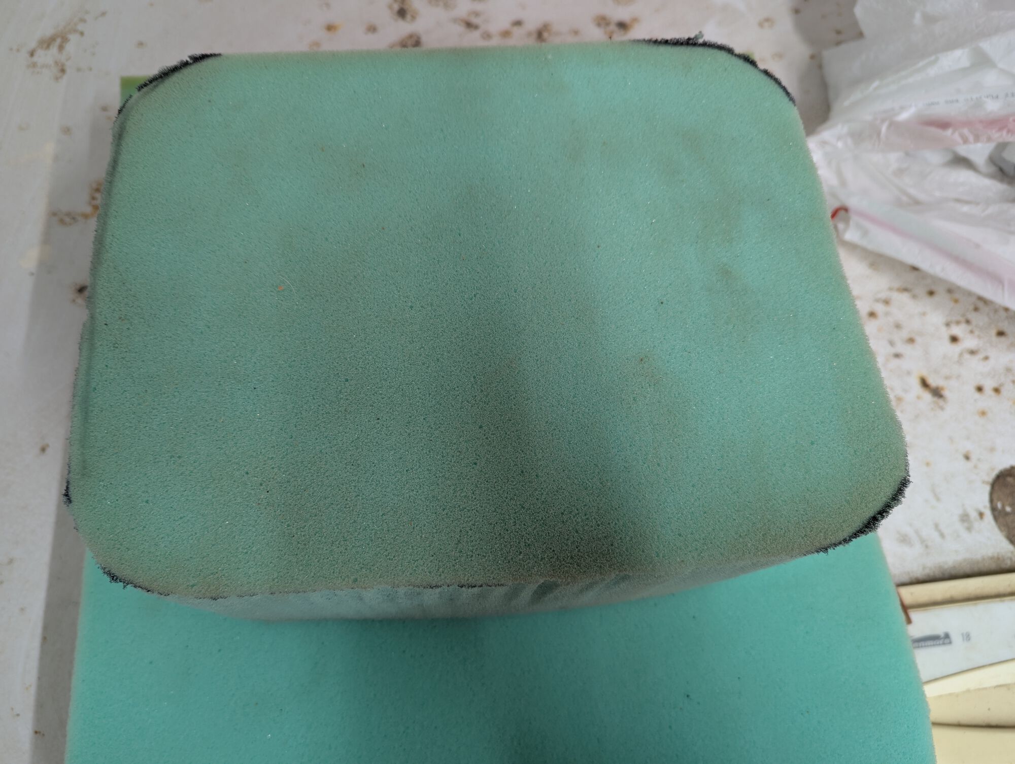

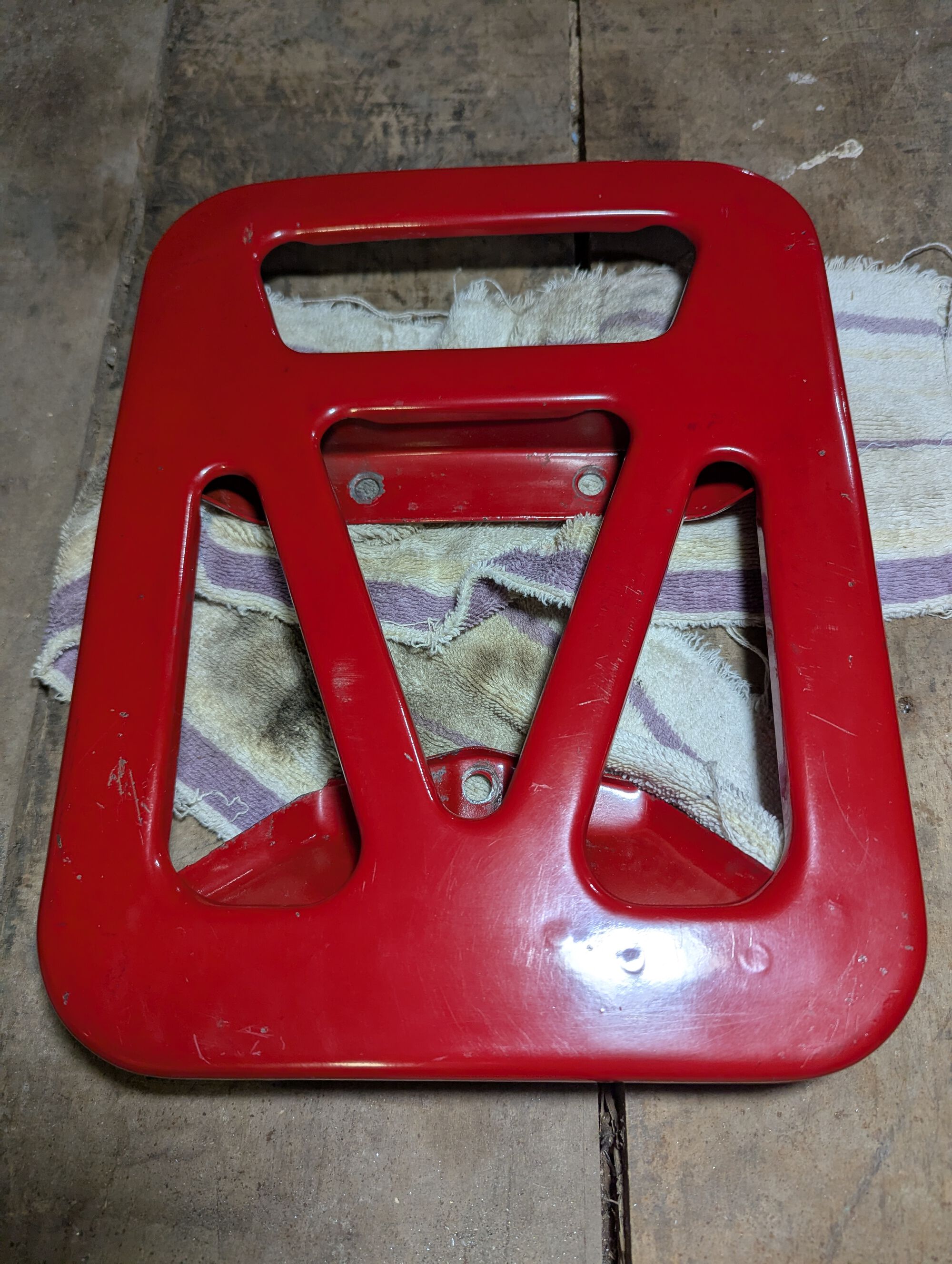

Cleaned up the buddy seat. Didn't realize it has a slight taper (2 3/4"-4" if anyone wants to make perfect) until I tacked the back of the cover down. Much like many of my other projects, "is it better than I found it?", if yes then good to go. If no, try again or call in a pro. I am placing this in the good to go category. Someday it will spend time in the warm sunshine.
Kind of squishy 4" foam, a little refined on my belt sander.

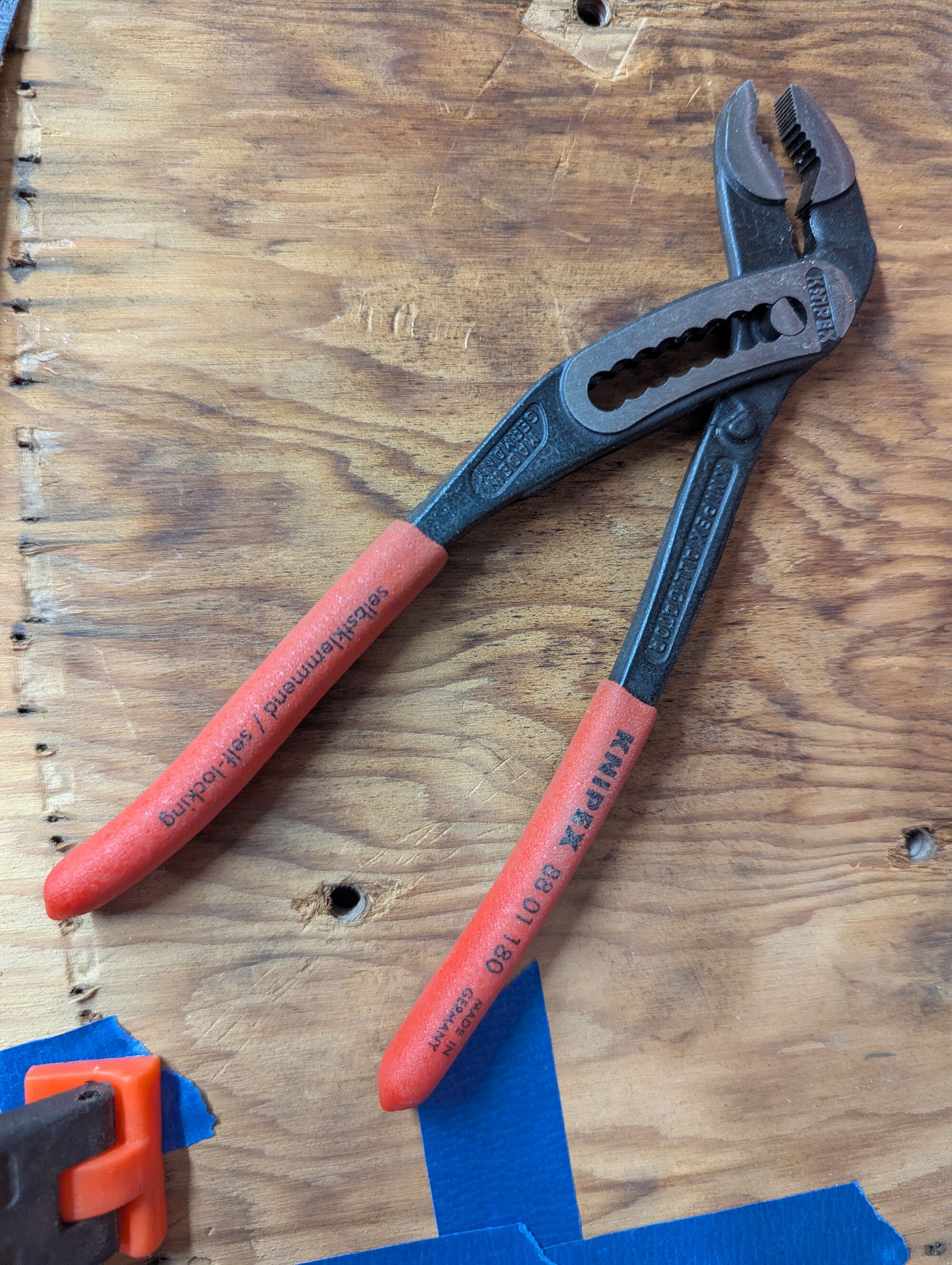

New Knipex 7" slip joint pliers, yes they are all they are cracked up to be

Padding sits a bit high but it will suit its purpose.
