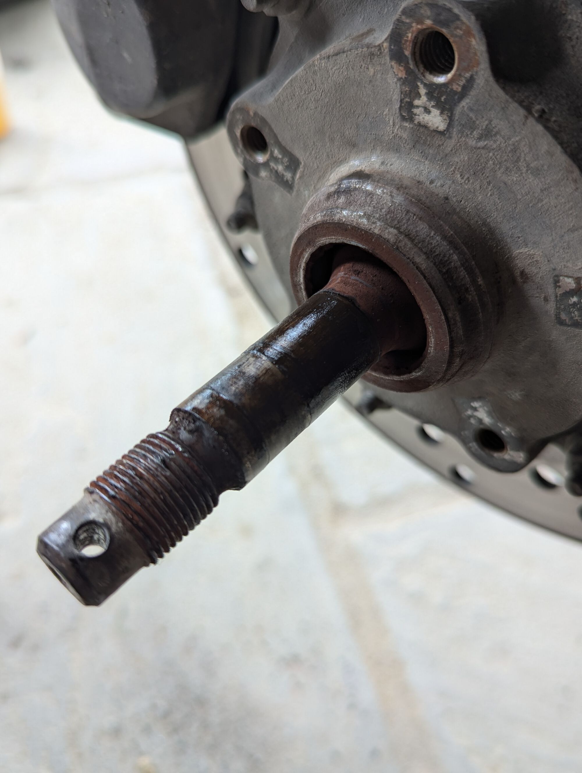

I reopen this post because I found the problem on the vespa and now it starts again. An electric cable was worn out so I had to fix it.
I removed the exhaust and the tire, but found nothing suspicious except for rust and a slight dent made by the baring on the main tyre axe. As you suggested the bearing is running fine and looks fine except for some dust.
In the last days there was an unhealthy intermittent sound coming from the rear that was getting worse and worse, even when just moving the tyre while on the central stand.
Here a few photos. I put a very little amount of grease on these parts to check whether the noise is coming from here, I put everything back together and yesterday I got no noise, but in my opinion it will come back. This does not explain why sometimes I have to tighten the bolt 😭
Here you can see the dent I am talking about

Is the guard still wonky or did you work that out?
And how have you been tightening the nut? And what torque?

I checked all three bolts of the guard but they are all tightand there is no actual wobbling where it is secured. It really seems like that in ten years of use the heat from the exhaust has bent the plastic on the right side so that it touches the tyre when setting a higher level on the two absorbers.
I admit that during my recent trip I was just tighten it with pliers and with no known torque hen the tyre started to wobble.

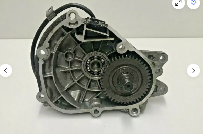

Did you take the hub off the axle when you had it apart? That you had to tighten it repeatedly suggests damage to splines either on the hub or axle or both.
Also was there any play other than rotational with the axle? There are 2 bearings on the other end of the axle in the final drive, any lateral movement of the axle would indicate a problem with these.
Posts: 14
Posts: 14
hi and thanks for your message! I don't quite understand what you are asking, you mean opening the part where the axle ends? isn't that section full with oil? (attachment)
Holding the axle and trying to move it did nothing so i think there is no problem related to it. Now it's only two days, i will ride a bit more in the coming days to see if it does it again and i will post a video.
This pic. Did you take the hub off the axle? If nut wasn't torqued correctly last time it was apart the hub being loose on the axle will damage the splines. Damaged splines lead to your symptoms, wheel wobble and won't stay tight.
Ahhh understand, sorry my technical English is not so good . You mean the hub that has to be removed when changing the brake disk. No I did not take that off, if i hear the sound again i will do it and take a look at the splines.
