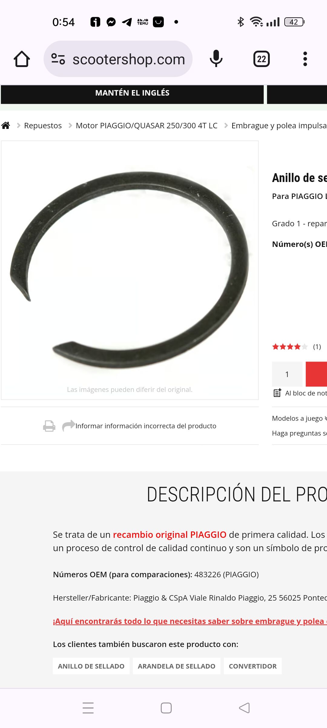

I continue looking for the noise of the vespa 250 gtv
brake pads were not the problem
I have reached the clutch pulley.
Bearing clutch ,(17x30x7) dont work fine!!
How can I remove this ring to extracto the bearing?
2 flat screwdrivers, but how?
Thanks

How to remove this ring to remove the bearing?
Posts: 8649
Posts: 8649

Perfect! Ring out!
