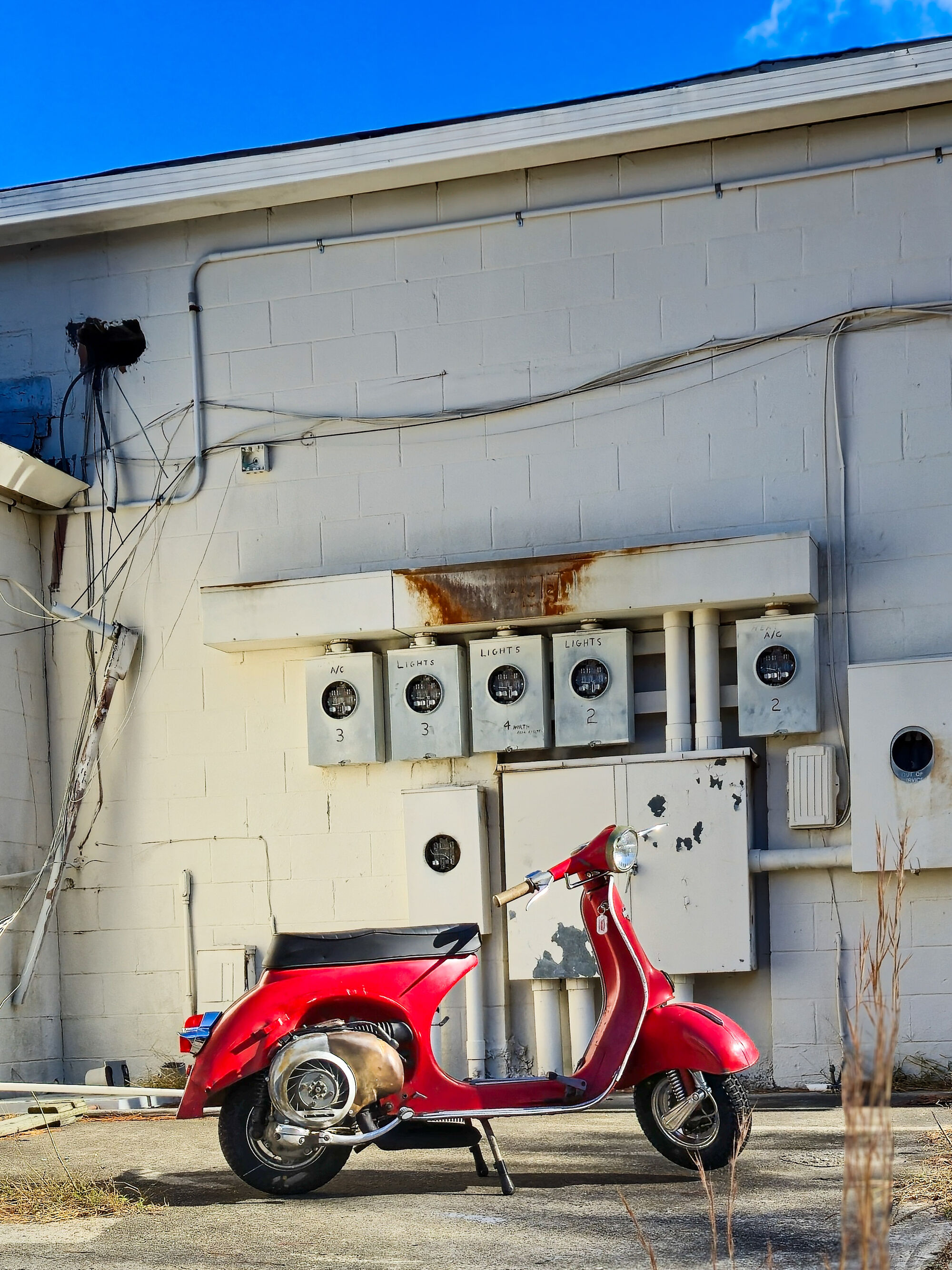

Hello. New to scooters and this sub. Just picked up a local to me one owner 63 Piaggio VNB Allstate this Monday. Very excited to dig into it. Already done a lot and still needs a lot.
Making this post to keep a record of it but also share with the community.
Will be updating soon with pics of what I've already been doing.

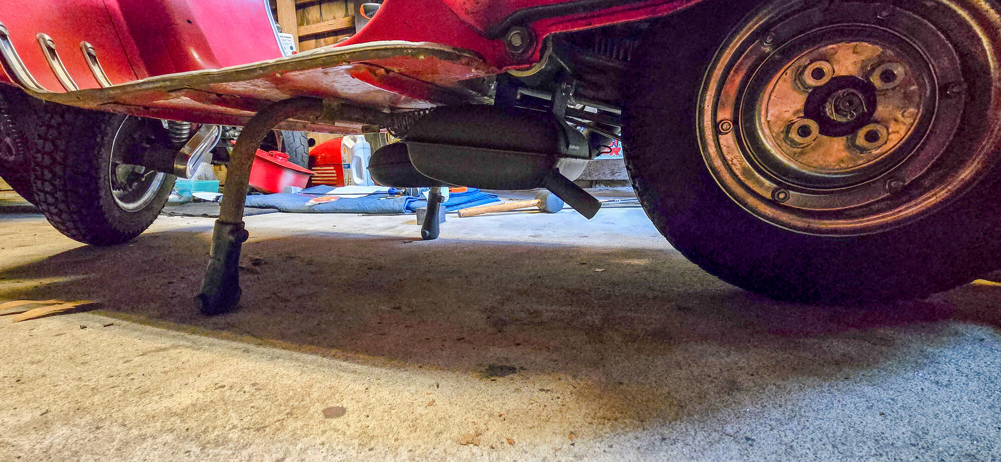

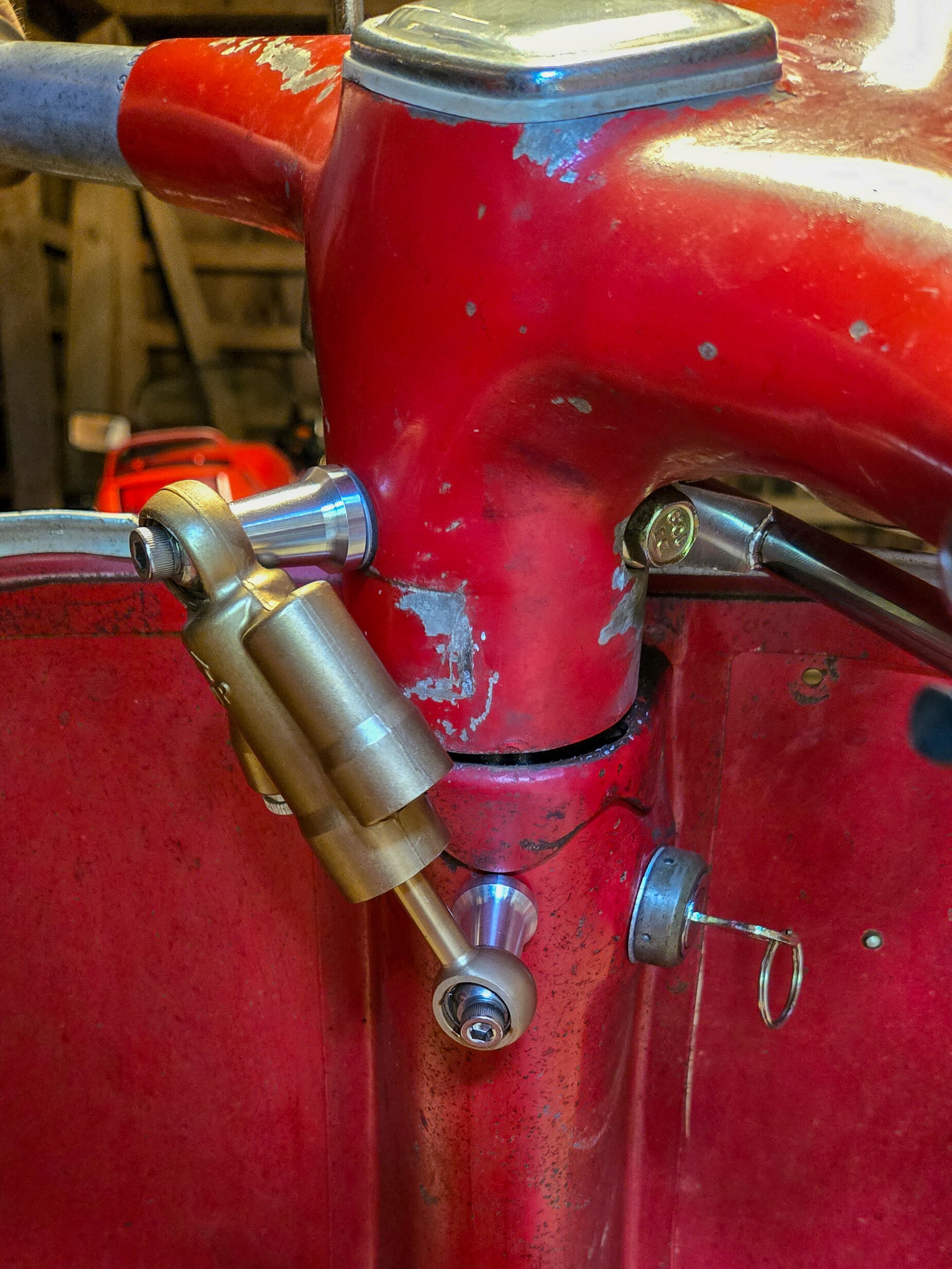

You need to check your fork, looks maybe bent back a bit. The lowest leg needs to be parallel to the upper fork going up to the headset as in the pic below. Could be replaced w/ a Vespas fork that has a shock your AllState "pogo stick" fork lacks ( or straighten yours and convert w/ Vespas lower link & weld on top shock mount.)
This is my AllState fork after conversion.

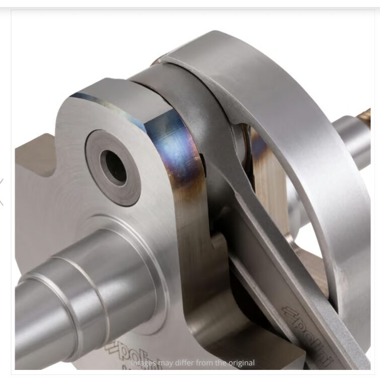

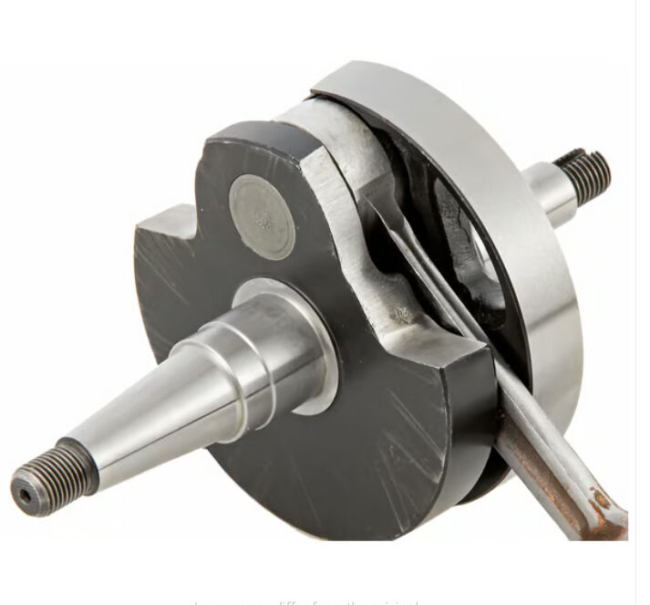

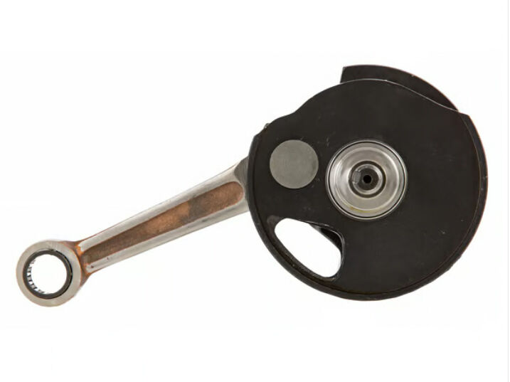

Most likely you will need to replace the crankshaft seals. Not that hard to do, plus you will know the condition of the crank seal surface and trans/axle components. I would try to stay away from the India made parts.

I'll go against V oodoo on one thing only. The front end. I have 2 Allstates, one with an upgraded Vespa fork and one with the original fork with no damper. I actually prefer the original fork. Much softer of a ride. Especially if you keep the engine original or only upgrade to a Pinasco 177. That's my crippled opinion though, if you got all your own original joints you may have a different experience.

I agree with you Friday, about the two front suspensions, one with shock and one without.
I one of each on my two '64s, really cannot tell the difference, but with the stock engines, they don't really go fast and I ride local streets which are in great condition.
Will take a look at that. Been looking into the top shock mount but don't seem to be suppliers I can find. Would have to plaz my own. Seems most here say wait and see tho so I guess I'll see what it's like before altering.
I'll look into to that and will steer away from those parts. Already seen comments on the Indian front fork quality when looking to swap mine.
The comments about the fork def has given me pause and I'll see what it's like. The Pinasco 177, a 20/20 and a variable electronic igntion are the long term things I wouldn't mind doing. Nice and basic and relatively good prices minus the electronic ignition but the ignition would be a fair ways off.
So far so good with my limbs. Did my bone braking when I was a kid. Sorry to hear about yours tho.
Thanks. I did get a stiffer spring from sip. That og spring makes it like riding a scooter on the moon. The stiffer spring was perfect.

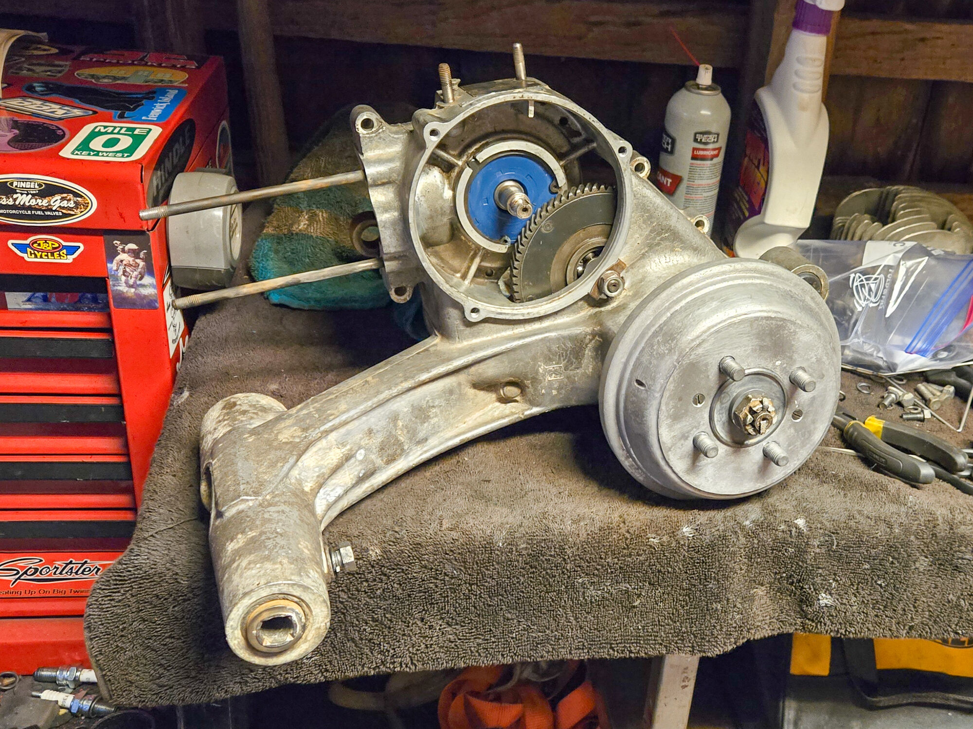

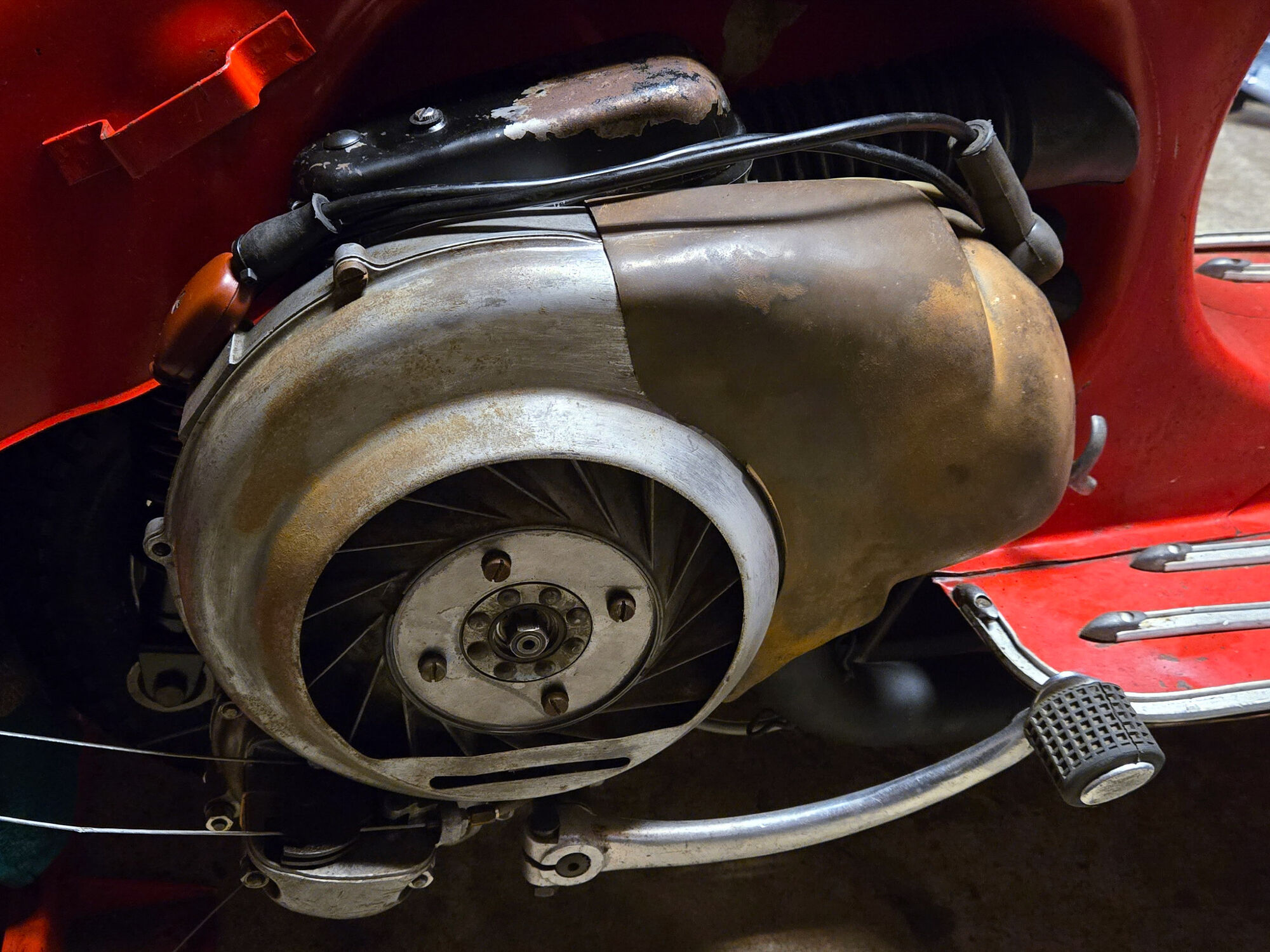

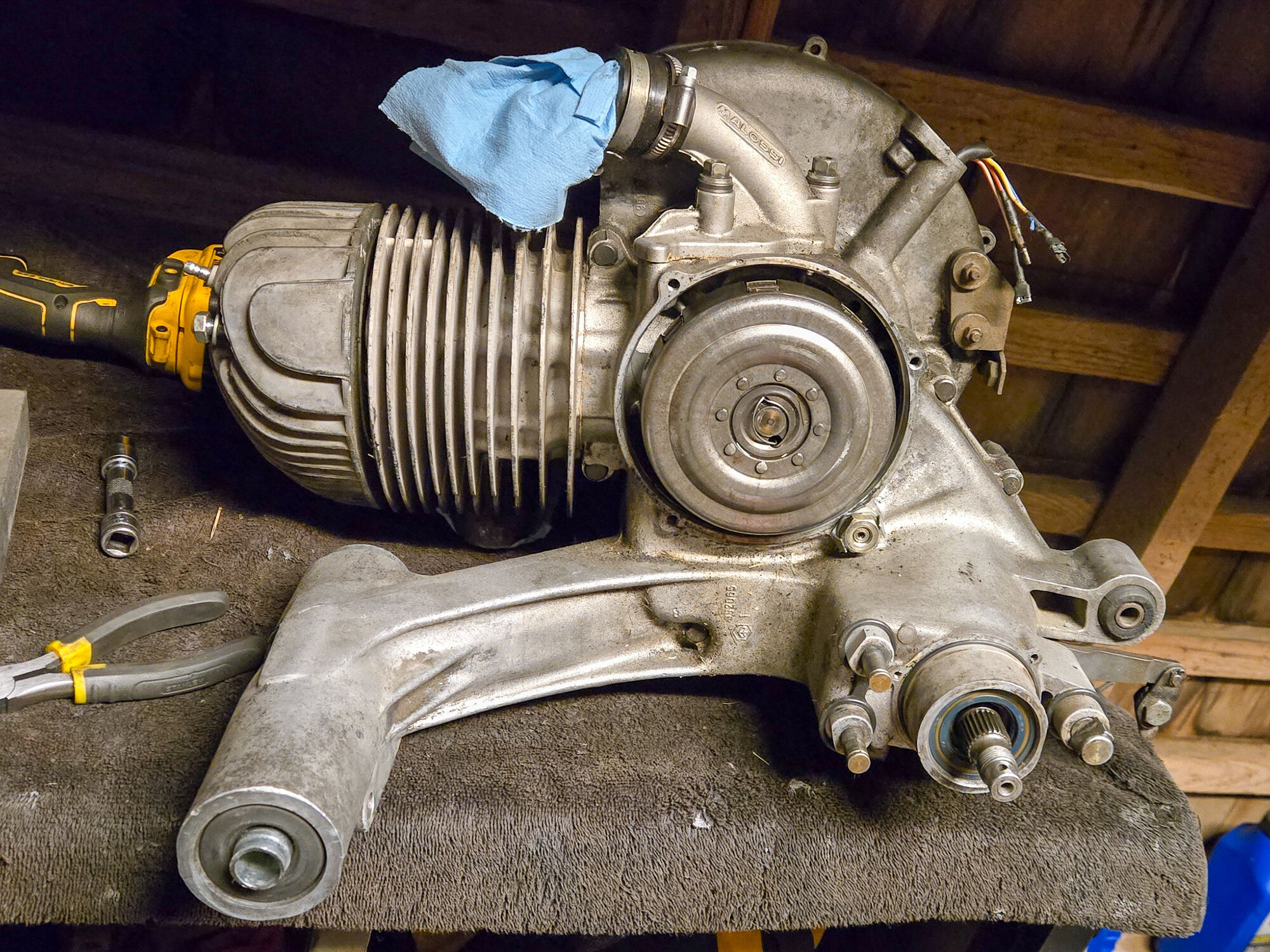

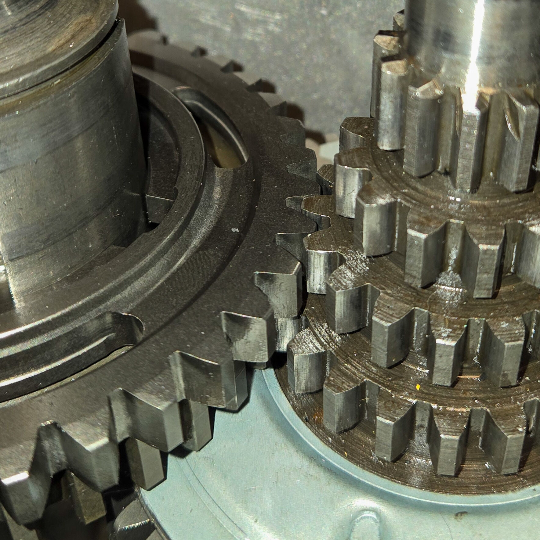

Ok. Pic dump and catch up post.
This is first pulling the engine. It was partially disassembled when I picked it up and the swingarm or swing engine bolt was not even installed. Only the shock was holding the engine in. Couple of the cables were seized and had to be cut.
A pic showing just how farmy the engine was. Seemed like a quarter inch of mud and oil mix cooked on. Have had to use picks and scrapers and wire brushes for hours to even make any progress.
The exhaust as it came off the engine.
The exhaust after a lot of wire brushing, picking, scraping and a coat of exhaust paint.
Airbox lid. Airbox itself even dirtier can be seen in a picture above.
Airbox after a good cleaning. Managed to clean lid without anything that would damage the paint. Rather like the patina on it.
Dirty engine pic again.
Cleaned up engine pic. Still have a few hard to reach places to clean but 95% done now. This is an earlier pic.
Little bit later and a little bit cleaner.

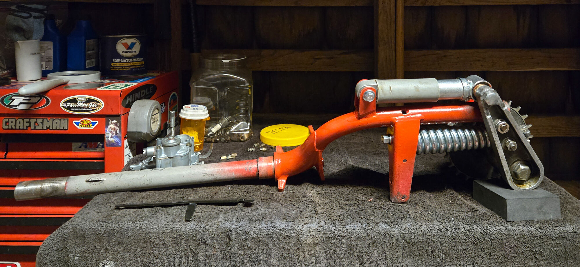

Fork was bent and caused tire to wear thru fender as well. Likely going to unbend the fork and weld a shock mount on while it's out. Want to seal that hole in the fender as well just for the paint. The one piece handlebar nacelle was a major pita and would have preferred a two piece. Not looking forward to putting it back. Oh well.

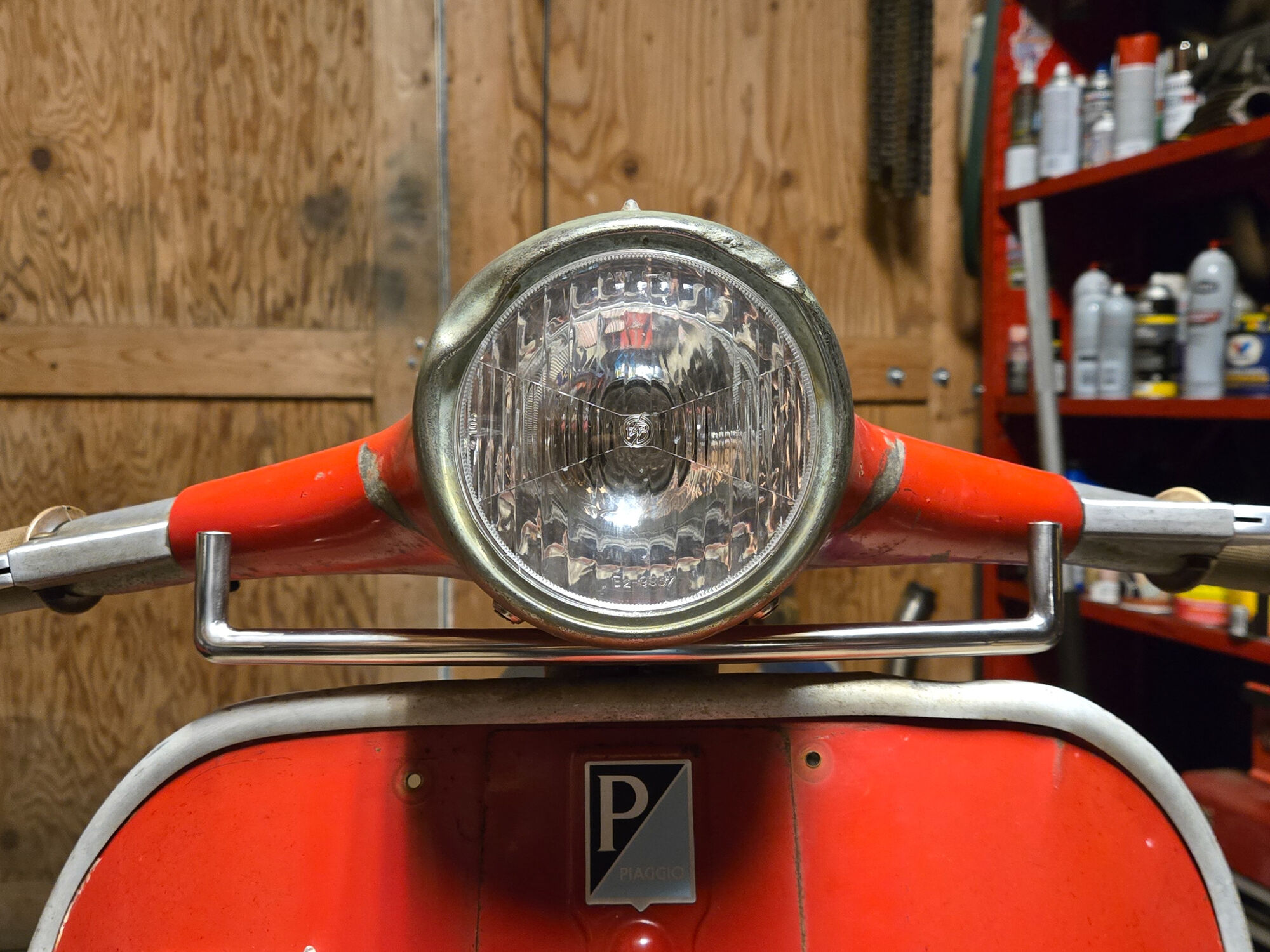

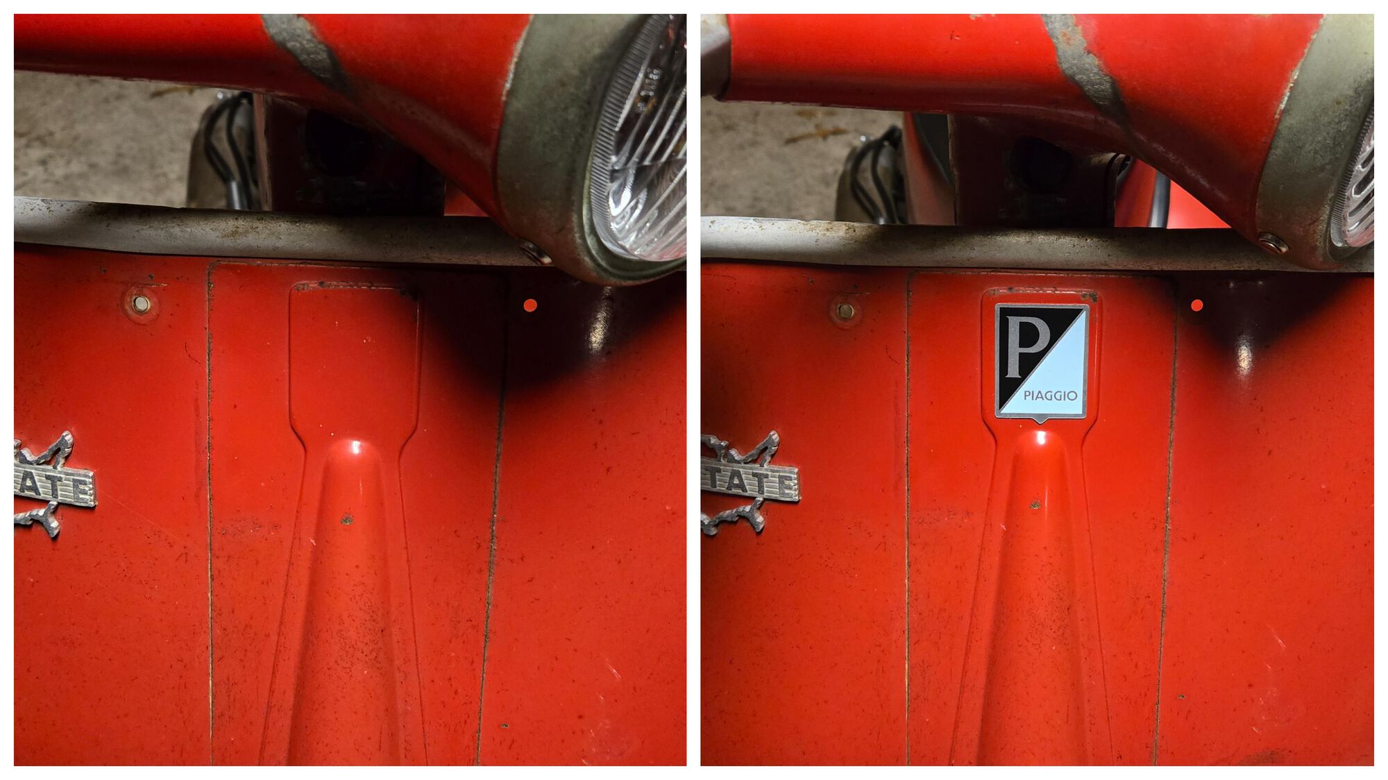

You're off to a good start, looks like a solid rust free frame. Your fork took a big hit so you might want to measure center of fork bearing to tip of seat mount area then report back to see if your frame might have gotten bent as well?
I see that you removed the mirror(?) bracket under the headset. It looks like it might have been on backwards but I've not seen that kind before. It looks like a good solution to a tough problem if you don't like looking down to a legshield mounted mirror. Would you mind taking a few pics of how it was mounted again?
@gomotogo avatar
1963 Piaggio VNB Allstate
Posts: 240
Location: MD, US
@gomotogo avatar
Posts: 240
Location: MD, US
Thanks. Yeah it is. I'll take a measurement when I can and report back.

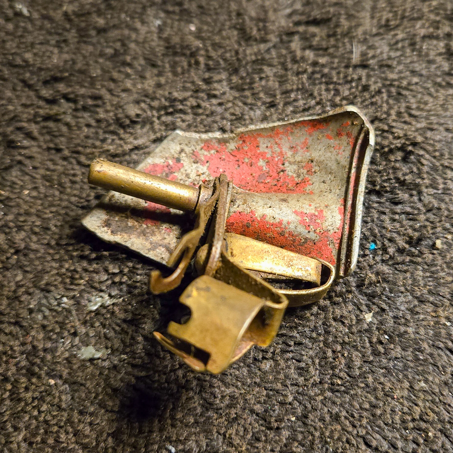

It's pretty much torn down right now. Even more so than in the pic. Had the fork apart to repair it. Waiting for stuff to get here. Going to do an update but want to get a pic of the unbented fork. lol
The bracket was for a windshield according to PO. Reminded me of a shackle. Rusted and was directly on the paint. First thing I did when I got it home was take that off. When they said it was a farm scooter it wasn't hyperbole. It apparently rarely if ever went off the farm or on a street so no need for mirrors. Even the brake light was unnecessary. I found a shard of it in the glove box. Need to take a pic of it and post it. Funny.

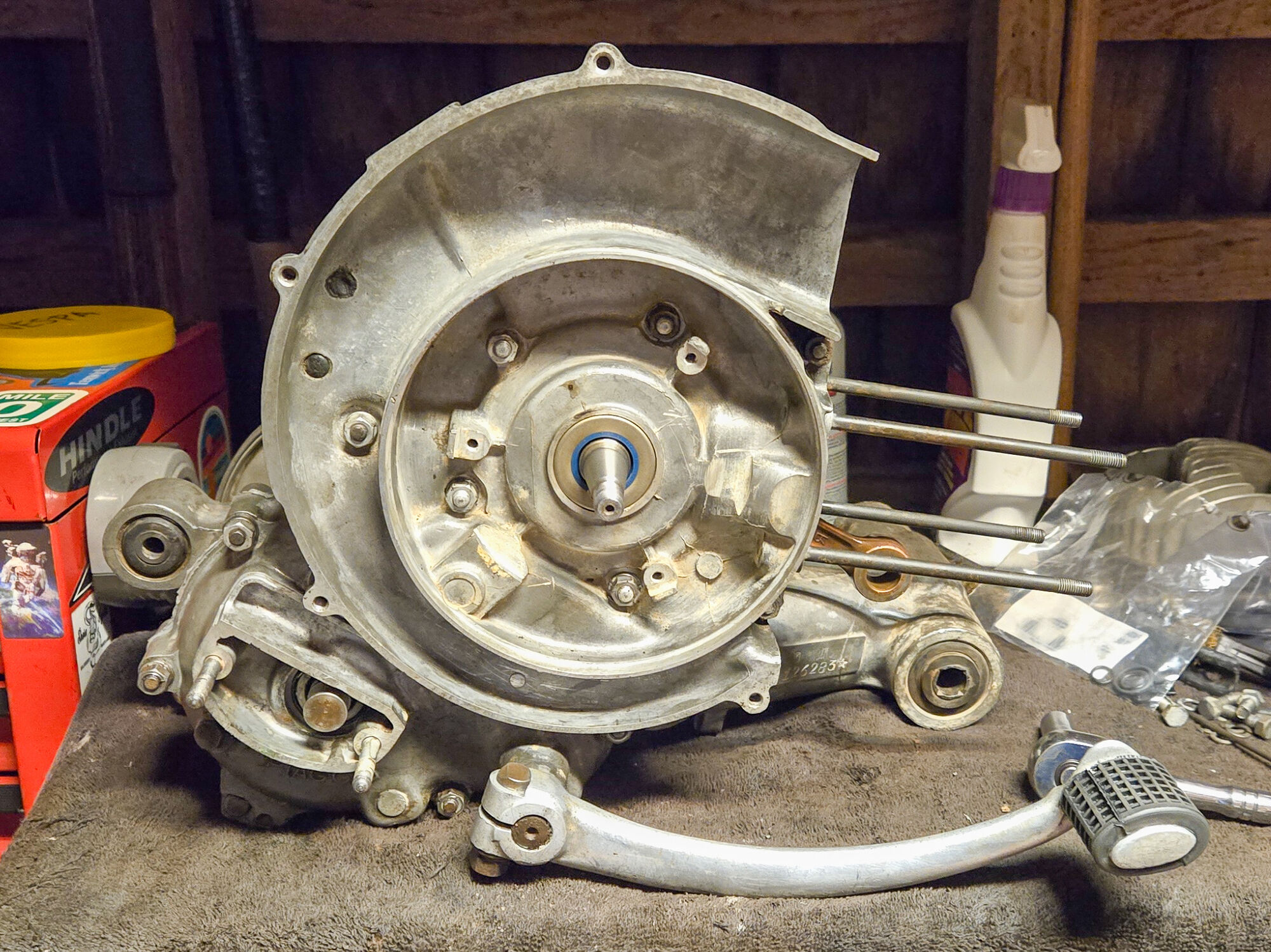

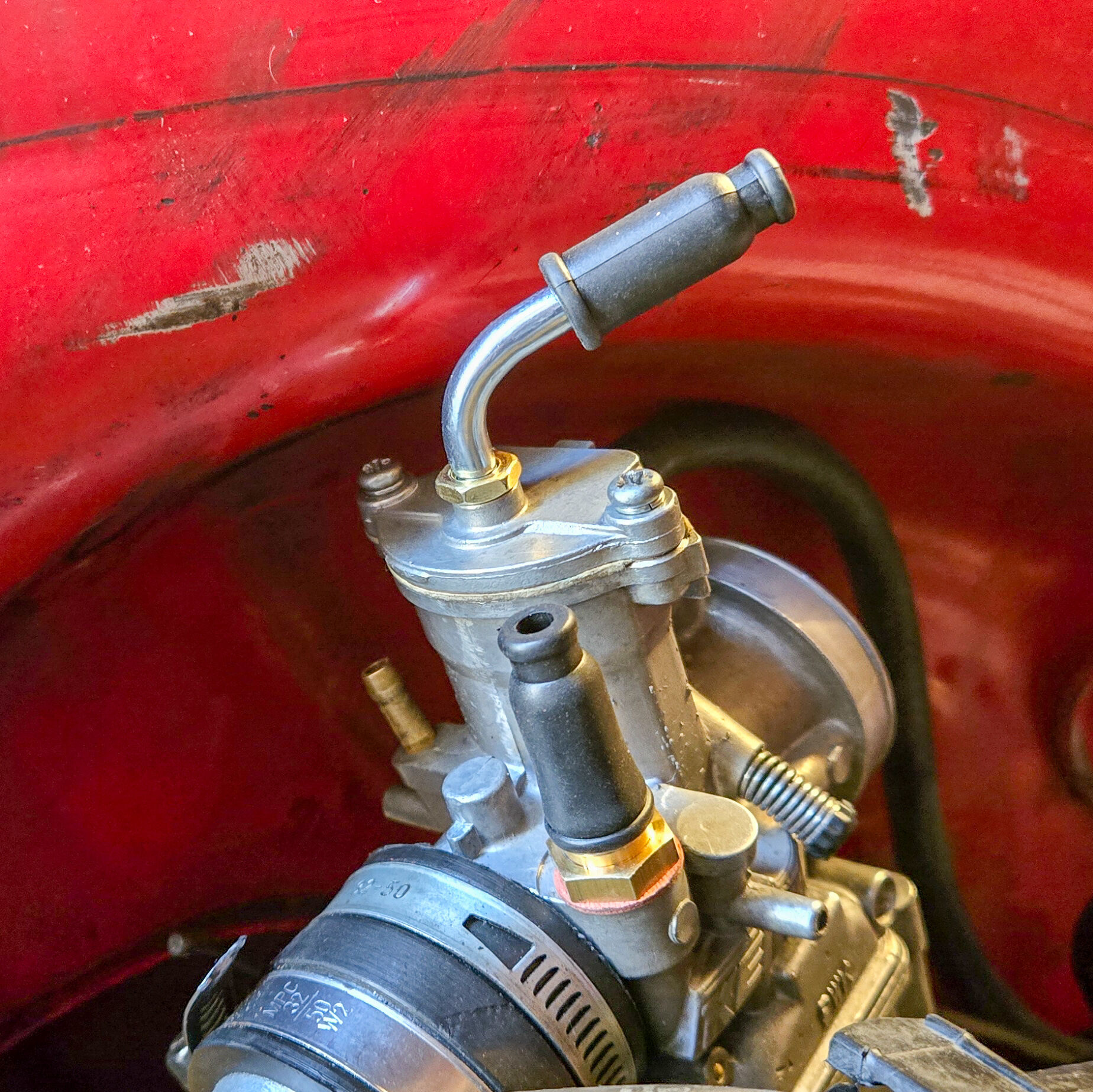

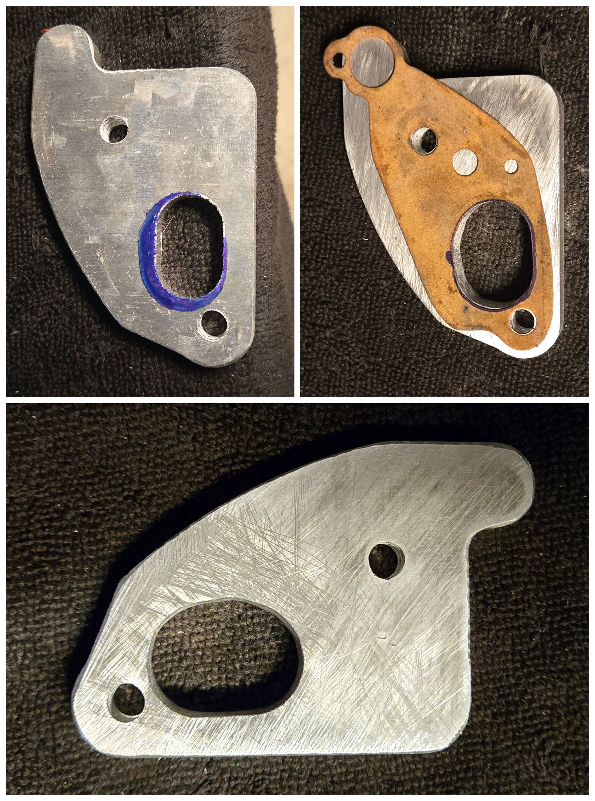

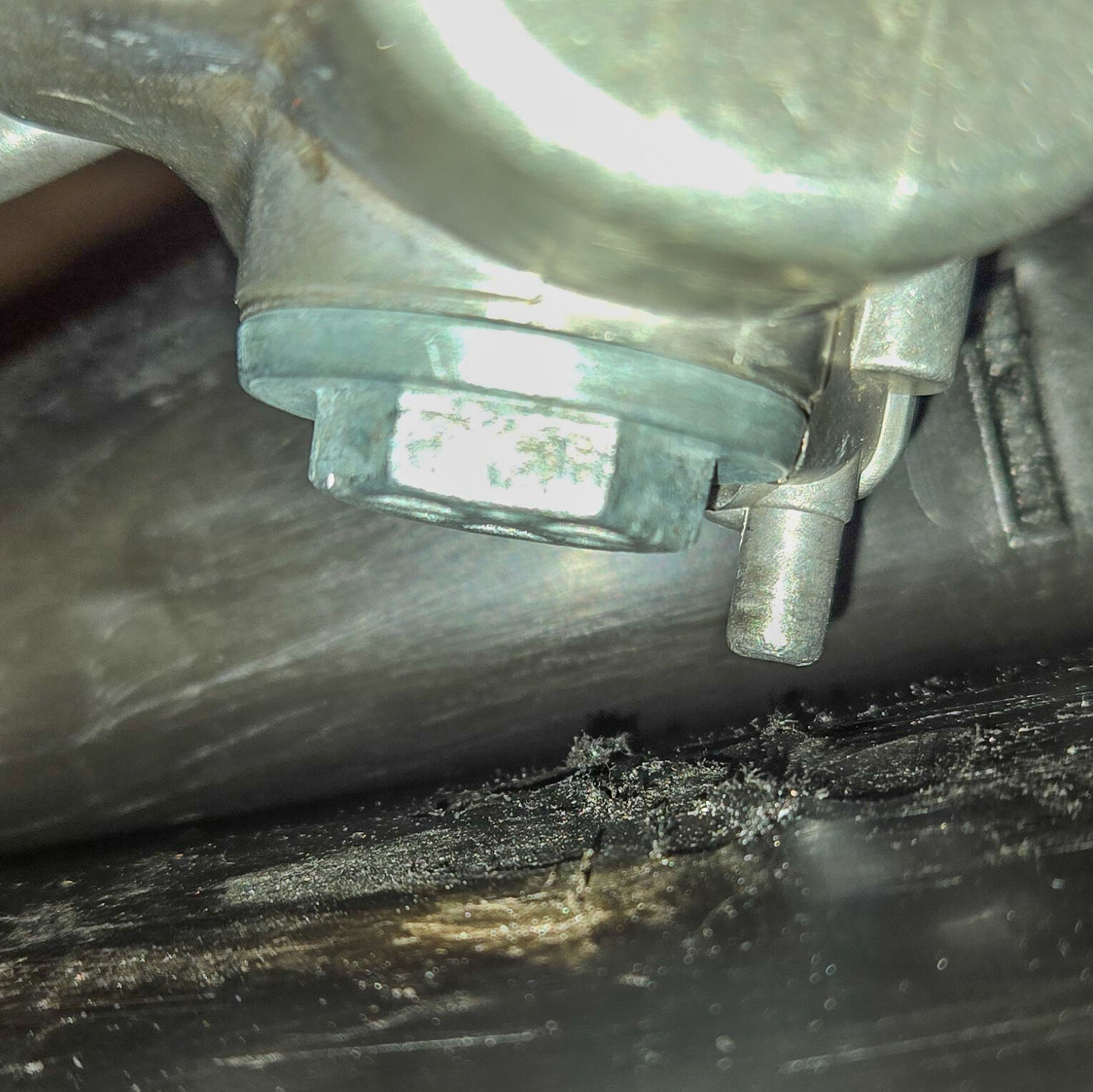

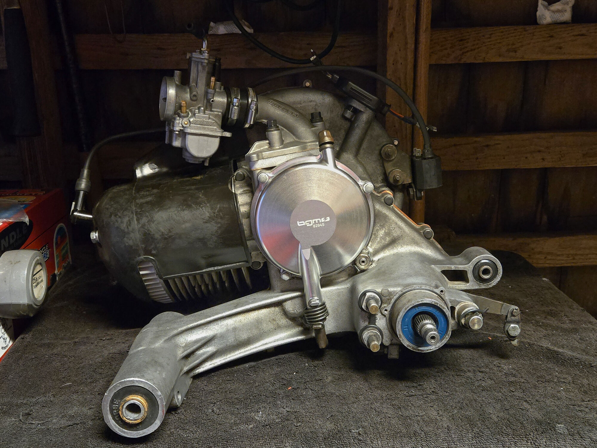

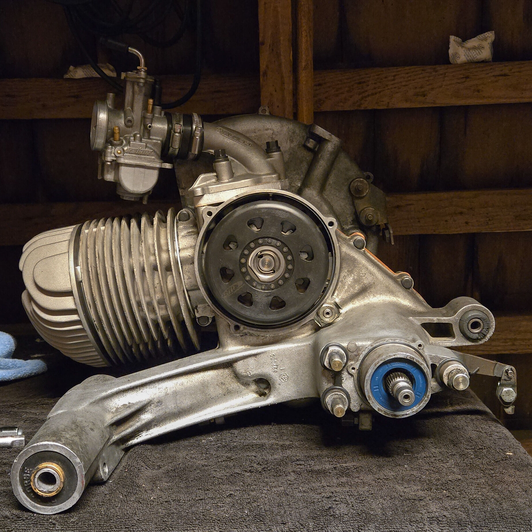

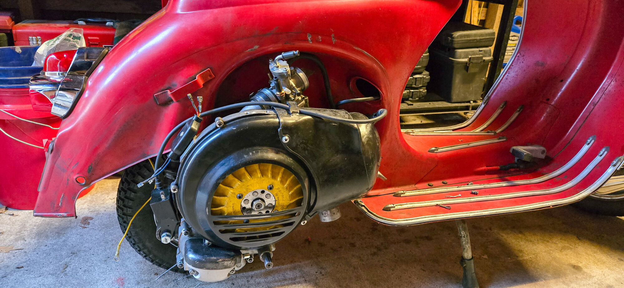

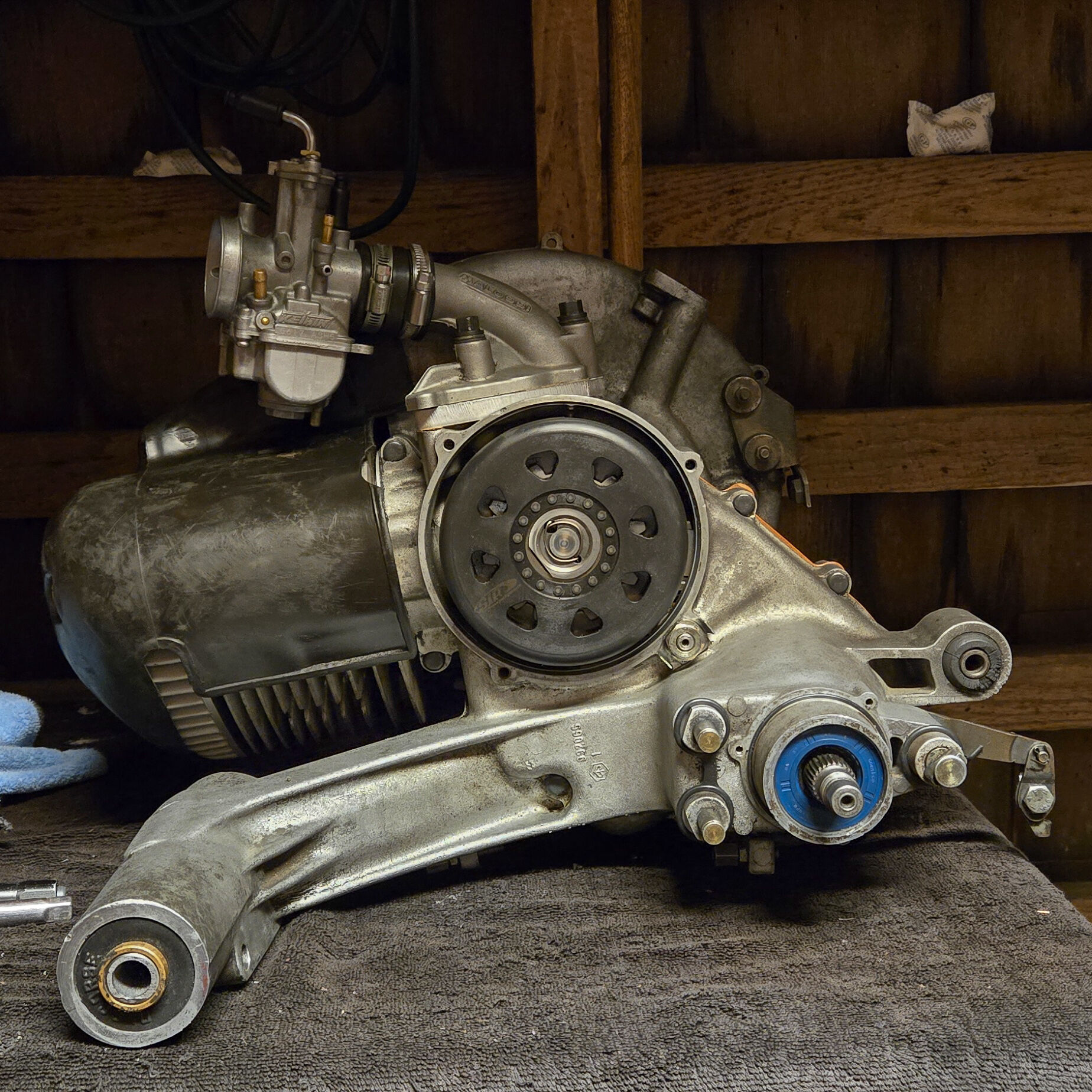

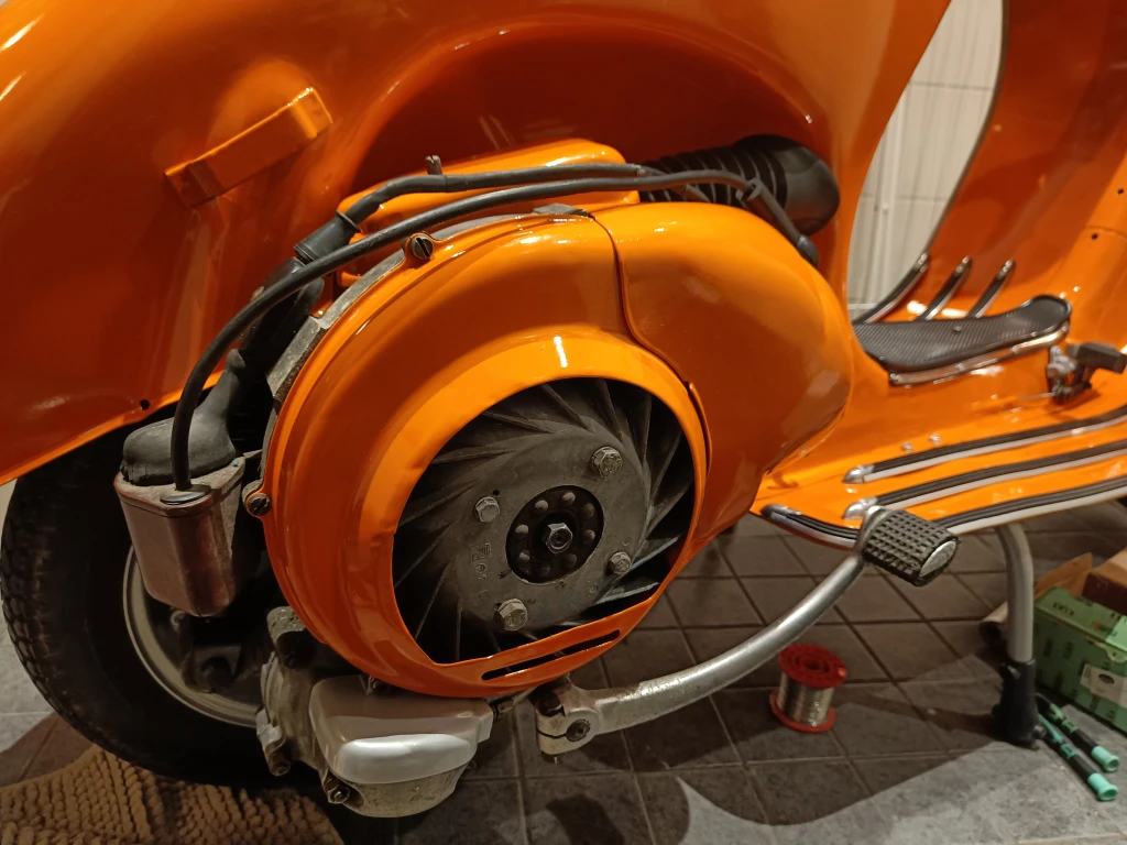

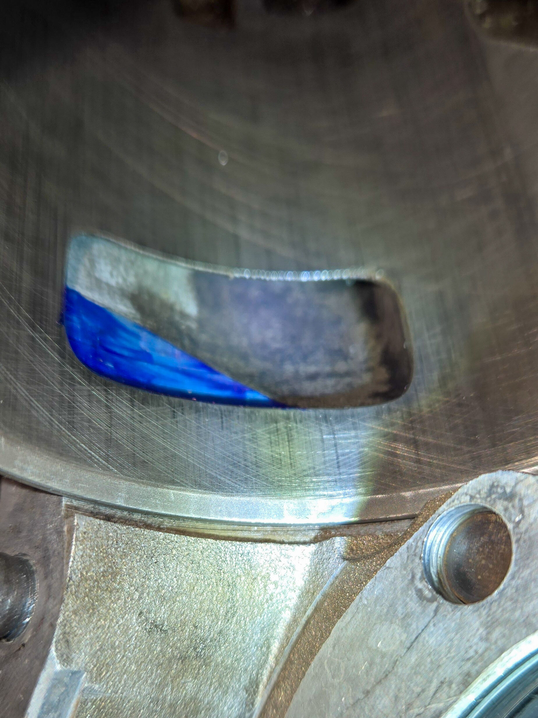

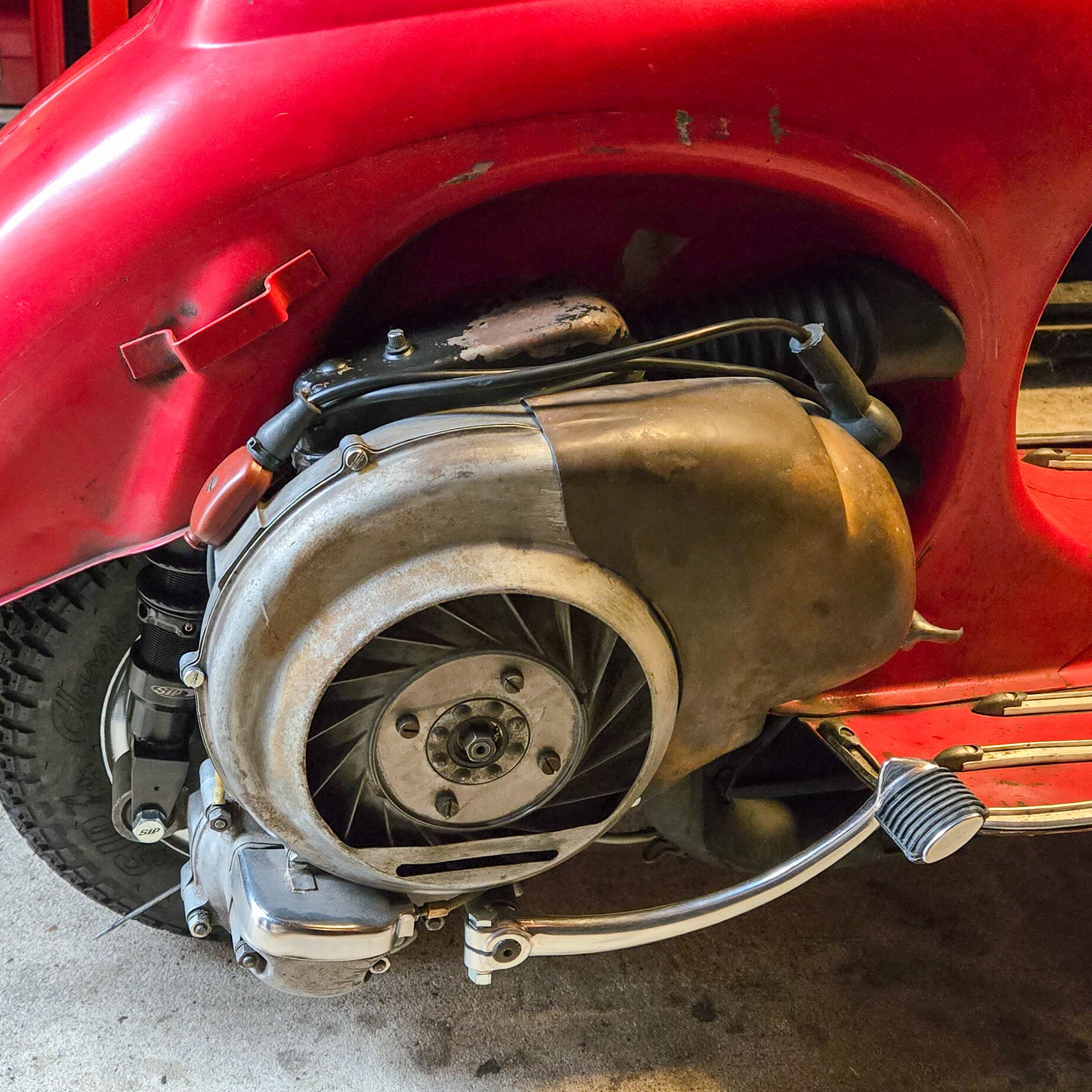

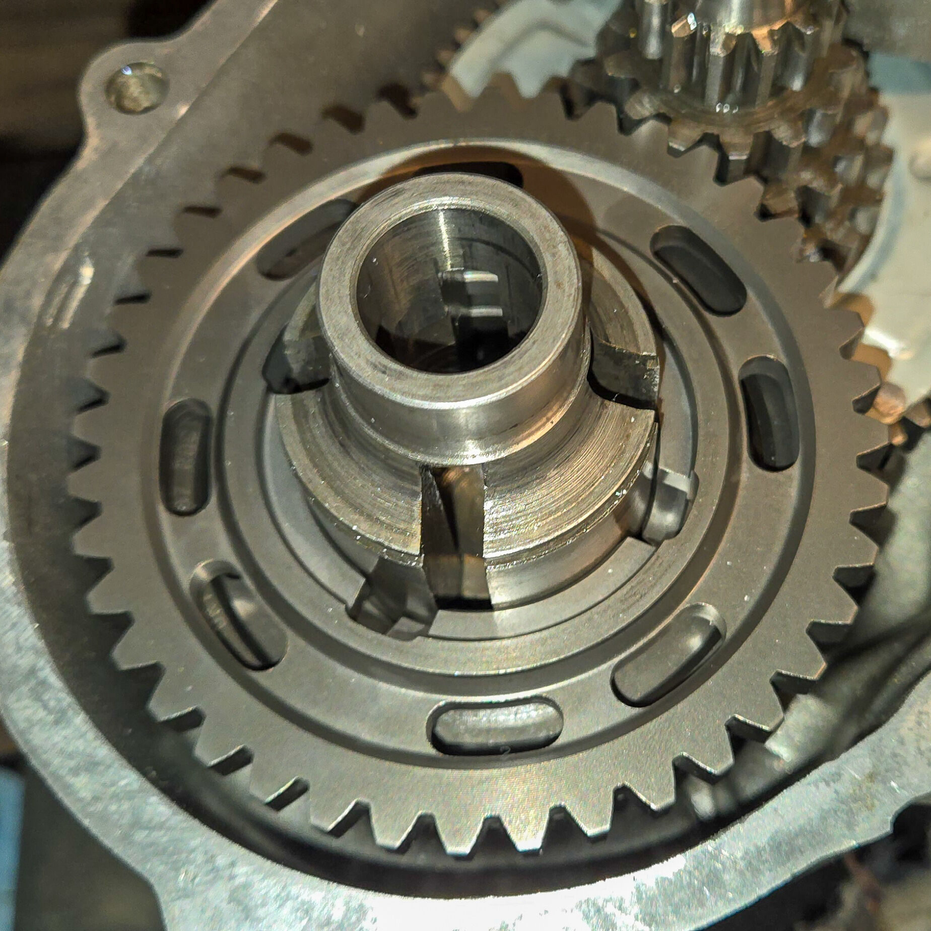

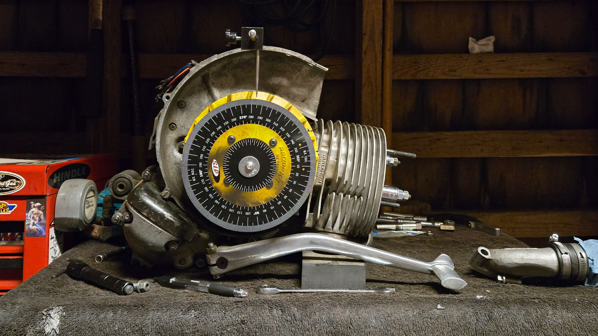

Update Photo Post

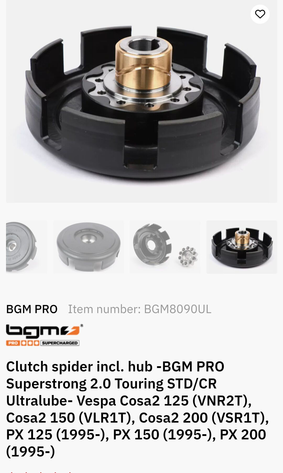

I'm replacing cables and grommets and crankcase seals and gaskets et cetera. That stuff is taking forever to get here too. Also had the Haynes I ordered over a week ago disappear en route.
On a side note it's taking all my will power not to kit it out right away. Crying or Very sad emoticon I want to know what it's like stock first tho. I'll do the other stuff over winter if I still want to.

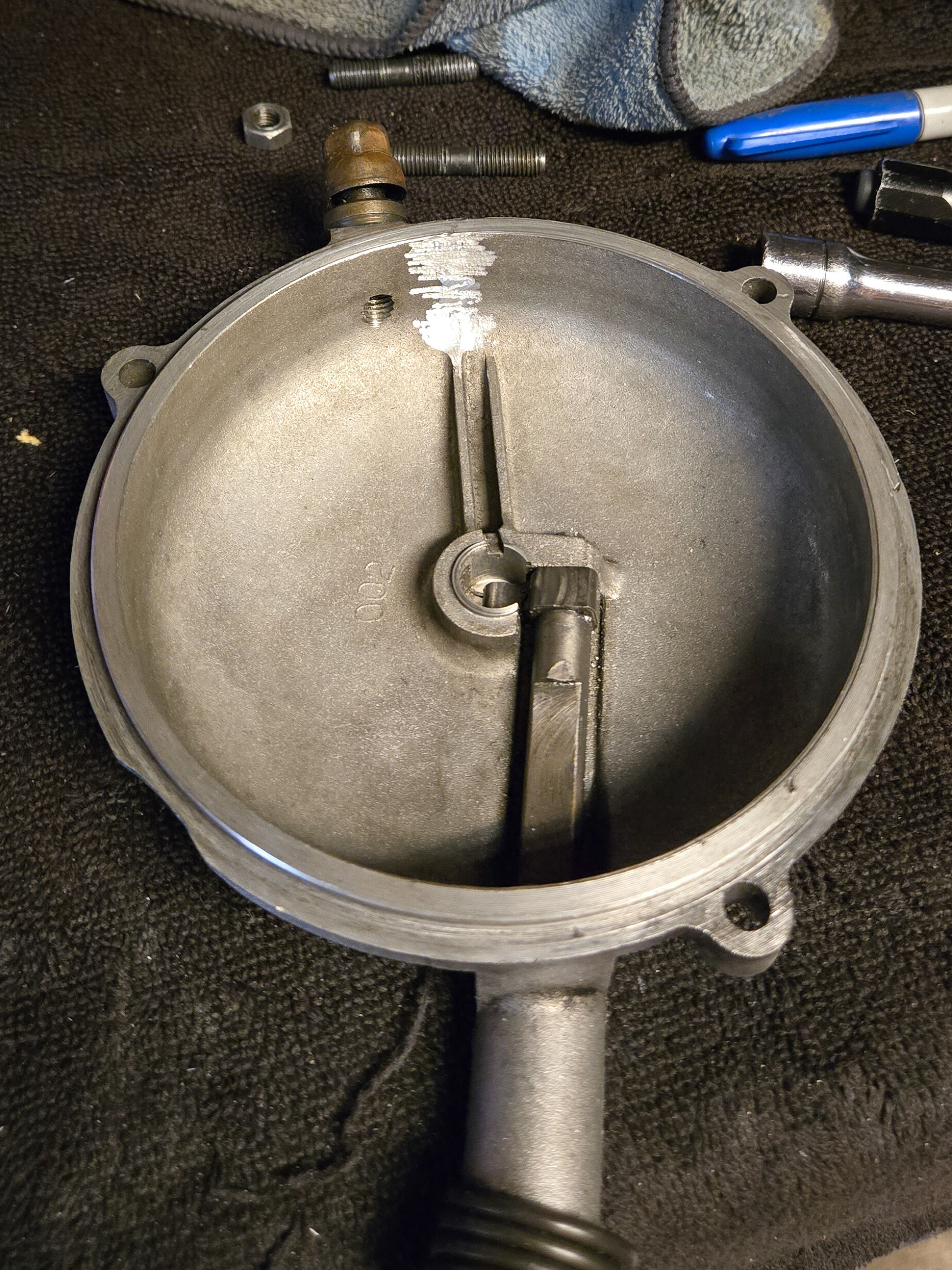

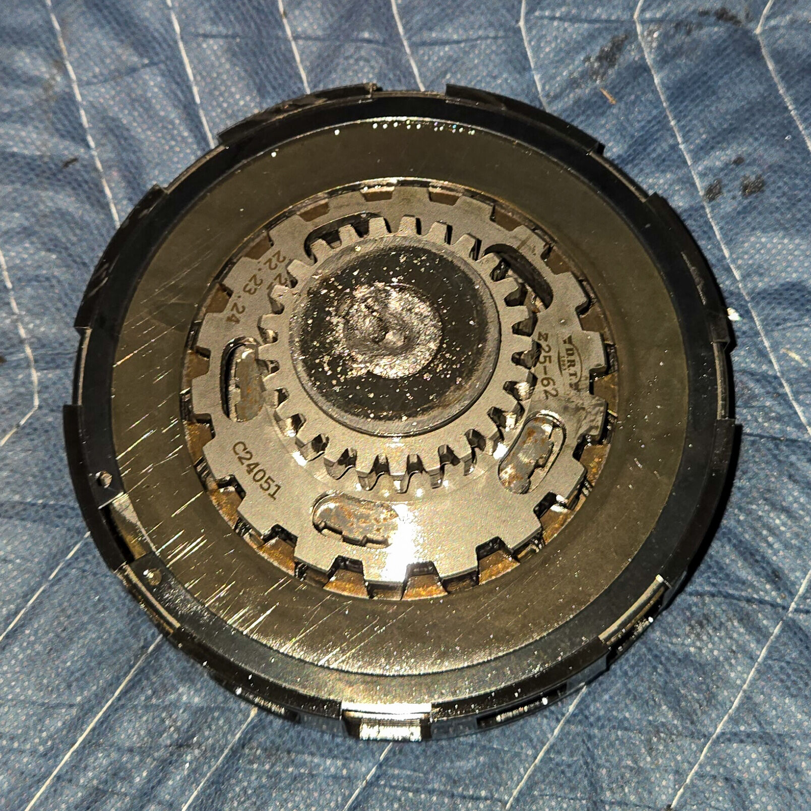

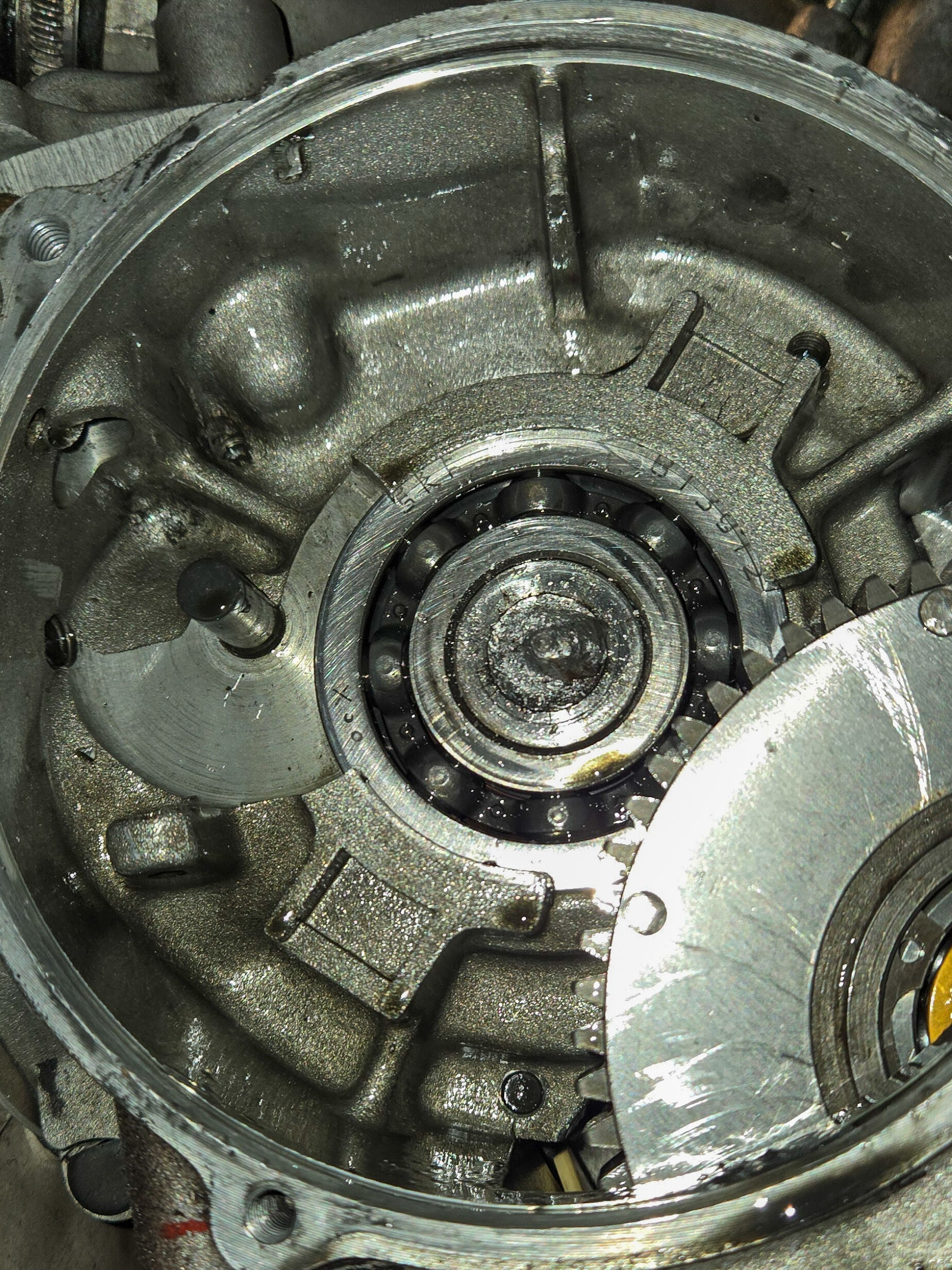

Swapped out holey clutch cover

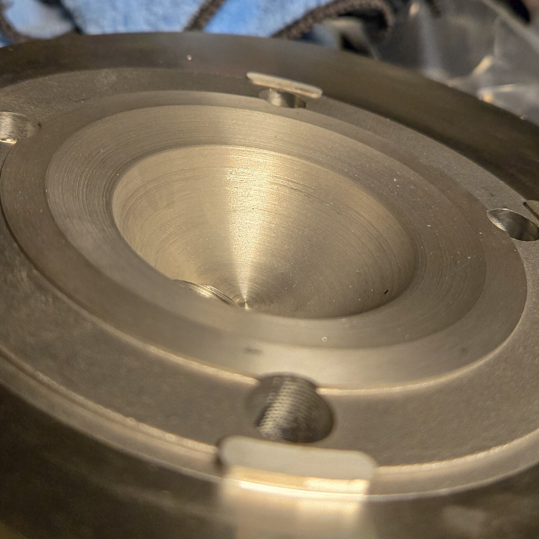

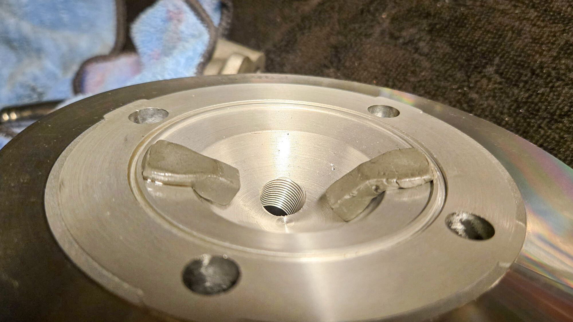

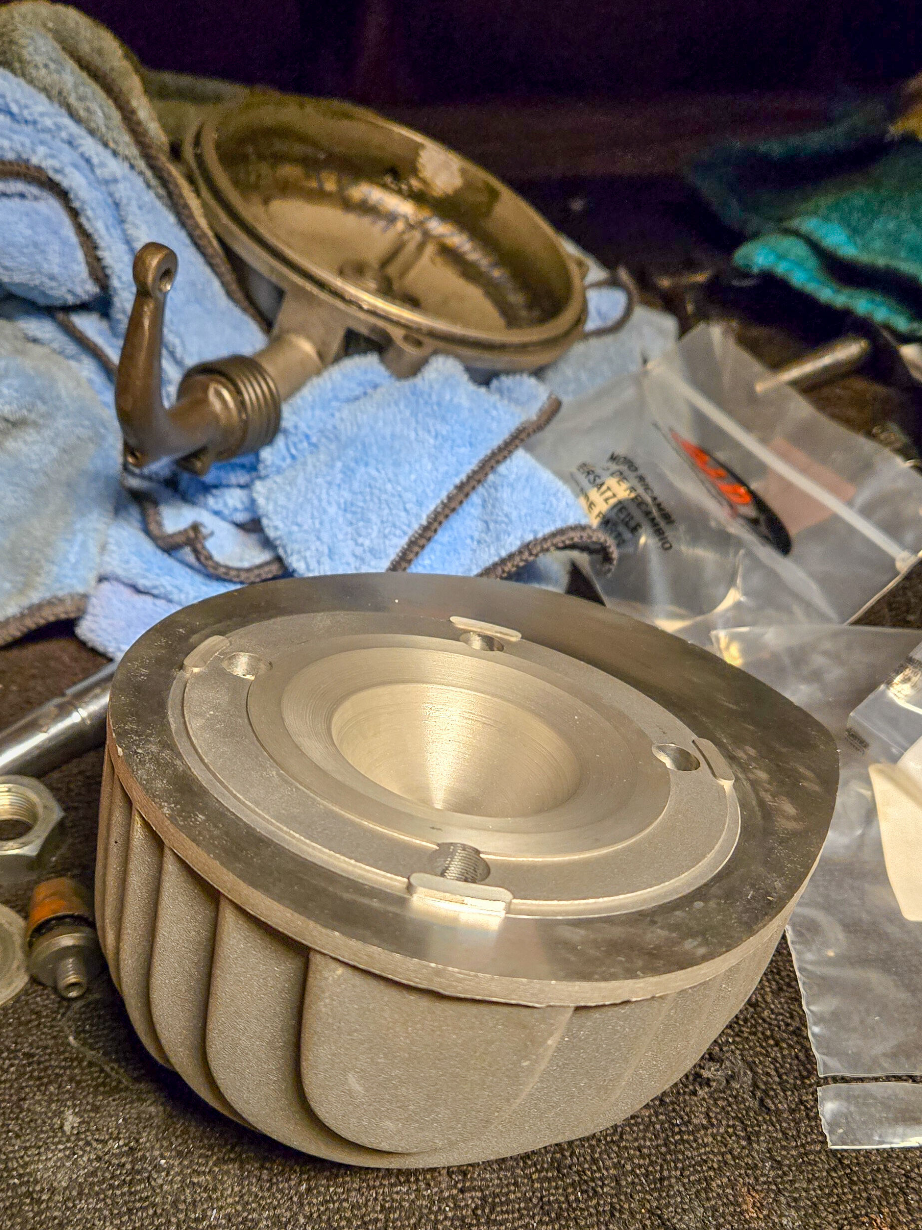

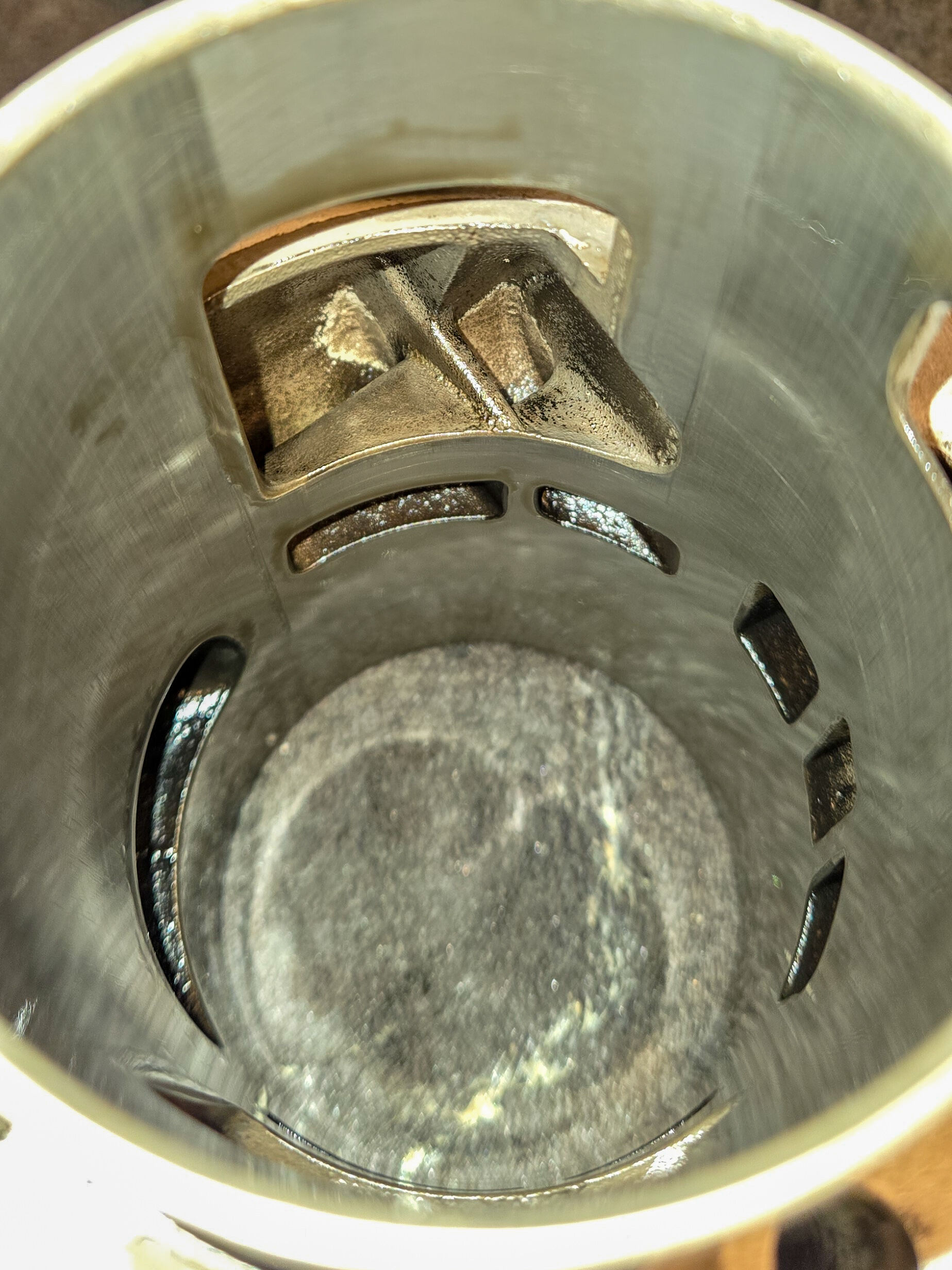

Pulled head and cylinder. All pretty good. Going to run those as is. I did use some light oil and a piece of emery cloth to clean up the cylinder.

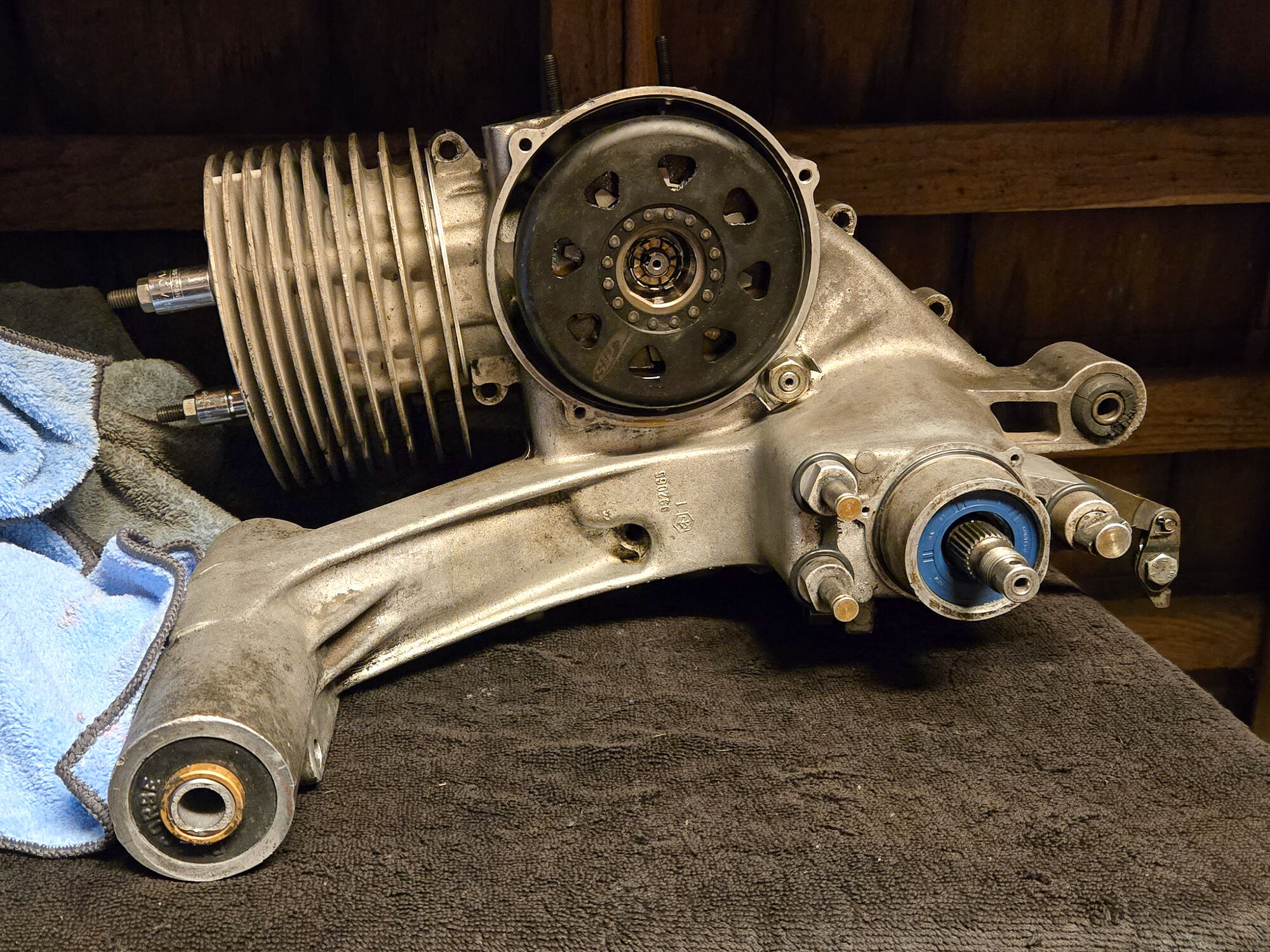

Whole engine dwarfed by a wheel is kinda funny
Little DIY dent repair
Cleaned up well
Cleaned up well
Both covers cleaned up nicely. Thought I'd have to paint but they're well preserved and I like the surface finish.
Almost forgot. I got the fork unbented with a torch and digital angle finder. My dad has an industrial torch set up and he helped with that.

This Allstate has basically required a near resto. Mechanical at the least.
Parts and manuals and tools have arrived. Just going thru everything and it really is everything.
Redoing the front swingarm from VNA to a VBB version.
Likely going with a Pinasco 177 kit, SIP Road 3, and a 20/20 for now.
Photo Dump
The original purchase receipt from 1963. Adjusted for inflation it was over $4,000 which would still be a pretty good deal.
Nice little manual find. 1965 Douglas manual. Inside was a clipping observing the passing of the designer of the Vespa.
The clipping that was inside the Douglas manual.
Cleaning up the wheels
CitriStrip for the paint and phosphoric acid for the rust.
Nice FA Italia swingarm

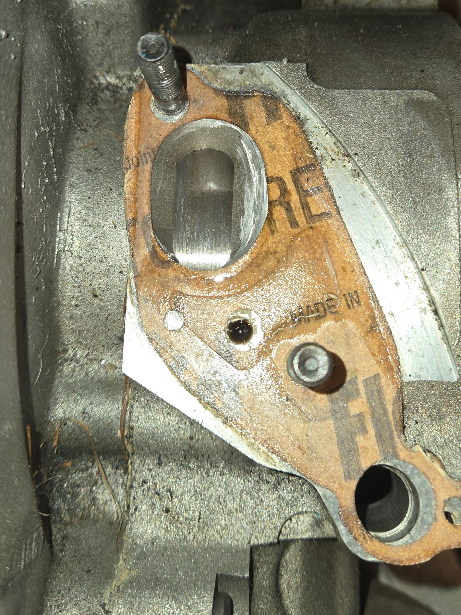

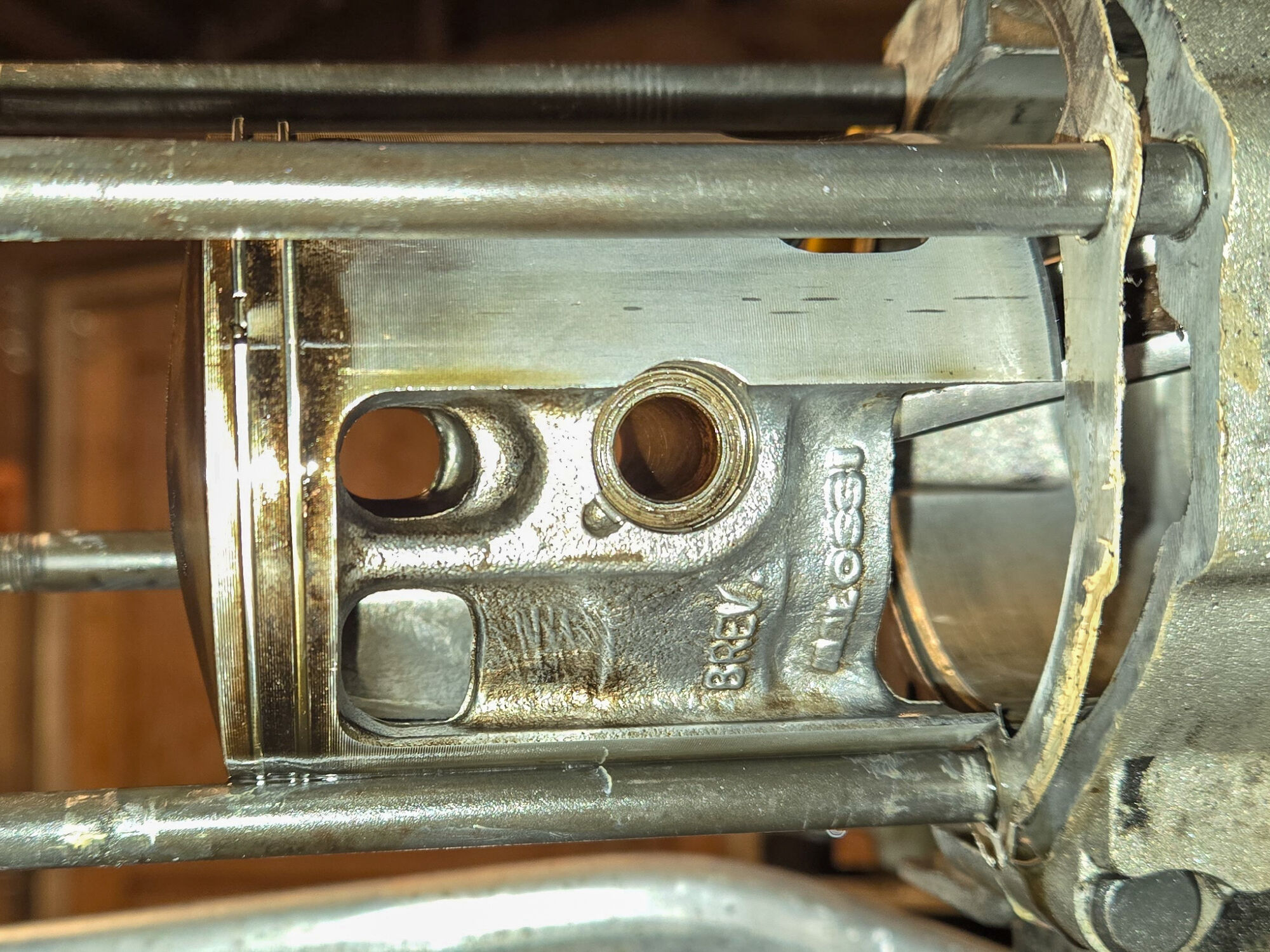

I cracked the case.🕵‍♂️ lol

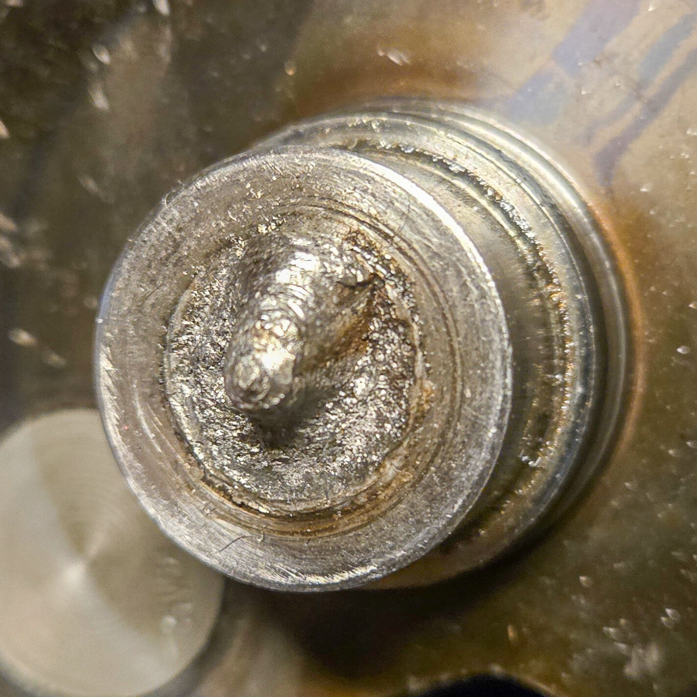

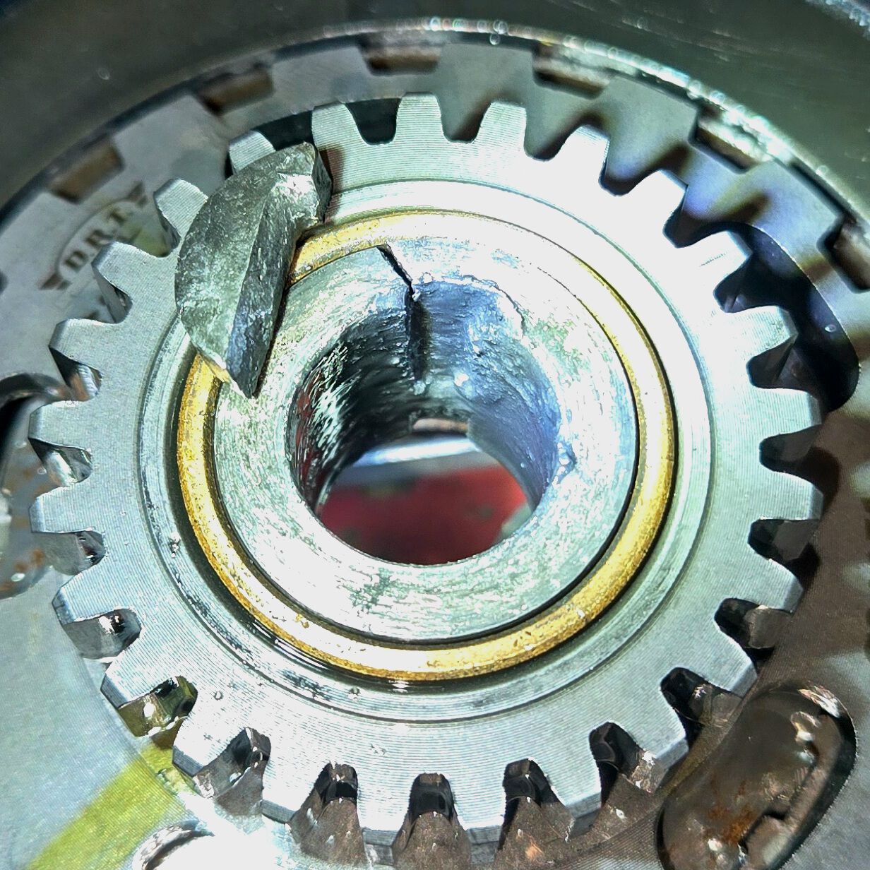

Filthy Pudding Engine
Just chock full of pudding. Def needed to be torn down. Somehow not gritty. All the bearings are in really good shape.

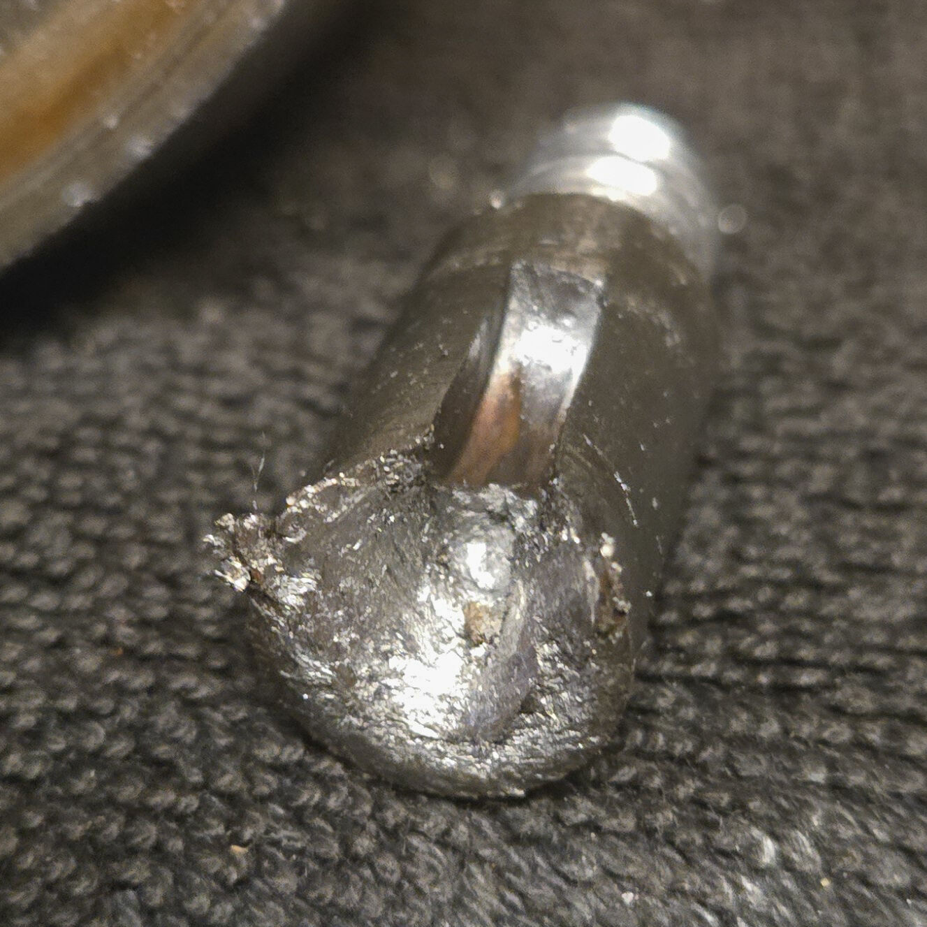

Found this as well. Not sure I'll ever be able to utilize it. I'm more of a 4 stroke motorcycle guy but always been intrigued by 2 strokes from afar so should be some good reading to catch up on theory.
Haynes finally showed up. One is from 1982 and had a British magazine clipping of guys who turned their scooters into 70's style choppers for lack of a better description.
Photo Dump
The receipt is so great; love it. I would put that in a very special place, maybe in a frame for the wall.
why did you decide to go to non-threaded pivot swingarm? I've never seen them on VBB's, but Sprint/Rally.
@gomotogo avatar
Posts: 240
Location: MD, US
@gomotogo avatar
Posts: 240
Location: MD, US
Yes I plan to put in a frame or other suitable preservation.
Because there was nothing else available.

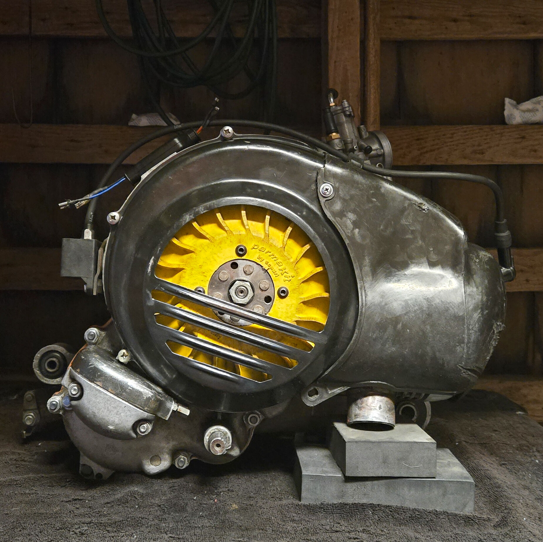

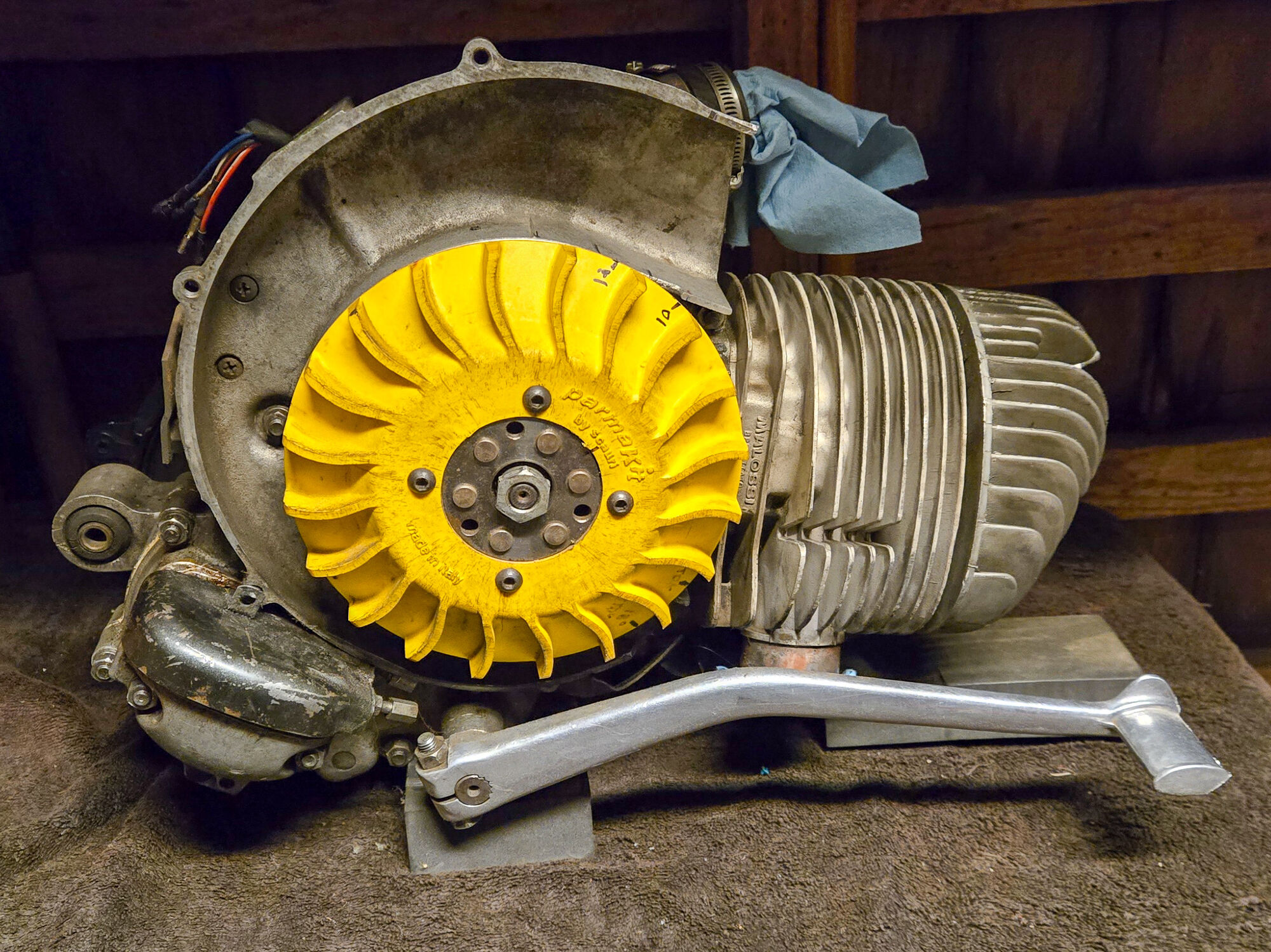

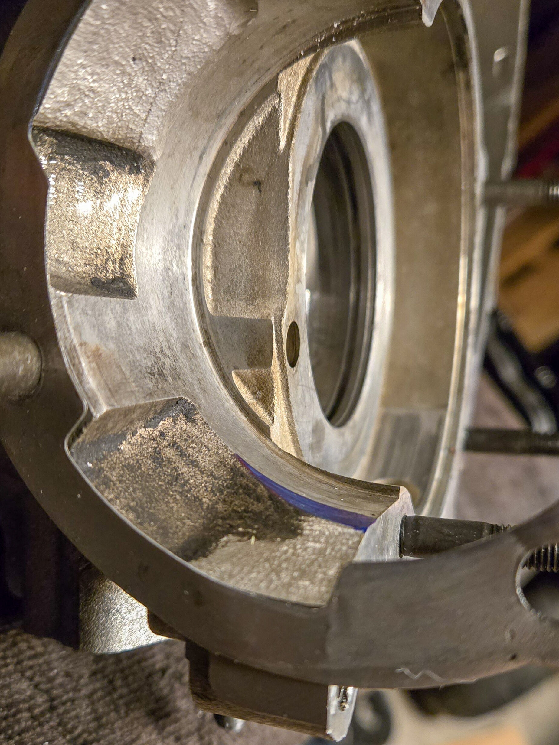

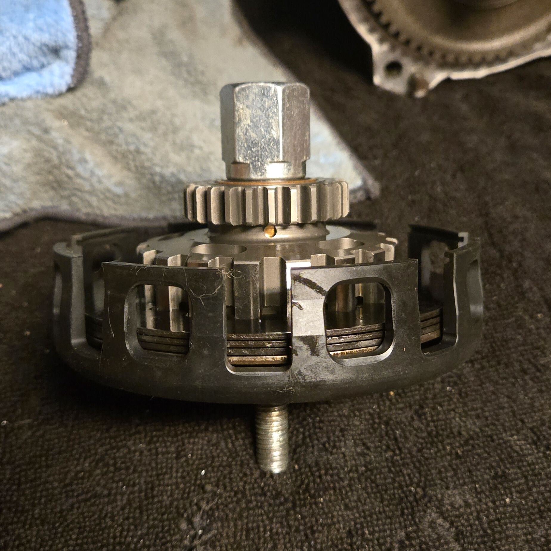

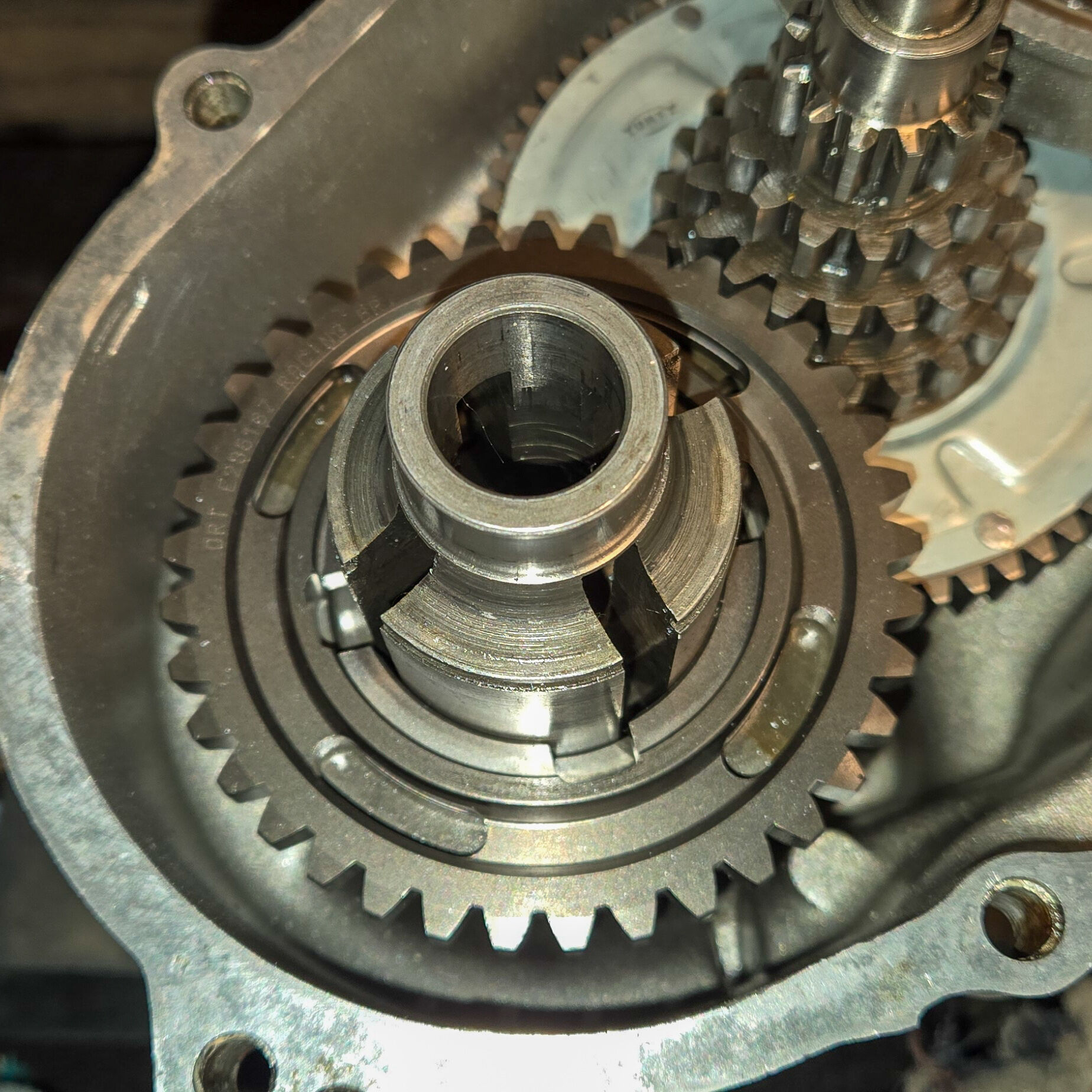

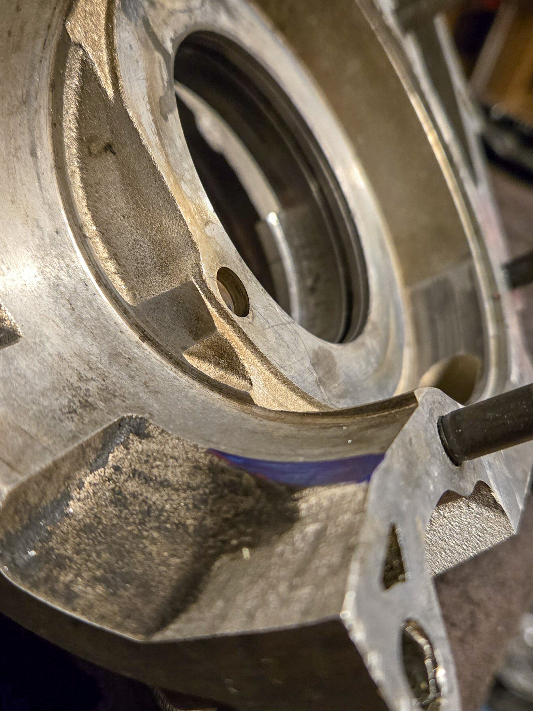

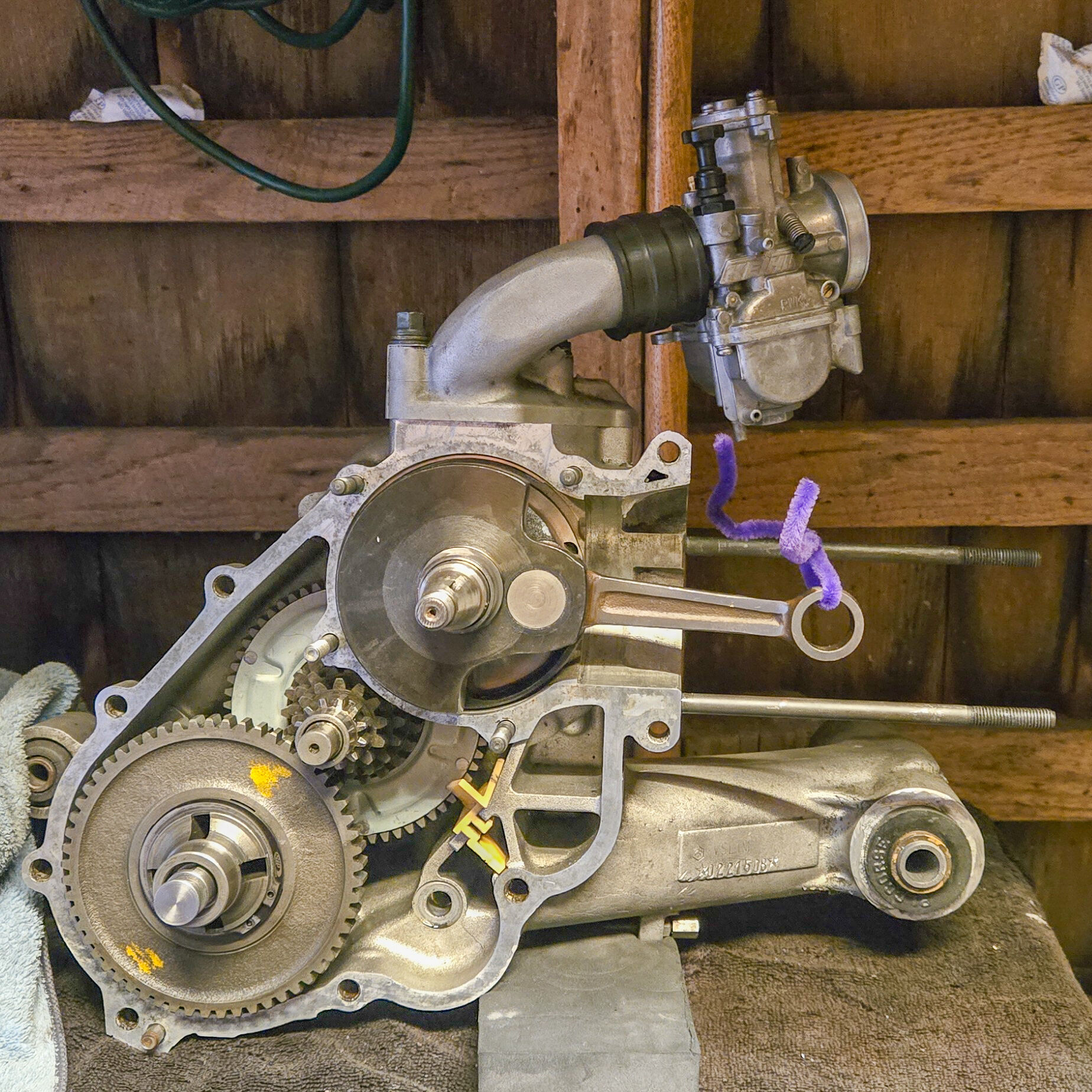

Bottom end/trans/cases back together.
Bunch of mundane stuff done:
Replaced lock set
Replaced rear shock
Removed and cleaned tank and updated fuel system
Replaced cables
Sent stator off for wire and coil replacement

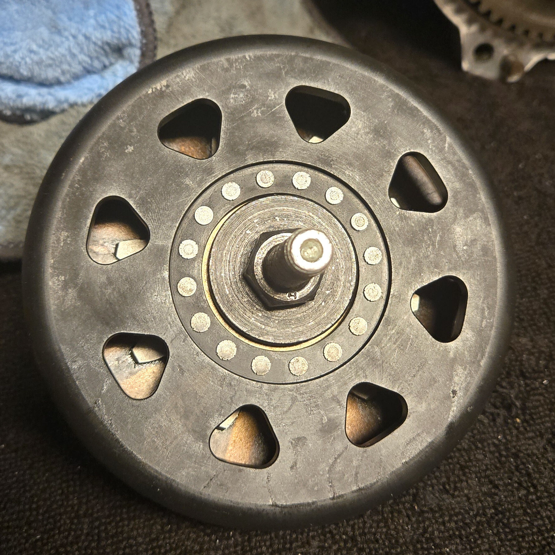

Rebuilt clutch
Replaced seals and bearings
Swapped in a 4 speed

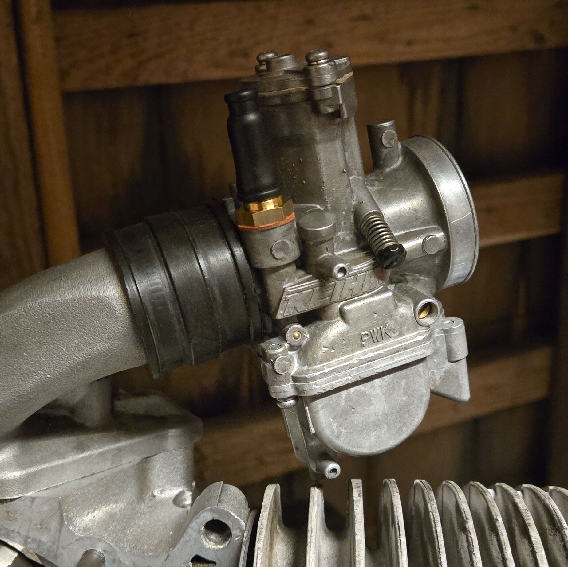

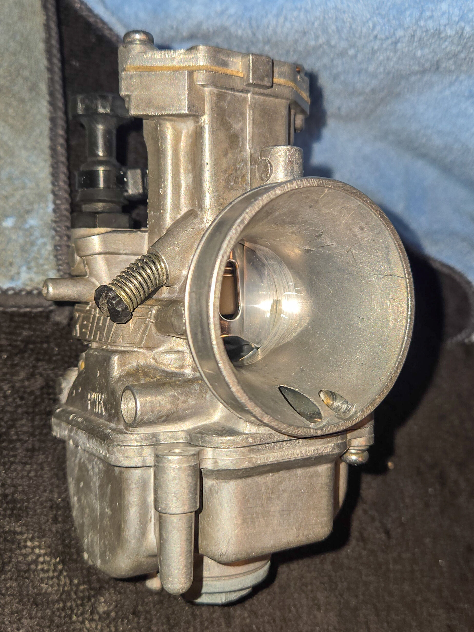

Rebuilt carb and also found and rebuilt a 20/20
Lot of other little things

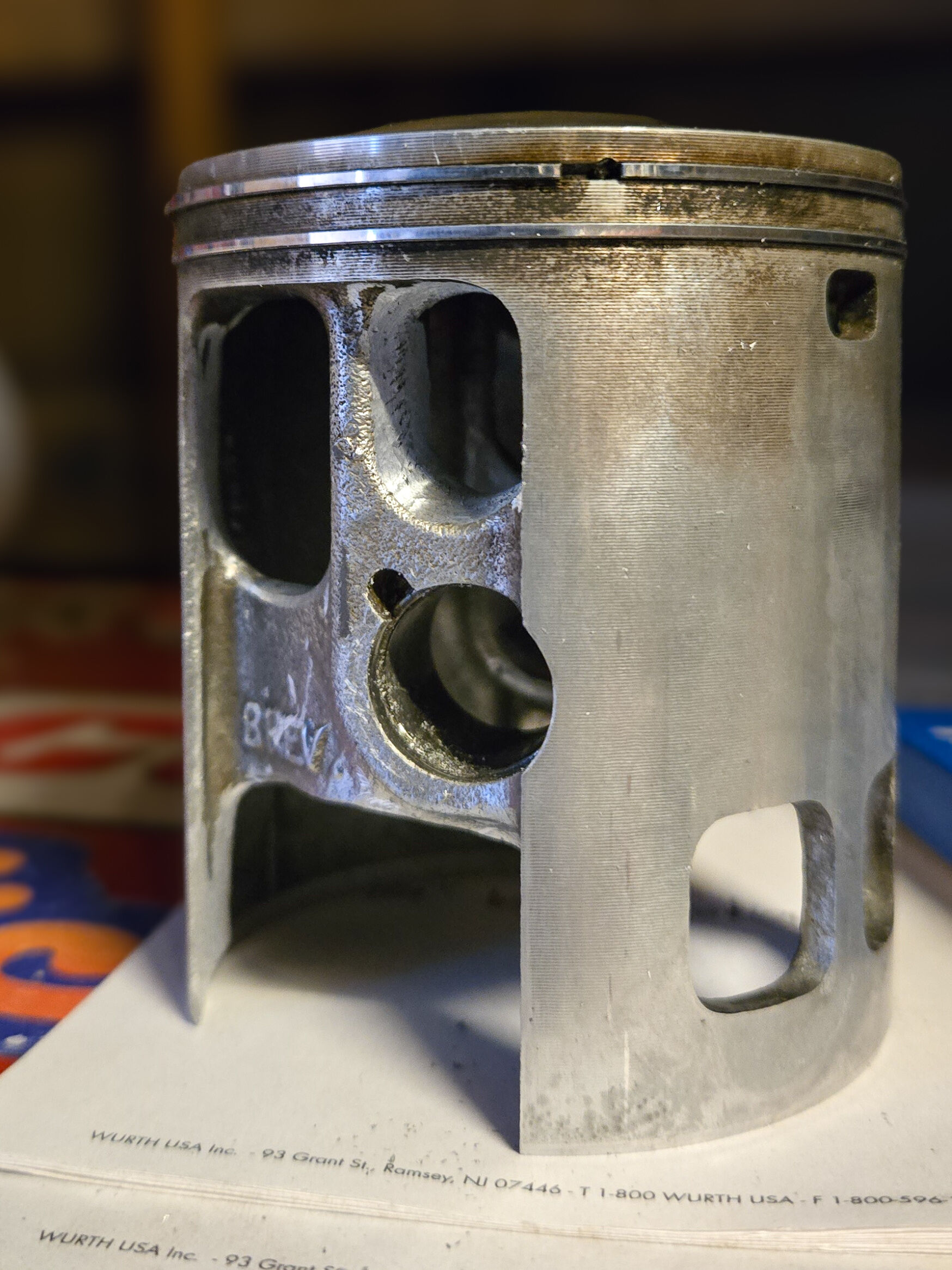

Have a Pinasco 177 and SIP 3 on the way.

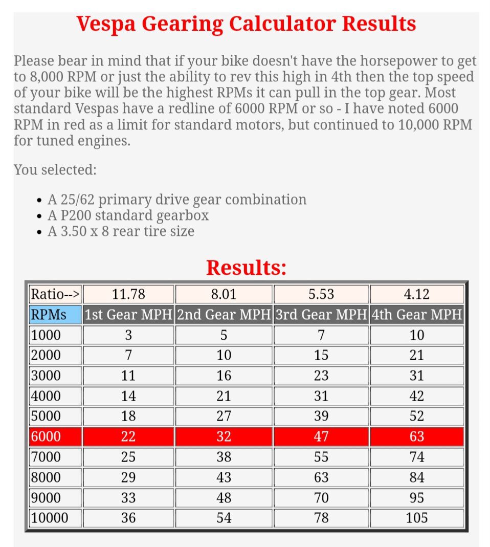

@gickspeed avatar
Posts: 2816
@gickspeed avatar
Posts: 2816
Replaced lock set
Replaced rear shock
Replaced cables
Rebuilt clutch

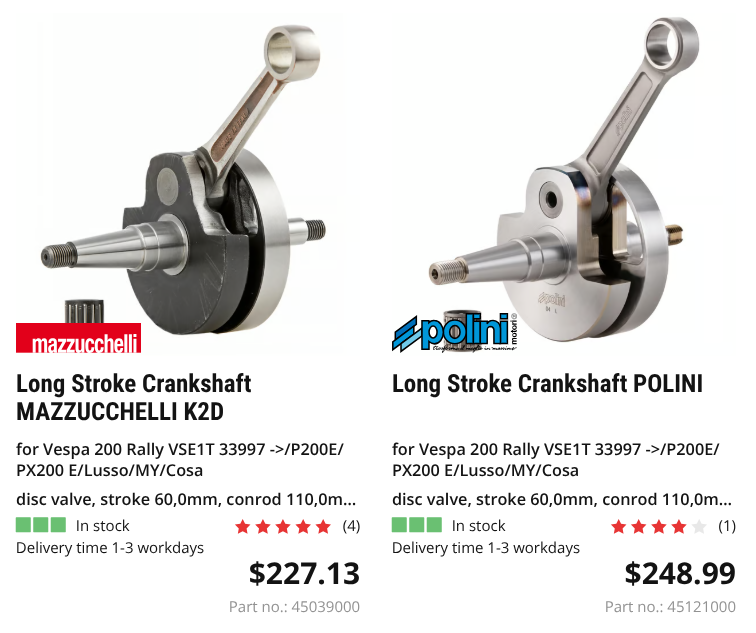

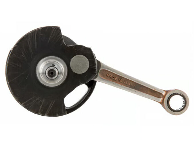

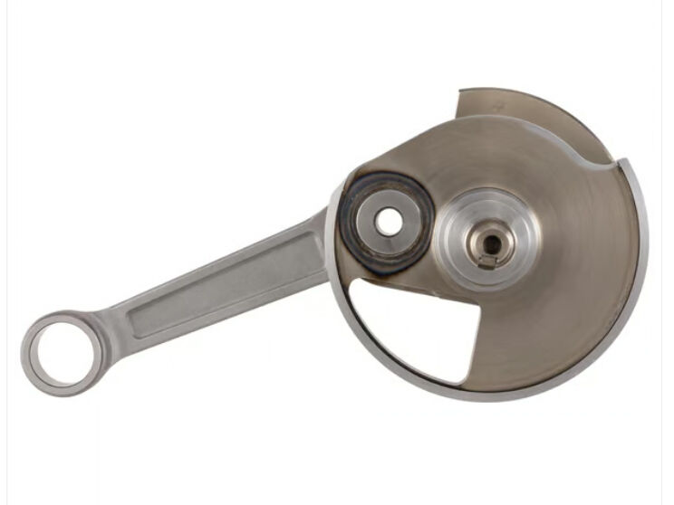

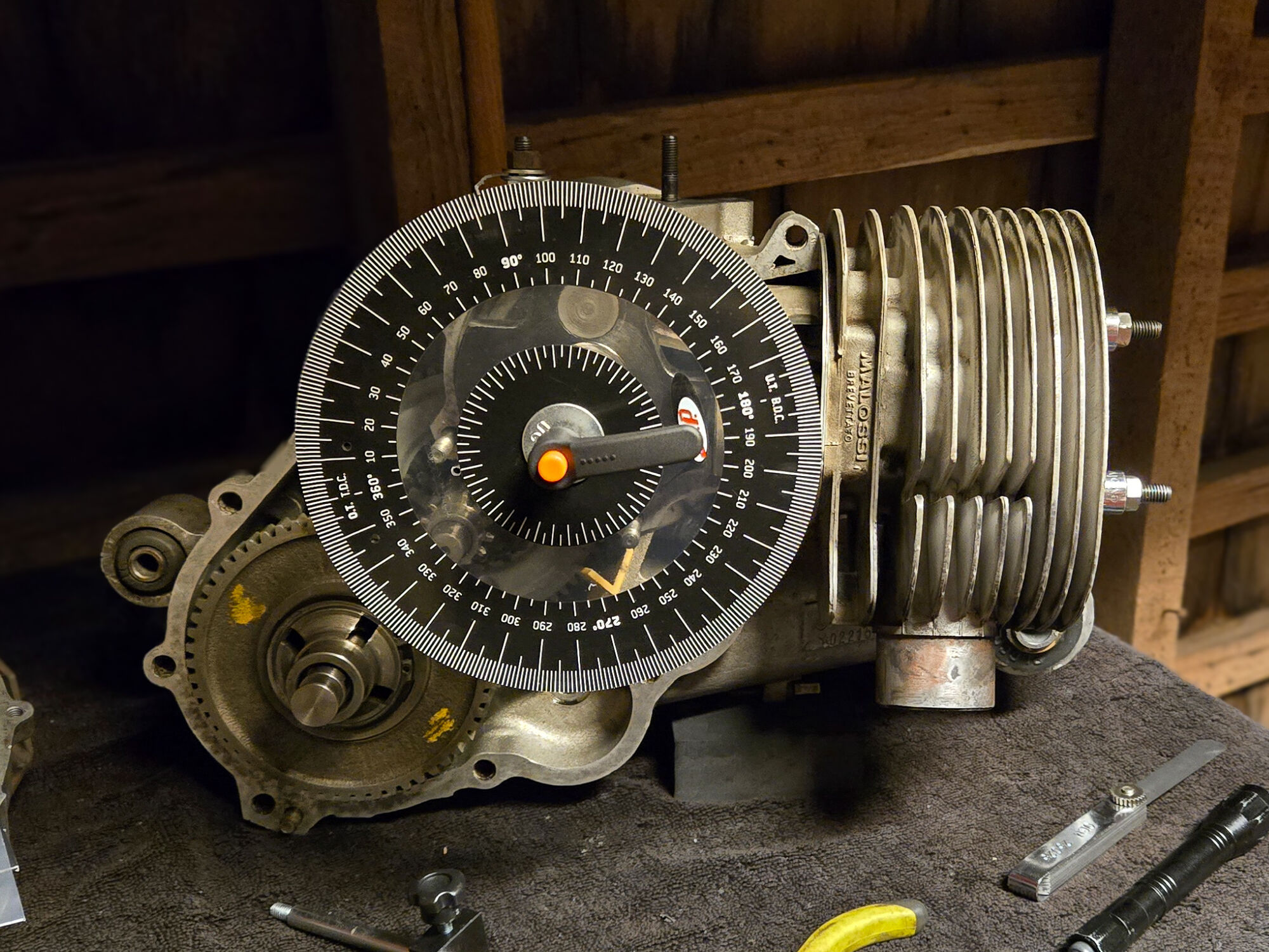

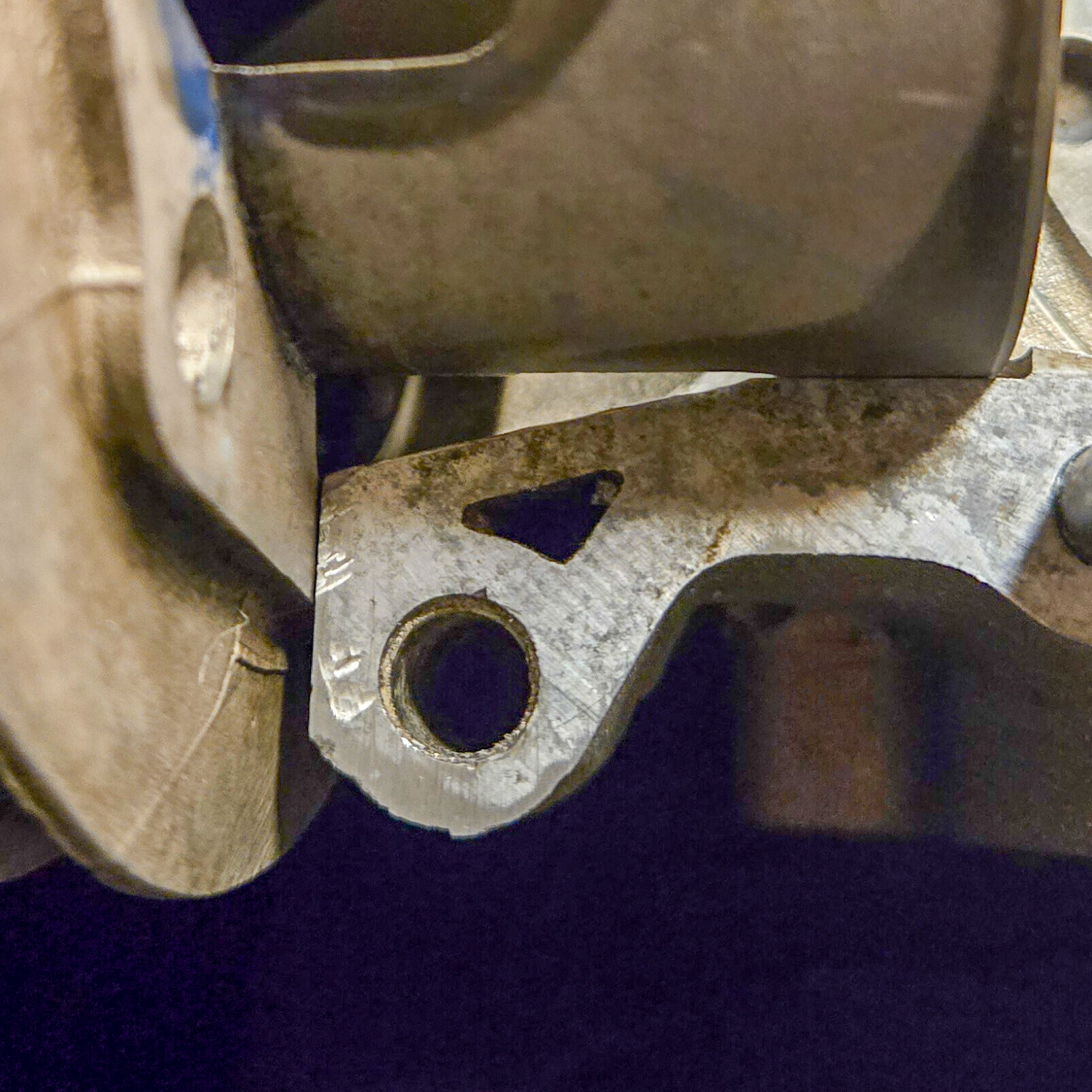

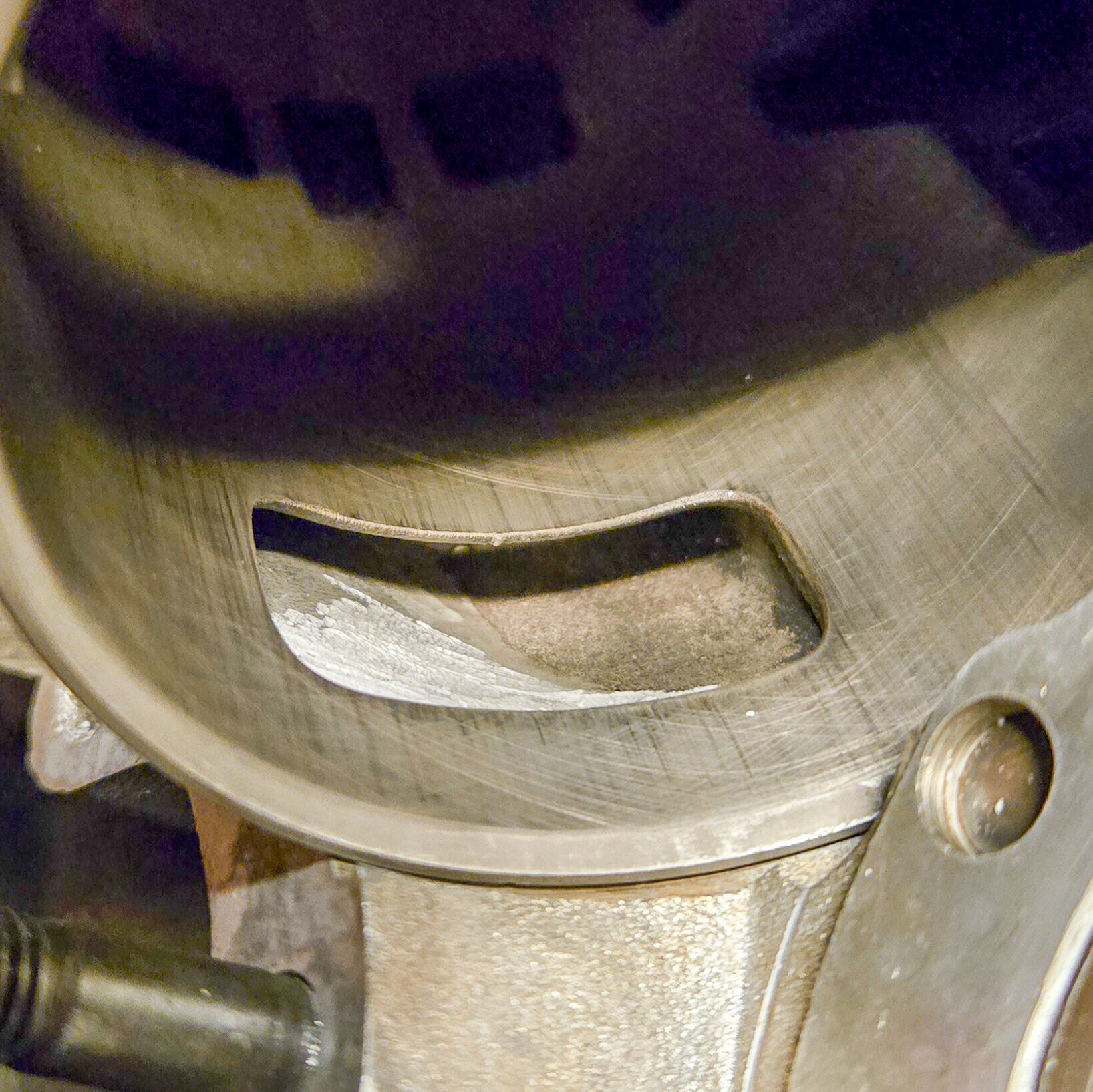

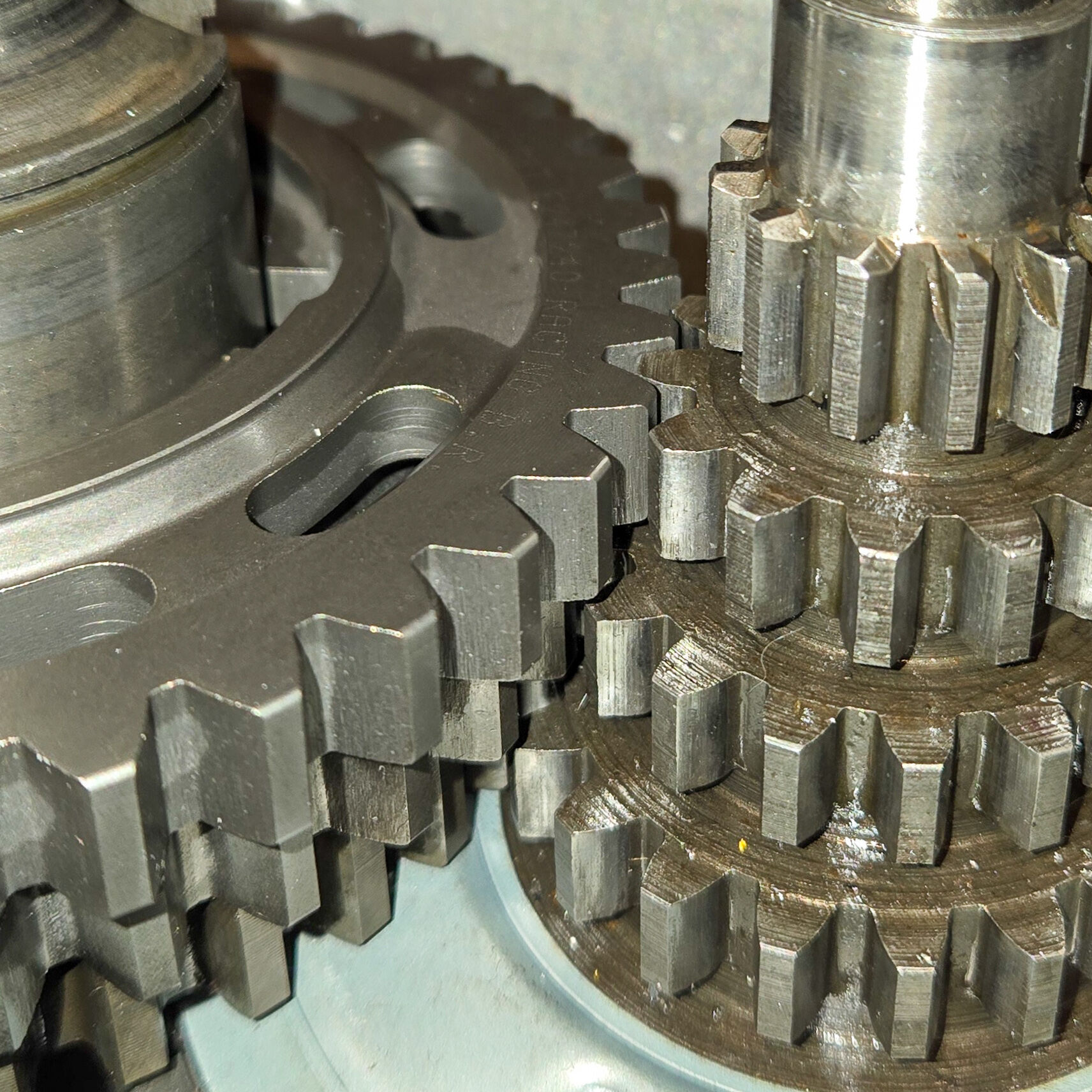

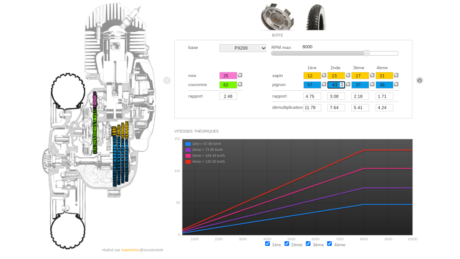

all that without going to a 22-23/65 is leaving power on the table. This also would be an excellent time to go with a crankshaft with a small end needle bearing. i would not run this setup with the bronze bushing.
@bajarob avatar
Posts: 2175
Location: Ventura, CA
@bajarob avatar
Posts: 2175
I second ditching the bushing and getting a crank with a bearing. Easier now than a little later.

Cut 57 and 65T ordered
