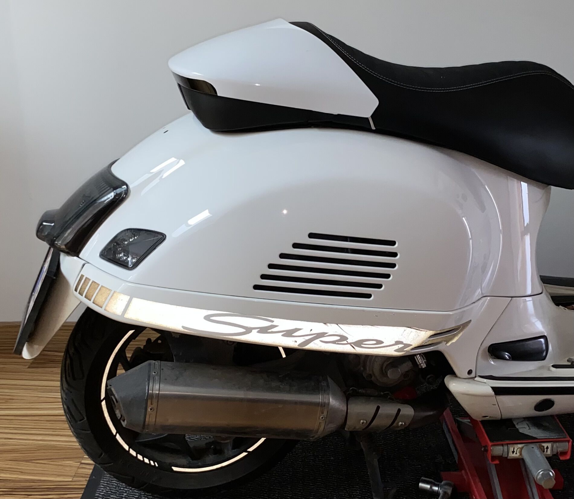

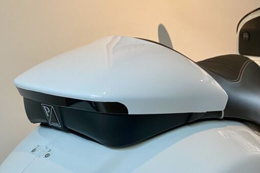

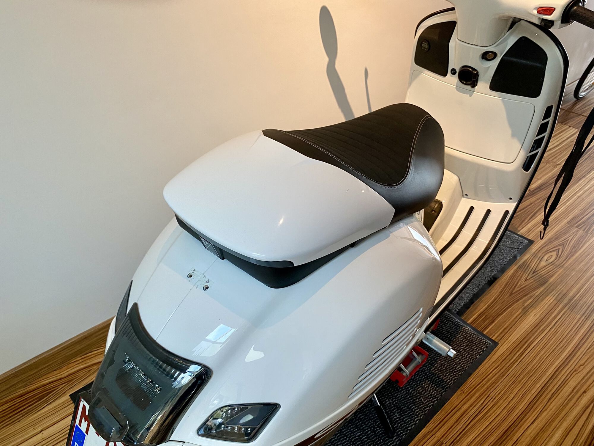

I did it a while ago...
I placed a post 2014 GTV foam & cover on my pre-2014 base plate and fitted the rear seat cover.
@abner_bjorn avatar
Posts: 1659
Location: Denver
@abner_bjorn avatar
Posts: 1659
Location: Denver
Well done. That looks great. What color is the super vinyl without camera flash?
@progetto_300 avatar
2010 GTS 300 SUPER
Posts: 1542
2010 GTS 300 SUPER
Posts: 1542
Reflective gloss black.
Gloss white reflective on the rims.
