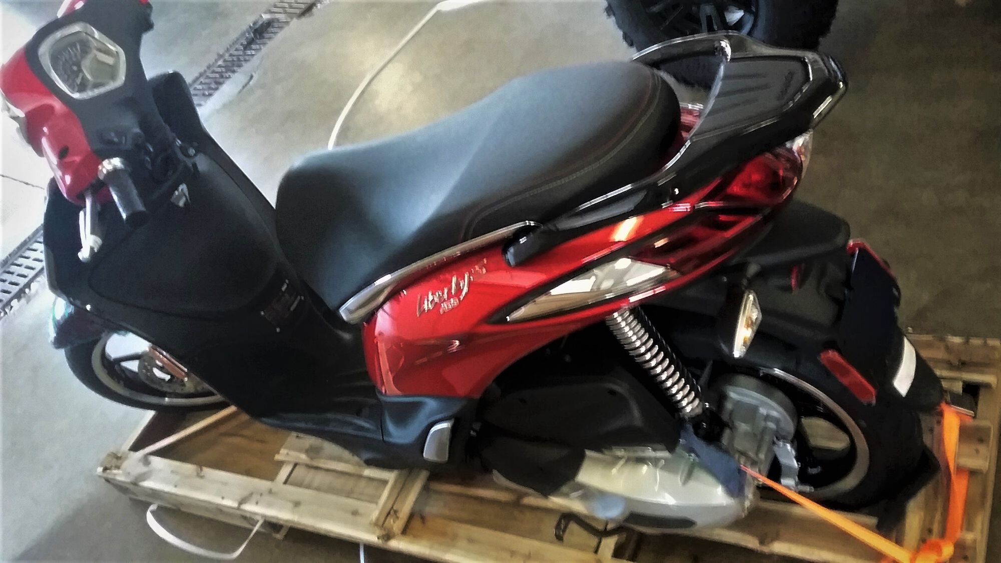

Better all the way around, acceleration off the line, roll on acceleration, top speed. I also added an Akrapovic exhaust and a Q-36 Space Modulator, I mean the emulator thingy, at the same time so there is that.
The next step is big bore kit but still on the fence about that. It runs great the way it is but have no data on how it is holding up and have yet to check the plug for color to see if it may be to lean with.
It is a very nice setup. Easily keeps up with small motorcycles in similar around town driving. Not something I would want to take on the freeway for any length of time but certainly short blasts are doable.
I am thinking a similar modified Vespa Sprint or Primavera would behave also very similar. Pipe and variator and Bob's you're uncle!
