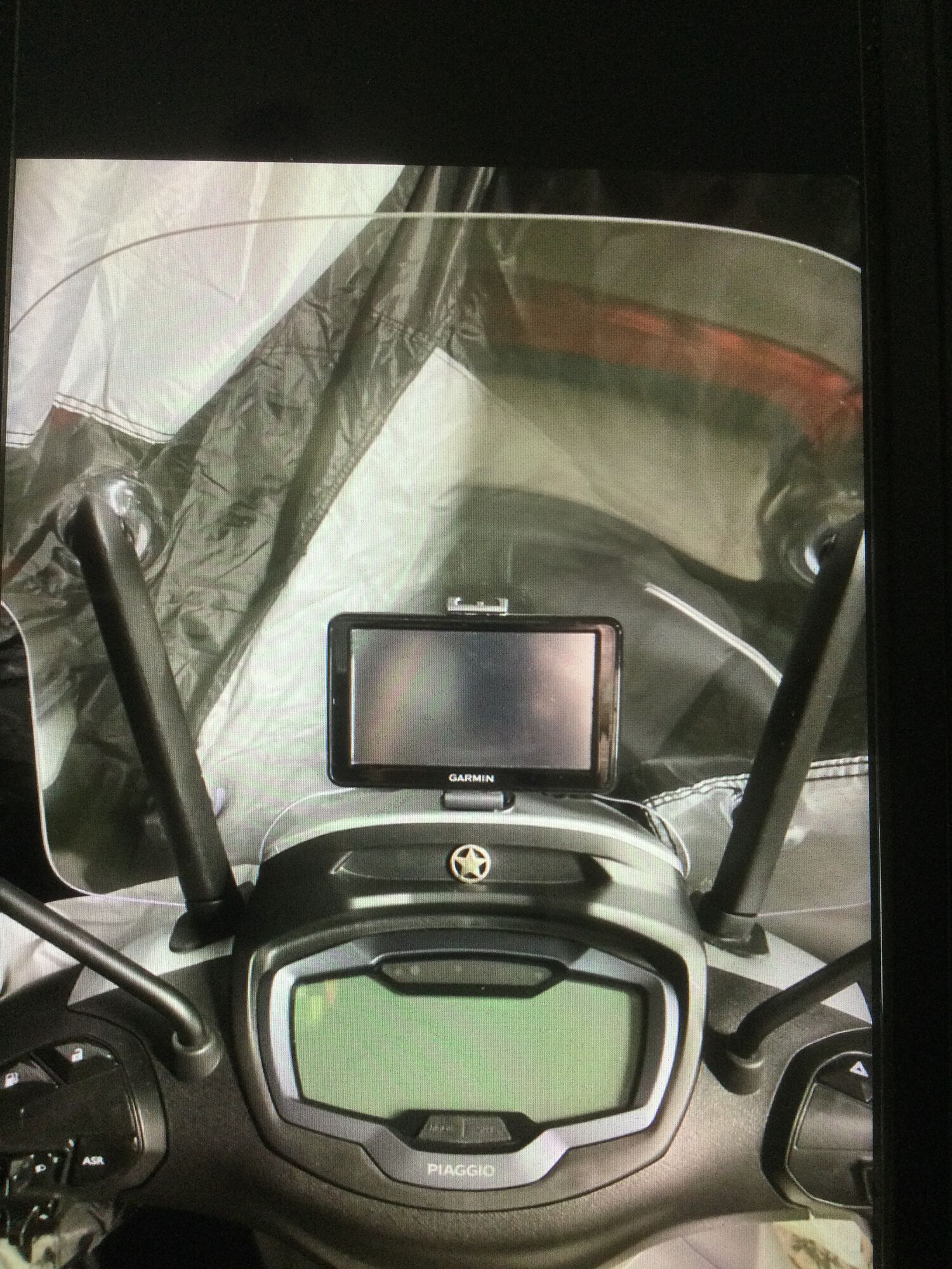

I put mine here.
Garmin GPS mounted on my BV 400

kawzak wrote:
I put mine here.
Please show the details! I want to do this. I have a short windscreen, and this layout makes so much sense.
Do the current Nav units reqire the power cord as an antenna like my older unit does? (Garmin NUVI)

I'll have to look up the clamp type mount I used that holds the Garmin unit. The base has a 1/4-20 tapped screw hole. See that star blow the unit on my dash ? That is where I held the SHCS in place w/ Allen wrench. The base also has mounting tape to reduce vibration. The screw going up through the mount. The clamp w/ Garmin then slides on and is held in place.
