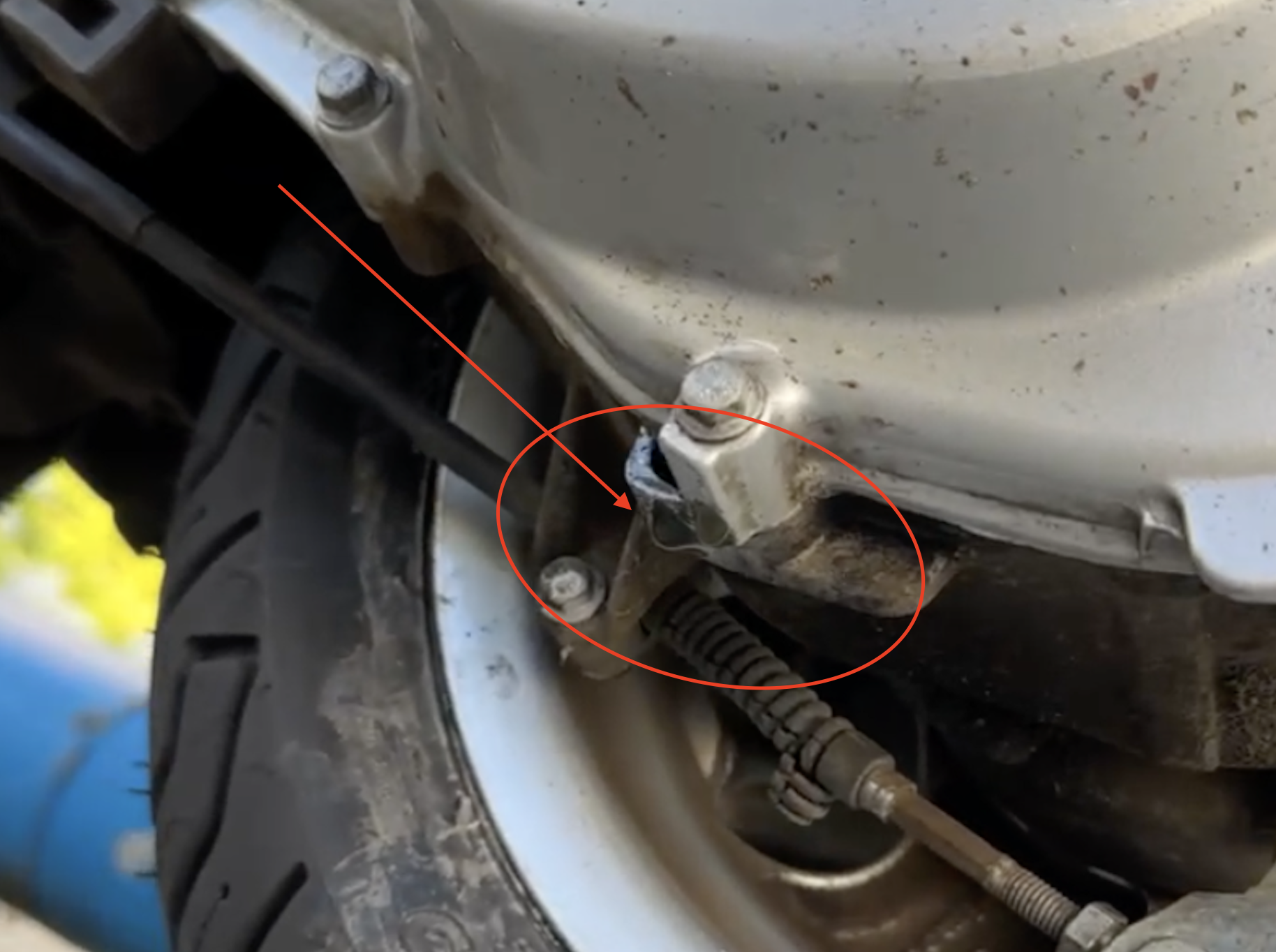

I reviewed the link you sent, and I can clearly see on the scooter where the leak is originating. I've attached a screenshot here from my video to show this more clearly. My drip source seems to be directly under the transmission case, and as I saw in the other ET2 thread, the drain bolt seems to be closer inwards on the side towards the rear wheel.
Any further ideas here what could be leaking?

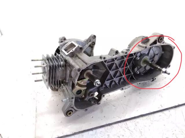

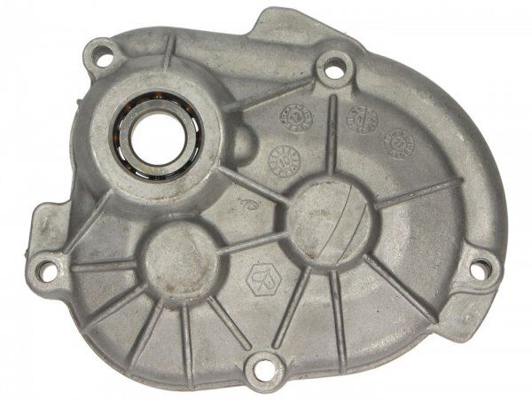

That looks like it's coming from the gear cover.
If you remove the transmission cover, then take the clutch off there is a cover (like picture below).
Thx, I need to order some tools to see if I can get in there. Many moons ago I had a Yamaha Zuma 50cc where I did some work myself with different variation weights etc. So maybe I can actually find what's leaking int here.

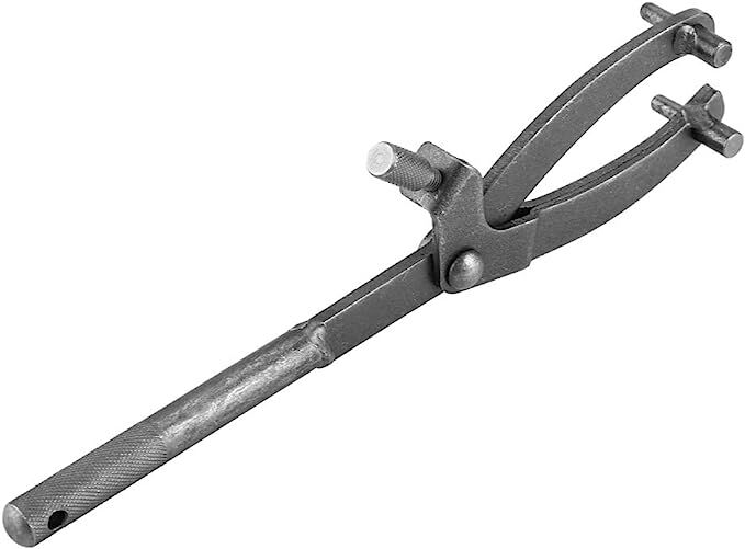

I've not had to take the gear cover off but there must be some videos on YouTube as it's common for people to change the gearing.
To get the clutch off is quite easy, you just need a socket set and a tool like the one below (cheap from Amazon/Temu) to hold it while you undo the nut.
Many moons ago I had a Yamaha Zuma 50cc 2 Stroke where I removed the transmission cover often to play around with different variator weights. As far as I can remember, there shouldn't actually be oil floating around in there though right?
I really wonder where it's coming from Crying or Very sad emoticon
