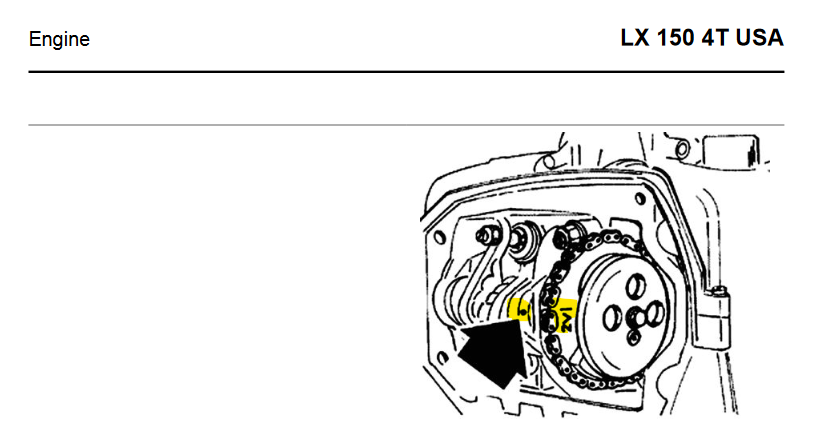

So I took apart my LX 150, broke it down redid everything. It is a 2V and I thought I got it correct but now it sounds like it's 180 out how in the world do I time this thing?

There's a workshop manual here: https://manuals.wotmeworry.org.uk/Vespa/LX150/
The Engine section (5) has details on timing marks and setup.
