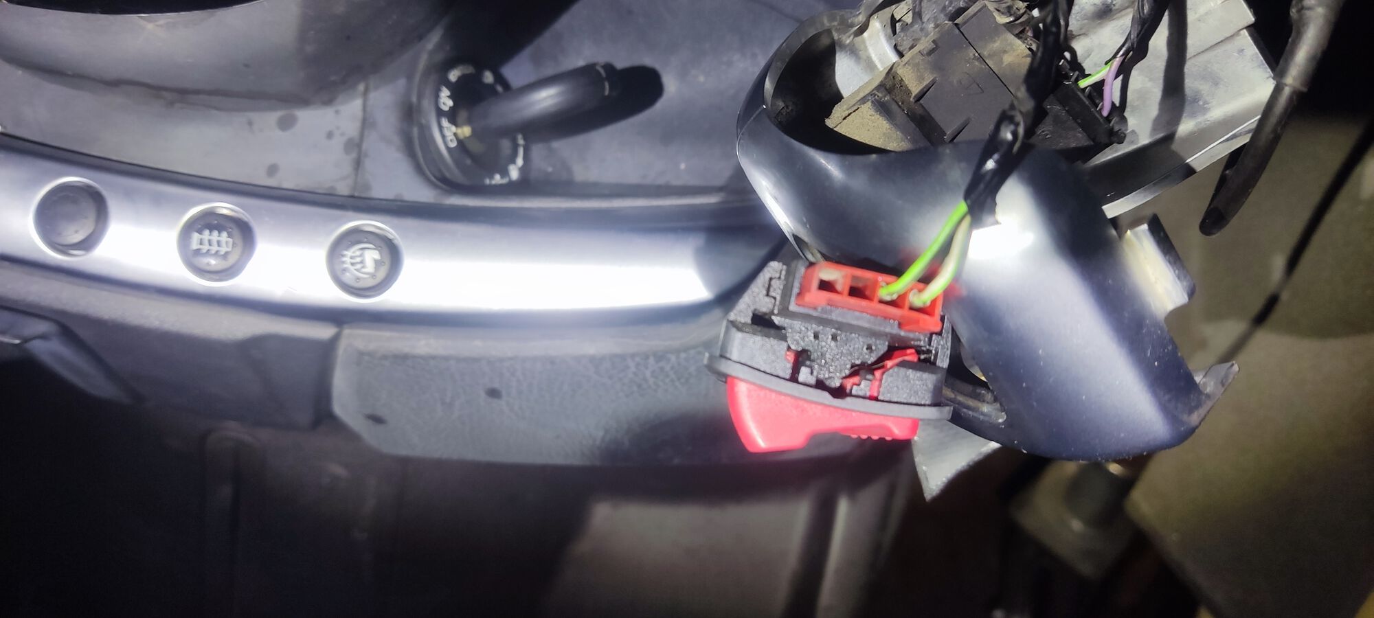

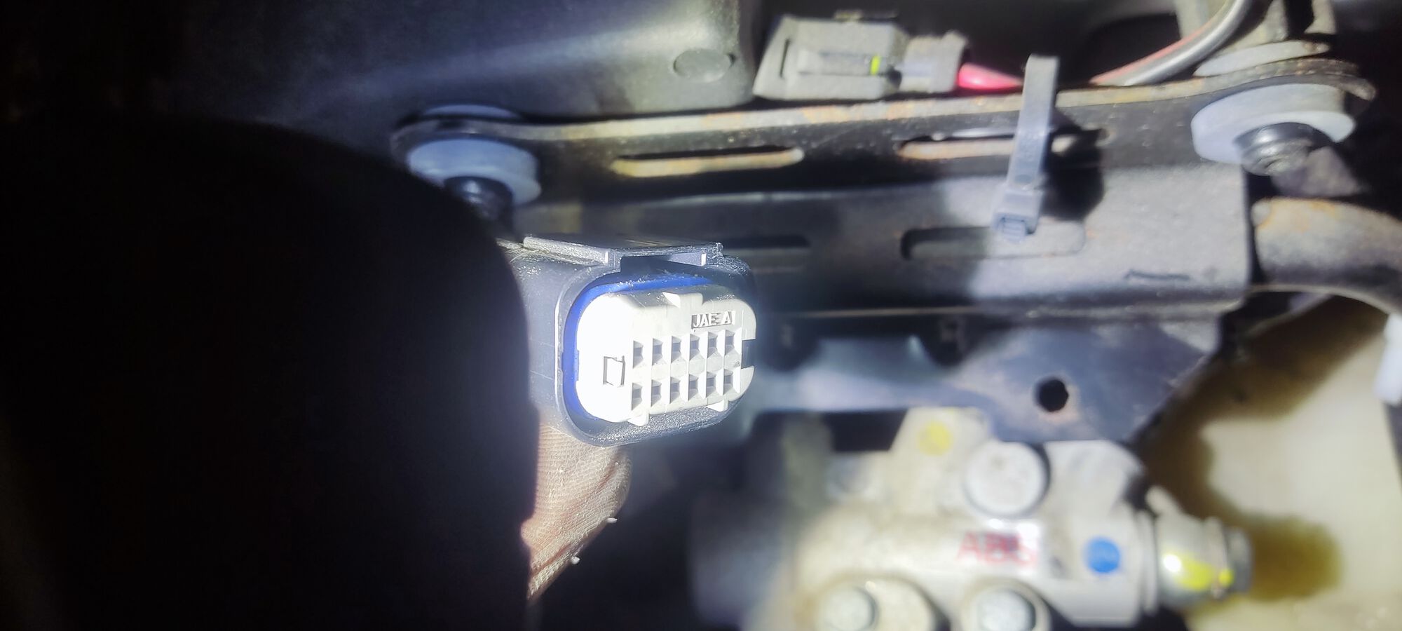

Hello, I show everything in the video. The checked switch is functional!!! Every time I press the brake there is no reaction from the starter. The red emergency stop LED lights up continuously. The scooter had an alarm installed, but someone cut the wires. After removing the plastic at the front, I have a plug like the one shown in the video, what is it for?
I unscrewed the tilt and fall sensor and moved it. Nothing has changed. I can drink the fall sensor and nothing changes?

First place to check is the starter relay and integrated fuse
The red cutoff switch should always be left in the run position under normal conditions

Faulty kill switch possibly

the emergency stop switch works. I translated from another mp3. It's still an error

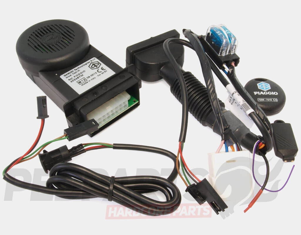

I bought the motorcycle from the company, I have an invoice and documents. Two keys and a remote control for the alarm. Someone cut the alarm cables. I see that the wires are routed to the throttle, the plug is connected to it.
I have an alarm as shown in the picture. It's possible that someone connected it and cut off this key?

Does anyone have an electrical diagram for the Piaggio MP3 500 2015 year Sport.
Where do these two wires from this key go?

Maybe I'm missing something here? What plugin is this? The front of the scooter under the plastic.
That plug is for the optional PMP module (accessory).
You do not need this module to make the bike run.
FWIW, I have the exact same alarm system. And just as with the PMP module, the alarm module is a optional accessory and is not required to be present to make the bike run.
Take a pic of these cut wires you are referring to.

On the emergency shut-off switch, press the bottom of the switch on the run side of the rocker and see if the normal start sequence will work
