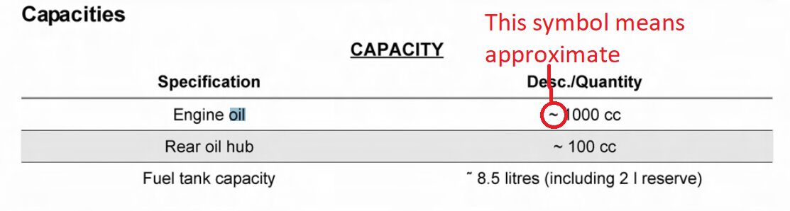

The manual states 1,000cc for the 2008 LX150.
After changing the oil and filter for the first time, The oil is in the middle of the hash marks
Just curious. is that correct?

Double check the information in the manual. I only have the 2009 version to hand, which states 1100 ml as the filling quantity.

Here is something interesting.
The owners manual (Vespa LX125 150 Euro 3) says 1,100cc, but the shop manual (LX150 4T USA) states 1,000cc

Trust the dipstick. Don't count the milliliters
Posts: 11699
Posts: 11699
1L is correct when doing the filter too.

Engine and filter, took 36oz top of hash mark. This is 1oz shy of 1,100 cc
