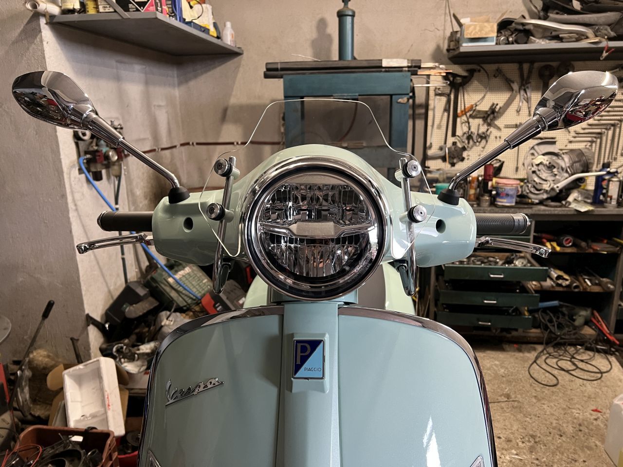

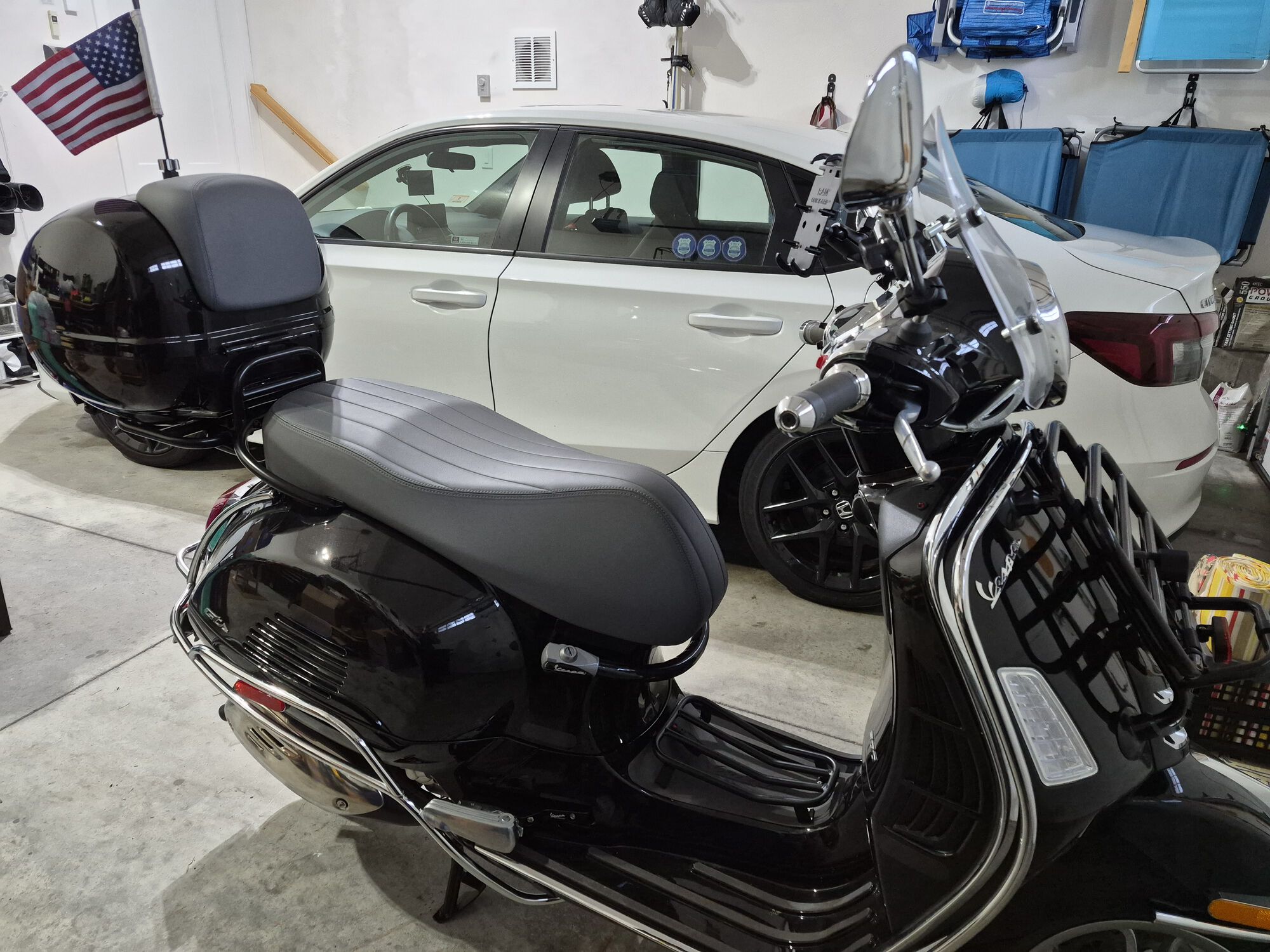

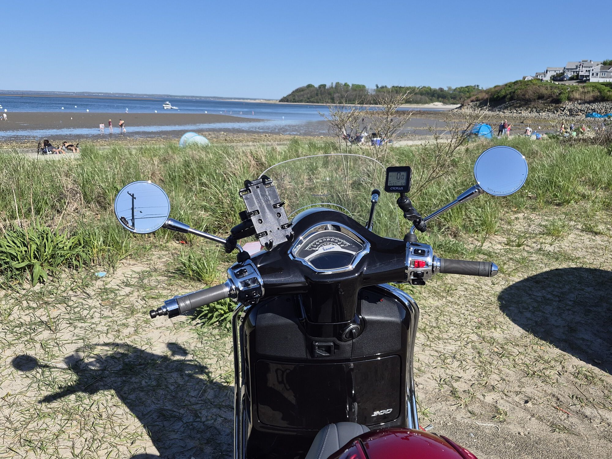

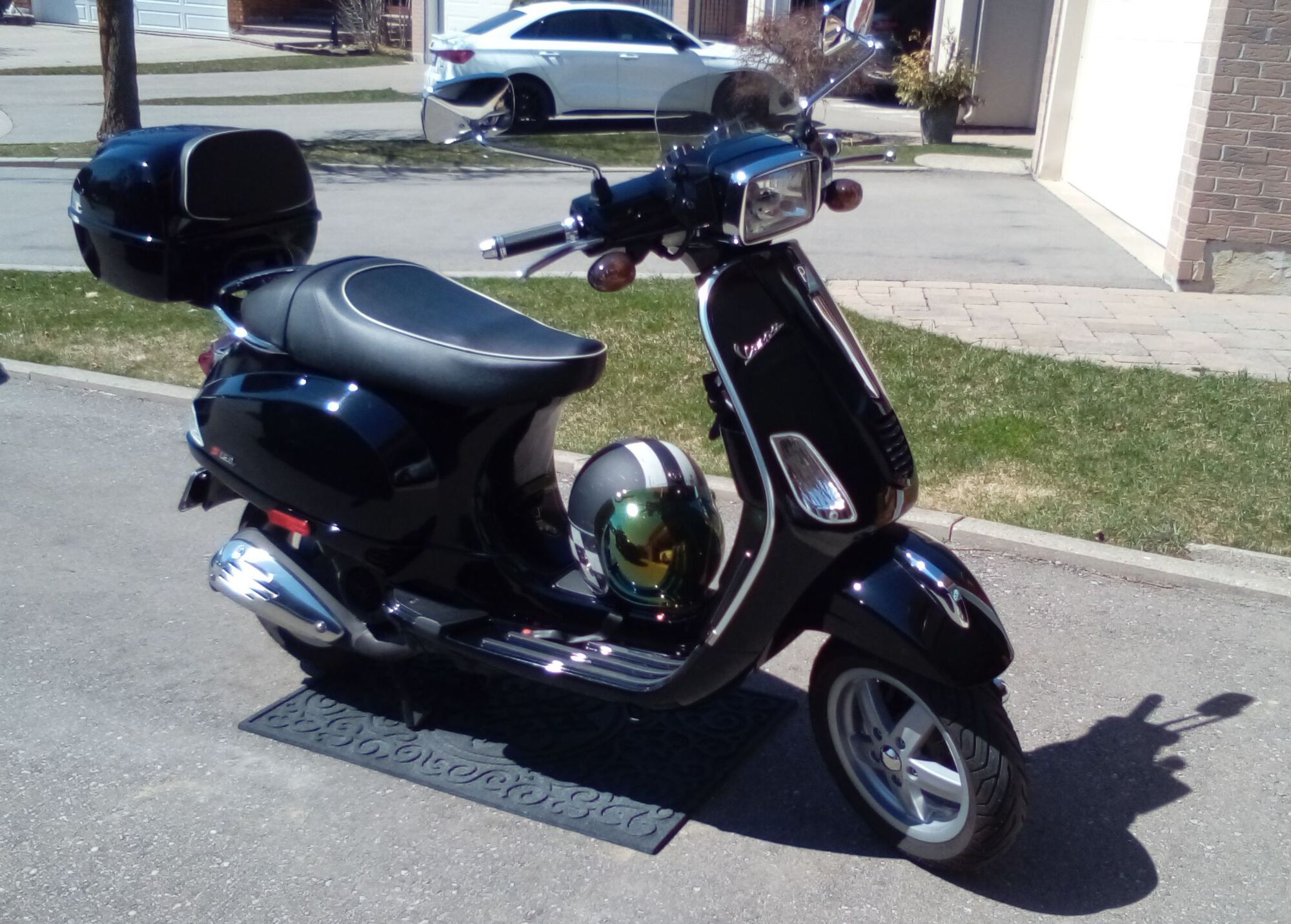

Is there an existing thread for stuff people have done to their Vespa's? I'm talking about minor mods, accessories added on, etc.
Nothing too heavy or detailed.
For example.....Today I installed a tinted mini fly-screen.
It was brisk this am (14*C) and my eyes did not water like usual. The wind noise was still up around my ears but it's to be expected because I wear a Crazy Al's half ("beanie")helmet.
With the cooler weather approaching I'll be wearing ear plugs and/or going with the full-face.....

Looks more like a mosquito screen to me.

flybynight.....I don't know where you're from but here in Canada the mosquitos eat
sparrows as an appetizer

I should have added that I took a chance and ordered it from AliExpress and received it in 7 days!
Looks like OEM and I saved over $200CDN from what the Local Motorcycle shops are asking.
The only negative is there were no instructions. Luckily I have the med-sized windshield that came with the s150(that I refuse to use) to mimic the assembly....

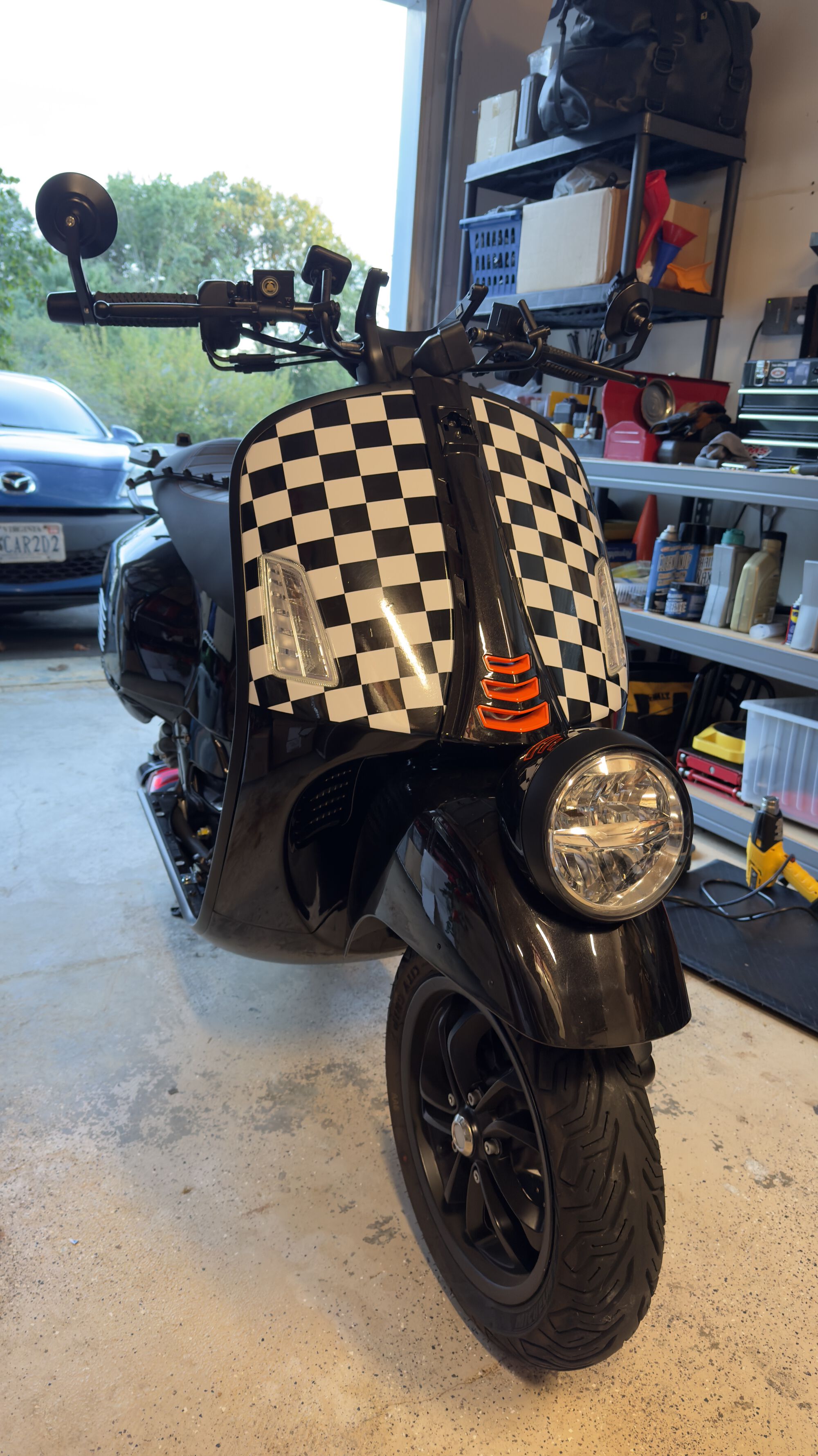

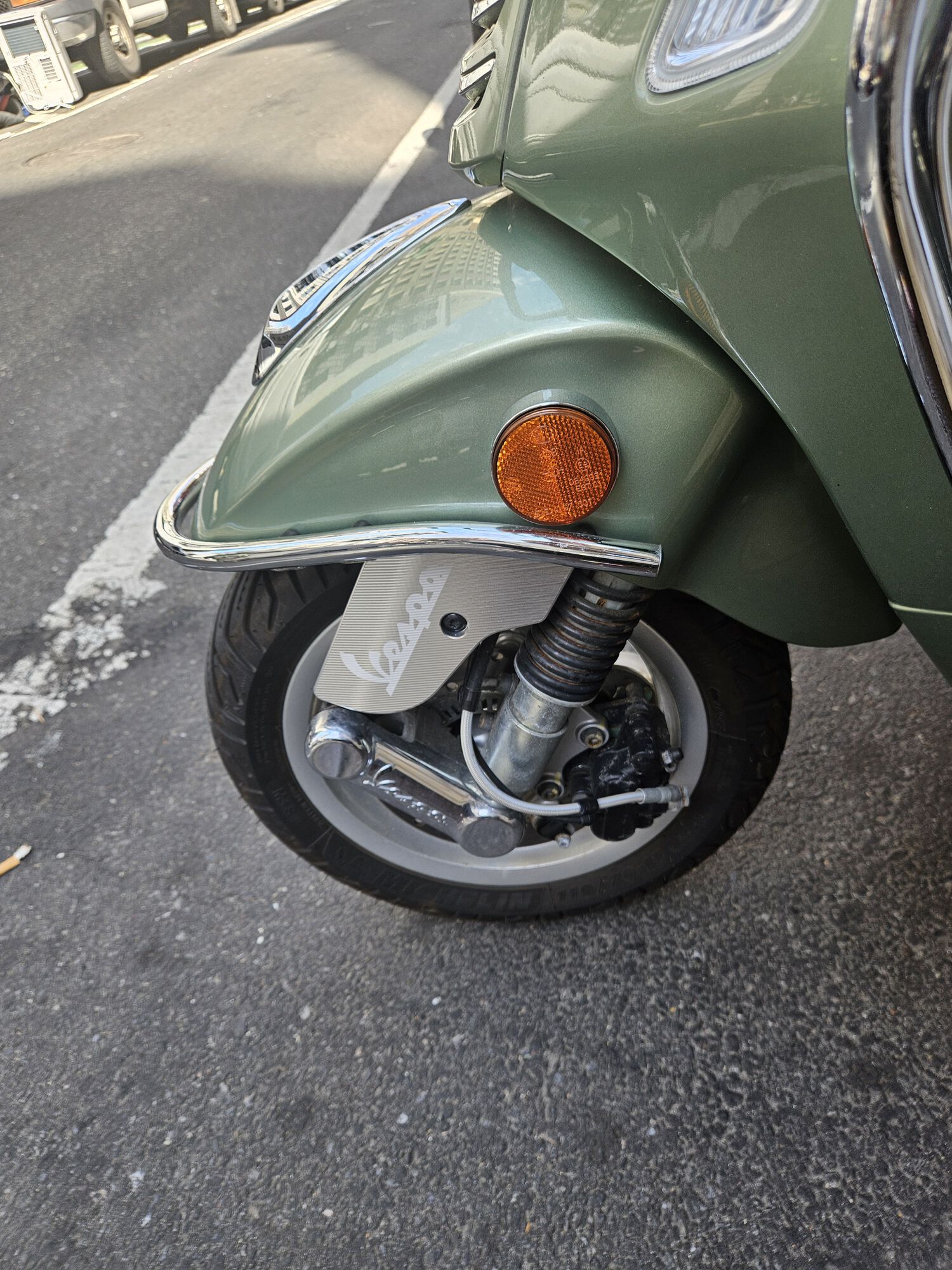

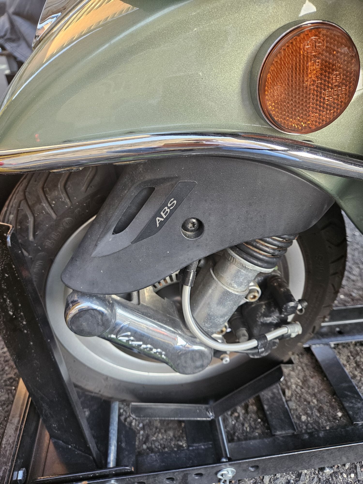

Today I removed those Ugly front fender reflectors......

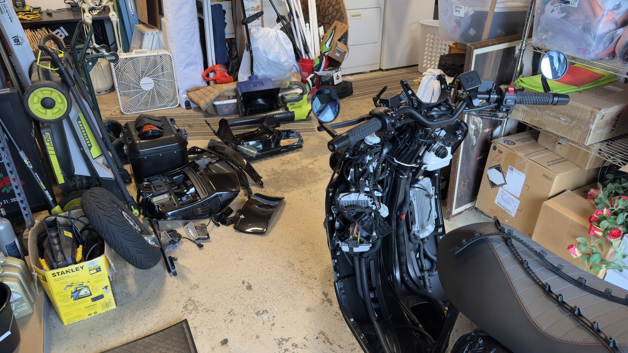

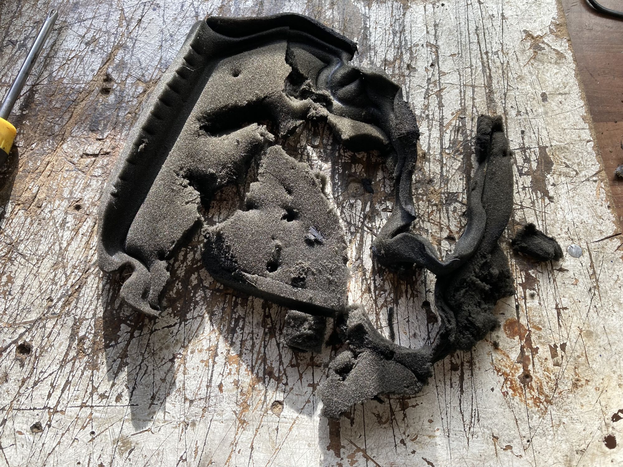

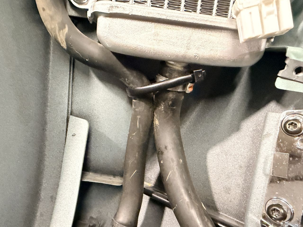

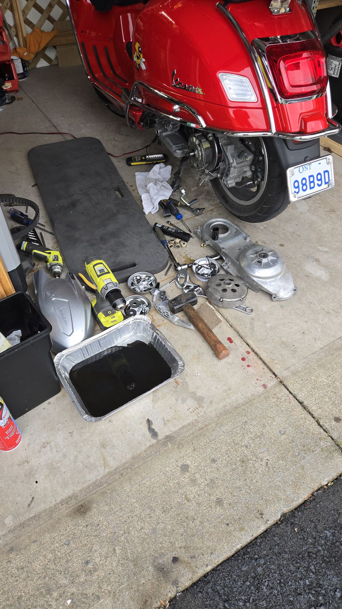

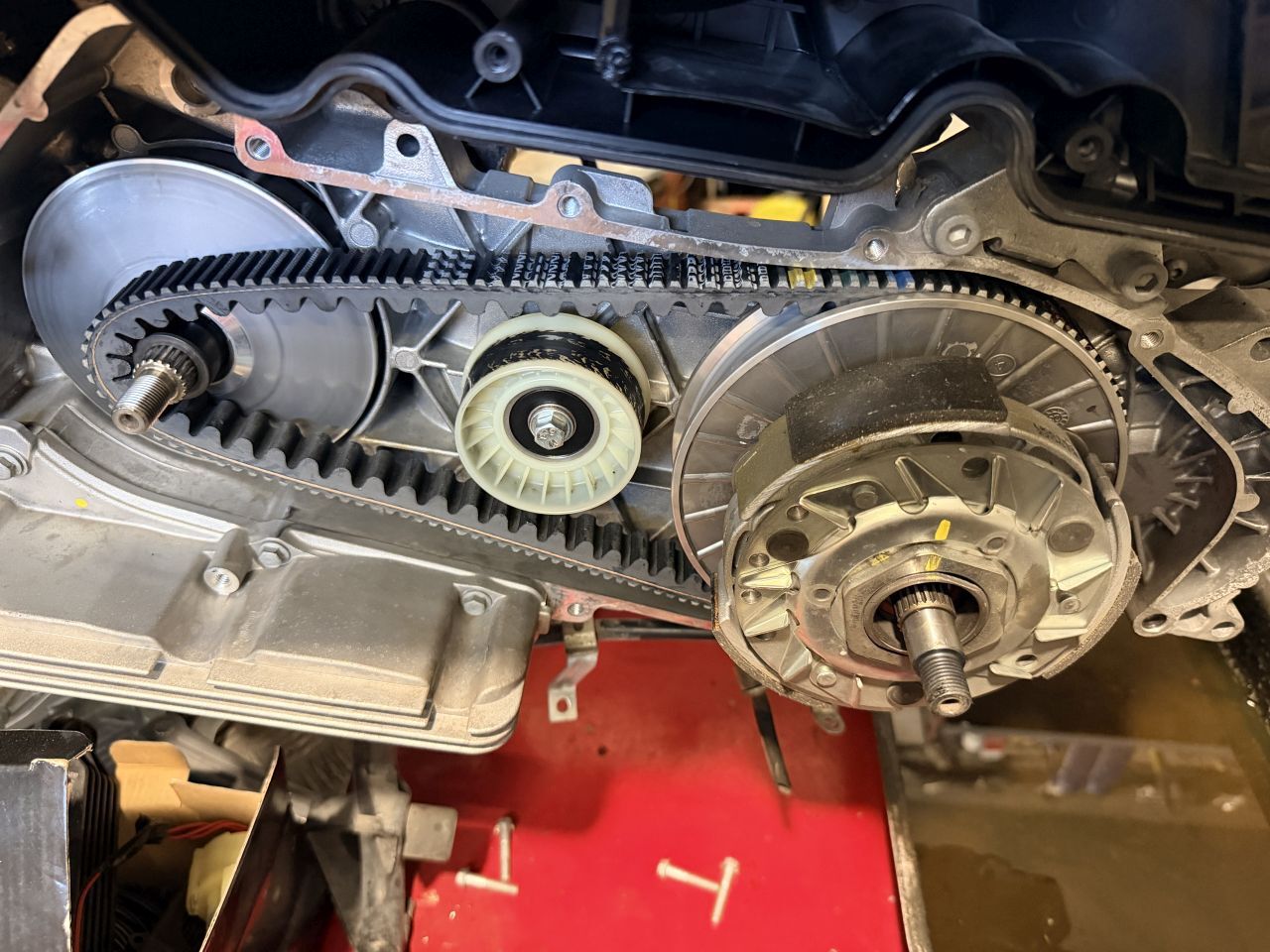

I spent 10.5 hours elbow deep in my Vespa. (18,000 mile service) There was so much yuck...
Tomorrow, I get to see if it worked, or if I killed everything...

All that yuck holds the vespa together, scoot will disintegrate.

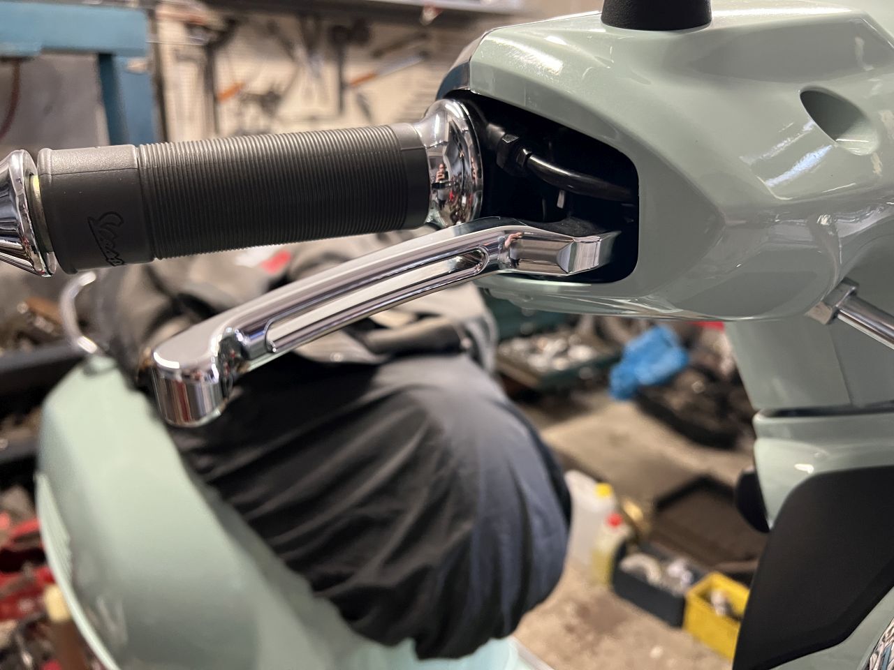

Today I replaced the 15yo OEM rubber grips with a new pair.
They feel a little bit girthier( ) and the "stainless caps" are nicely machined....

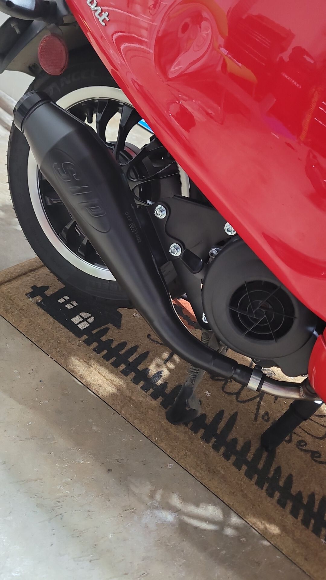

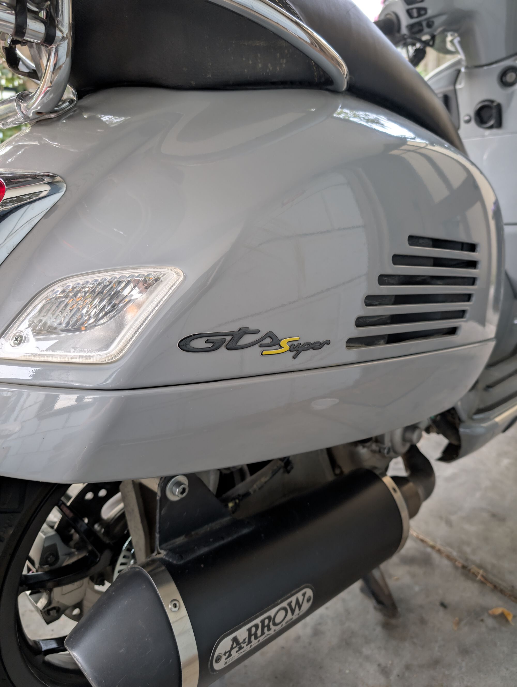

I had this brand new exhaust out on - loving it

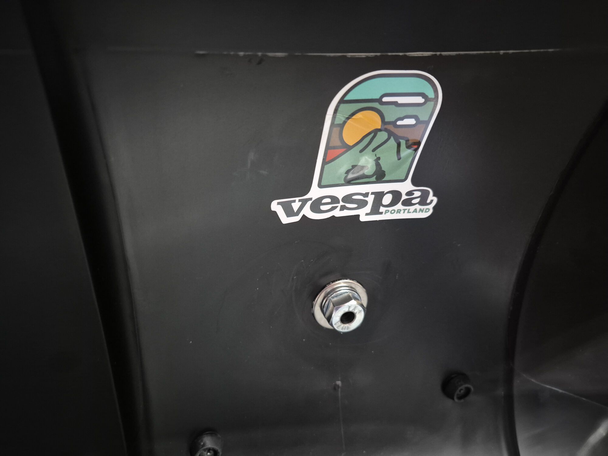

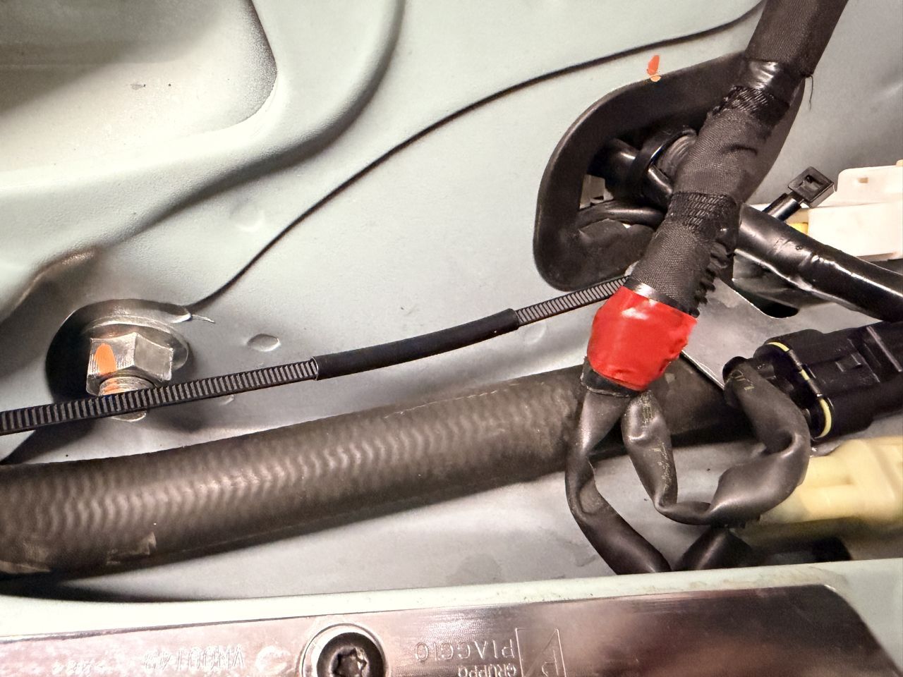

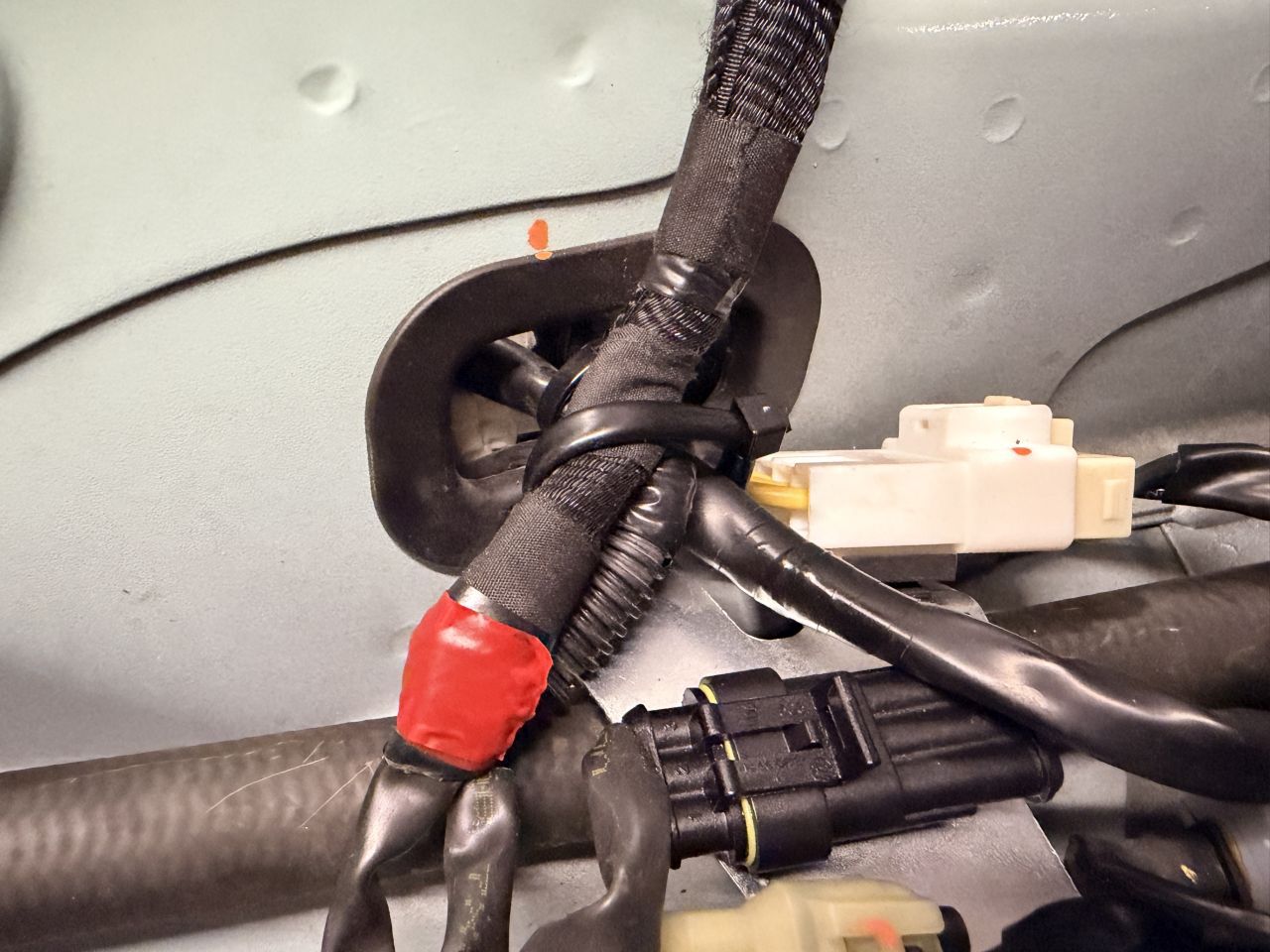

It wasn't Today but I installed the pigtail for the Battery Tender. Managed to find a perfect spot under the Top Rack held by a zip-tie.
It's pretty much hidden....unlike my Buddy's that's hanging out of the battery cover by his feet. Don't know why the Dealership did that but it looks like an umbilical cord on his 300GTS:roll:

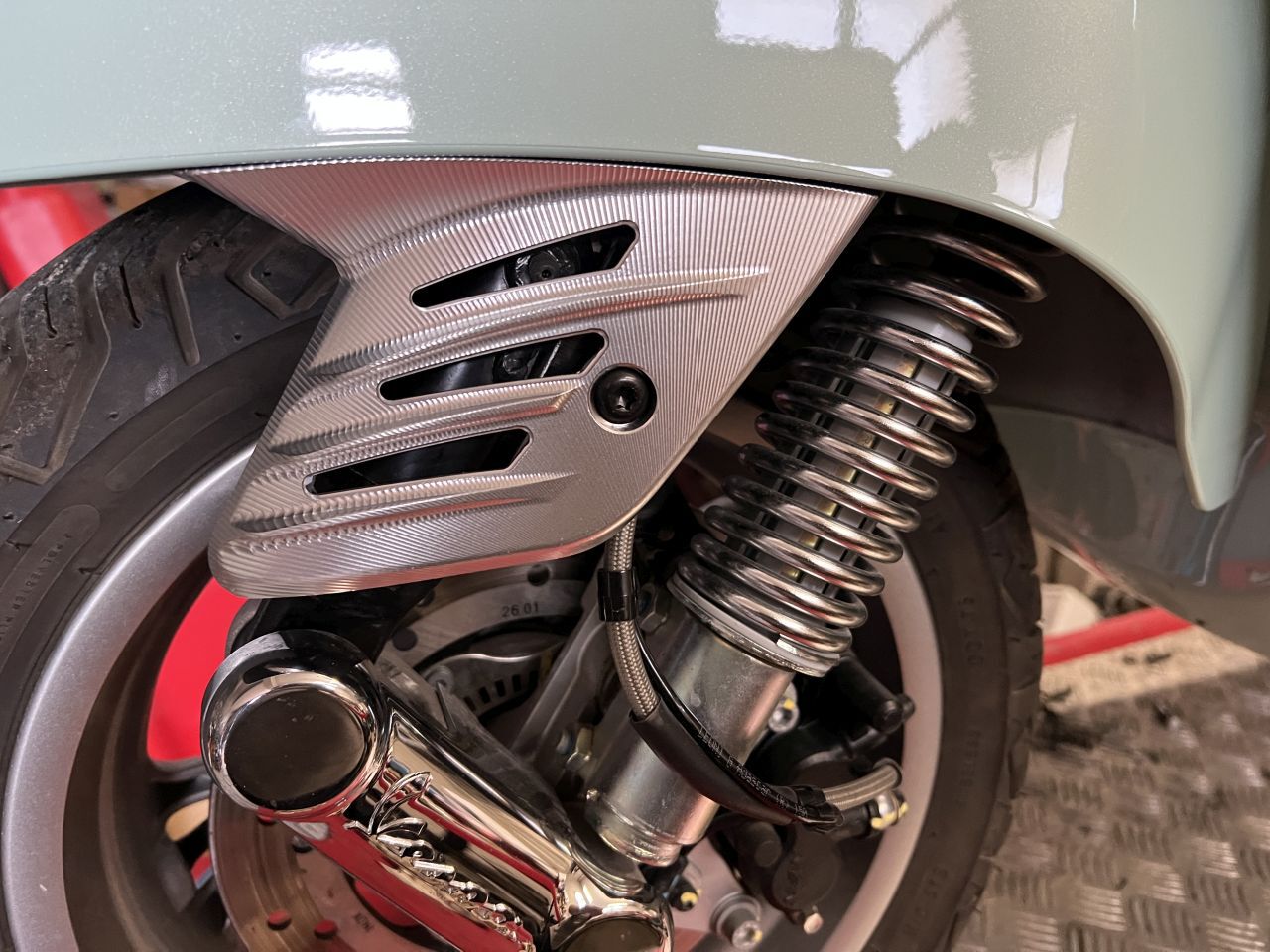

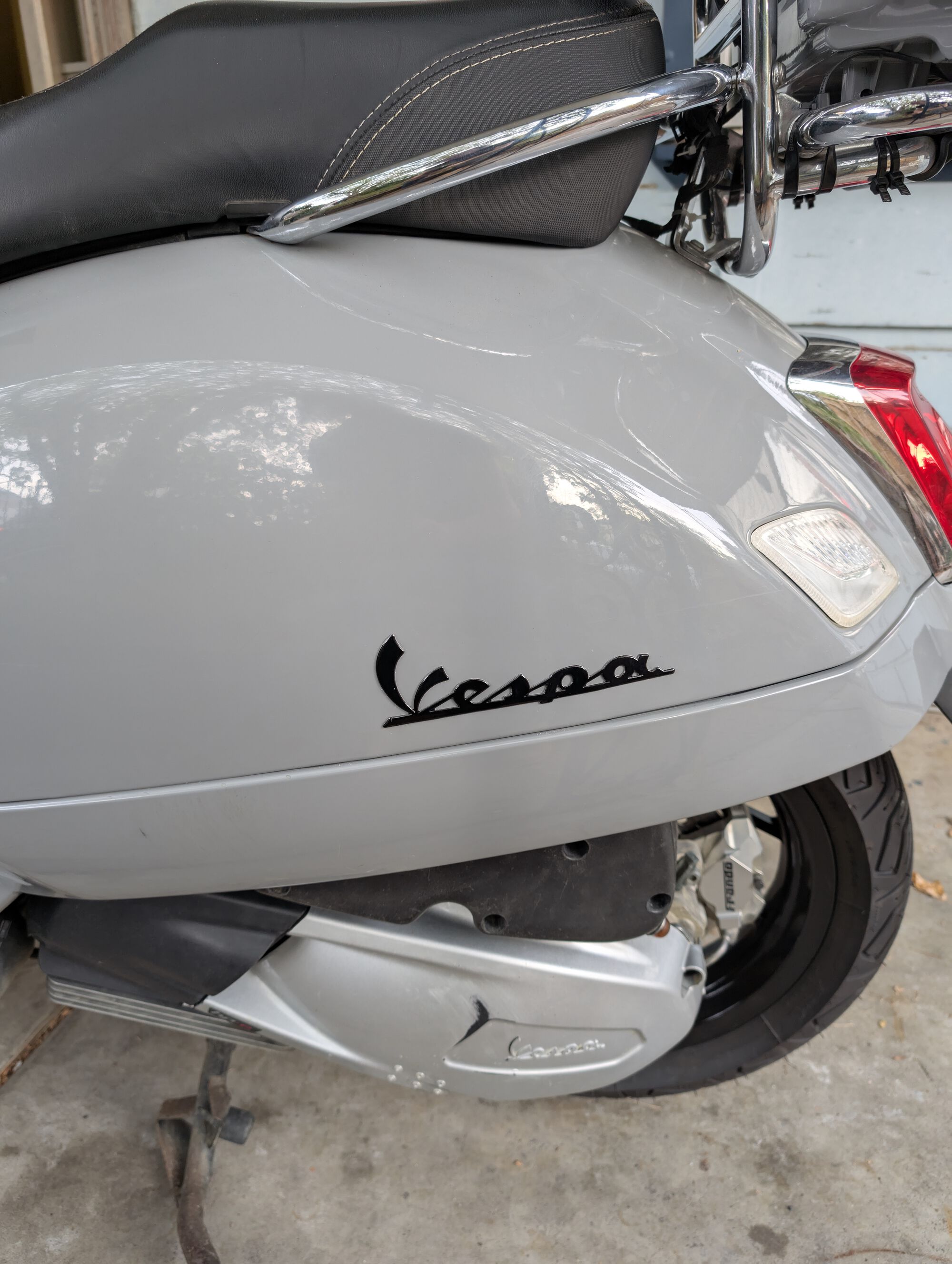

My Buddy painted and clear coated his grey Belt/Drive cover to matte black (forgot to take a pic)
Also, the chrome muffler cover was replaced. AliExpress comes thru again with a quality accessory at a fraction of the cost and delivered quickly (1 week)

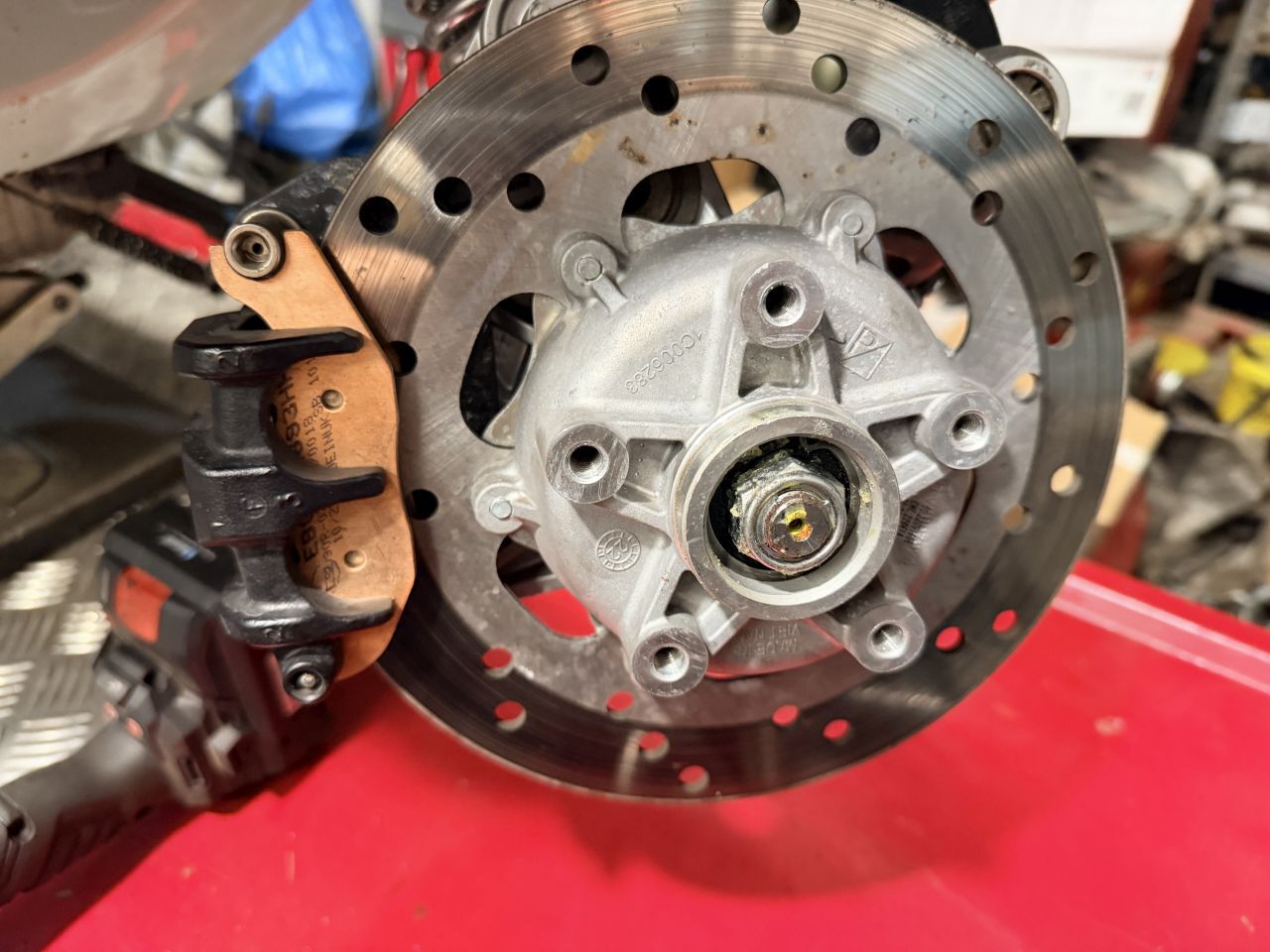

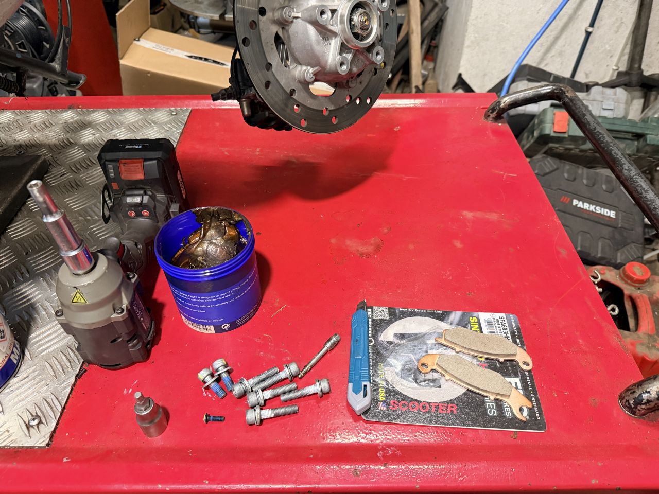

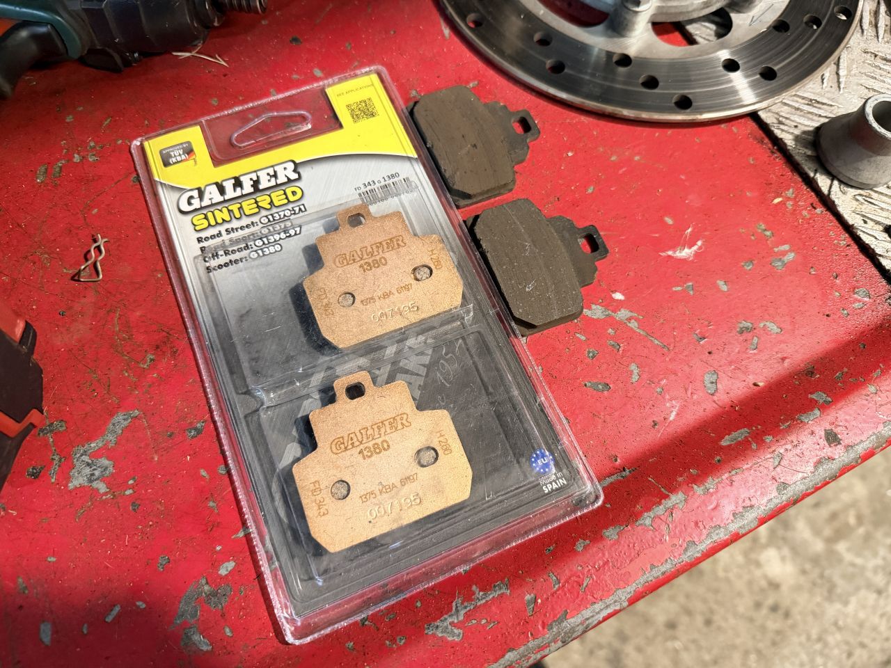

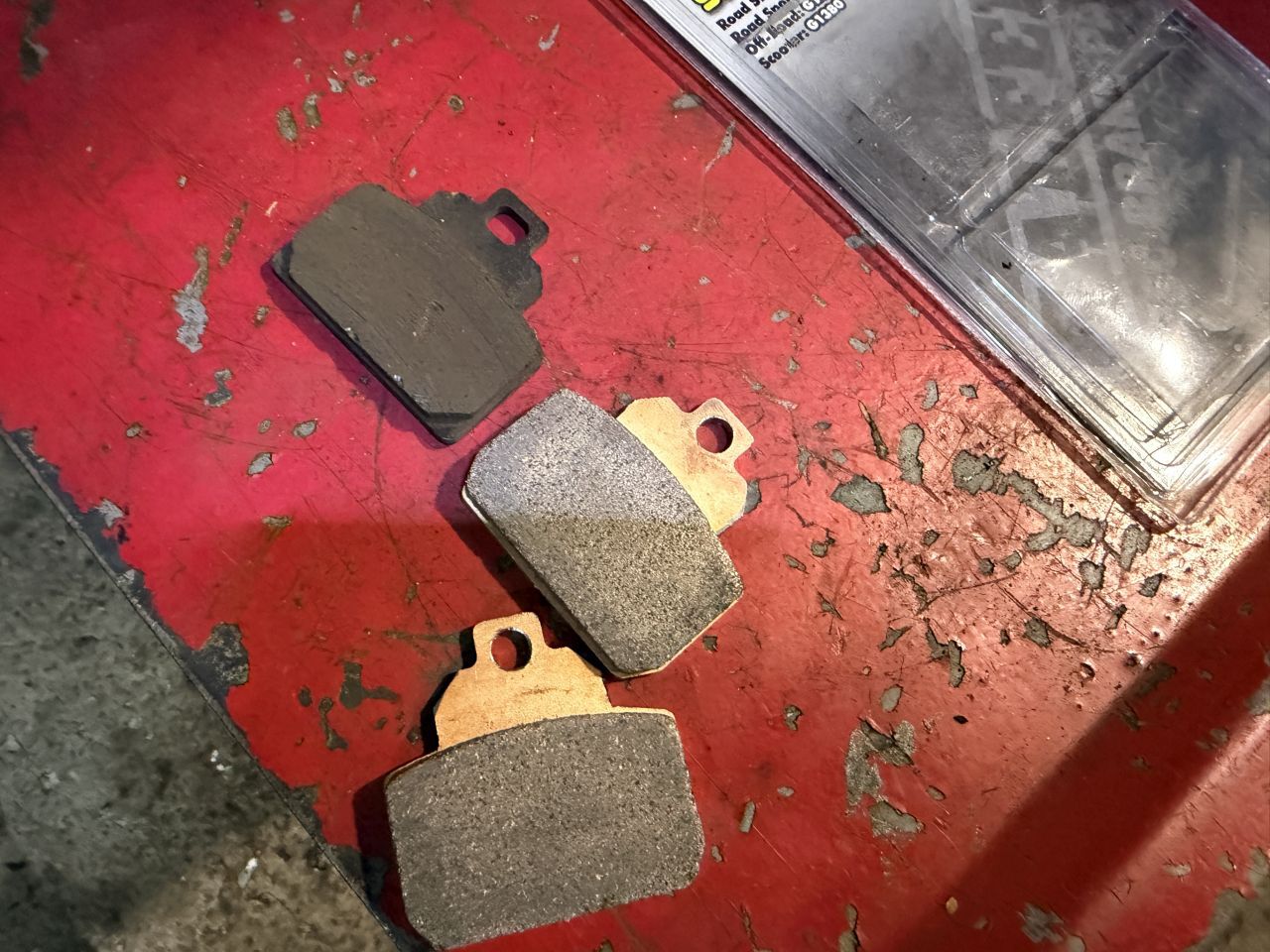

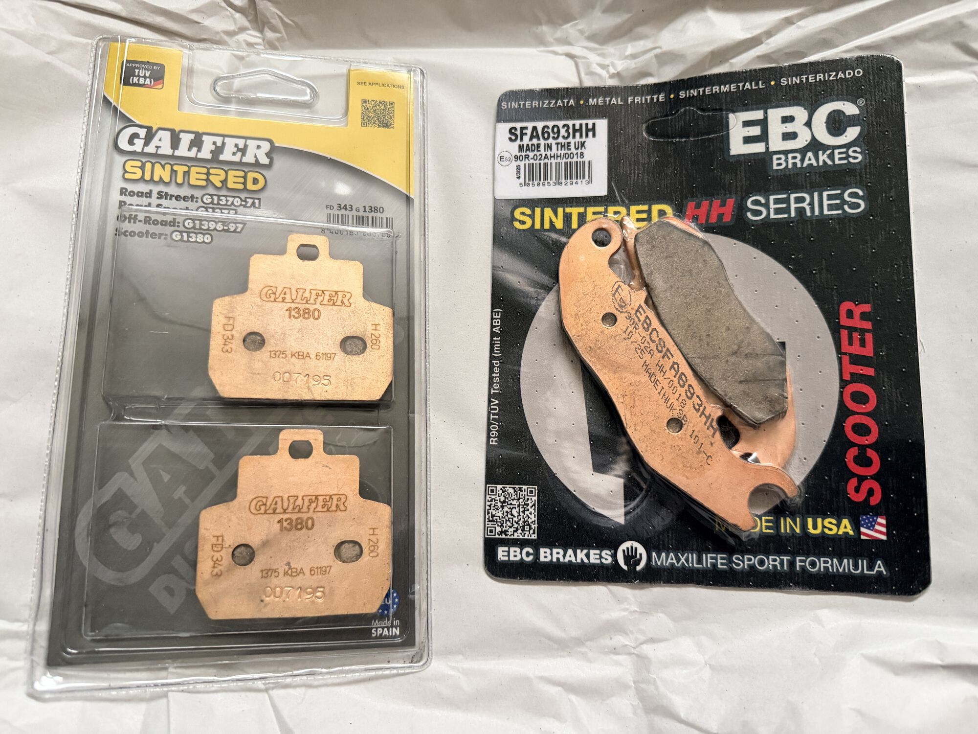

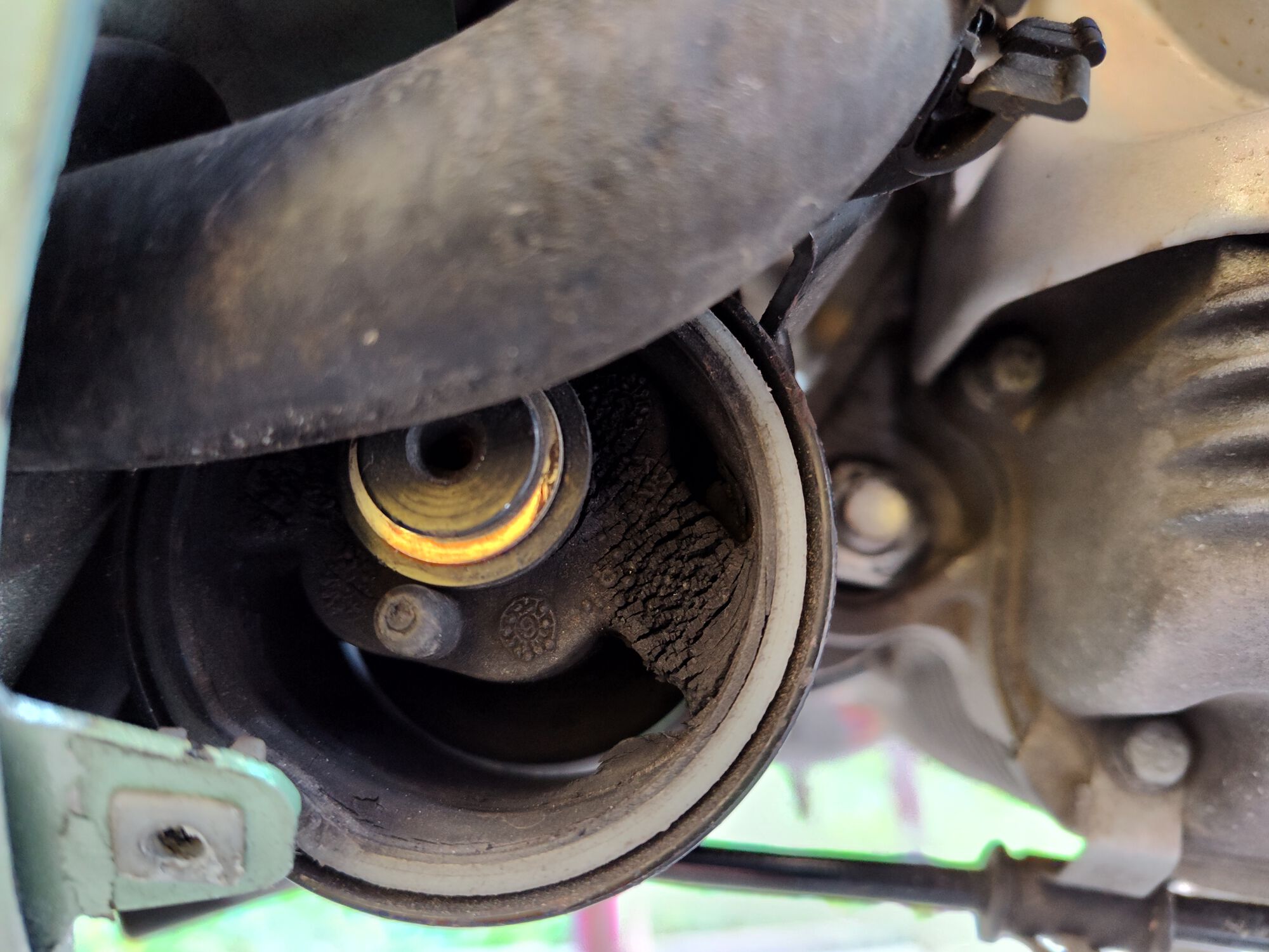

Yesterday I swapped out my front brake pads and flushed the brake fluid. Very dirty! I put in some Motul RBF600 that I already had opened and upgraded the pads to some Malossi gold sintered pads. Turns out the old pads weren't all that worn, but this is my initial refreshing, so in they went- I can save the old ones for spares. These new pads bite HARD! They seem like they're three times more effective than the stockers! New fluid could also have something to do with it.
I also installed some replacement parts (right lever, right floorboard spoiler, left mirror) as I'm trying to make this scooter whole again.

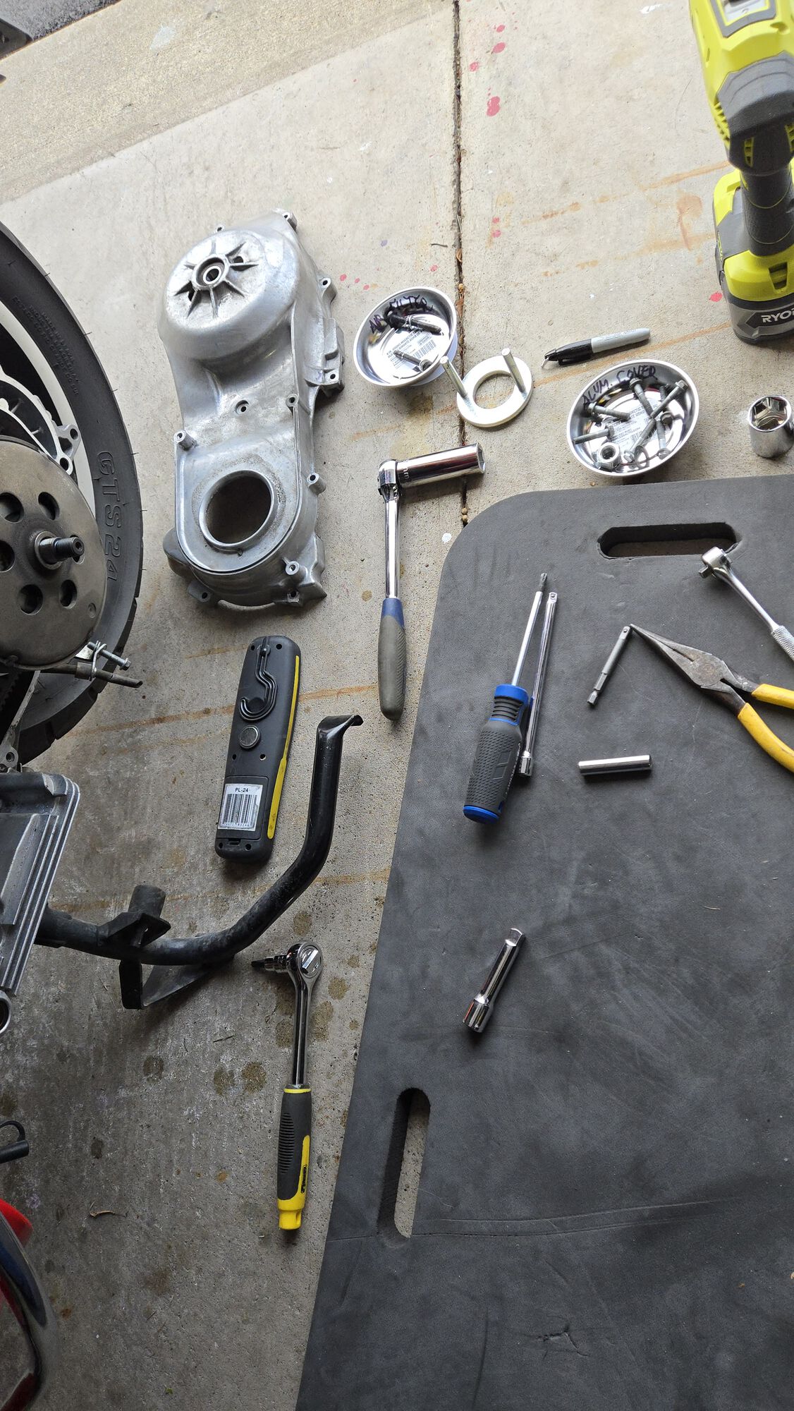

Today I'm changing out gear and motor oils and swapping in new brake shoes. I love it how the oil pees down the center stand. It wouldn't be an oil change without an Exxon Valdez incident!
Look how dirty this is!!
This is what was stopping me!
The new Malossi's
The new Malossi's

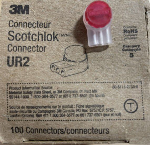

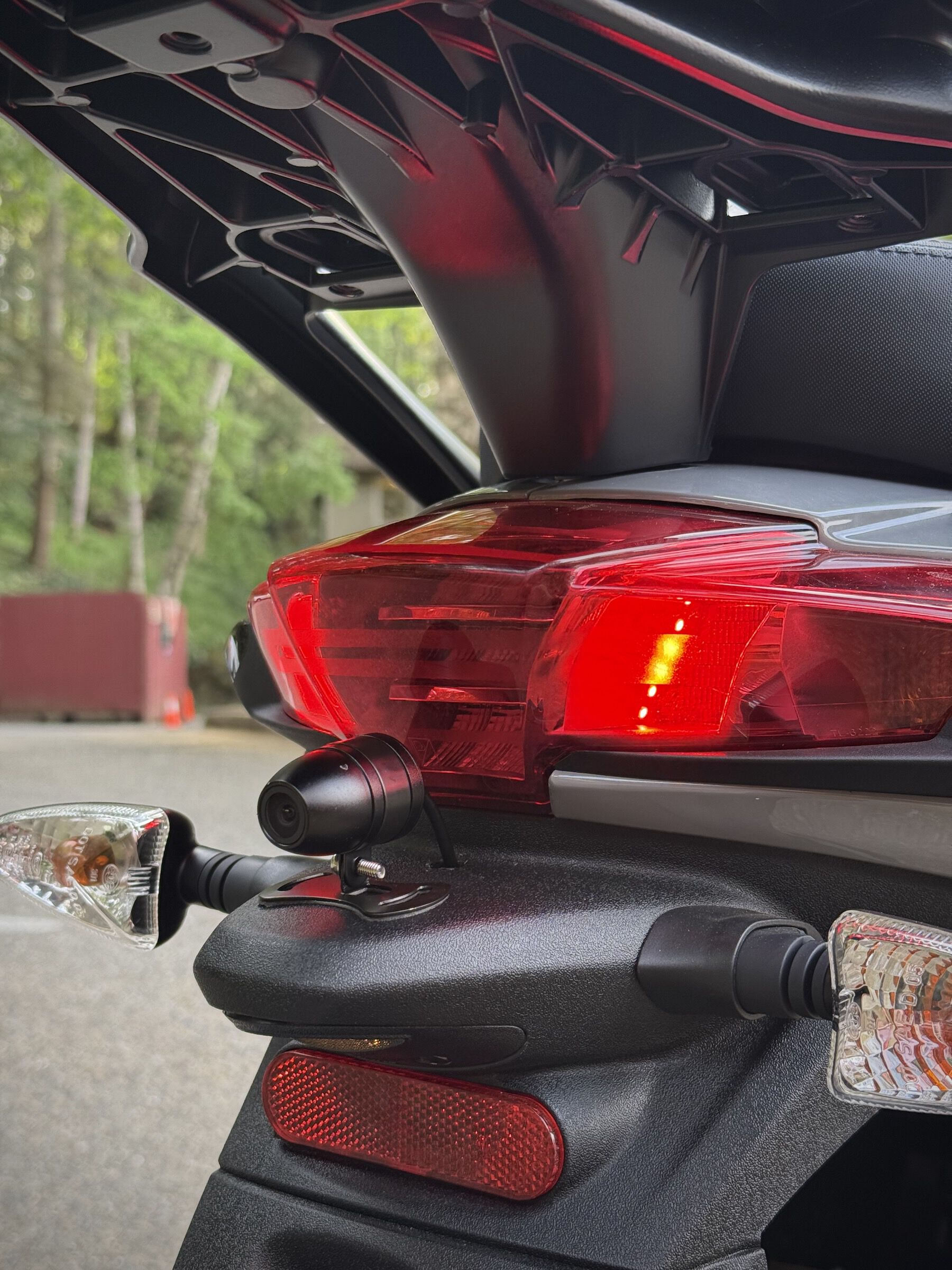

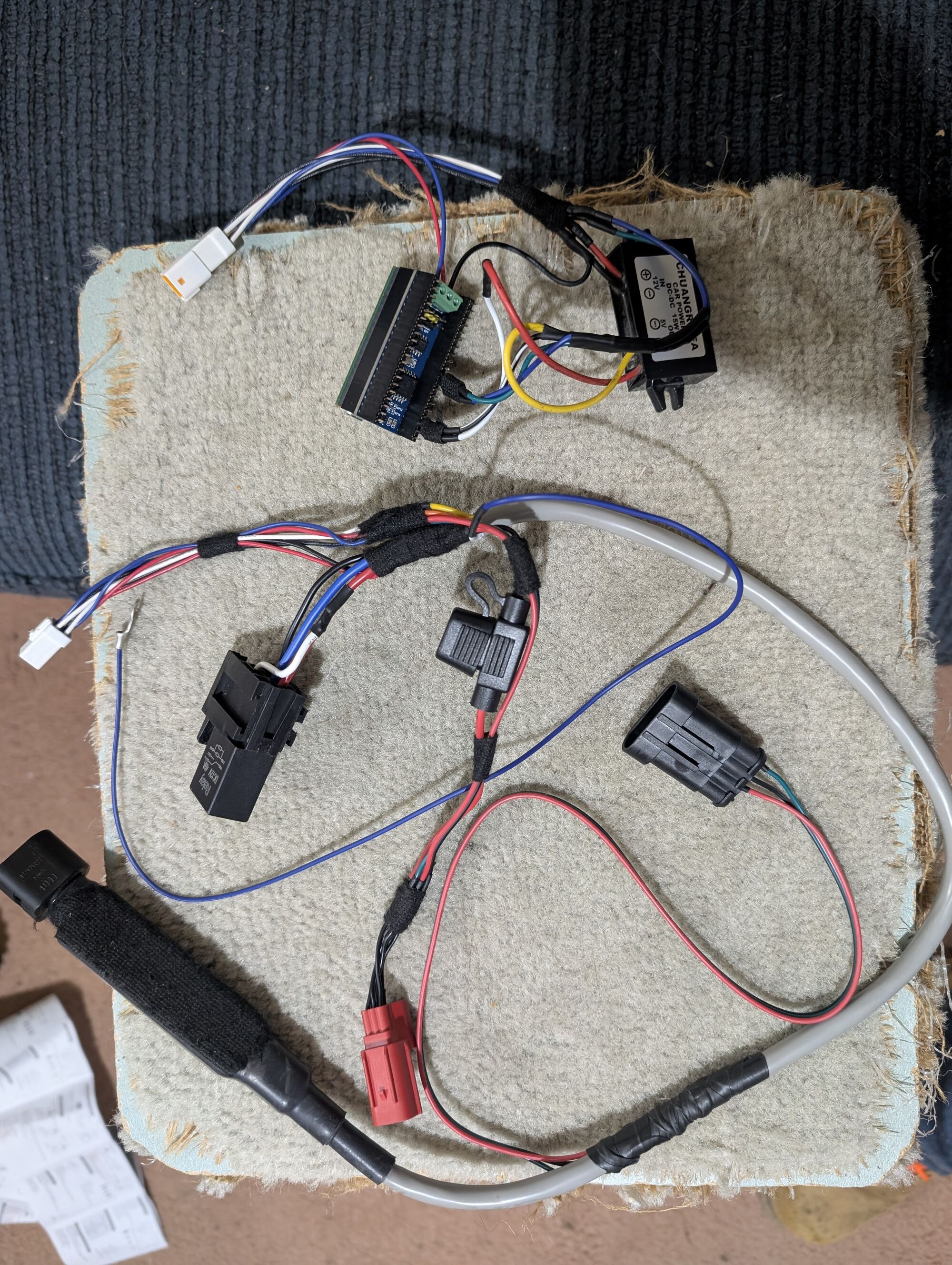

Decided to install a brake light modulator on the scooter today. I had a couple of BackOff units laying around the garage, so I thought it might be nice to get some use out of it. Pretty forward and easy job. Took about a whole 30 minutes to do it. I feel safer already.

2Scooter....can you list the modulator part#? I'd be interested in installing something similar. Can't ever be too safe.....

This is the unit that I installed.
https://www.signaldynamics.com/01001
I believe it is the brake modulator that started it all. I'm sure you can find it somewhere for a decent price. I bought it originally in 2001 for my SV650. From then, it's been passed onto a few other vehicles. Super-reliable and works well. It's function is simple and straight-forward- no programming involved. Only two wires, not four like the newer ones. It simply splices into your brake light wire with the red wire towards the handlebar.

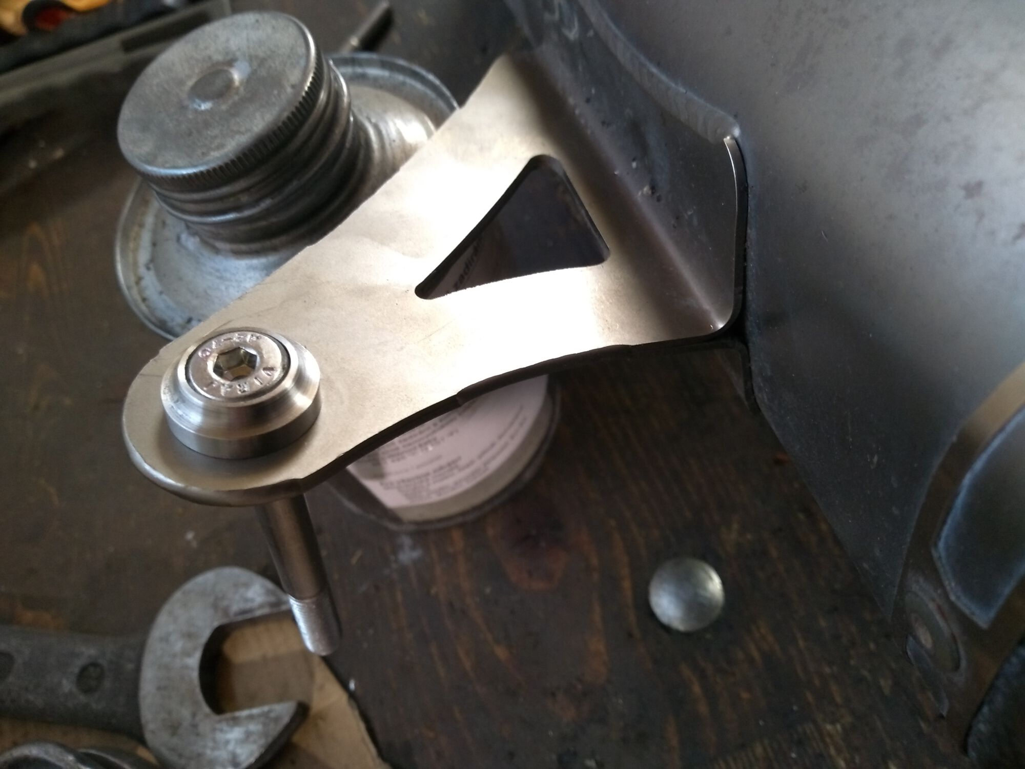

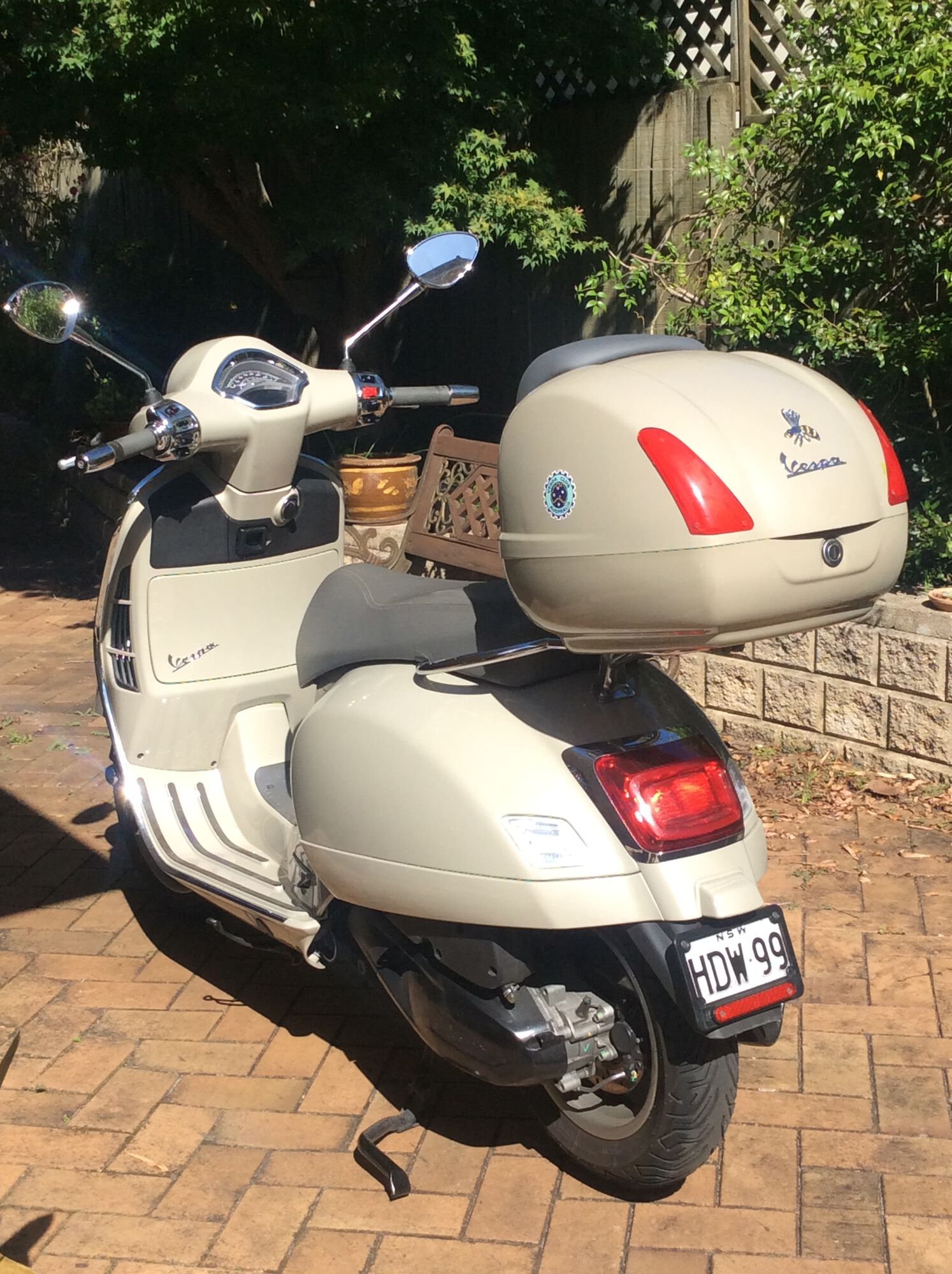

My GTS was making a clunk-clunk noise when I went over bumps.
First thought it was the lid of the top-box, so I modified the lock to reduce the play there, but that didn't fix it. Then I discovered that the play was in the hook that connects the box to the carrier at the back, so I wrapped a piece of rubber hose around the carrier where the hook engages, and problem is now solved.

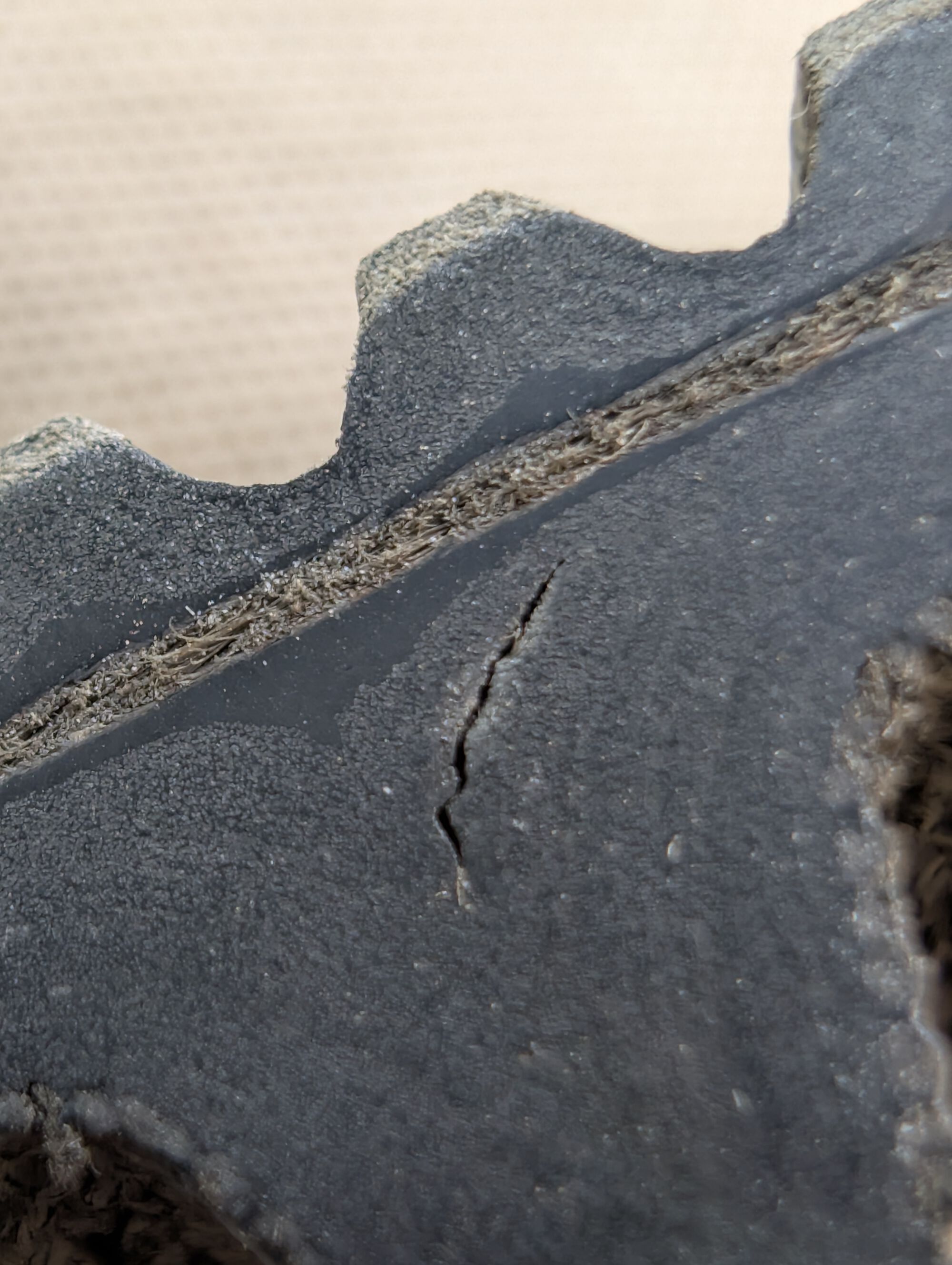

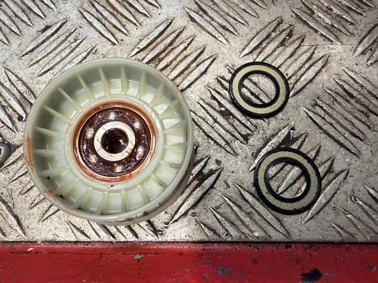

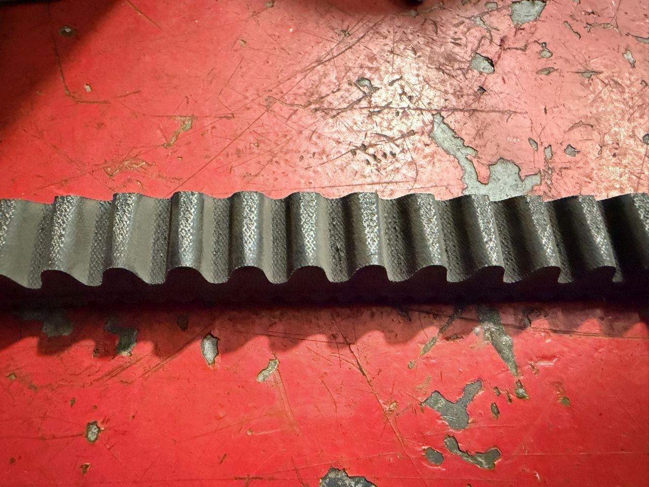

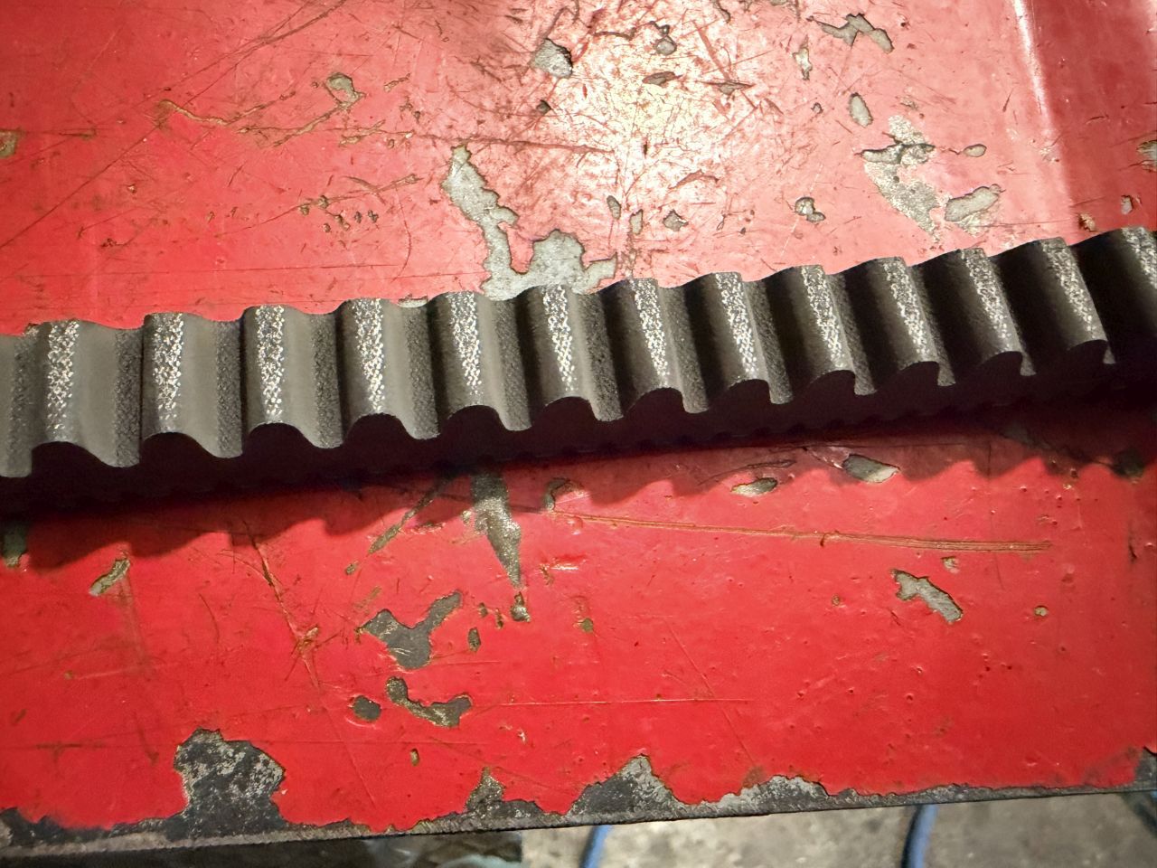

My GTS 300 had been getting noisier and noisier. It was a slow gradual build up and seemed like it was losing some power too. So today I removed the exhaust and changed that stupid exhaust gasket. Problem solved. Now I can hear the variator rollers rattle again…….

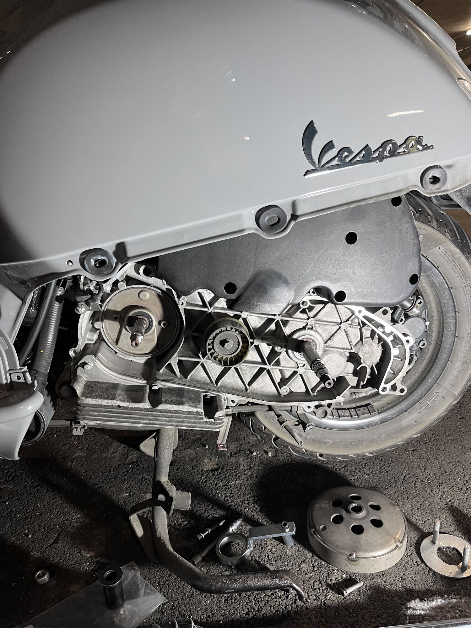

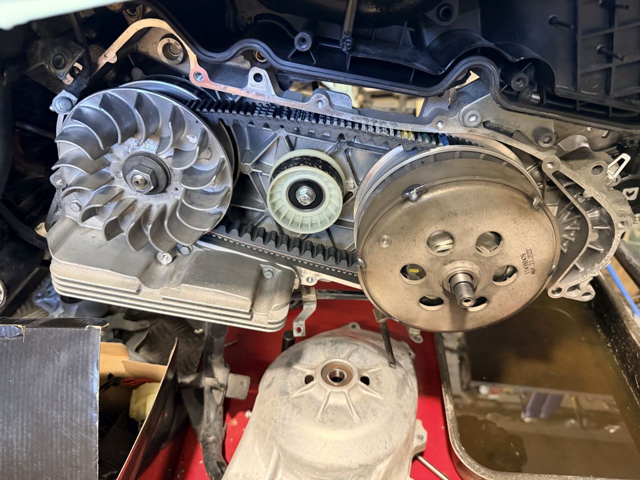

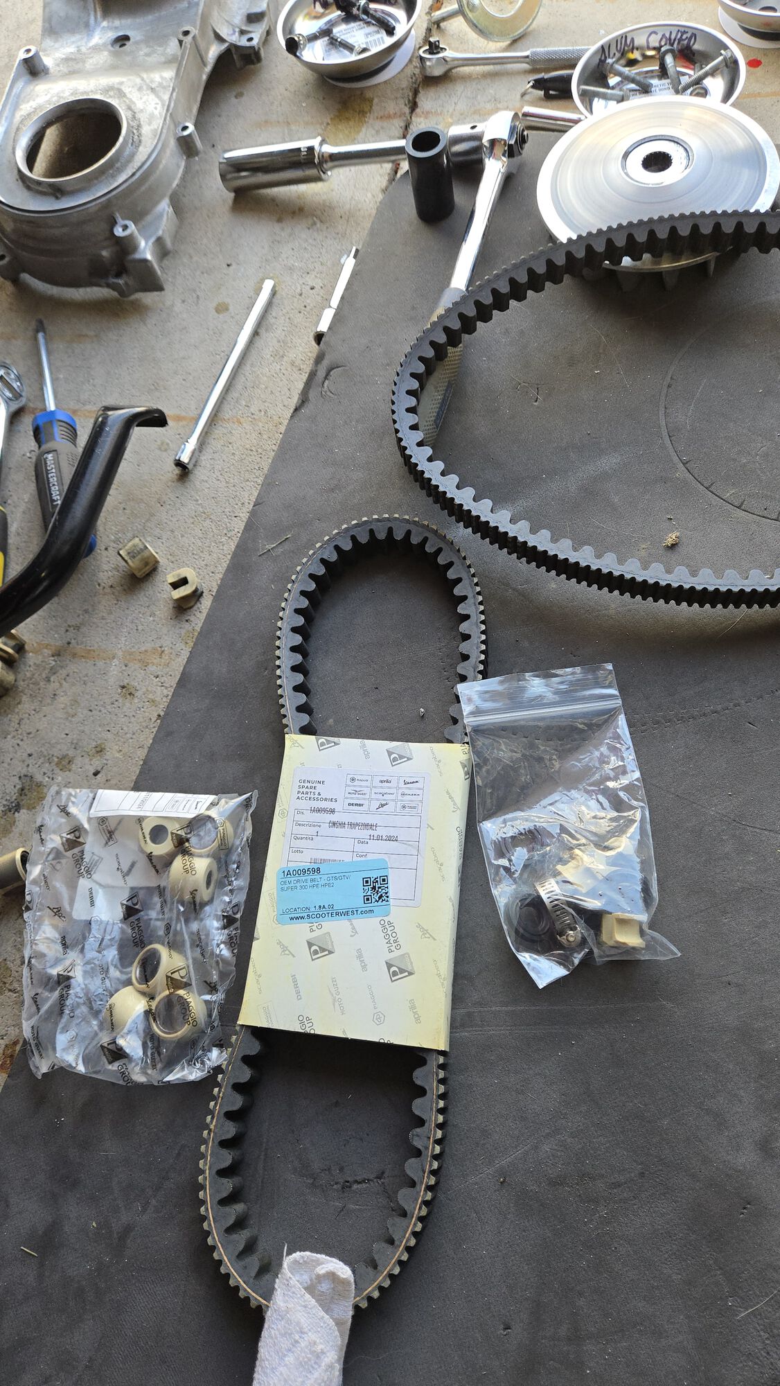

I just did the variator roller and belt service yesterday. Everything was within tolerances. So somebody did take care of her.

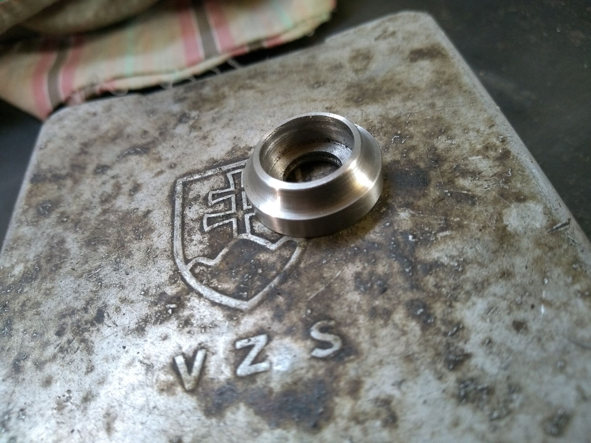

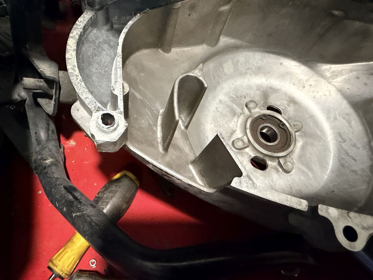

I finally got my replacement expander sleeve part from ScooterWest. I ordered a Faco expander from Scooterpartsco, but it had a different thread pitch, so I had to abandon those efforts. Last night, I spent some time polishing the deep scratches out of the windscreen with some wet sandpaper and the Novus products. Turned out pretty amazing! I got it mounted up on the scooter this morning and I am pretty darned pleased! It was certainly worth my 2 hours of effort!
Before
Before
After
After

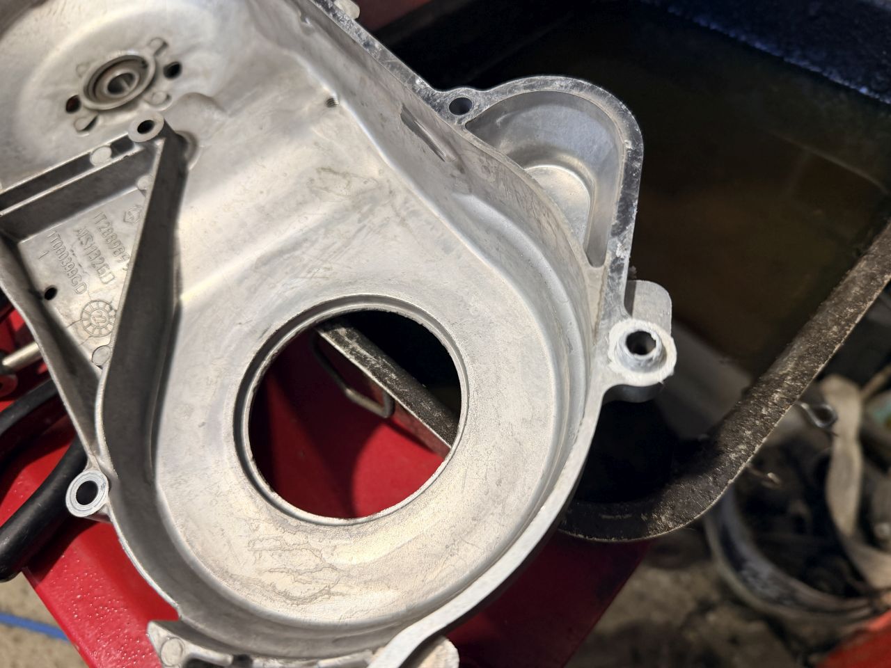

Fixed broken plastic cvt cover with bits of old computer case and pop rivets.

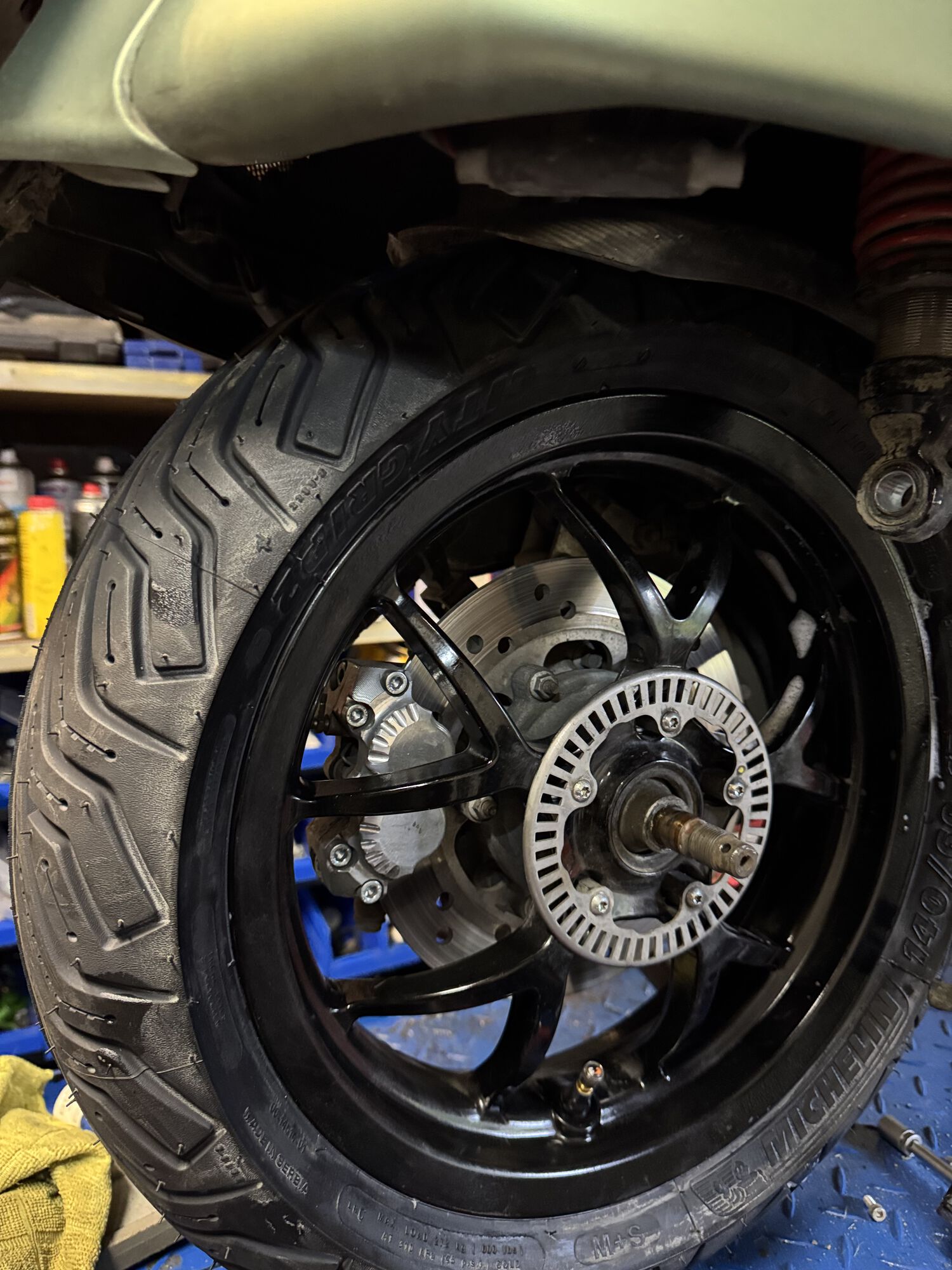

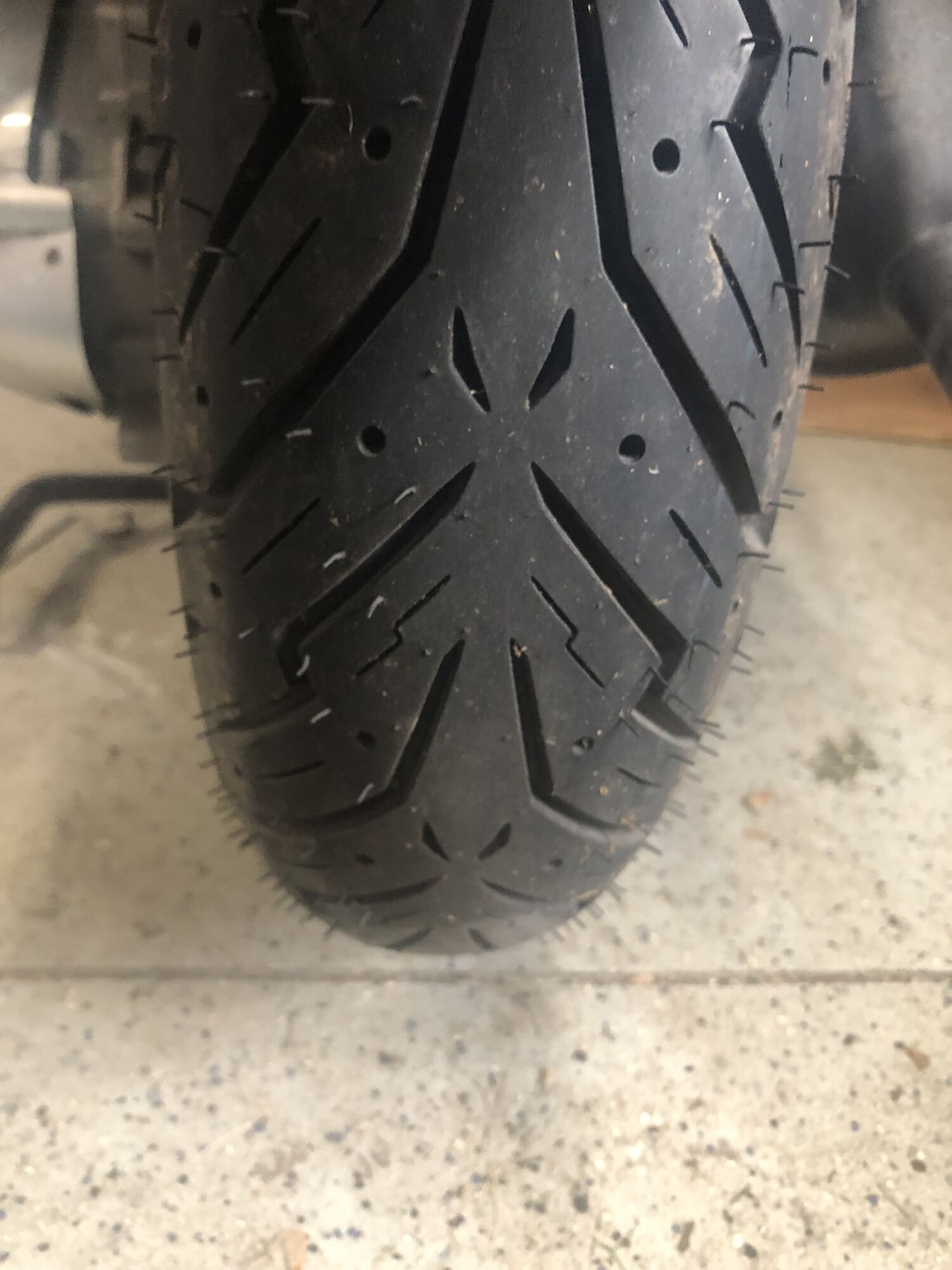

Today I change summer whell to winter whell.

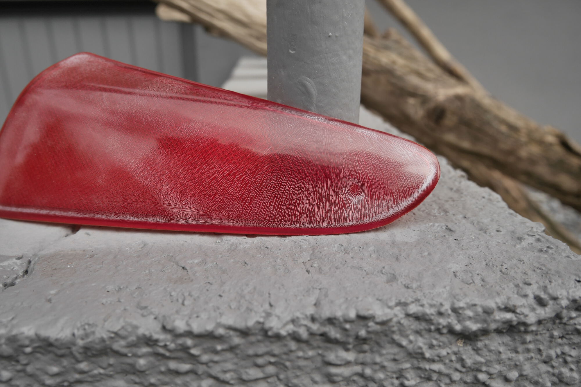

I prayed to my future scooter that I may find another NOS gooseneck tail light assembly for it.

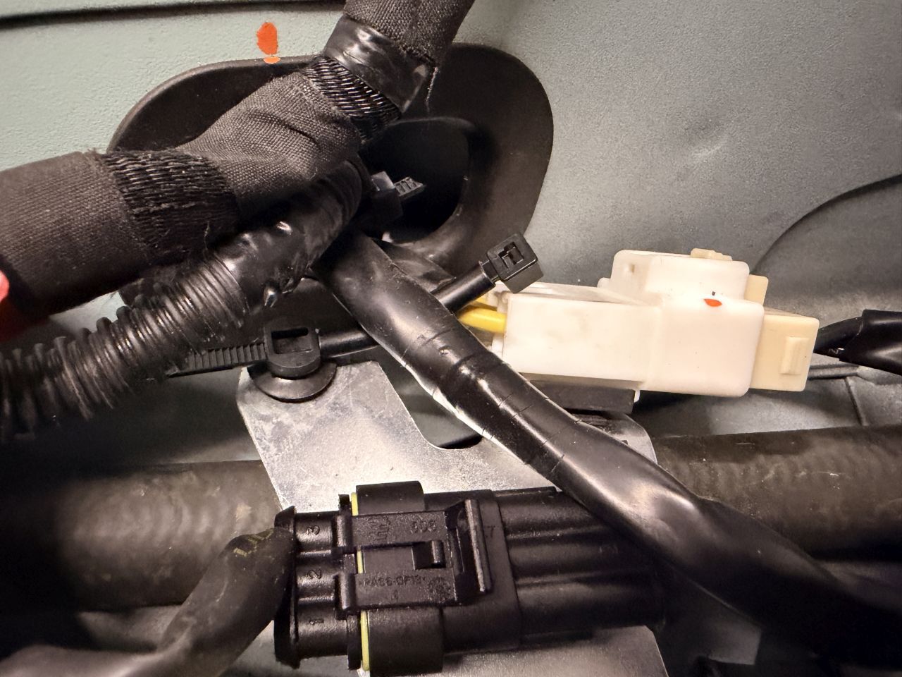

fixed the oil light by reattaching the sensor.
checked the oil.

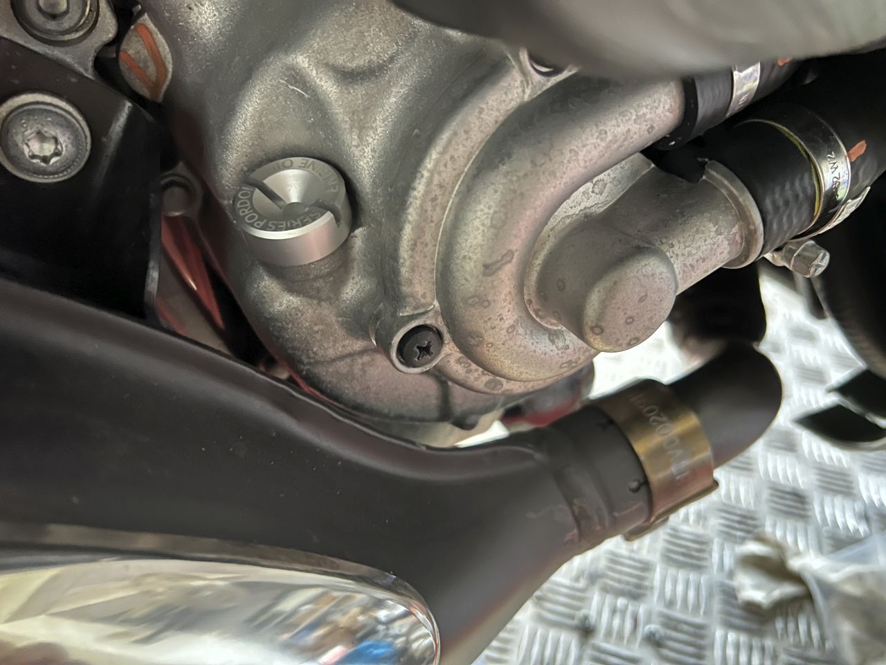

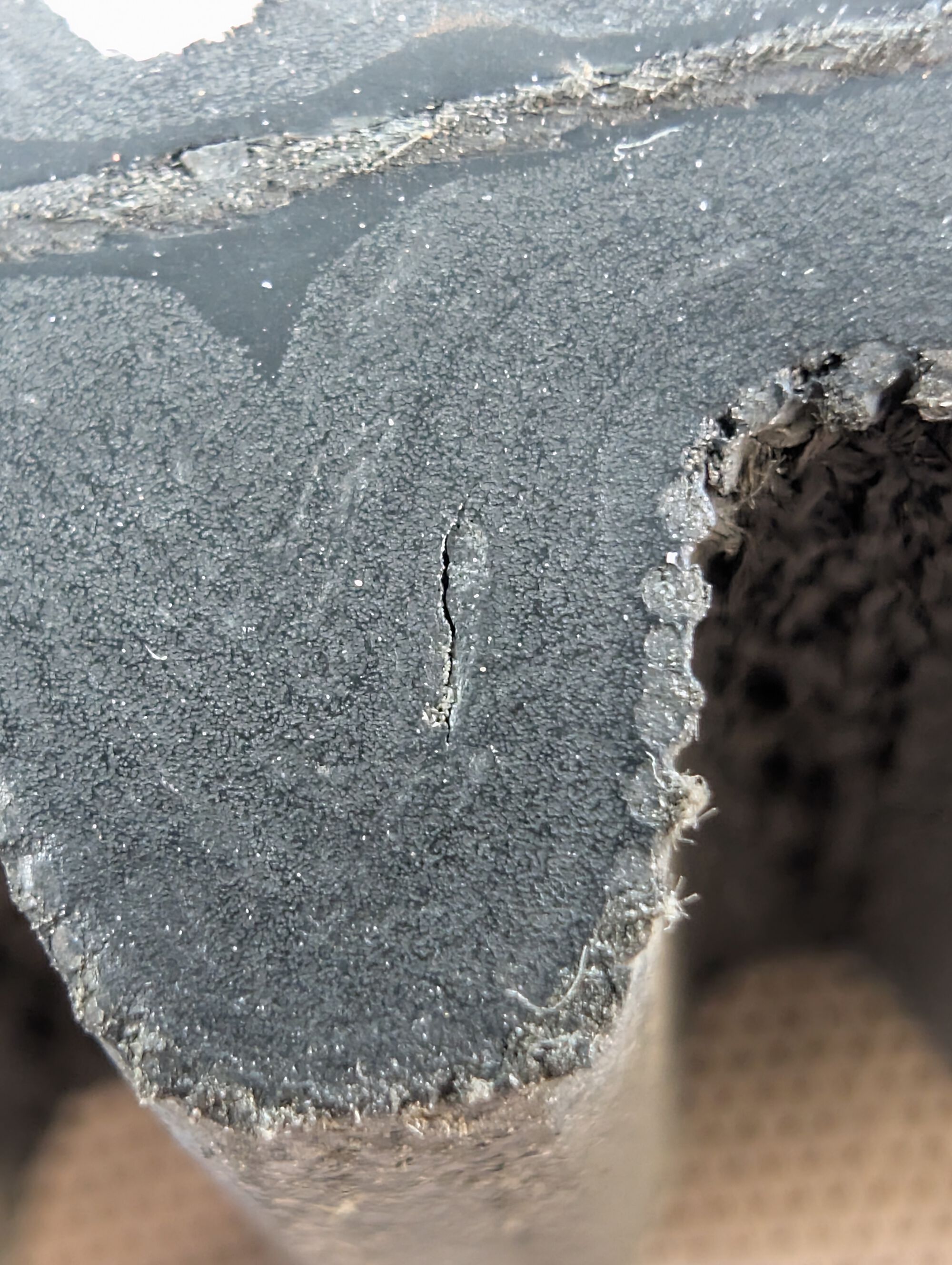

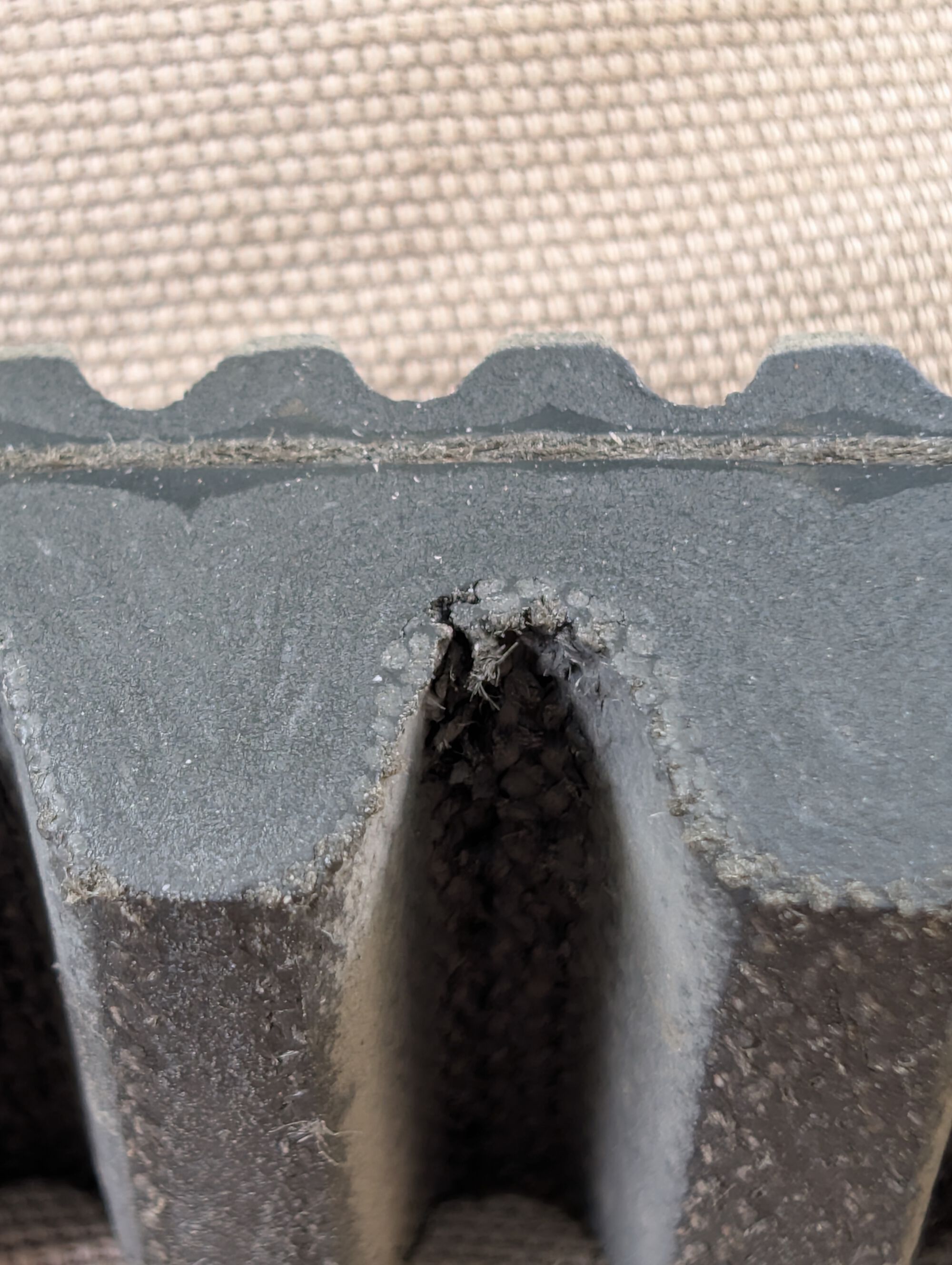

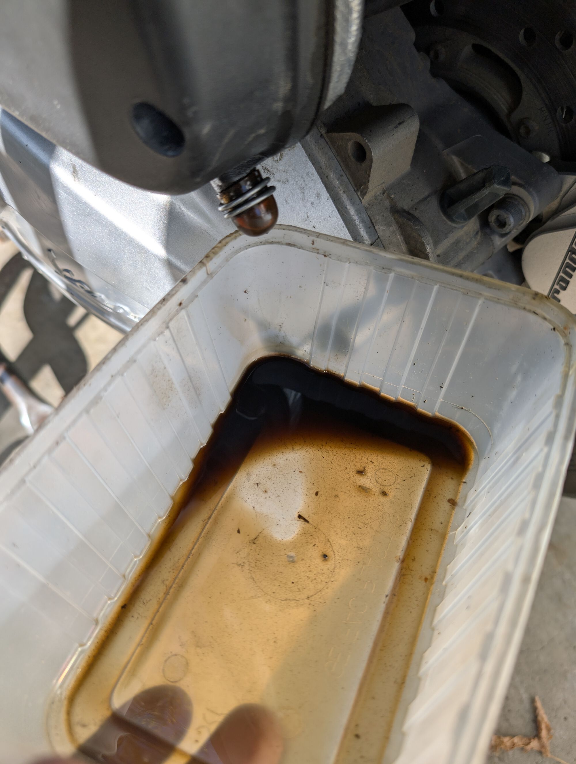

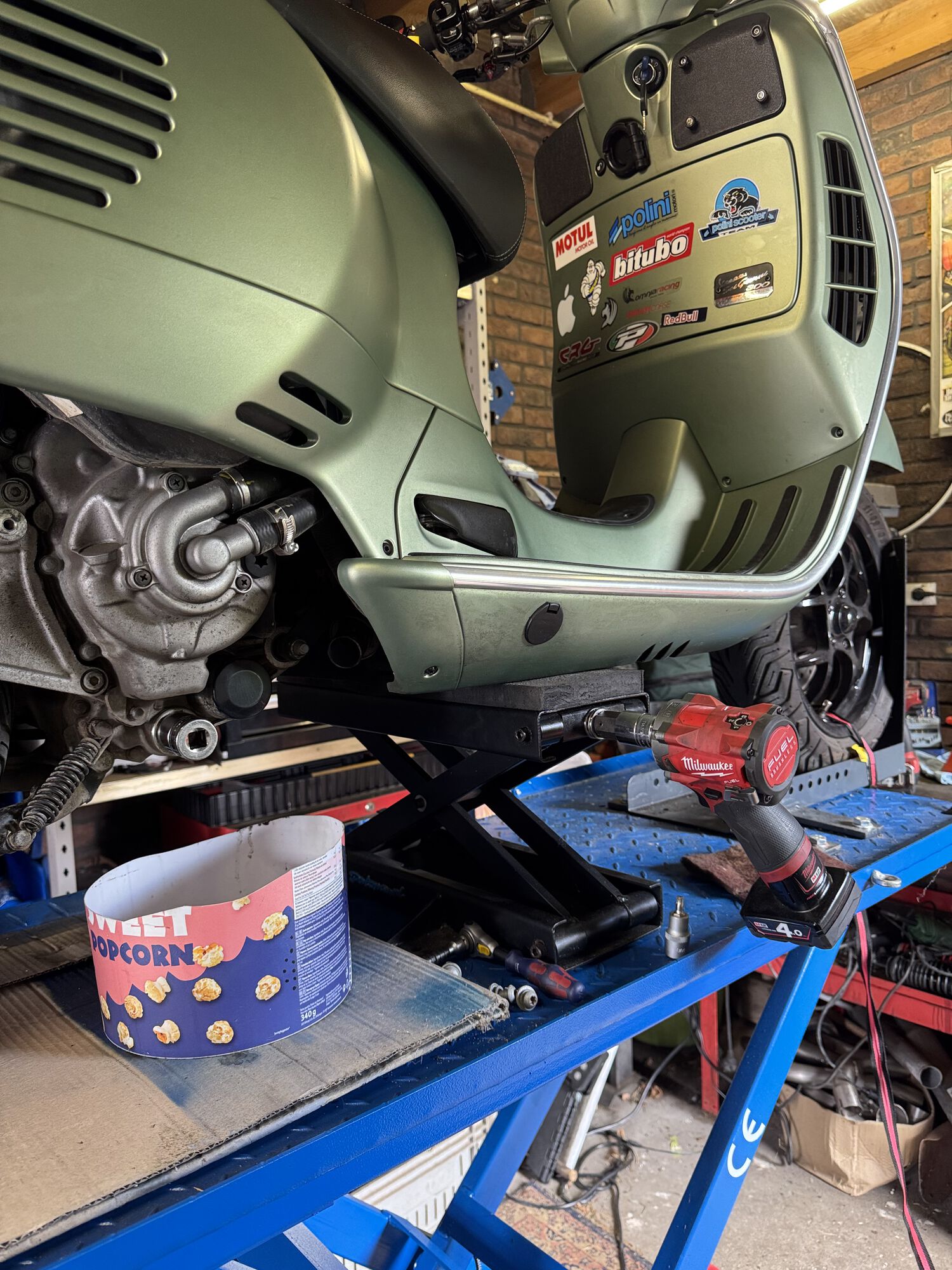

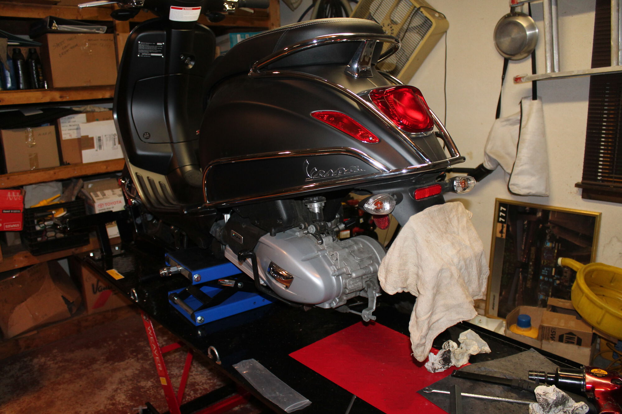

Finished up my maintenance on the GTS anticipating the end of riding for the year. Oil, coolant and brake fluid. And mounted my tall screen for when I do venture out.
BV is next. Things started going downhill when I started spending a third of my time looking for stuff. 🙄 Decided to finish up tomorrow.

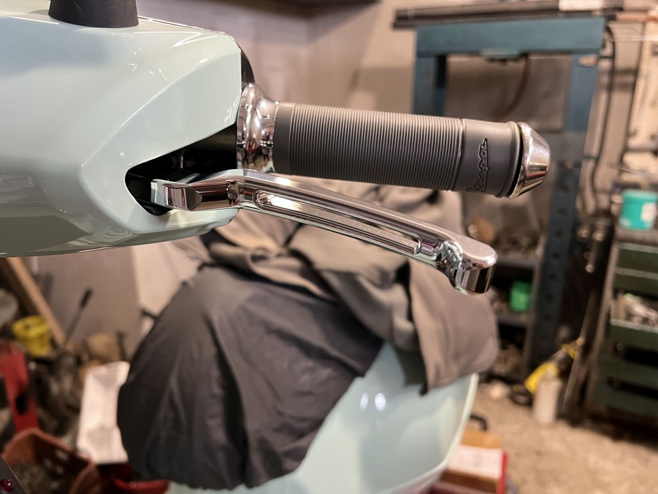

Replaced my worn and gripless OEM grips for some soft Pro Grip silicone grips. Also drilled and tapped my bar ends and installed some heavy HVMP bar end weights that have been sitting in my garage drawer for some 15 years now. (I love recycling bike parts!)

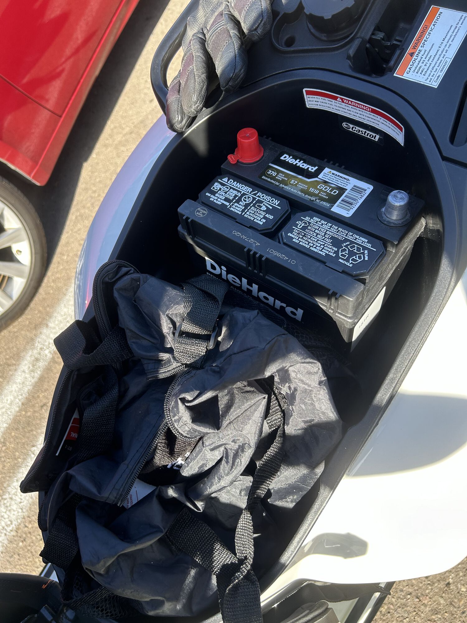

Installed new larger amp battery to get more cranking power in the cold weather.
