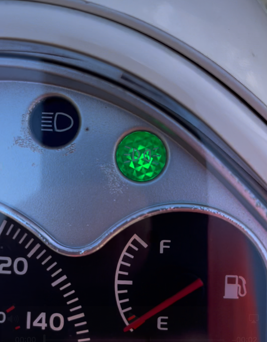

The headlight warning light on my instrument panel is flapping a little when driving. When sccoter is running at idle no issue at all, but when driving I can see I flapping a little.
somebody with a tip of reason?

It's wired permanently on when the ignition is on - nothing actually to do with the lights at all! So suspect a connection to the bulb or into the cluster.
