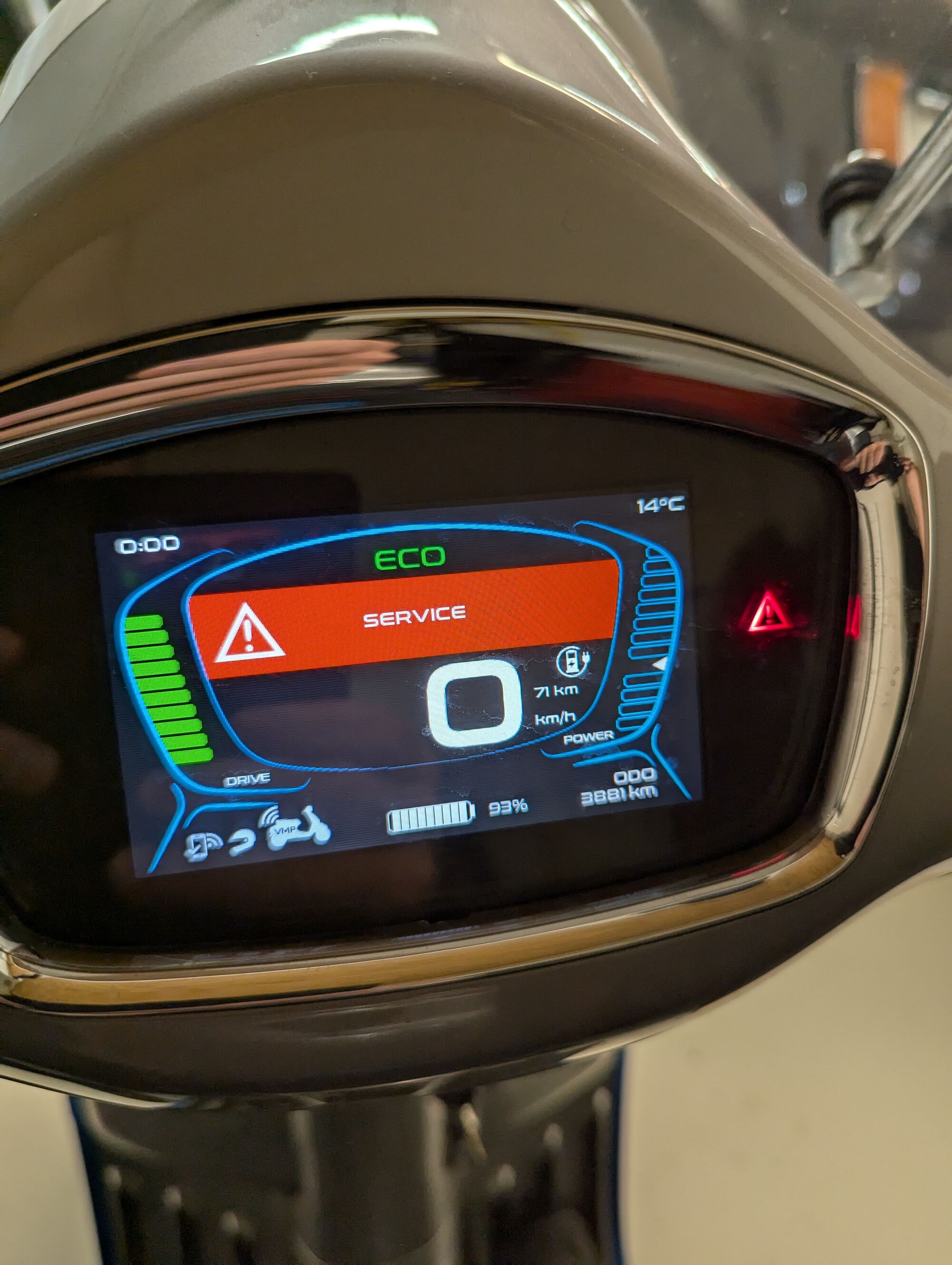

The aux battery is low so I get this as well. see image.
