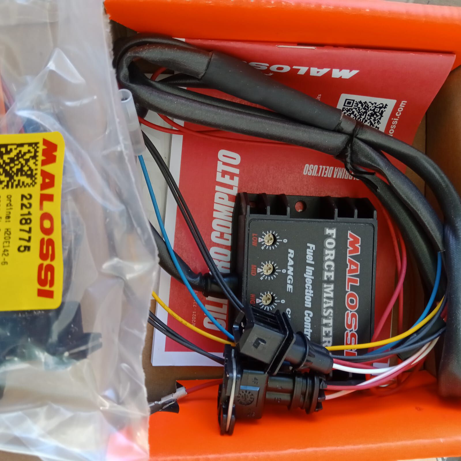

btw did your engine have the ECU integrated in the throttle body or not. There are two different part numbers and the difference is in the Malossi Forcemaster (connectors I suppose).
Was trying to order and the imo wrong partnumer only was on stock.

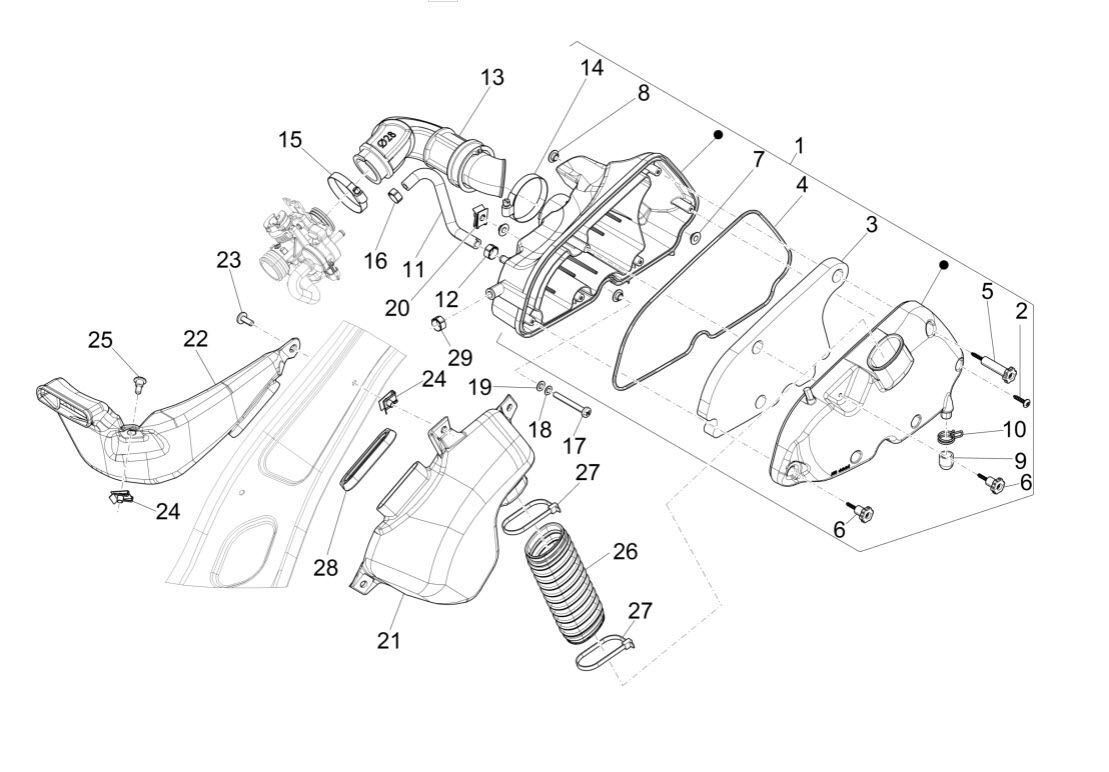

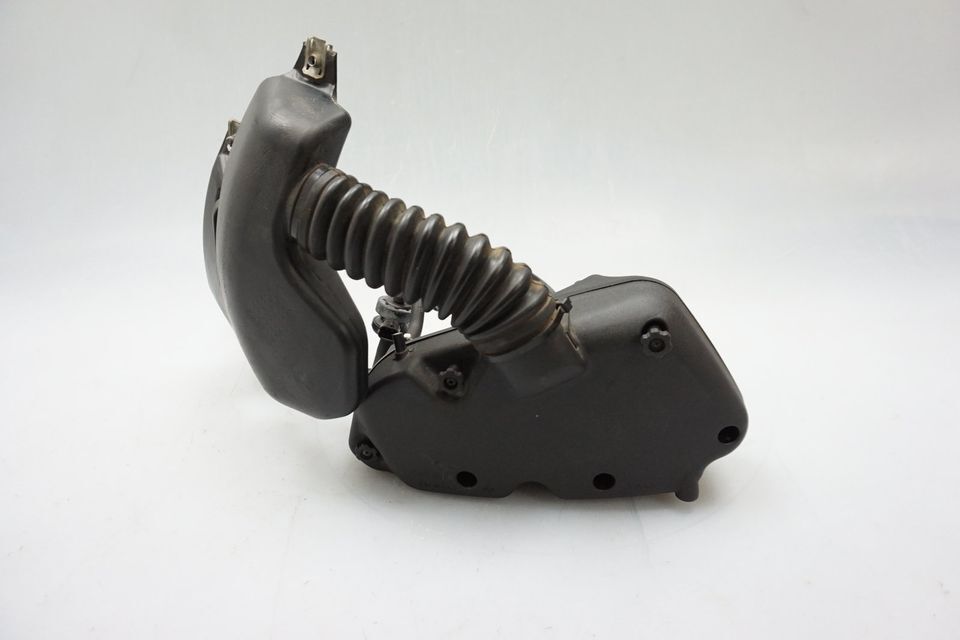

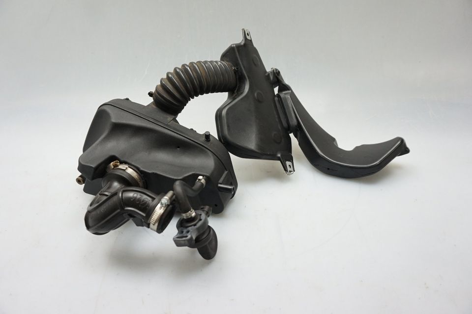

and now for some sacrilege; the air filter
The perspective is that I also have an NSM and the air filter is fine metal gauze only. Now understand that the air/petrol/oil in a two stroke goes through the crank and the mixture lubes the crank et al.
Looking at where the Primavera takes in air and how the tract is, remembering it stays above the piston... why bother with the filter? With my mileage it will not make a jota of difference to wear but it wíll make some difference in the resistance to the 50% more air sucked through.
Mine has a separate ECU mounted behind the legshield.
Much appreciated; same version as mine then.

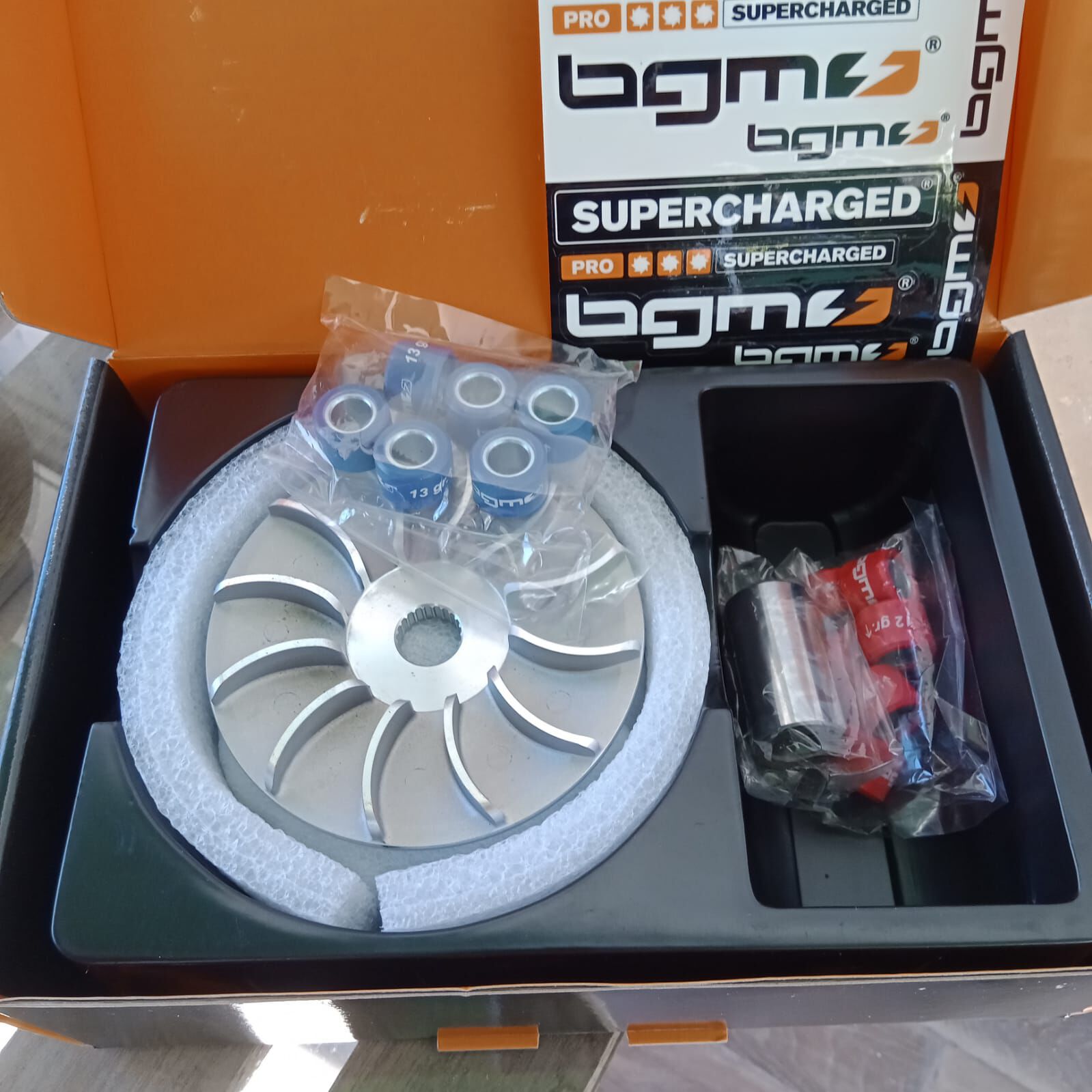

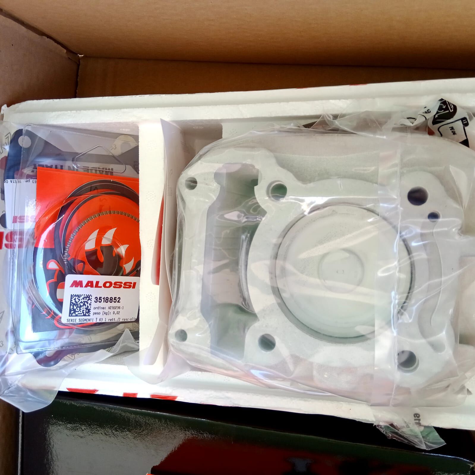

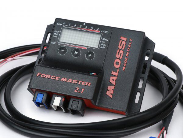

Ordered from SC:
- Malossi 185cc kit
- Malossi Forcemaster 2
- BGM Pro Variador*
* the actual weights cannot be compared because the rollers move on ramps which are different per brand.
It is good to note that it is the design of this ramp which determines the rev cháracter of the variator. The BGM ramp supposedly increases high speed revs less.
Fingers x-ed.

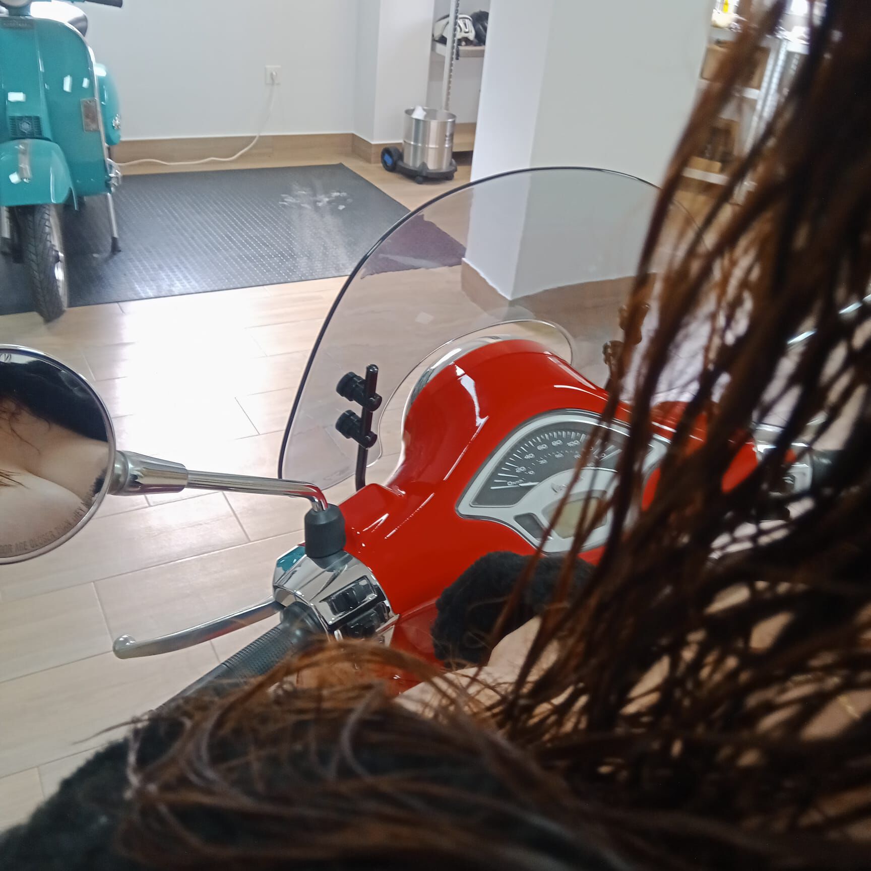

was reading the user manual and... with accessories top case, windshield, luggage rack et al, 80 km/h should NOT be exceeded.
.... and then there is me who ordered a fly screen to increase max speed ROFL emoticon
No, seriously, I know it is to a large extend bum covering by Piaggio but it doés have solid reason: These accessories change the oscillatory frequency and the Vespas cán get into speed wobble. Especially a windshield and/or loaded top case.

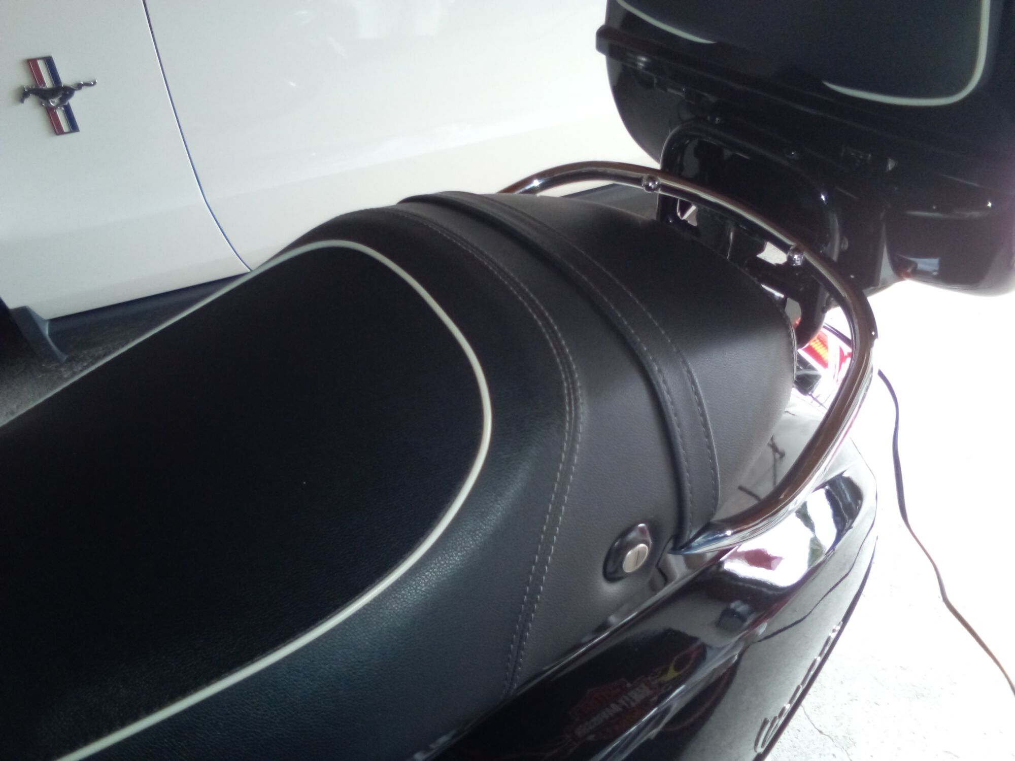

Seen the OEM Piaggio ´sprint´ solo seat and like it a lot.
Take the grab rail off and it would look a LÓT sleeker.
You think the charming passenger would notice?
@che-storto avatar
2009 Black Vespa s150
Posts: 412
Location: Thornhill ON Canada
@che-storto avatar
Posts: 412
If your passenger is male you may want to keep the rail on otherwise he'll be hanging on to you.....unless you're ok with that.
My s150 has the "fast-back solo" seat with a strap. The original owner also added a chrome grab rail which also supports the top case frame.
If the chrome bothers you that much get it blacked out.....

Che-Storto wrote:
Just wondering why you went with the BGM vs Malossi Variator kit and why you didn't get the heavier gear drive spring?
The BGM I opted because it meant one stop shipping ánd I hope their design will suit my use.
The way I read the blurp is, the BGM variator characteristic is supposed to be designed to work with the original spring:
´NOTE: A harder counter pressure spring is not necessary and would reduce the performance on a series engine only reduce it due to the higher friction of the V-belt.´
Ok, ok, my engine will be stronger* but furthermore the theory is that having the original contra spring means should hold a higher gear ´better´. Rolling a bit off the throttle should give less ´down shift´.
But I can always go stiffer spring if I feel that needed.
* thus the weights in the kit meant for 150cc will likely be better suited than the ones for 125cc.

Petrus.....thanks for the info. I think I have a better understanding how the Contra spring is designed to work.
The Malossi Variator kit I'm looking at for my Vespa comes with a white Contra spring. Sounds like if you snap off the throttle quickly (with a stiff spring) its almost like down shifting....resulting in better mid-range response(?)
@petrus avatar
P200E DN 1982
Posts: 1459
@petrus avatar
P200E DN 1982
Posts: 1459
Akin to yes.
The variomatic is all about balance between loads: Load on the primary pulley resulting from revs (centrifugal force on the rollers) and throttle x load on the seconday pulley from road speed/load. The spring in the latter counteracts the load on the belt. The stronger the spring the more pull on the belt is needed to push the pulley apart and ´shift up´.
Momentarily rolling off the throttle will see a strong spring push the pulley tighter = shift down.
A stronger spring logically pushes harder on the belt; more pressure on the sides of it. It increases friction thus some loss of efficiency and increased wear.
What the effects of a change in the forces will be can be sussed out by reason but how much is a matter of trying out.
Remember that the load on the secondary pulley is also a function of rider (passenger) weight, even the bulk of the clothing.
Ergo ... it all depends

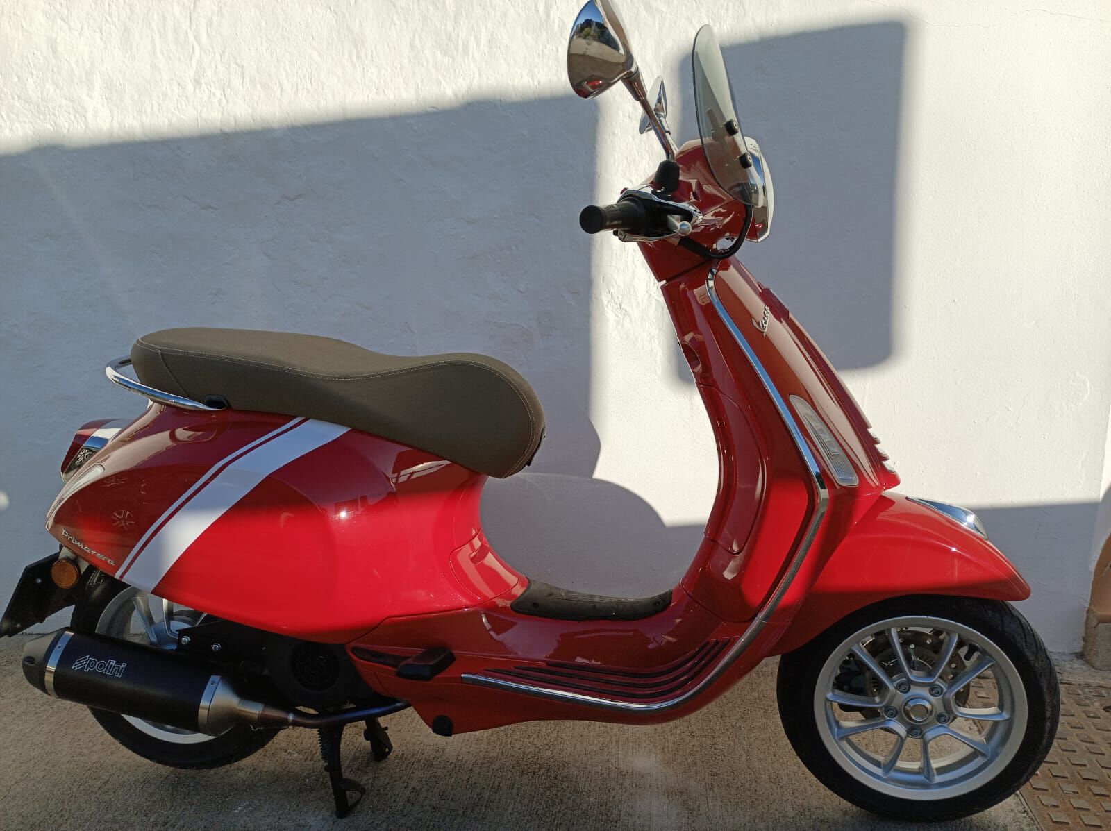

The fly screen is in.
I am impressed by the vfm.
Also by the fool resistant pre-assembly Clap emoticon
Fitting was a doddle. ´Frutting´ the rubber grommets through the holes in the screen was the most complicated
p.s. yes; charming company will model the screen Laughing emoticon

In preparation of the engine mod. am looking at the air filter box.
Looks a quite nice design actually.
Will most likely add a hole in the separation between the ´still air´ side and the side under the filter.
Not decided whether I will remove the filter element or not: The front/low side of part #21 will trap stones and larger sand/dirt particles.

Ok, finally a moment for a photo of the fly screen:

Got all the go-faster stuff in now. crammed it in one box, instructions and all. Kind of to know it´s a handful of horses in it!
The camshaft is surreal diminutive. I know but still rather a difference from the four cylinders I have so far swapped cams of.

Meanwhile... looked at the air intake system again. Imo the bottle neck is in the ´snorkel- which snakes from ahead of the pet carrier, between the side panel and said bucket to a coupling piece onto which the bellows hooks up.
Deleting parts 22 -> 28 -> 21 would imo improve intake air flow.
It should be very easy to verify by simply taking bellows 26 from box 21. Leave out the bucket and take the scoot for a spin.
The crucial ´issue´ with the intake is that the feed is the ambient air pressure. Any drop of pressure / resistance in the inlet tract is power loss.
On the exhaust side the burnt gasses are expelled by a piston moving up. This can manage a way larger pressure difference than this same piston ´sucking´. It can never suck more that the ambient air pressure pushes.

The fly screen is AWESOME!!!
I knów that even the smallest screen makes a huge difference in ´parachute effect´ but ecery time it is Clap emoticon to experience.
