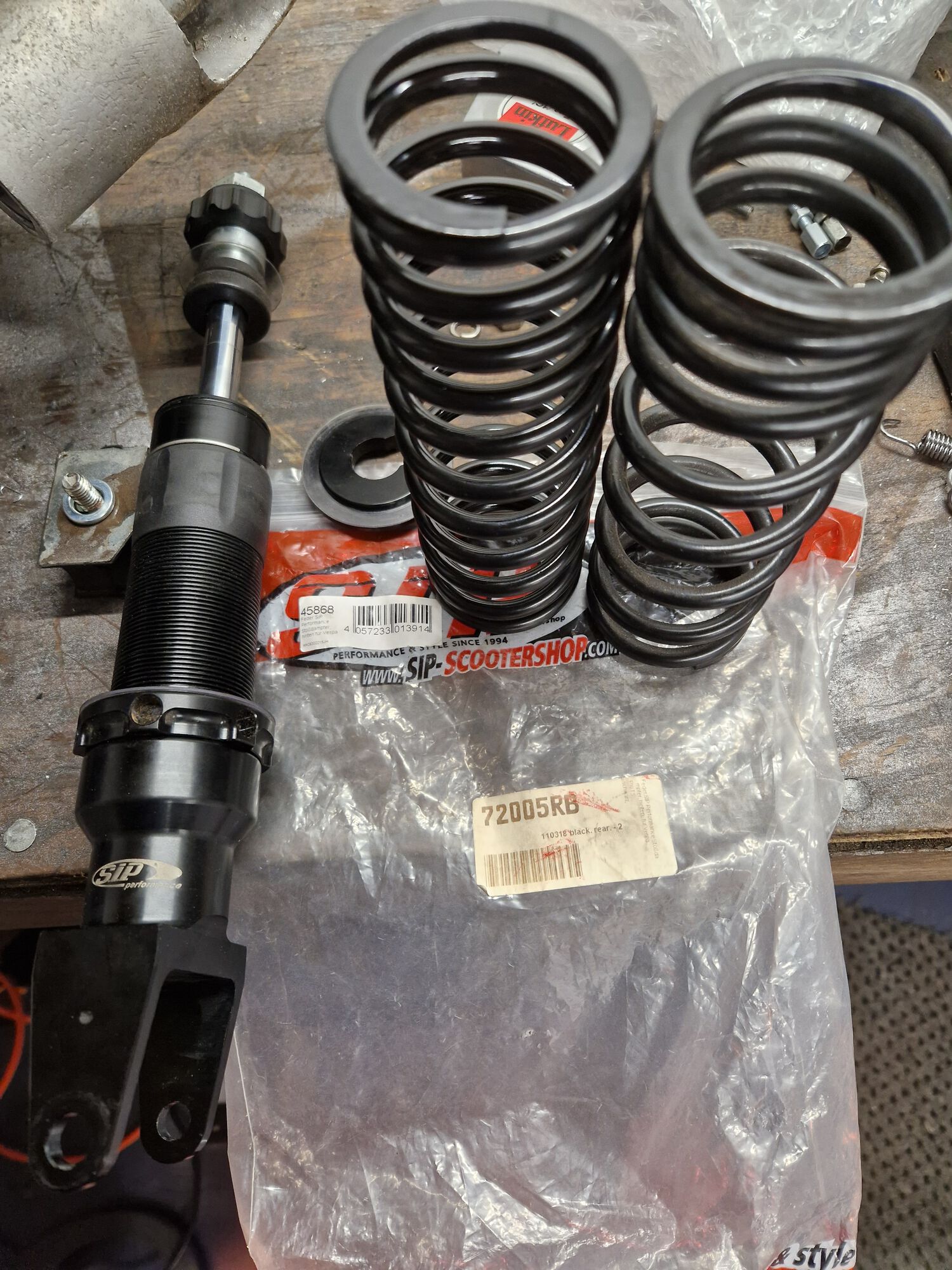

Just tried to fit the new spring and the ID is too small at 42mm vs 44mm for the old one.
Old one is labelled 110lbs. New one isn't labelled but it has more turns so will be a lower rate.
Irritatingly I can't find the receipt or any related emails to figure out where I bought it so I can return it.

Here's a pic
