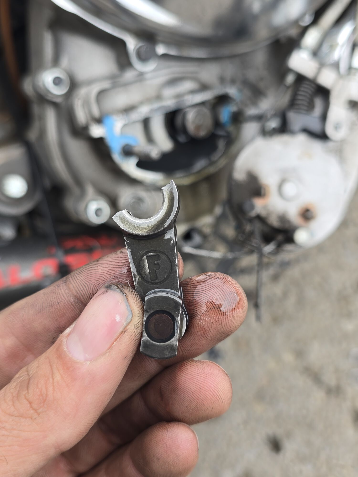

Classic vespa, fixed the exhaust after sitting for a few months, went for a ride, and immediately broke the shifter arm, well not immediately, about 2 miles down hill from my house. So who makes the best ones?

That'll teach you to buy the Grade F shift box. ROFL emoticon
I've gone for the FA Italia when I needed a replacement. You can spend more, but unless you're building race bikes, I'm not sure it matters.
You could just replace that arm.
https://www.scootermercato.com/Scooter-Parts/Selector-Box-Misc-Parts
"Best" is the KR Automation box. Feels like EFL/Lusso on an older bike.
https://www.scooter-center.com/en/gear-selector-box-cnc-reinforced-kr-automation-4-speed-vespa-px-till-1983-3333658?number=3333658

I tried this one without luck.
Then I went back to original old gear selector.
Later I rebuild it with DRT arm, pin and new standard spring(I also tried reinforced spring but not liked it).
