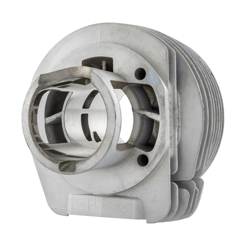

SIP youtube channel just released a video about a new product, a 125cc cylinder for Large frame Vespa with modern tech, new port layout, 8-times bolted with O-ring sealed head etc. What do you guys think? Should it be a high performance stock-like cylinder? I wonder if this can rev higher

I love this! good base to turn it into something efficient instead of following the "no replacement for displacement" mentality.
The thing I hate about all the kits on the market is that they punch them out to ridiculous bores leaving the stub too thin, the walls around the studs to thin, and an over square bore/stroke that compromises making good power.
The ports here look like it could deliver more than a stock T5 as is, and could be a base for a monster of a 150.

True! Just what I am looking for… At least this kit should a new standard for stock 125-150cc engine.

I can see the reason for this kit. The port layout is ideal, especially for tuning further. I'd expect when correctly set up, this would take a 125 that might do 60mph downhill on a good day, to one that does 60mph uphill everyday.
That said I think sales of VMC 177 kits won't be affected.
