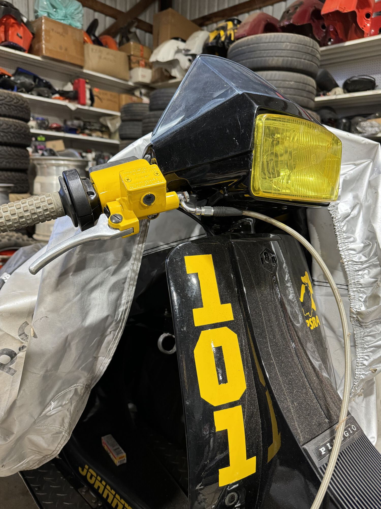

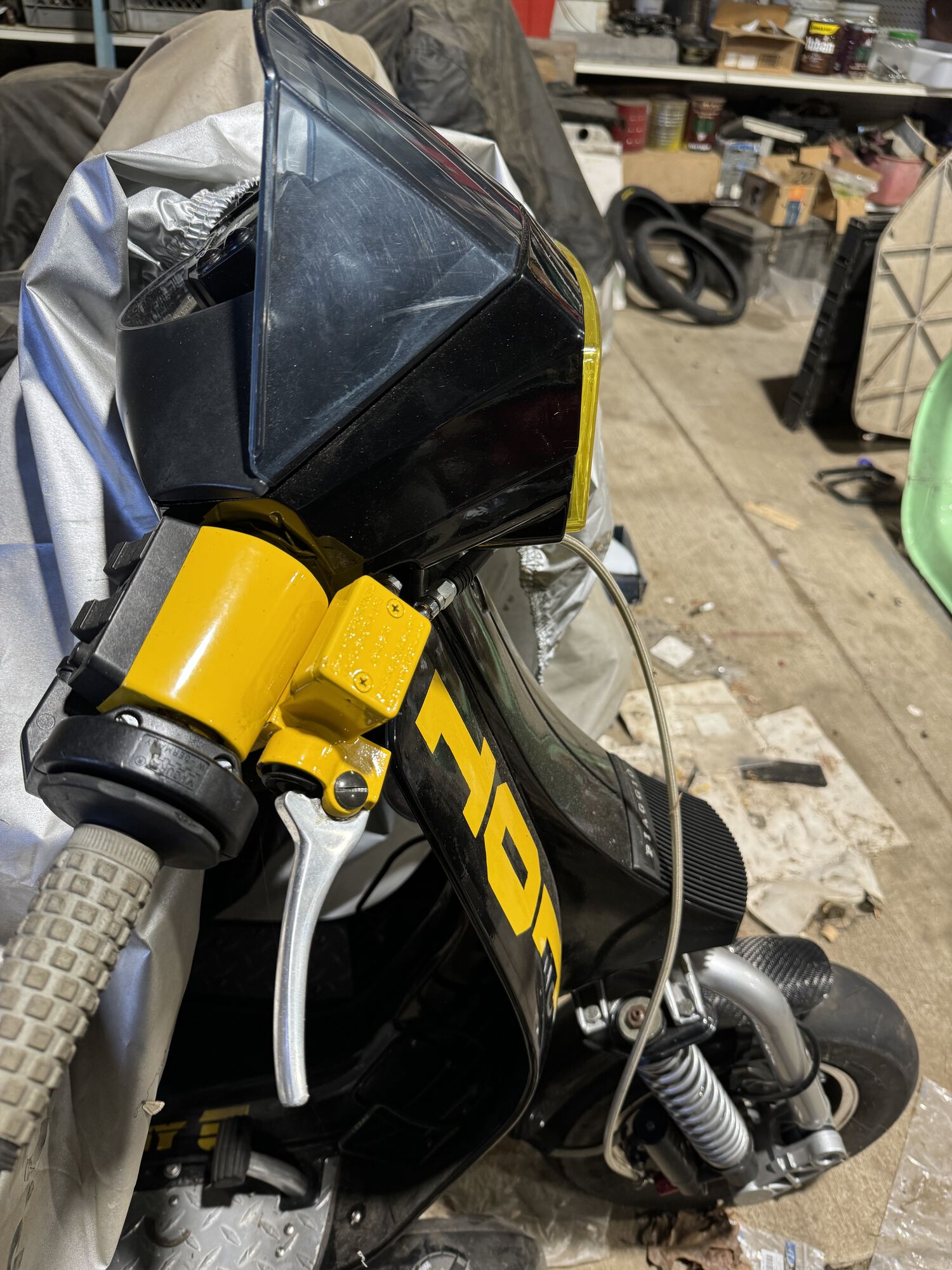

I installed a Grimeca 5 star brake kit on my T5. I mounted a PX master cylinder up on the bars.
