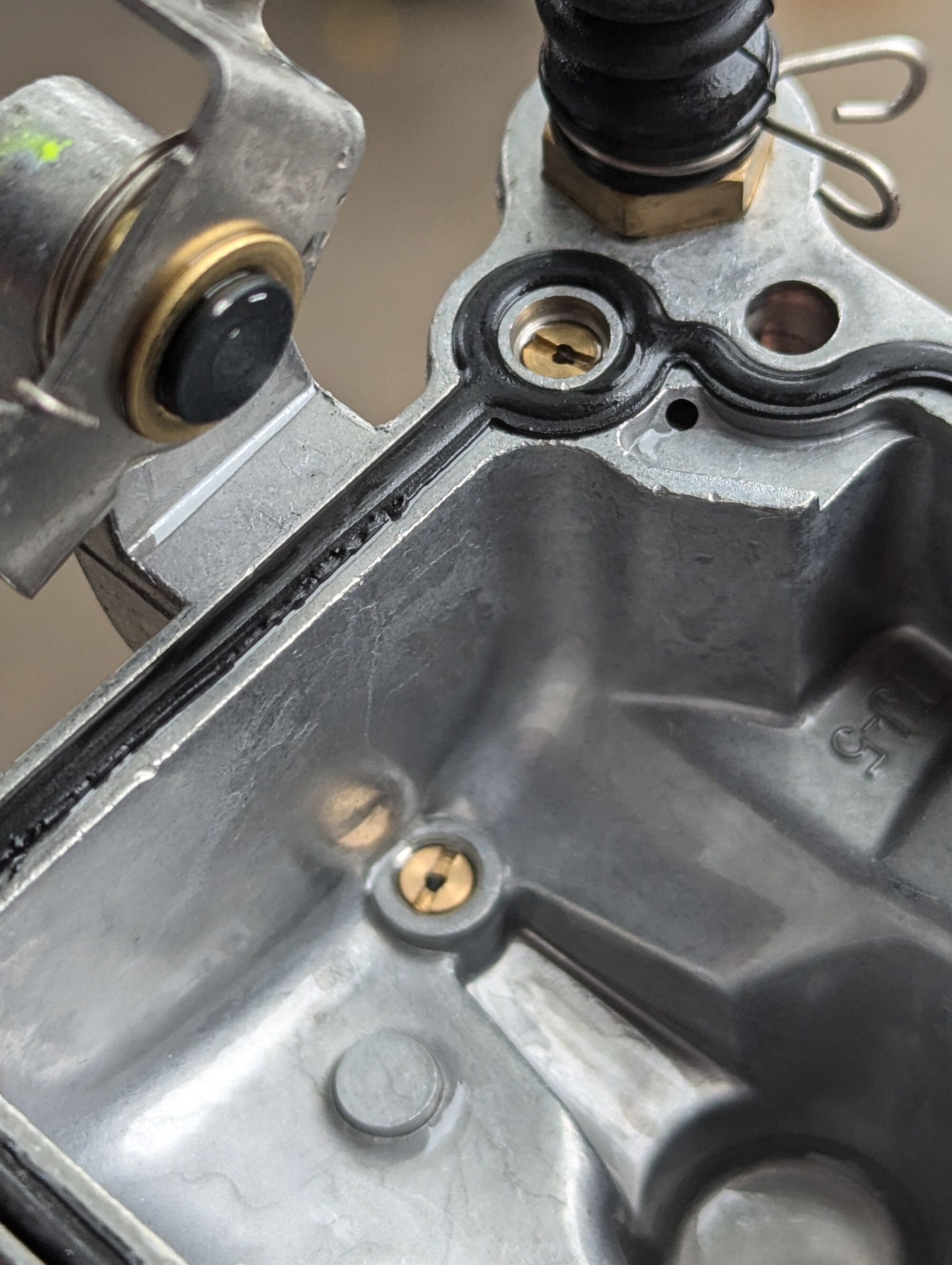

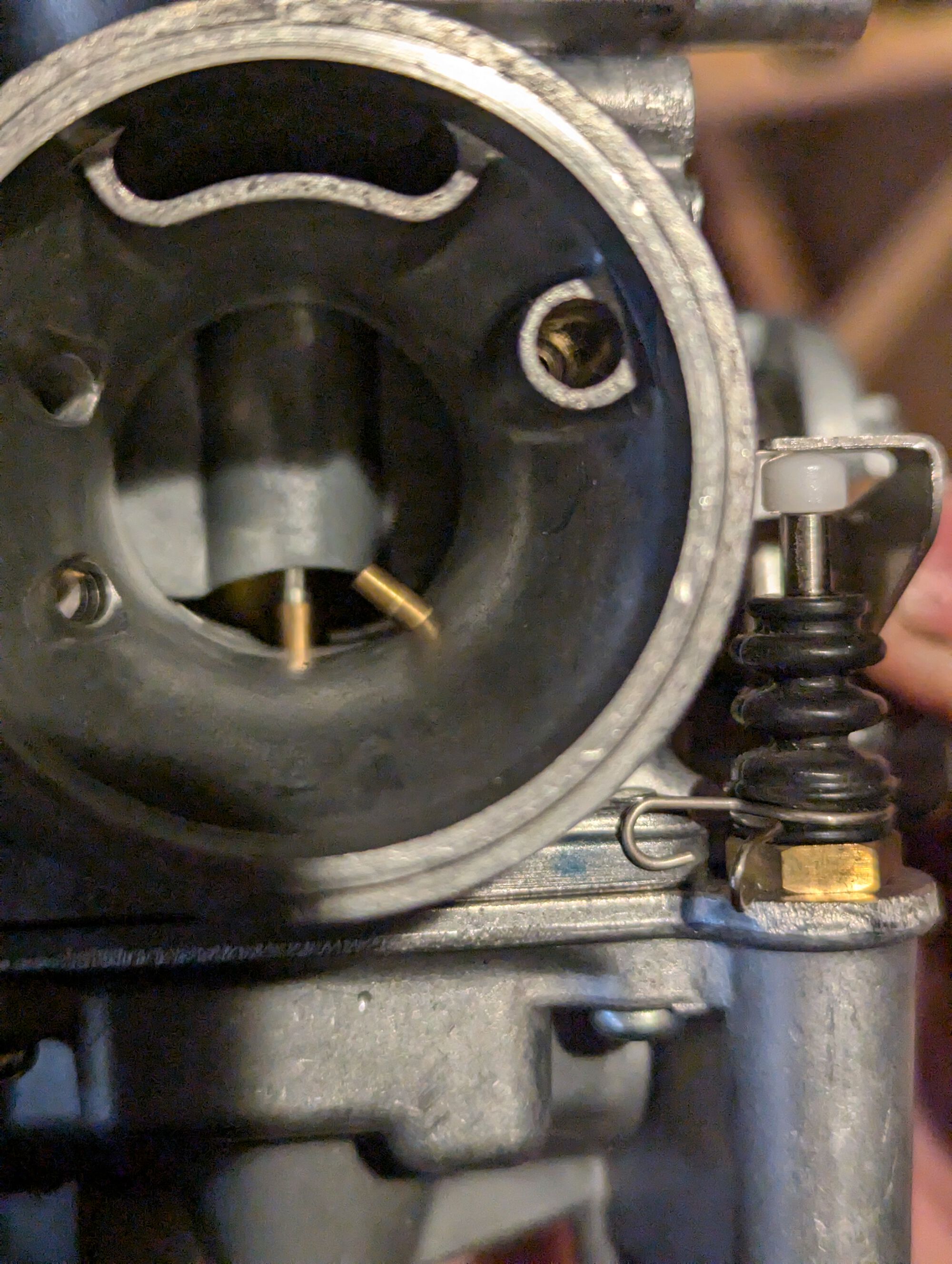

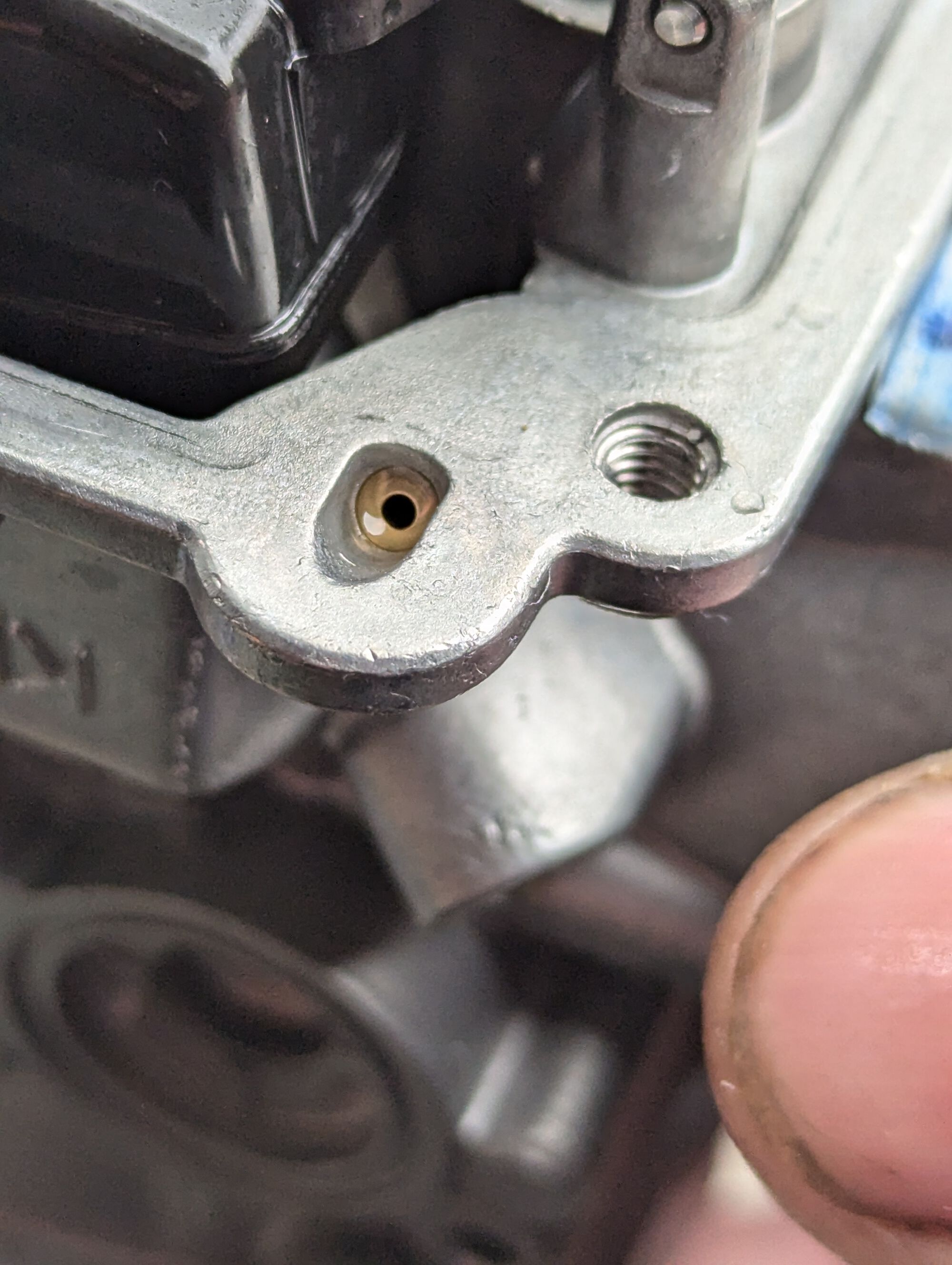

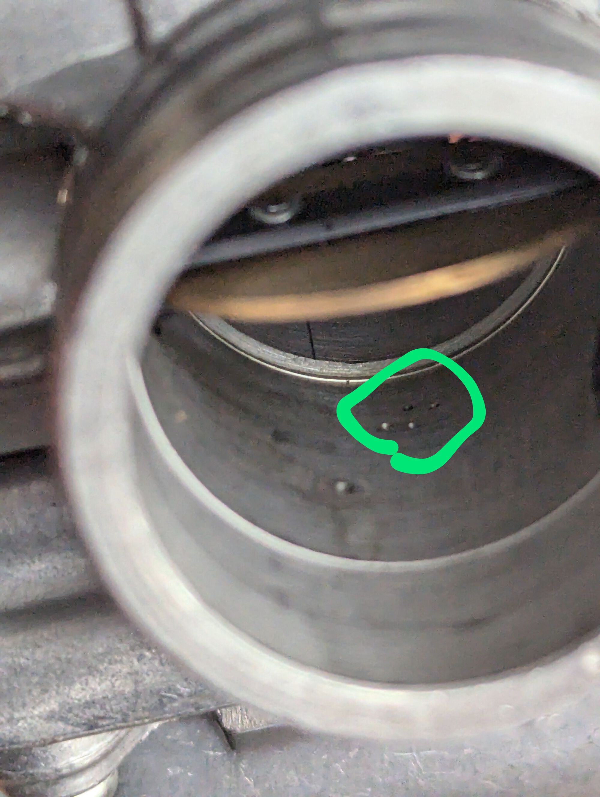

Well. I'm getting there.
I drained the 15 year old gas (ugly stuff!) and replaced it with fresh gas and now it will start without the Starter Spray but it runs badly. It won't idle and when I can get it to rev at a higher speed it won't do so consistently. I have to constantly blip the throttle and I can keep it going for a couple of minutes but eventually it will die.
It looks to me like a fuel feed issue so I'm thinking clogged jets. Does that seem reasonable?
I'm little intimidated by the thought of having to pull the carb. I can pull the carb on my 2-stroke in just a few minutes but the ET4 carb looks to be a lot more involved. Lots of hoses and other connections. I've been watching videos so I'm sure I can do it but I'd welcome any tips.
@az_slynch avatar
Posts: 2031
Location: Tucson, AZ
@az_slynch avatar
Posts: 2031
The carb on these is nothing to be afraid of. Once you've done it once or twice, it's a piece of cake. You need to loosen the hose clamps on either end of the carb; it might be worth removing the airbox to get more wiggle room. You need to remove the fuel line, throttle cable, electrical connector for the carb heater and the electrical connector for the bystarter assembly. The carb should come out with minimal fuss.
I suspect that the chamber between your venturi and pilot jet might be gummed up. Your accelerator pump may not be working either.
The carb is a Keihin CVK and parts are still available; if Piaggio doesn't have them, someone else will.
If you need more detail, I'll get some pics from the CVK off of my LX150.

Carb work is easy on these scoots. AZ has it down right. While you're at it, change out all the vacuum and hose lines. Also check the rubber intake manifold which is known to crack. If you are feeling energetic, lose the EVAP system and save yourself a headache down the road.
I'll give it a shot. Thanks for the step by step instructions

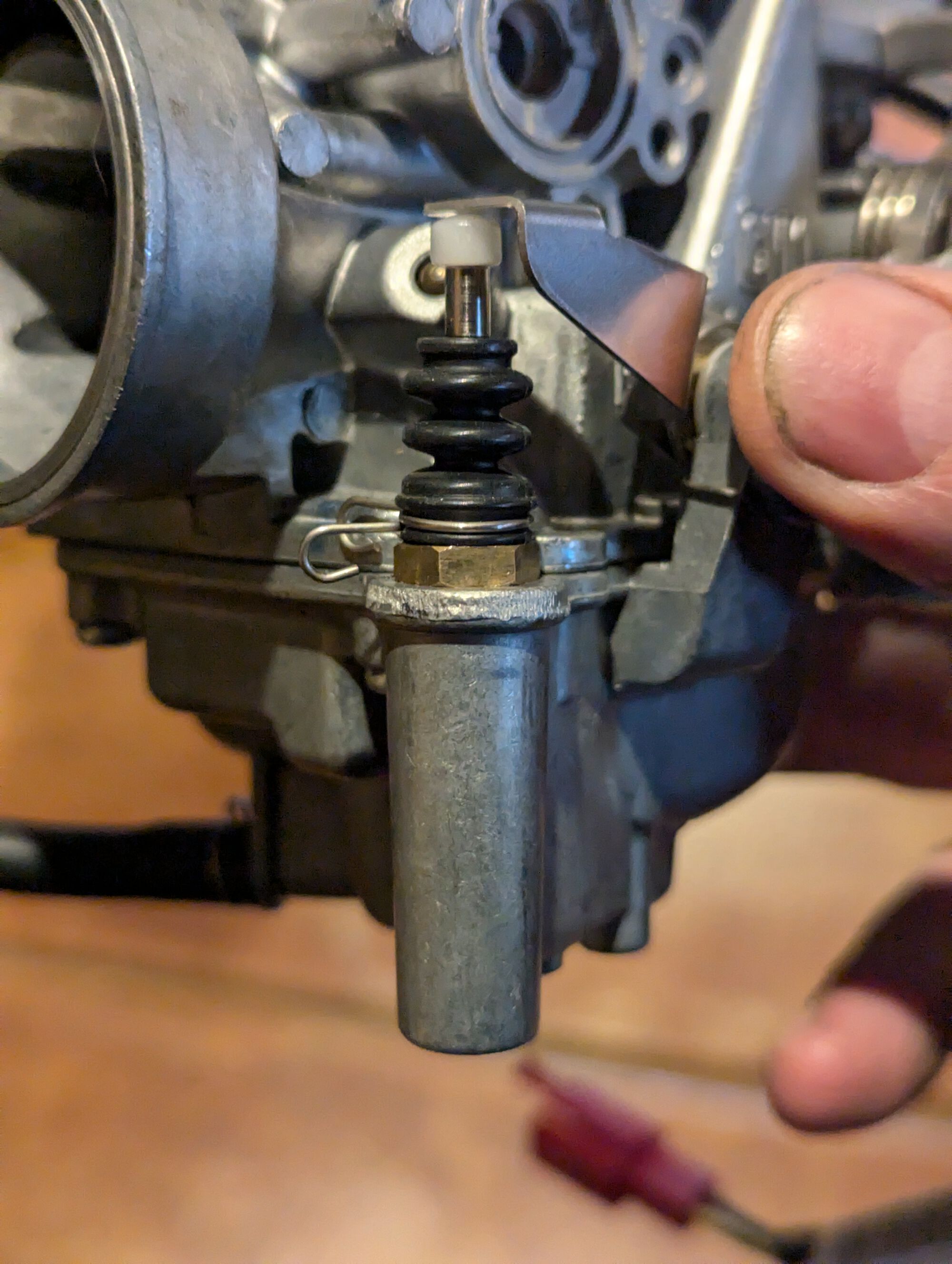

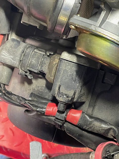

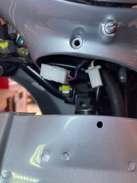

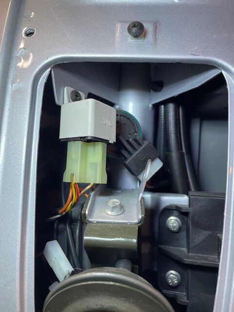

Ok, I've pulled the carb... well almost. I still have two electrical connections I need to deal with but I don't know where to disconnect them? I've followed the wiring as best I can but haven't found a connector for the two cables. Am I missing something or do they disconnect at the carb? If so, I'm guessing that I would unbolt the smaller wire on the left but where would the larger wire, the one with the black cap, unplug? Does it just pull out? As you can imagine, I don't want to try unplugging something that doesn't unplug.
Getting the two larger carb hoses disconnected was a bugger and I'm worried that putting them back on the carb is going to be a SOB. I'll probably heat the hoses but I'd welcome any other tips.
I also had a hell of a time getting the orange-labled hose off. I finally had to give the hose clamp a rather firm twist. I'm thinking that that hose is the fuel line but I was surprised that no gas came out when I finally got it off the carb. Is that telling me something?
I don't know where to disconnect these two electrical connections
Does this unbolt from the carb here or unplug elsewhere?
Where does the connection under the black cap disconnect?  Also, is the orange-labled hose the fuel line?
Don't think I'll reuse this hose clamp.
@az_slynch avatar
Posts: 2031
@az_slynch avatar
Posts: 2031
Orange is the fuel line.
The thing above it is the bystarter. There should be about a foot of wire and a red two-pin plug. Lube the connection before passing down on that tab. You may need to wiggle it a bit.
The bolt with the wire is the carb heater. There should be a black two-pin connector about 6-8 inches down the wire; remove it like the red one. I don't recommend unscrewing it with the wire connected to the harness as it might damage the connections.
Showing the bystarter plug.

I didn't see any connectors when I looked this morning but now that I know what to look for, I'll check it out tomorrow. Thanks
@fatbear5 avatar
1977 P200, 1980 P200
Posts: 1457
Location: Fresno, CA
@fatbear5 avatar
Posts: 1457
GOTCHA YA YOU BASTARD!
This morning I found the two connectors hidden in a black sheath. Of course, I couldn't slide the sheath out of the way and had to slit it to get at the connectors but I'll tape it back together when I reinstall the carb. Considering how tough it was to get the wires out of the sheath I expect it's going to be a son of a bitch putting it all back together. (I tried unscrewing the clamp that holds the sheath in place but couldn't do it.)
Thanks oz slynch for your help with this.

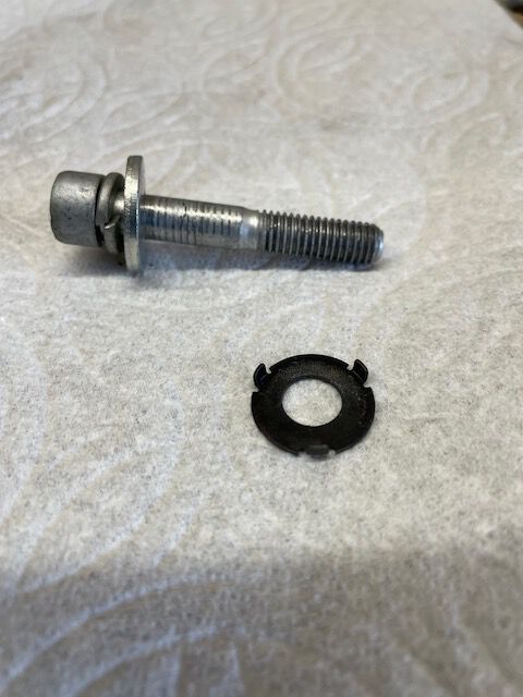

The clamp that doesn't unclamp
All it needs is a little tape.

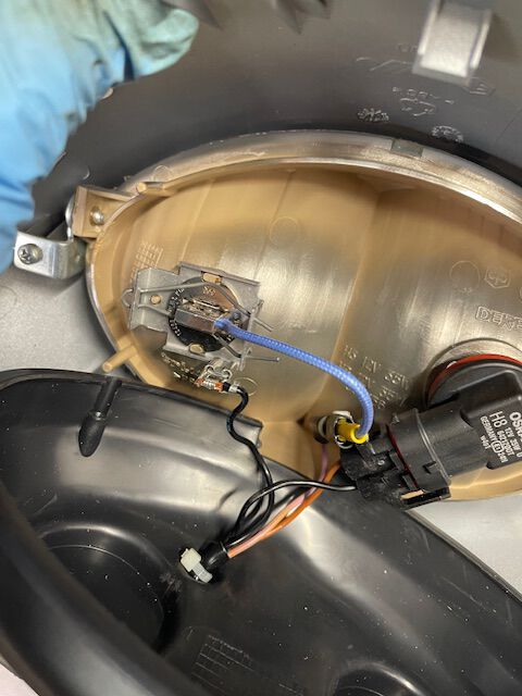

It's going to be a bugger getting this connector back in the sheath!
Damn! I couldn't slide the sheath out of the way because I was trying to unscrew the holding clamp... the one that unsnaps instead of unscrewing. I sure wish I'd figured that out before busting my butt trying to disconnect the wires.

Did you dismantle and clean out the accelerator pump? That's the plunger near the carb intake. It has a hole in the bottom of the float bowl that feeds it. You can test it by taking the bowl off, putting fluid (water works) in the bowl and pressing the plunger rod down. It should shoot a bit out of a hole in the lip of the float bowl.
Assuming that works, find the corresponding hole on the carburetor body and shoot some carb cleaner into it. It should spray a fine jet of cleaner out of the little brass nub in the carb venturi, firing towards the throttle plate.
Barring that, I'd get a metal guitar string, like an Ernie Ball #10, prop the throttle plate open, and poke it through the four holes in the venturi floor to ensure they're not blocked.

"The clamp that doesn't unclamp" should be pretty cooperative if you jam a flathead screwdriver into the gap and twist.... unless you figured that out already...and they pop closed even more easily...

Yeah, I figured out that one and all is good now. Just so many things I'm not familiar with

Damn, I hate being ignorant. But in my defense, I would say... well, actually I don't really have a defense. I just didn't do enough research.
Apparently there's a little trick about reconnecting the airbox cover and hose in order to make the engine run. I hadn't bothered with doing that since I was frequently using starter spray directly on the filter element to start the engine and I didn't think it mattered. (It's doesn't on my P200s.) But then I was watching more general videos on the ET4 just in order to learn more about them and ran across someone saying the engine won't run if the airbox is not connected. Suffice it to say that I did a quick repair and just took my first ride around the block
As I've been saying, these Twisties are a lot different from my Shiftys.
All that's not to say that I don't appreciate your help az_slynch. I had cleaned the accelerator pump but did not look at the throttle plate. I'll add that recommendation to my growing maintenance file in case I have to (God Forbid) remove the carb again.
Thanks to all who helped me with this. I'll no doubt have more questions and I get more and more involved with this ET4.
