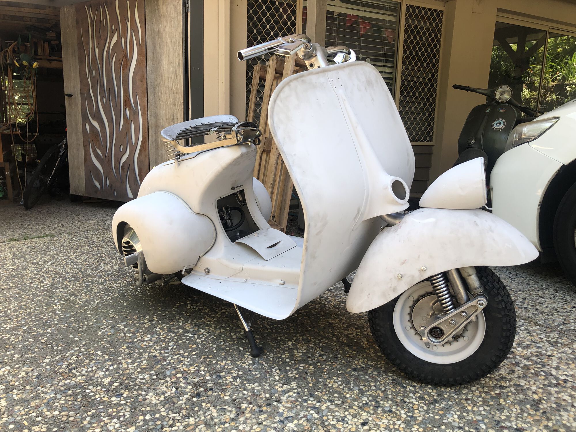

I'm looking at SIP tuning options for my 1953 wideframe. Anyone got advice on the pinasco 160 cylinder kit (SIP part number 84123J00) versus the reedvalve version (84123100)? Also thinking of stoffi polini CP23 carburettor and the SIP racing exhaust 3.0. My goal is modest power (10hp), reliability and plug-&-play. Any advice welcome, hope you read this BajaRob GickSpeed

Did this bike come with a single port engine? or is the bike VM1?

It's 2-port. The engine is from a Douglas G

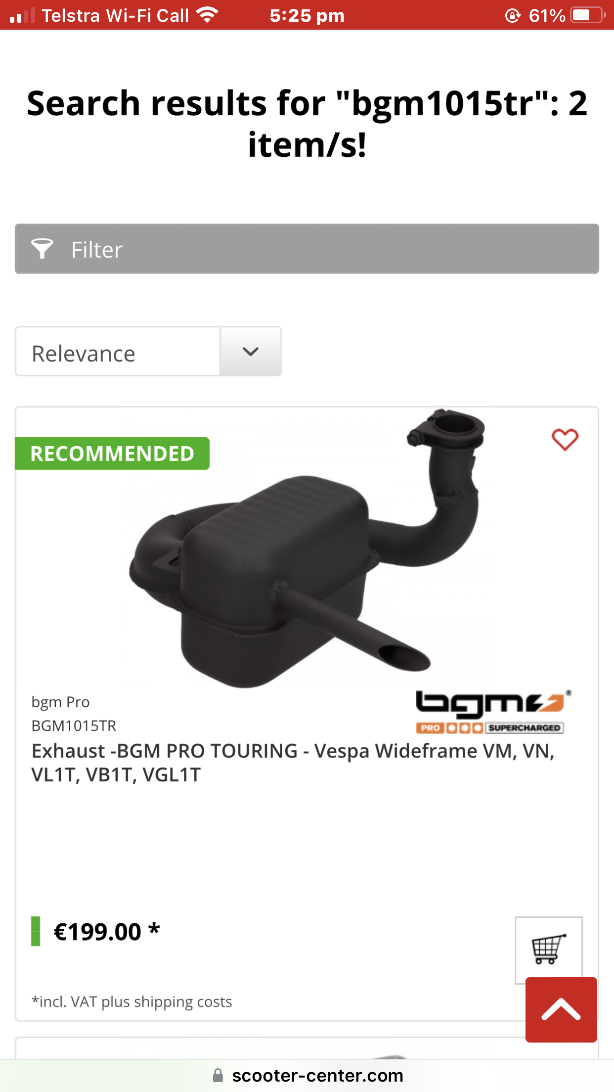

23/65 gearing. Skip that exhaust and go with the new BGM Box. Run a Vape static ignition, 57mm crankshaft, CP23 carb.

BGM Box - you mean this this one GickSpeed

Yes.
