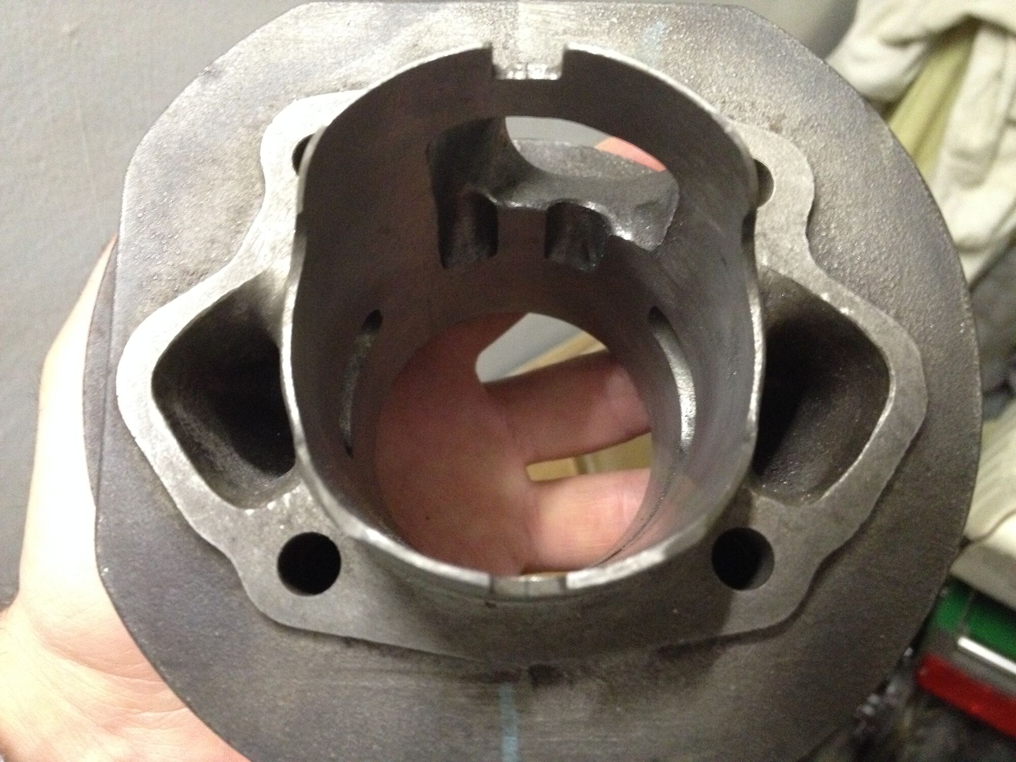

Picked up this White LUI earlier this summer. I always thought they looked cool. It is actually a lot of fun to ride and it is super light. Bonus, everything on the engine is easy to access and there is all sorts of room for exhausts.
I originally wanted to do a CP135 build, but the costs involved are more than I can justify after some other recent projects.
I decided on a CP105, claims have been made to be capable of 10hp and 60mph, we'll see.

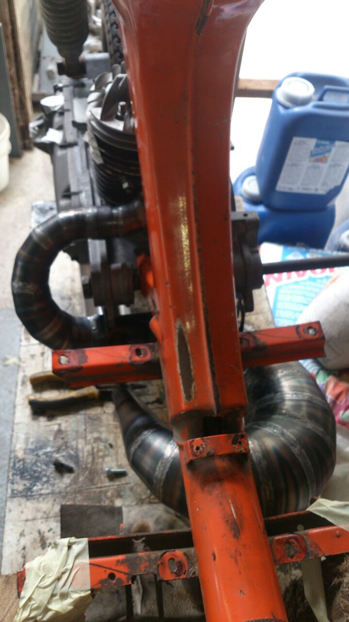

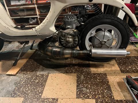

I ended up cutting the mounting brackets from the stock exhaust and welded those on. Trying to decide whether to keep the pipe unpainted and oiled, or send it off to be ceramic coated. I sort of dig the raw metal look for this bike.
Also installed new rims and tires.

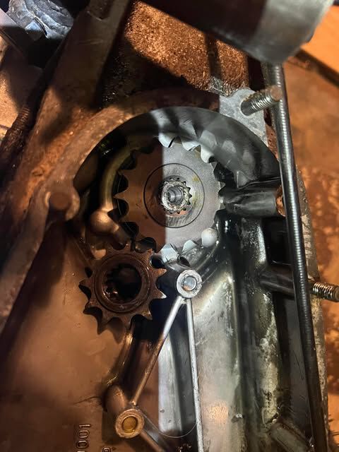

I am keeping the 3 speed for now, but making some gearing changes.
Fortunately you can just tip the LUI on it's side, remove the clutch/transmission cover and you have full access to everything.
Installed an RLC 10-15-19 gear cluster that is supposed to remedy the short 1st and 3rd. Also switched from a 11t to a 15t front drive sprocket.
I may switch to a 4 speed at some point, but this fits the budget right now.

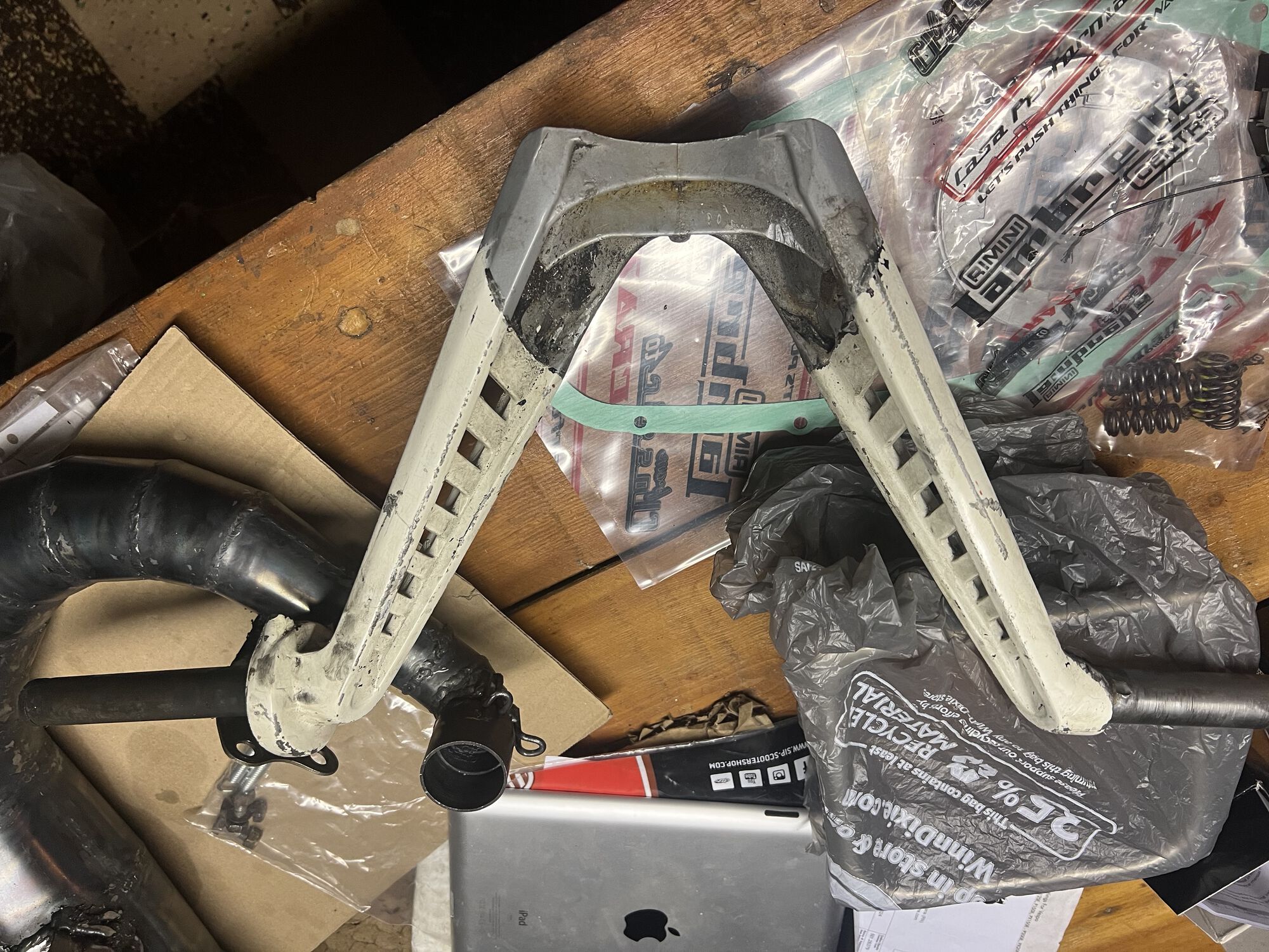

Someone painted my bars white along with the rest of the bike.
Trying to decide whether to paint these the original grey/silver or strip down to bare aluminum.

bare alum would look rad all polished up, but pain to do and pain to maintain. Clear coat would help. Grey-Silver would be nice too

keep the bars alu, matches with the bare metal of the exhaust.
This color (or similar) in Italy was available only for "Lui C" and your is "Lui CL"

As far as I can tell the bike was originally orange and the bars were a grey/silver color, someone sprayed them all white. But all sorts of parts could have been swapped out at one point or another.

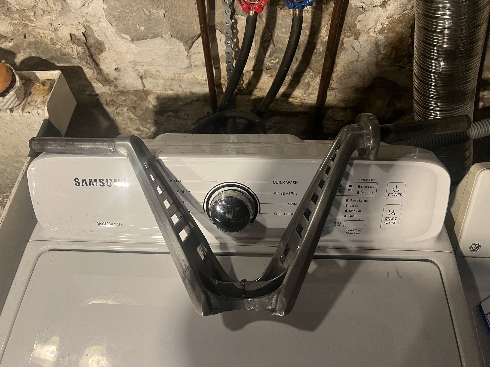

Cleaned up the bars.

Bars look great!
you threw them in the washing machine!?
they look great

Brushed on Citristrip, put them in a trash bag and waited about an hour, the layer of white came off. The original silver/gray was worn through in some places, so I brushed on some more Citristrip, bagged it, and came bag to it in the morning. The rest of the paint wiped off. Polished things up a bit, cleaned with Prepall, and then some clear coat to keep it from oxidizing.

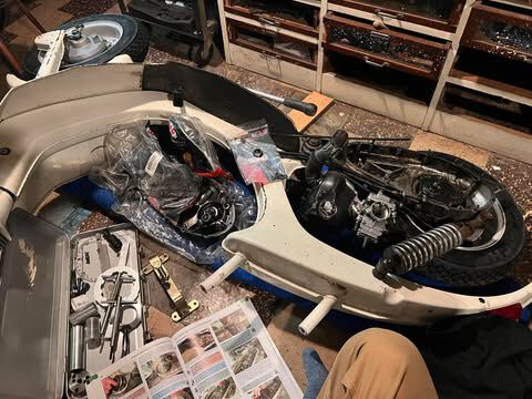

4-speed LUI parts arrived this afternoon. I am hoping to have time this weekend to swap things out. Been riding the LUI around a bit more, it's fun once it's moving. The three speed makes it tricky to have good top speed and stay in the 6k rpm range that the pipe hits, especially 2-3rd gear. Probably wouldn't matter much if I was running a box pipe.
