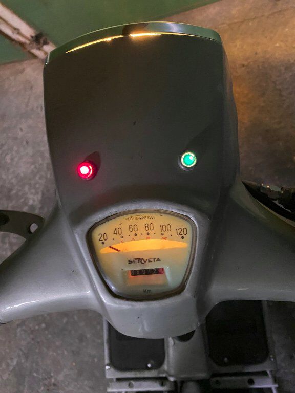

Ok, just keep in mind that 12V power needs to go to the idiot light, the idiot light needs to be connected to the fuel tap, and the other fuel tap wire needs to go to earth, not the other way round. It's a pretty reliable and fool proof system once it's hooked up.
Here's what it looks like on my 12V AC Lambretta:
Red: reserve
Green: neutral
@donarntz avatar

Yeah, I put this conversion up there with autolube, as a user-friendly time-saving piece of technology. Having to check the tank nervously every time you want to go for a ride, never being sure of exactly how far whatever seems to be left through that tiny hole and the deceptive reflection of the gas inside will allow you to go, is a thing of the past.
Just let the bike tell you when it's thirsty, and be confident that even when going full speed on the highway out in the sticks, if the light turns on just as you pass a gas station, its pessimistic configuration will allow you to get to the next gas station without having to slow down to save gas.

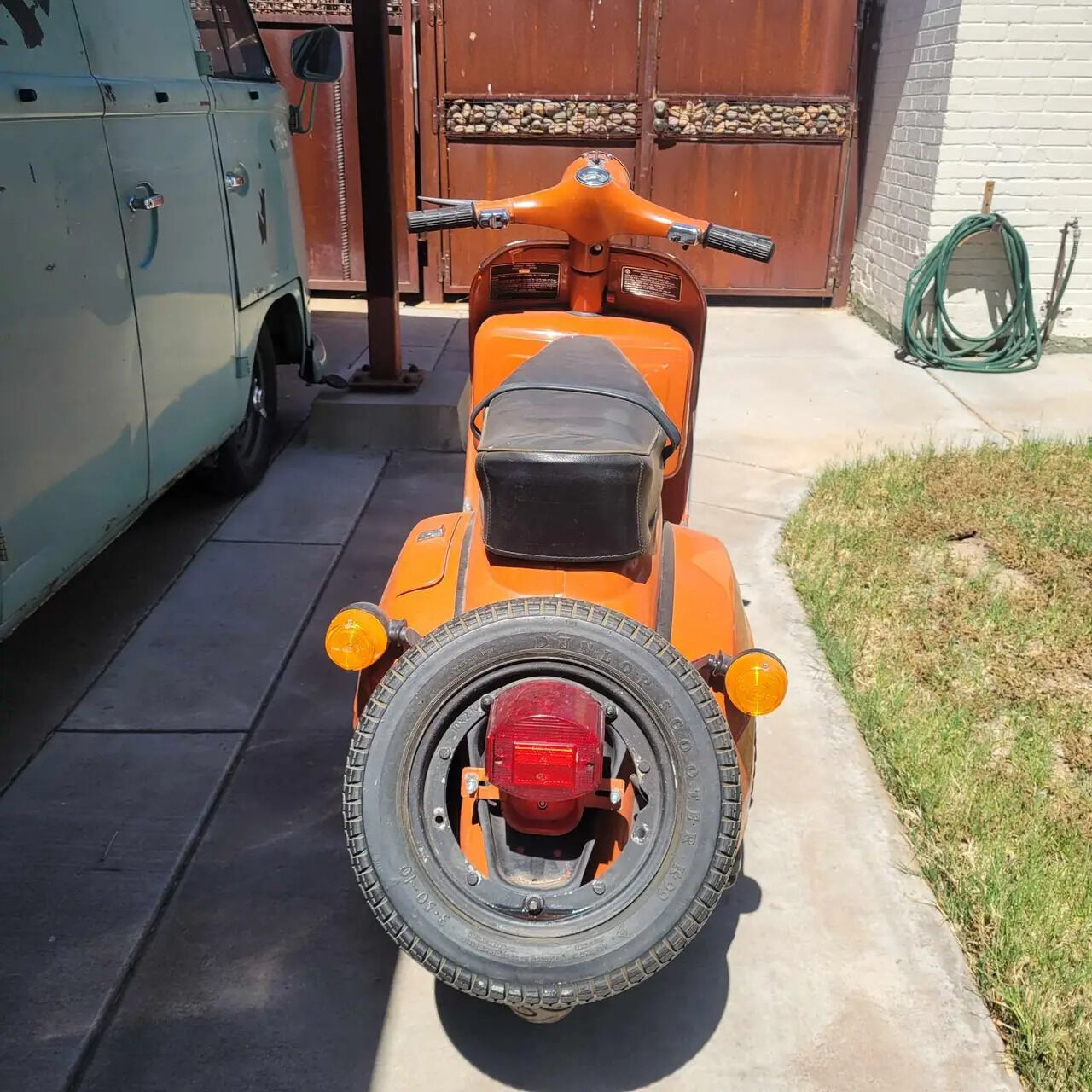

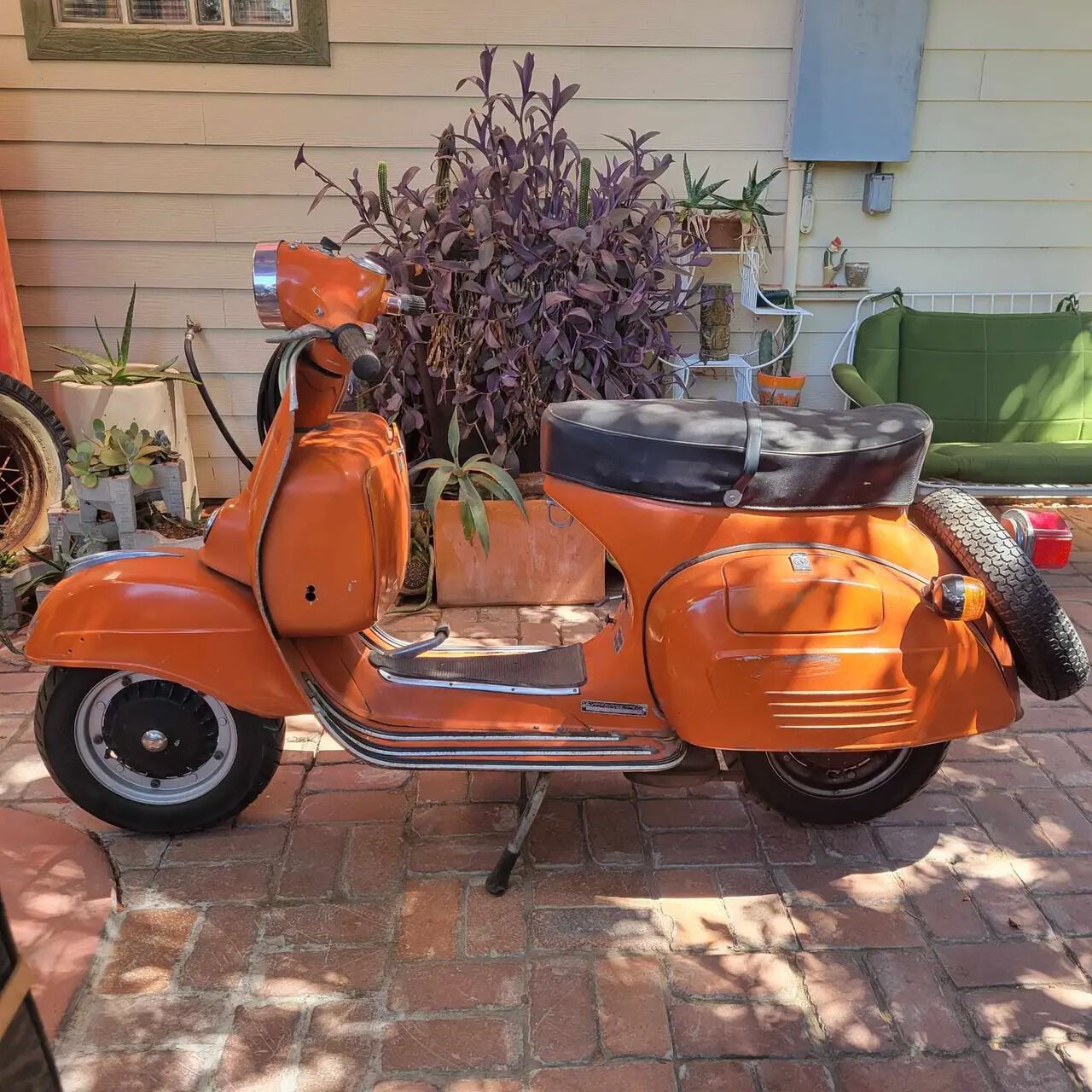

Has anyone seen a spare carrier like this? I really like it.
@avad avatar
Motovespa Tx200, T5, 50N, 90 Racer.
Posts: 57
Location: NE Scotland
@avad avatar
Posts: 57
Motovespa Supers had one like this but good luck finding any in stock anywhere.
https://www.vespajets.com/product/motovespa-125-super-rear-spare-wheel-carrier-small-frame-spare-wheel-lamp-holder/
I have one but it's not for sale but it has inspired me to look in to the possibility of doing something similar with a PK spare wheel carrier.

If you could figure out how to 3d print it and maybe figure out how to reinforce the mounting with some metal, you would be the hero of the day.

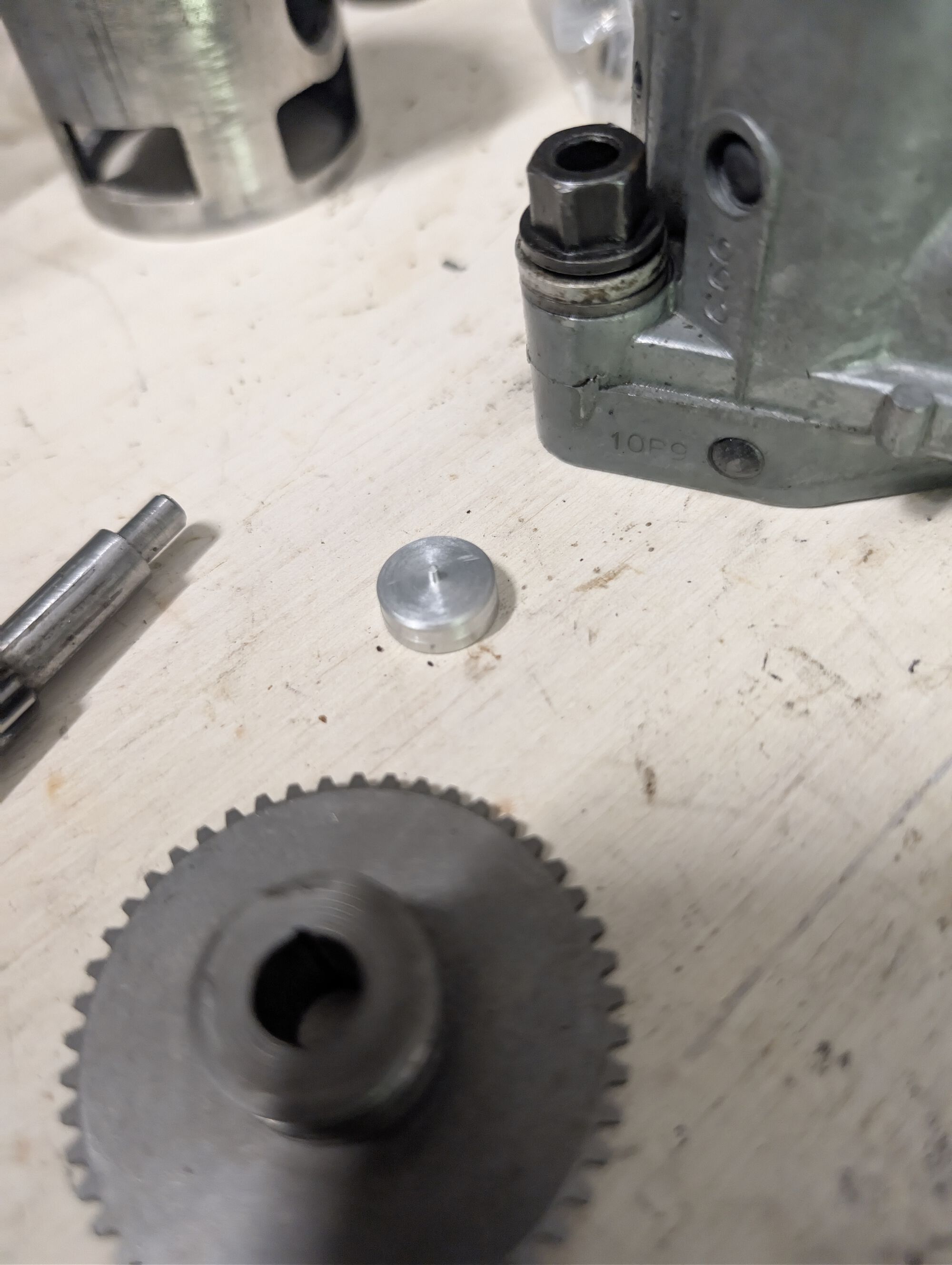

For the p125x motor going in the bajaj...

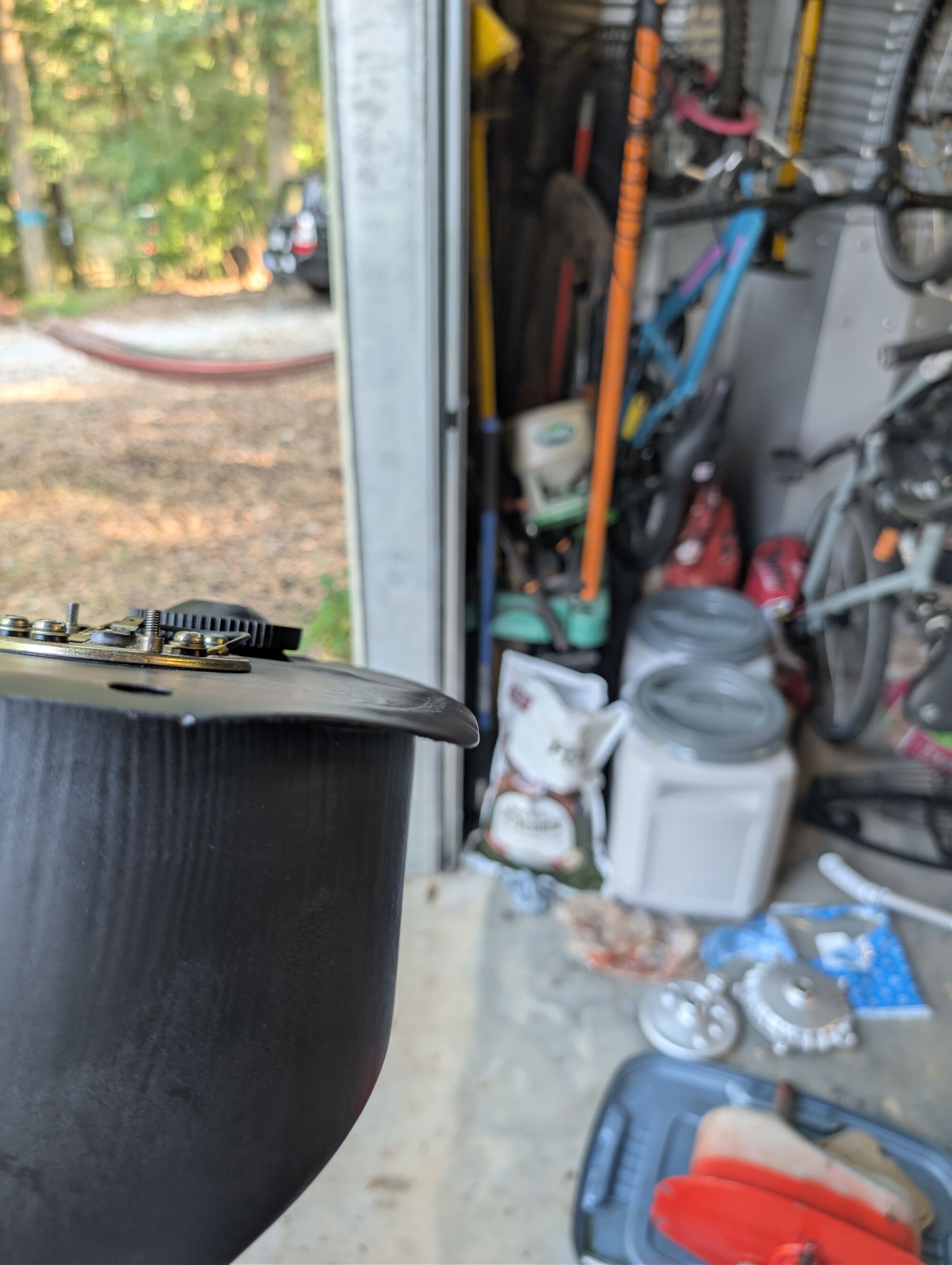

Which way does this autolube block off go? Pointy side up? Do I use some sort of gasket sealer on it?
Posts: 3028
Location: Philadelphia
Posts: 3028
Pointy side up and lock tite red is recommended.

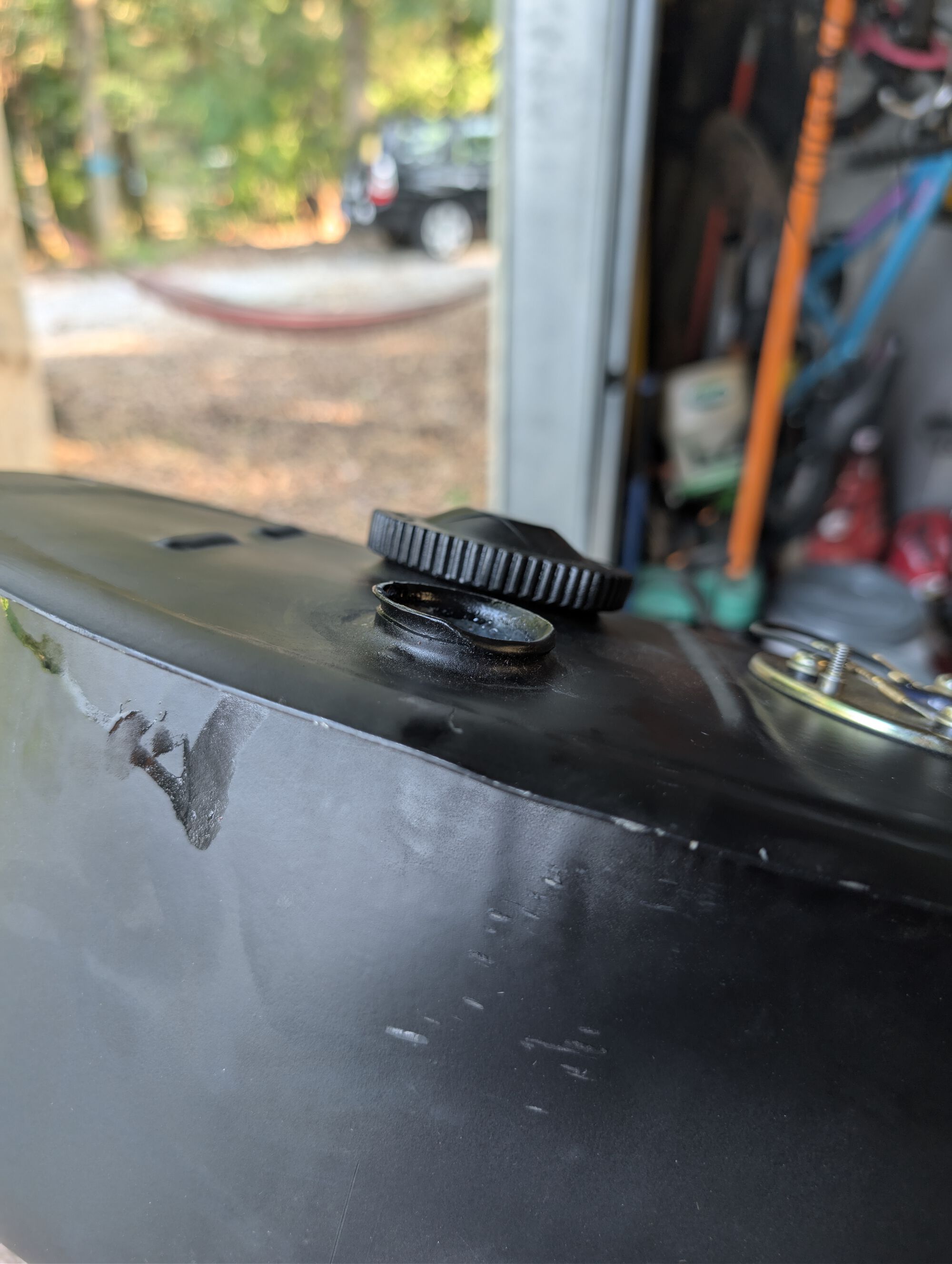

The replacement autolube tank comes with a fuel gauge. Is there anything interesting I can do with the unused gauge? I wonder how difficult it would be to have it light up the headlight indicator once it hits a certain level? I'll never ride it enough to run out of gas probably but I hate to see things go to waste. I could not find a blanking plate.
@chandlerman avatar
Innovator
Posts: 13021
Location: Nashville
305 Days Since Last Explosion
Innovator
@chandlerman avatar
Posts: 13021
Location: Nashville
Is it a potentiometer or a float switch? If it's a float switch, you just need to wire it up and you have a low fuel light.
Not a float switch, that would be too easy.
If you really want a low fuel light, you can get the SIP Fast Flow with a float switch built in.
Other than that, you need a fuel gauge and it needs to match the resistance rate of the sender, which is A Lot for something that probably won't ever work very well, anyway.
True dat. It can be worked around by adding diodes and resistors, but count on the resistance rates not matching from the get go, even within the same brand. An issue that won't occur with an on/off setup such as a reserve light.
