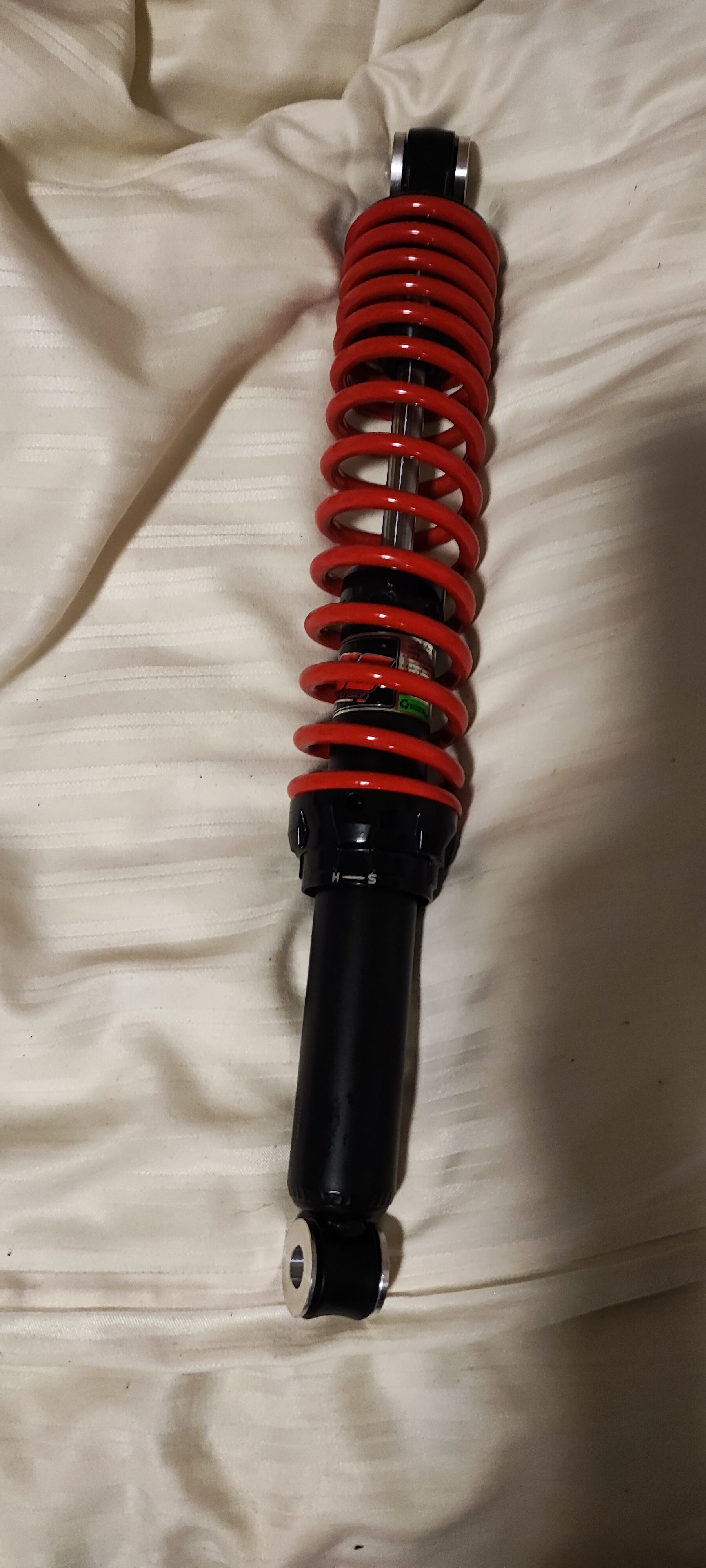

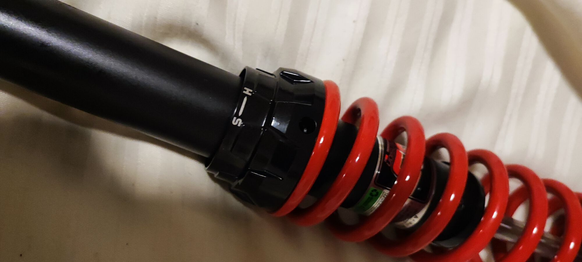

Got them today, seems quality right through! Installing them tomorrow, I'll be back... Laughing emoticon
No tool was included for the hardness but then I realised that I could change the 5 different stiffness twisting by hand since I don't change the spring compression but the gas...

New shocks work great, what a difference in comfort!
Only complaint, the lower hole is M12 while the MP3 has M10 up and down. Also the width of the lower fitting is about 5mm narrower than the original. Running it like this for now but will shim it soon.
As said, you get what you pay for...

I checked with three stores before buying, they were all selling these as MP3 compatible. I'm sure these aren't made for the MP3 specifically, they are rather generic fitting...
They do fit, they did a lot for comfort and drivability and they were fairly priced.
