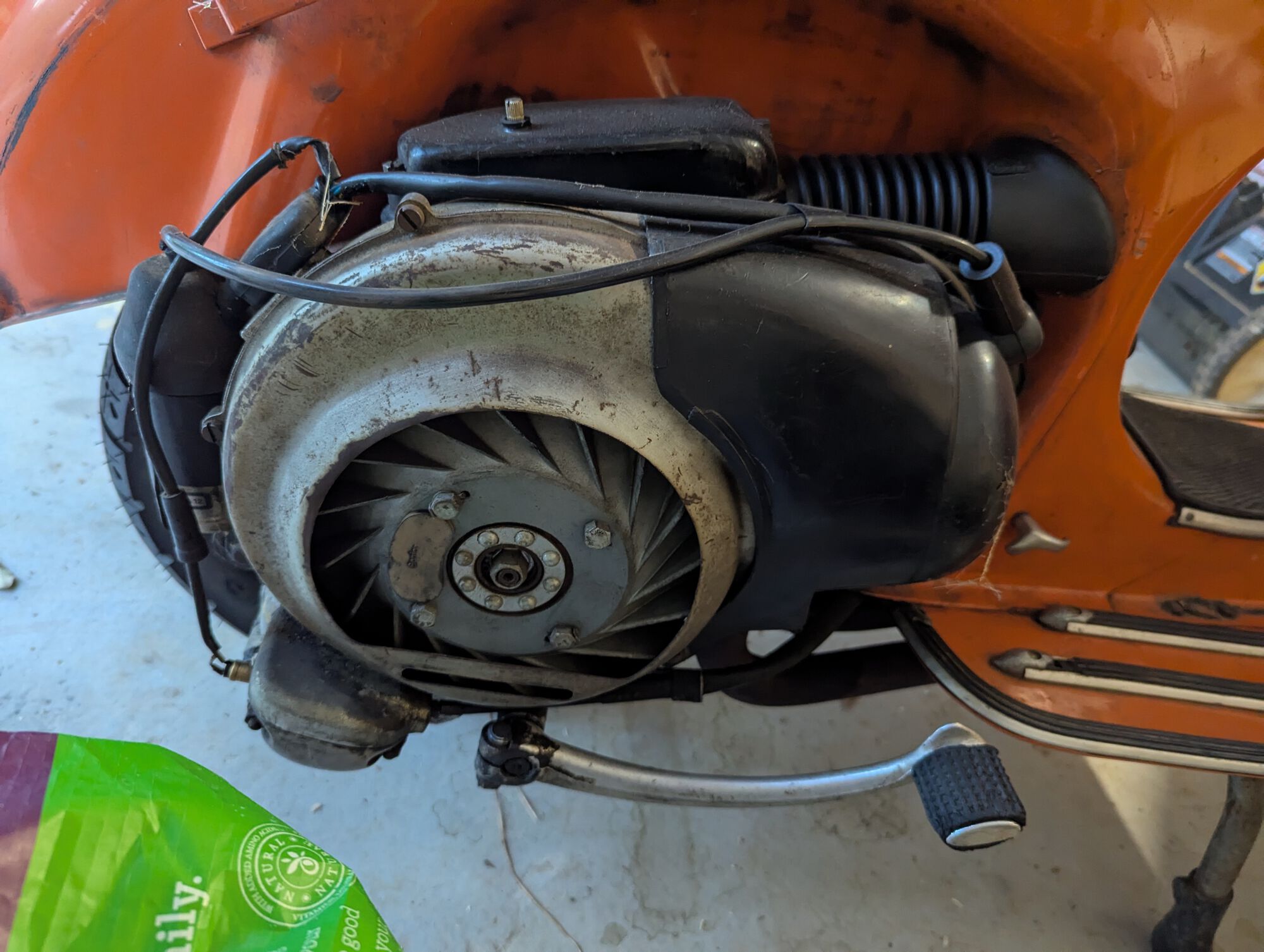

Thanks for that. I'm still in the planning stage thankfully. I got it home on sunday. I had an old vnb5 that bat city scooters threw a cheap kit and bajaj ignition on, but nothing much ever went wrong with it so I never really learned much about the engine before I sold it. I was much more comfortable with the px150. Now this old 1980 bajaj I just want to mild tune because off all the hills here. Look at the size of the coil on that thing.

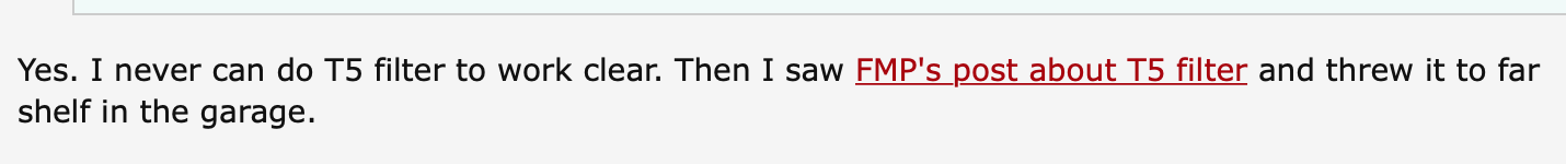

donarntz wrote:
I skimmed, it was a lot to read. So you never figured out how the T5 fubared it?
Yes. I never can do T5 filter to work clear. Then I saw FMP's post about T5 filter and threw it to far shelf in the garage.

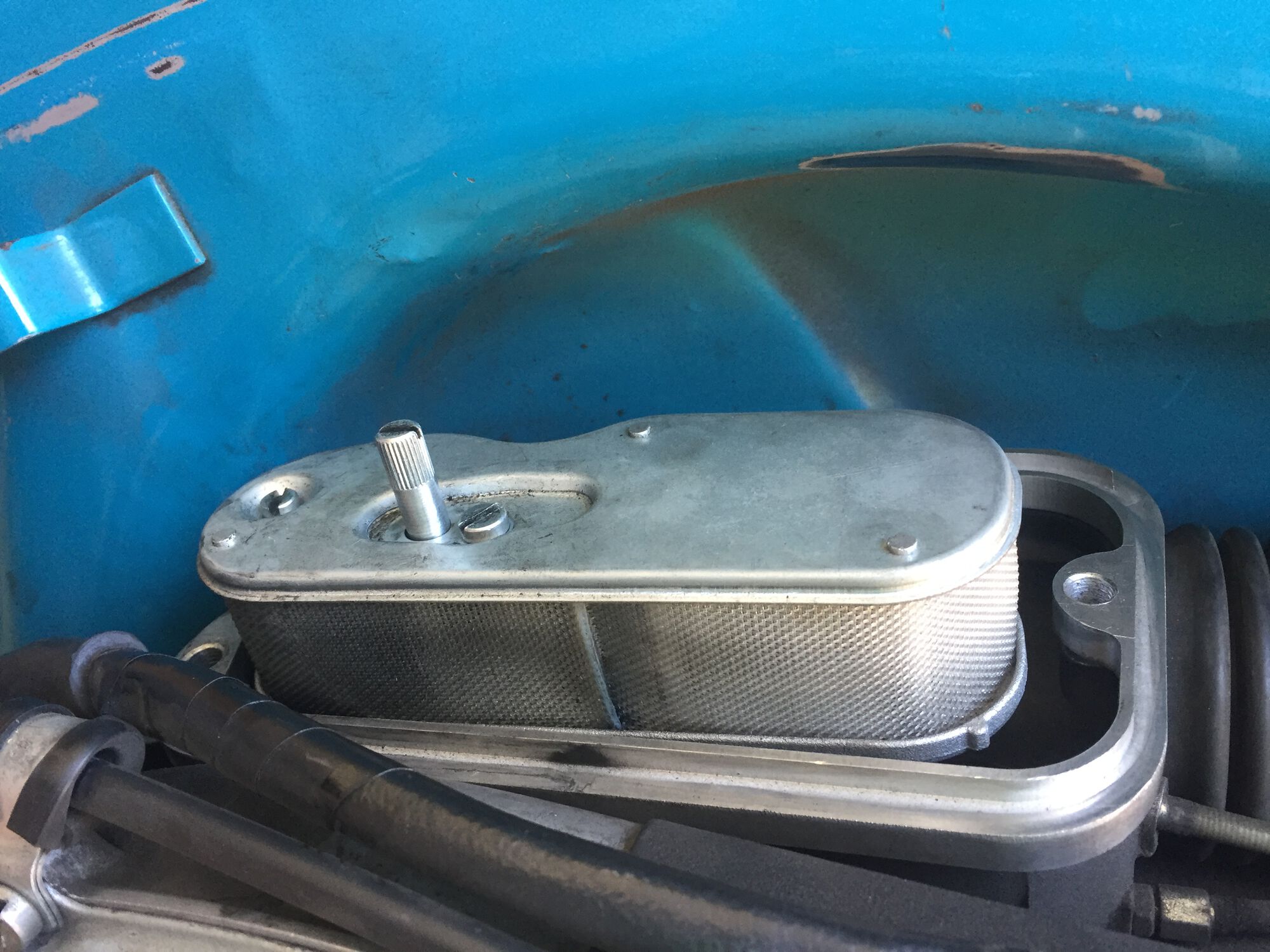

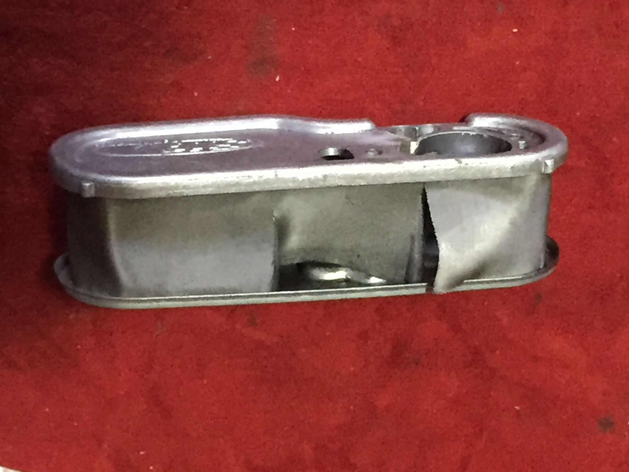

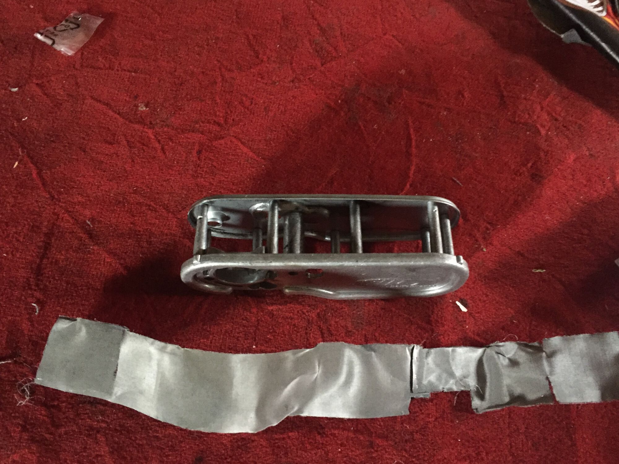

Thanks Roland. The link is tricky to uncover the details and there aren't many. One thing I picked up was FMP described the silver mesh being too fine. SIP had an earlier version with fine metal mesh. I had one and agree they are horrible. SIP changed to a nylon mesh like the original Piaggio filter. Here's a photo of the fine metal mesh that is bad and the new version with the nylon mesh.
Fine metal mesh
Fine metal mesh
Fine metal mesh torn from normal use
New nylon mesh
New nylon mesh
