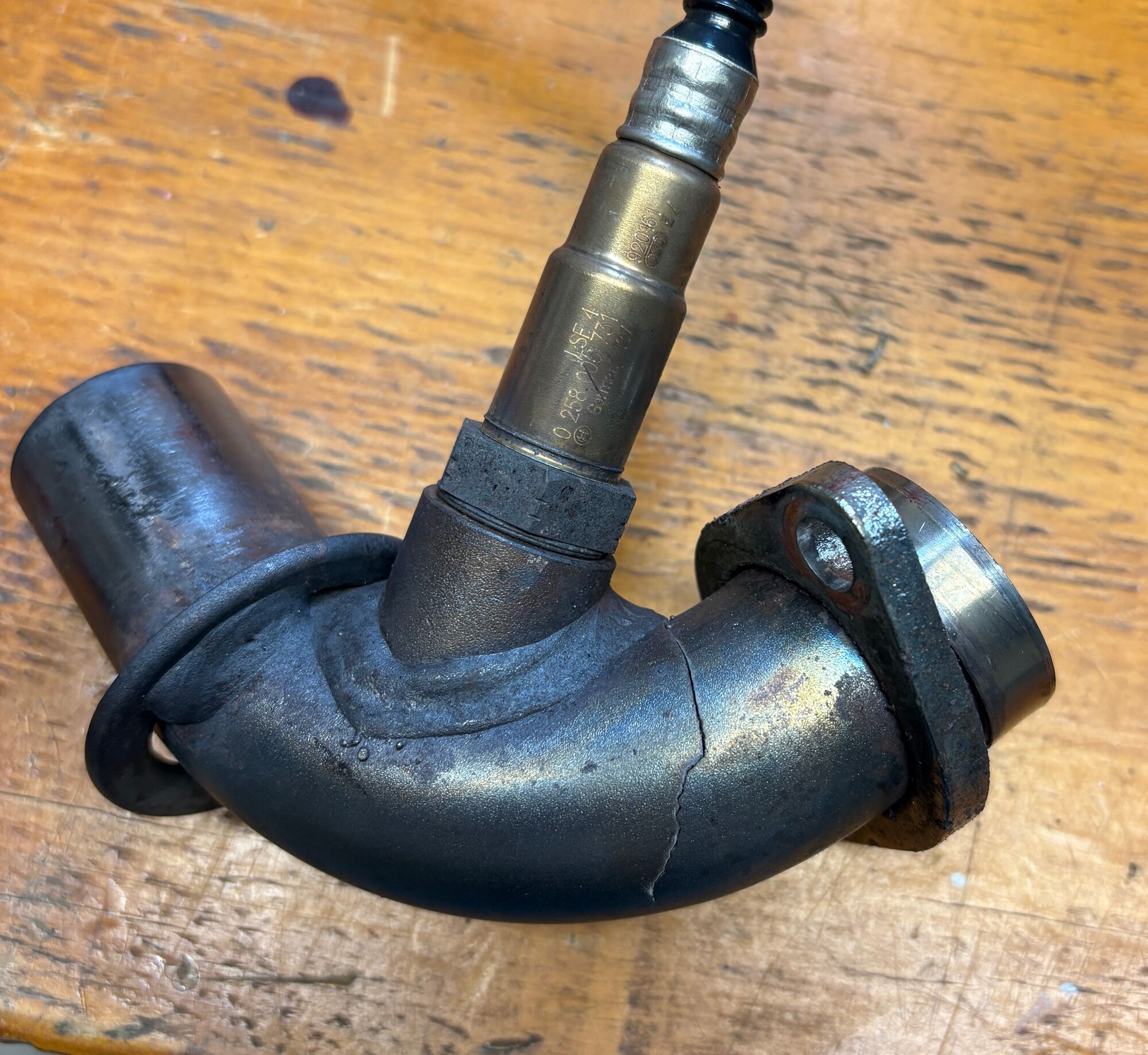

I finally got around to buying a new exhaust gasket and dropping the header off the bike. The old gasket was great, not so great was the big crack in the header pipe. At least I know I was looking in the right place.
What is the consensus?
-get the pipe welded (crack goes >50% of the circumference)?
-just buy a new part?
Posts: 8851
Posts: 8851
you appear to have an aftermarket sports exhaust. it's not unusual for the header to crack when using these (happened to me). I suggest replacing with a stainless steel header - can get from the usual places like SIP, Falan, Scooter Center (can't find on scooterwest). also on ebay and aliexpress
Depending on the material, a good TIG weld is harder than anything else. If it were my bike, and with the current wait times for parts, I would just weld and be done with it.

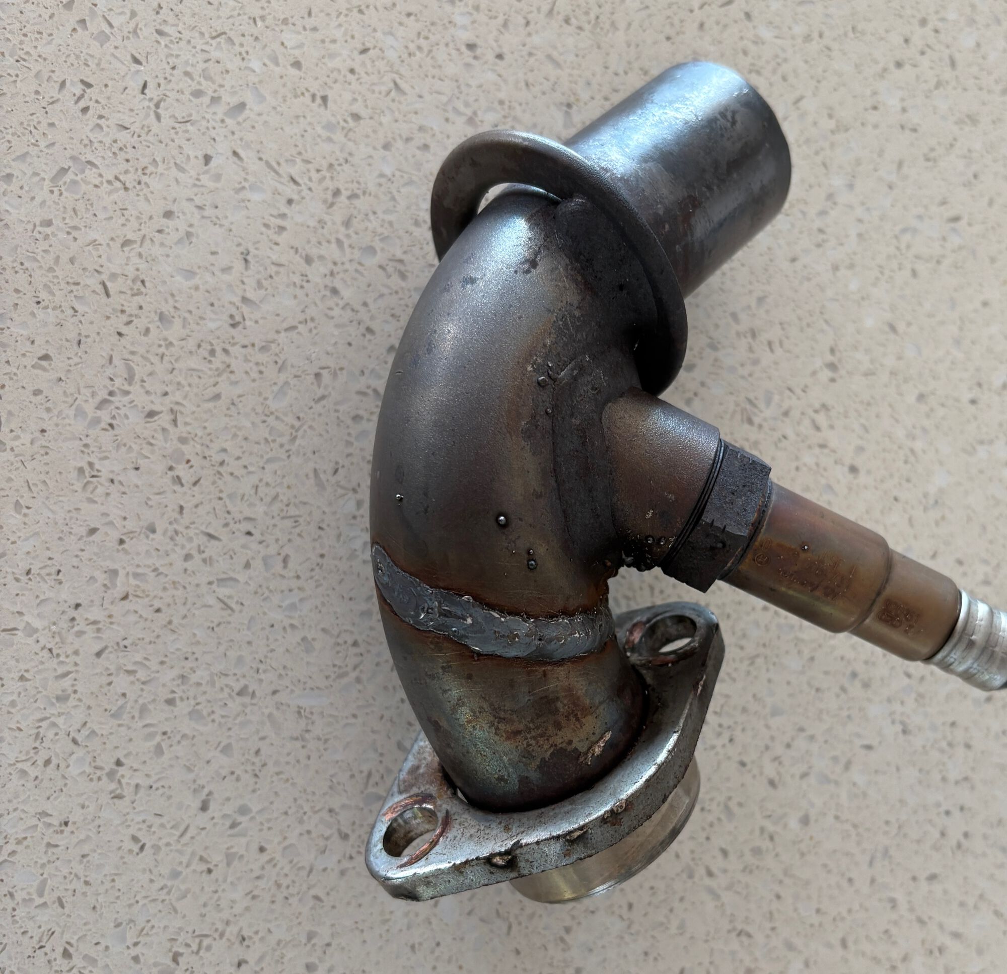

Thanks for the advice gentlemen. After some online price and availability checking I took my pipe to a local exhaust repair shop and got lucky on a Saturday morning, found a craftsman who did a while-I-waited repair and then declined payment! I gave him some cash for his trouble.

SteelBytes wrote:
I didn't know Racing Planet makes this part. Now it's back on the menu. Learn something new every day.
Posts: 23423
Posts: 23423
now that you have it repaired go ahead and get the SS one a coming. cause it will crack again.

@yellow300gts avatar
300 GTS supertech HPE
Posts: 78
Location: Icy Norway:)
Posts: 78
guess this is kind of a common problem, as i did the same fix to mine.....have not cracked again....sweet cheep fix:)
