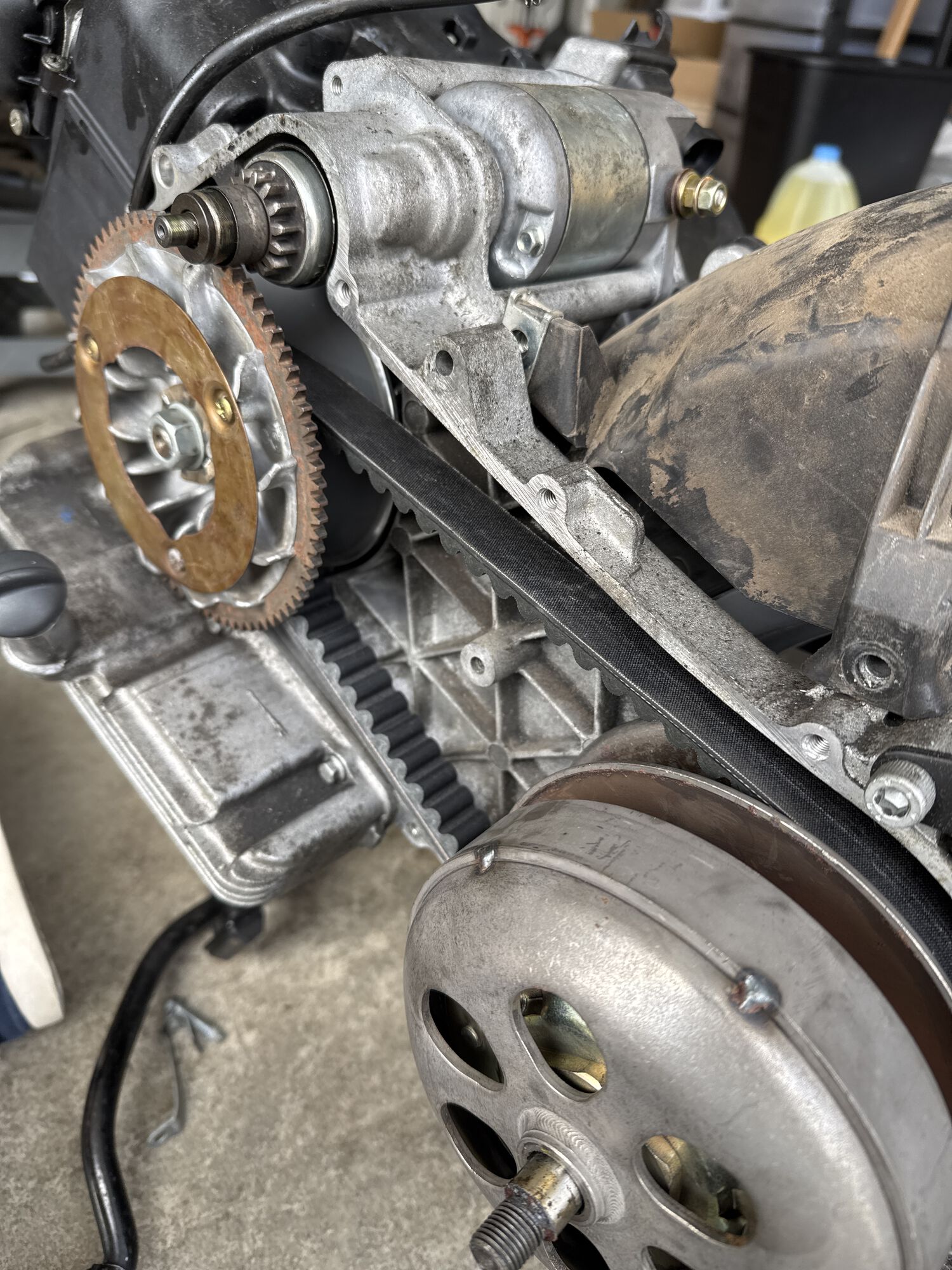

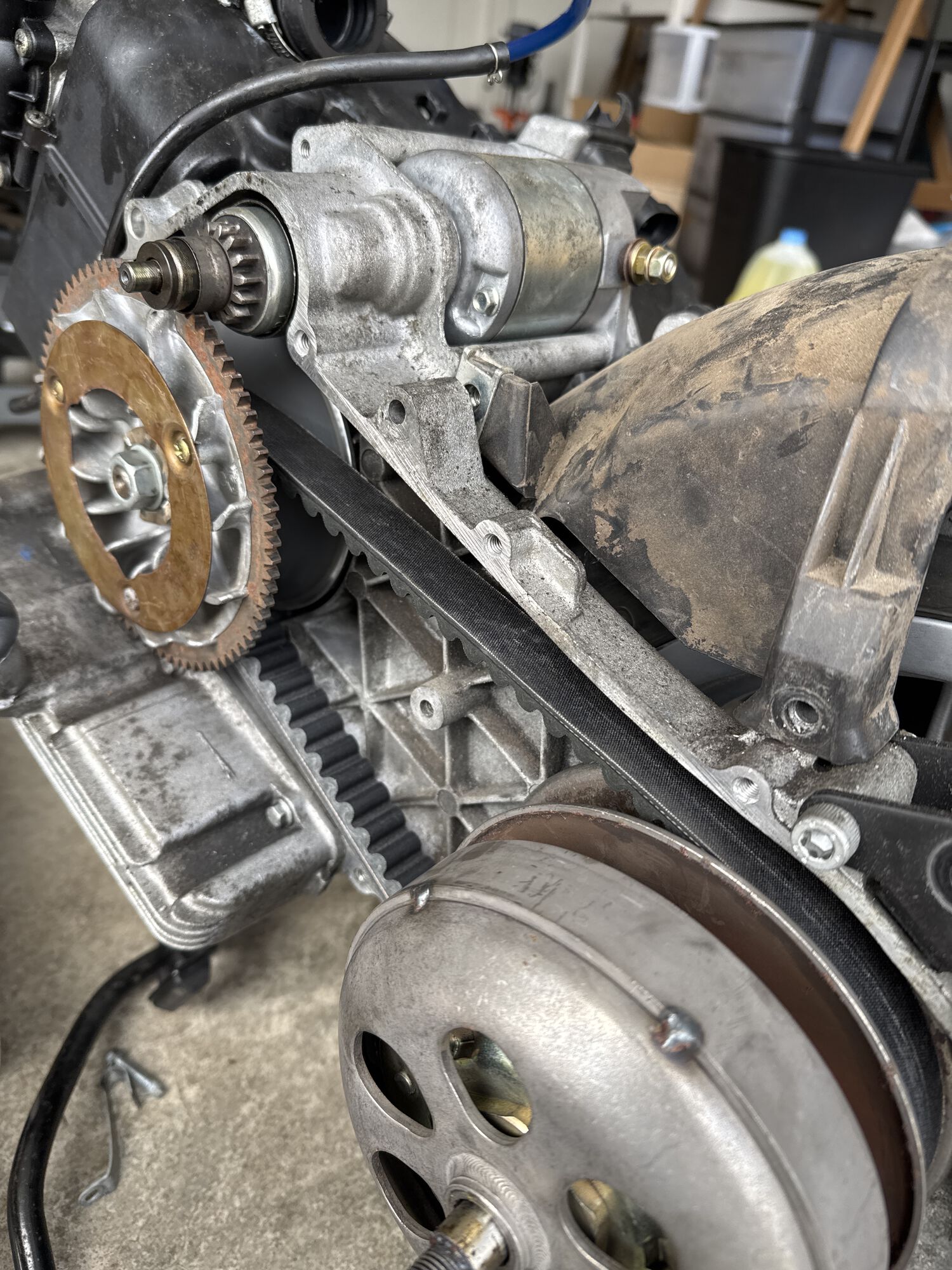

Got the engine opened up - crankshaft seems to be toast - a lot of play sideways and not spinning free.
Not sure what I'm looking for with the bearings in both parts of the cases - no visible damage to "half-bushings" there.

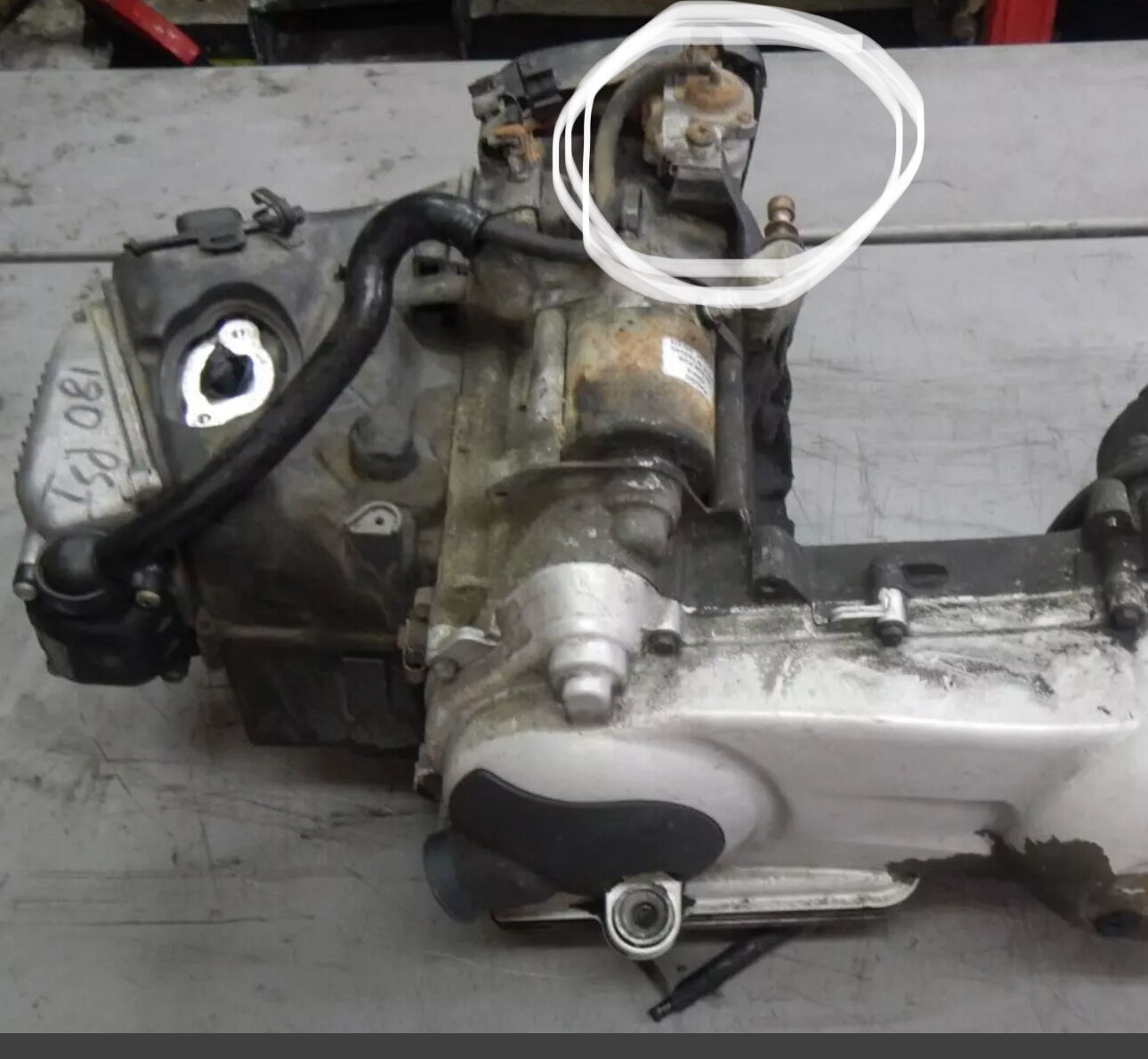

Hi guys, thank you for responding here. So, bought an ET4 2001 150 motor, the scooter had the evap system removed by the previous owner, now that I am at the final (hopefully) stage of assembling - I have a question. This engine, unlike the previous LX150 2008, does not have this part (I assume a part of EVAP system?) circled in the picture:
So, the question is - where do I plug in the blue hose that people usually plug in to the T-connector(in the picture)?

the other end of that blue hose goes to the petcock attached to the fuel tank. It's a suction line that opens the petcock valve and allows fuel to flow from the tank to the carb. The suction from the engine intake via the intake manifold is what is generating the suction in the blue hose. Sometimes if you have a stuck petcock, it will flow fuel without needing suction, in which case the blue hose would be irrelevant.
The photo from ebay you linked to has the same intake manifold as your LX150. Or you can swap the intake manifold from your LX150.
That part is the vacuum valve for SAS secondary air system, emission control on later scoots. Not needed and often deleted along with EVAP.

The carb at this point has been cleaned a 100 times. All the jets are clean, the diaphragm seated properly, the accelerator pump works perfectly.
No air leaks anywhere.
Air filter was cleaned out and lightly oiled.
In addition to that, replaced a belt, clutch bell, variator today.
Fuel mixture screw is out 2.5
The moped rides well past 10mph - got to 50 no problem.
But, once again, from a dead stop, even when warm - almost cuts out during acceleration.
Played around with the screw - the bike dies when it's all the way in, but, regardless of what "out" position it is in - as soon as I start slowing accelerating - it's sputtering and trying to die on me.

Hmmm, perplexing. Does it run and rev normally on the center stand?
If so I wonder if the CVT is "sticking" in a high gear - even though you've replaced several components, for whatever reason the belt isn't getting all the way down as close to the crankshaft as it should be. So the engine is lugging at low speeds when it's loaded. It won't show this behavior unloaded on the center stand.
What happens when you go up a long, steep hill starting at high speed? This is the opposite, or complement perhaps, of the standing start that is giving you problems now. The transmission should downshift and keep you going at high RPM but lower speed. If the engine bogs this way it could be an indication that it can't get into a low gear ratio.
This drove me crazy on my buddy's Buddy because it felt so much like a carb problem and fuel starvation. It turned out to be corrosion and debris on the bushing (tube) that the variator is supposed to smoothly slide in and out on. It often, randomly, would bind in high gear and wouldn't slide out.
I suppose this could also happen if the variator had been assembled with a spacer washer missing, or out of order - the opposite of the so-called "Fuzzy washer" mod described here that for some models adds an additional or thicker spacer washer for extra pep off the line at low speed.
It that isn't the issue, can you definitively rule out the carb by temporarily swapping in a known working carb?

The bike does this when on center stand/unloaded… I try to throttle it and it lags.
No issues going uphill.
Assembled correctly - double checked.
Rechecked the valves too - up to specs.
Don't have a spare carburetor to check and a local store (Portland) doesn't do returns if I buy one and figure that that isn't the issue.
Will keep googling/trying
