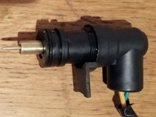

Here's some more data.. from a similar scooter with a Gurtner carb with same electric choke.
To test it, remove it and apply 12 v to it.. the needle should extend after a couple-3 minutes, as it warms up.
I took mine apart to see how it works inside.
I used my car battery.

Thanks for everyone's input. Finally warmed up here in DC a bit and I had a chance to fiddle with it again. After some adjustments to the mixture and idle speed on my brand new Dell'orto carb, I was able to get it running pretty reliably. Took her around the bock 6-8 time with no stalls at the stop signs. Then took her about 0.7 miles to the grocery store with no stalls. She started right up when I came back out. May still get her looked at just to be safe, but will see how it goes first over the next few rides.

Put a new spark plug in and still not catching and starting. I have tested fuel, compression, battery, and spark — all are good.
What now? 😭😆

Just posted update yesterday. Seems like new carb needed to be adjusted a bit. Mixture and idle. Seems OK now. Going to take her out again today to make sure she's still OK. Realize, though that I replaced nearly everything. petcock, fuel lines, carb, reed valve setup, spark plug, gas, air filter, etc.
