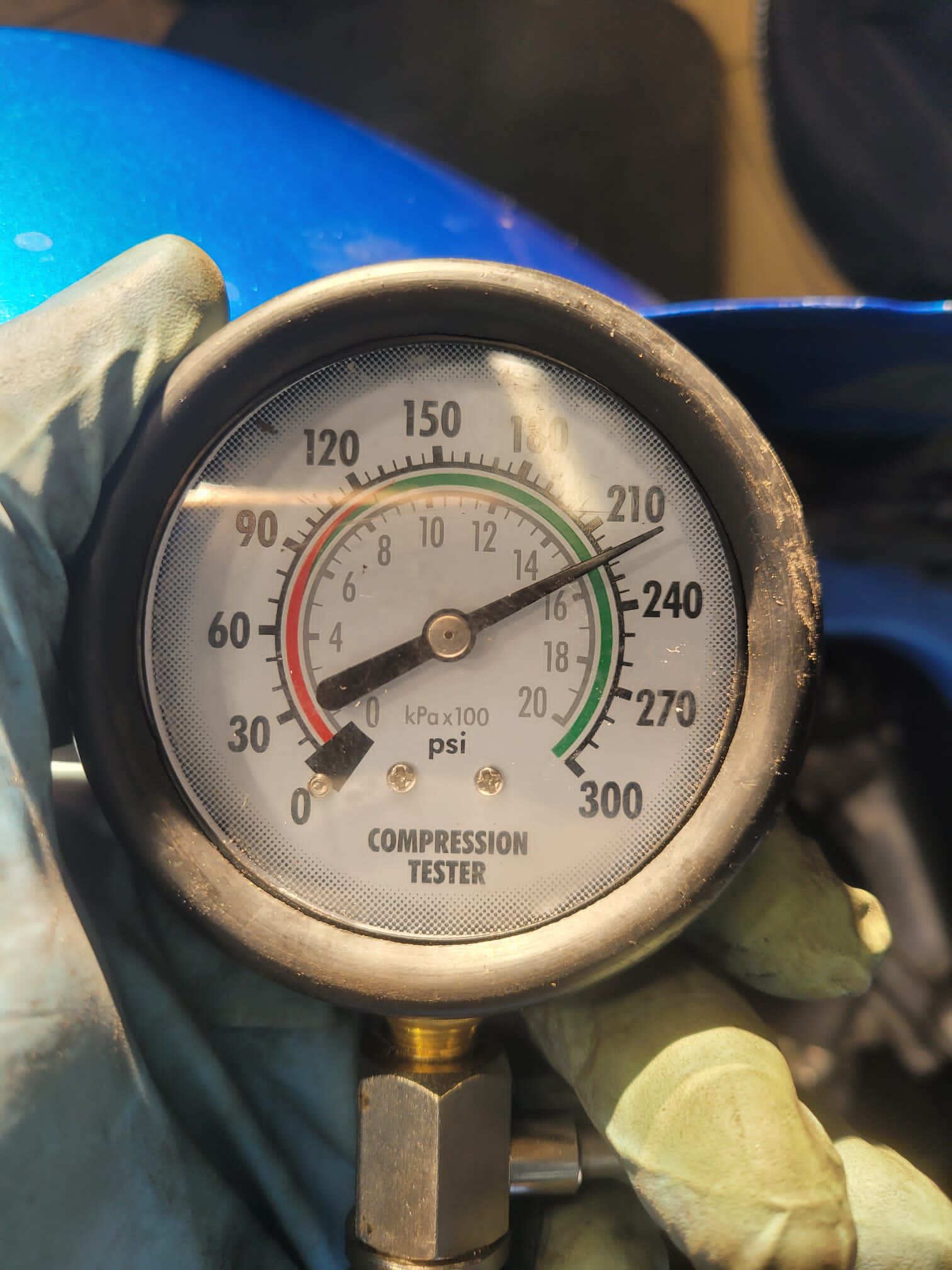

I left my Vespa at one moto mechanic garage (not specialized in Piaggios) and he said at the first sight that the engine might be seized... It is hard to believe you can start and ride when engine is seized.
Anyway, he checked the compression and it is around 220 PSI (photo attached)
Any ideas what may be the reason?
