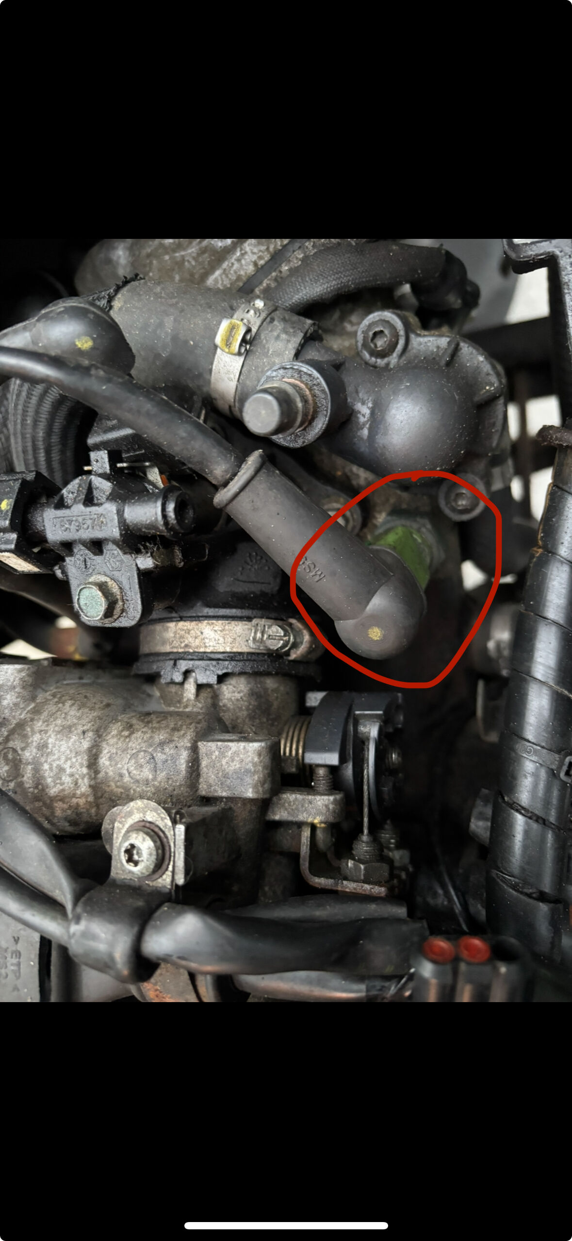

The sensor for the gauge you mean the green one next to the thermostat housing? It goes straight into the engine? If so, that one I haven't replaced.
Can you please tell me where the other sensor to the ECU is located? By the way I checked the fuses and all look good. Just to be sure I will be replacing them all today or tomorrow.
Is there a way to check if the fan has seized?
Posts: 46410
Posts: 46410
Both sensors are in the same unit. They cannot be separated. However, they are electrically distinct. If one fails, the whole unit has to be replaced.

Just to be sure, you mean this unit right:
Posts: 46410
Posts: 46410
Yes.
