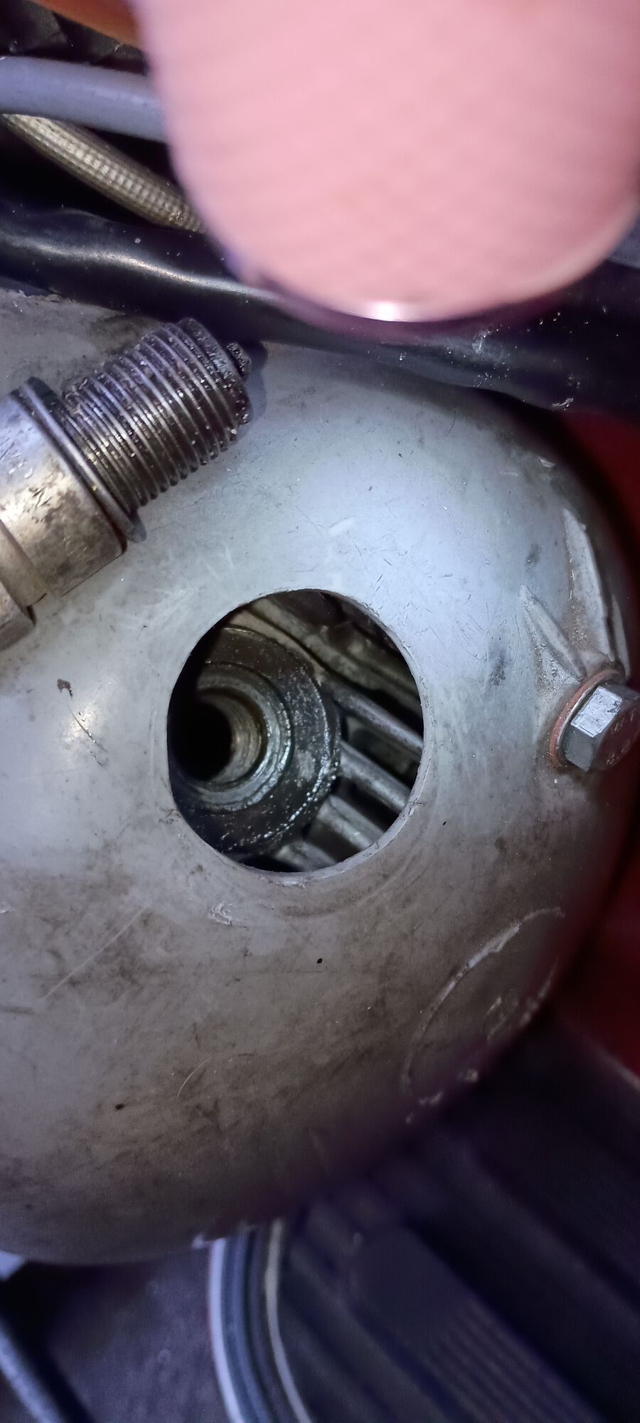

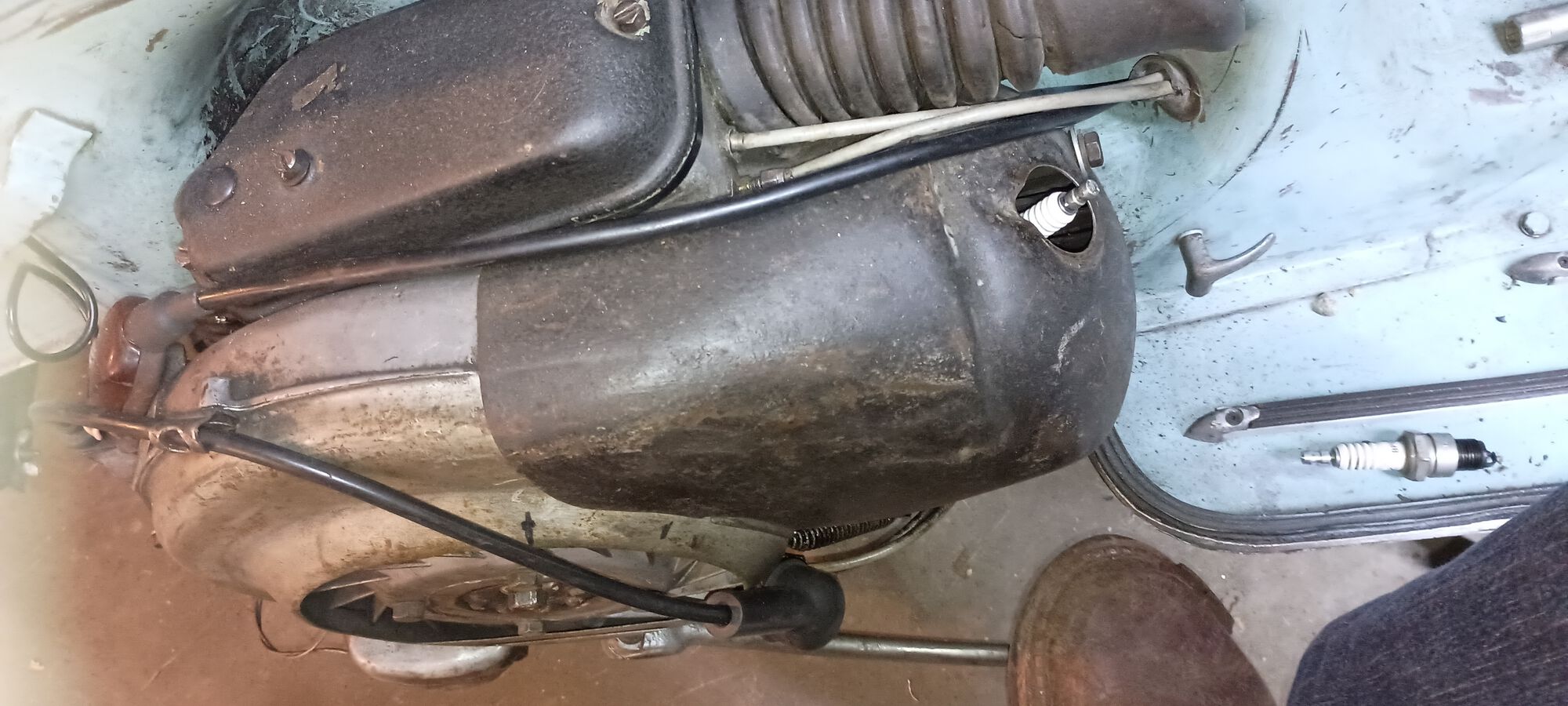

Hi, I have this engine in my '58Allstate, but it keeps fouling plugs. What is the correct plug or best plug to use in this?

I would fit a b6es in a stock motor. Fouling plugs is not usually a plug issue, more carburettor adjustment or ignition issues. If you're unlucky it might be a mechanical problem.
Which plug are you running? Post a picture, we might be able to tell what's up.

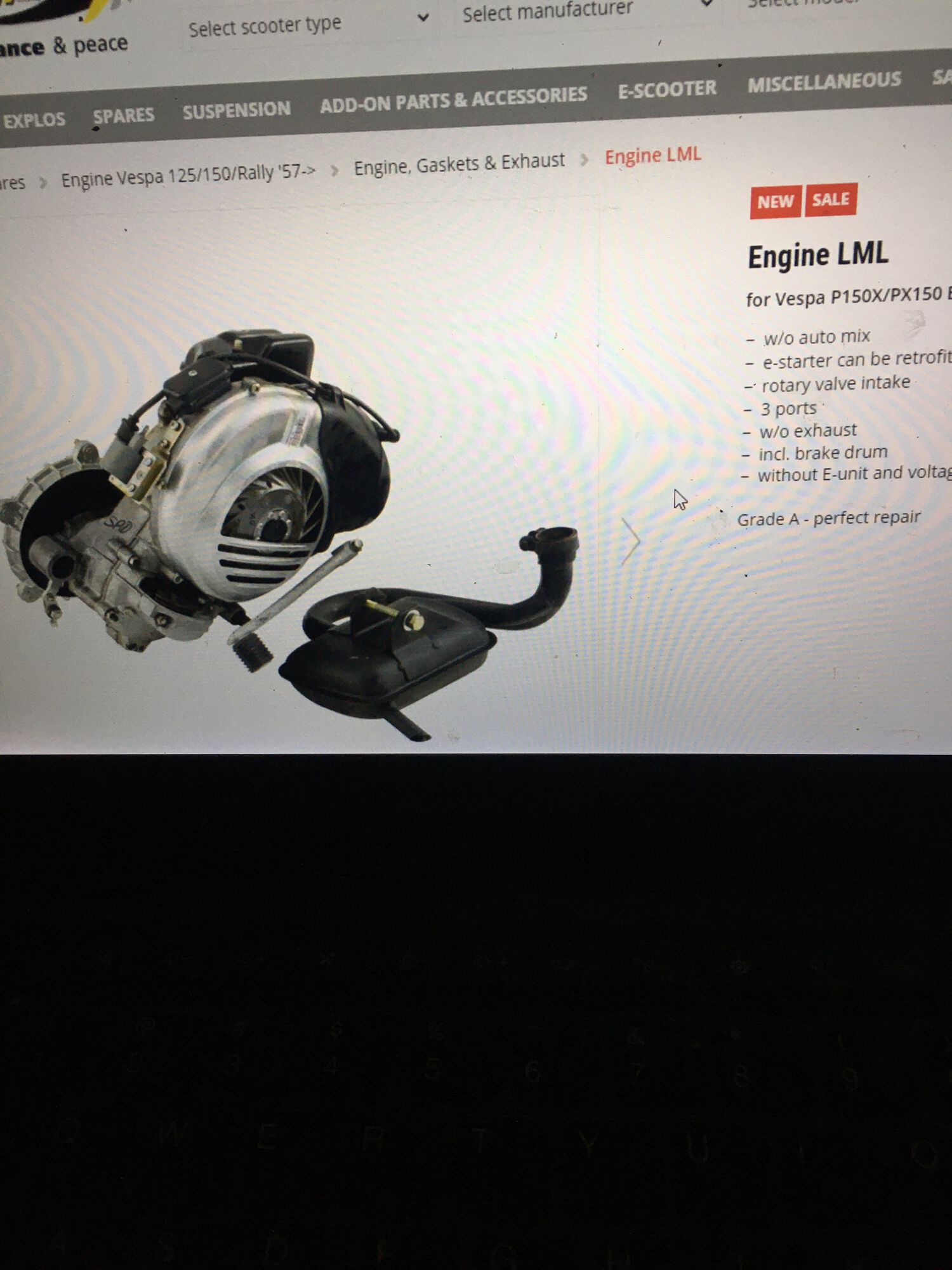

I don't know what happened. Sitting for weeks, fired up after 3-4 kicks. I let it idle for a while before riding, so it was probably loaded up with fuel. then stalled and couldn't restart. not sure if this plug is correct or not. Not sure if HS and ES are vastly different. Can anyone tell me the correct one for an LML engine?
Mercato I believe says ES.
PS I closed gap to .008 as well.
Please school me thanks!

Thats way too rich. You could try a hotter plug, a 6HS. You could try adjusting your mix screw on your carb. Possibly a leaking seal, would guess crank but im sure an expert will come on board soon. Rule out the obvious first, clean your carb out, carb spray all the jets etc, clean your air filter (lack of air = rich). Check you havent put a mix jug under your seat in the air intake hole of frame, or a rag blocking that. Adjust the mix screw at back, couple of turns out to start and go from there.

So I need to continue with HS? Not extended threads ?
I'm confused because I thought I had an LML engine and on Mercato it says to use an ES plug
But I had an HS in there…

I've never owned a Stella either but pretty sure the LML 150 is an ES plug. The Vespa PX150 is an HS plug
@kowalski avatar
2005 Stellalossi 177 Fe
Posts: 685
Location: MA
@kowalski avatar
Posts: 685
Location: MA
Stella plug is ES, but that's for reed intake. OP shows rotary intake. I think LML made both. Plug might be different.

Or put a screw driver down plug hole and measure when piston top position. If it's supposed to use short reach and you put on long reach you will punch a hole in piston crown . But yes as suggested take off cylinder head and check by putting plug in, seems sensible .
Posts: 10081
Posts: 10081
That's a good idea that will help you decide, and agreed, pull the head to 100% confirm. But let me go look down that hole w/ light... BRB
Interesting, you can see to tell but you almost need to see both types to know the difference. I also wanted to see if a long plug in a short plug motor would actually hit the piston and punch a hole, or would easily burn a hole when the adjacent area gets too hot and turns to aluminum cheese before blowing thru.
LML motor
LML motor
Vespa 150 motor, hard to see much difference in pic but it's there
Long plug in Vespa 150 motor, spins free.
 It sure doesn't physically hit but obv a bad idea.
Long plug in Vespa 150 motor, spins free. It sure doesn't physically hit but obv a bad idea.

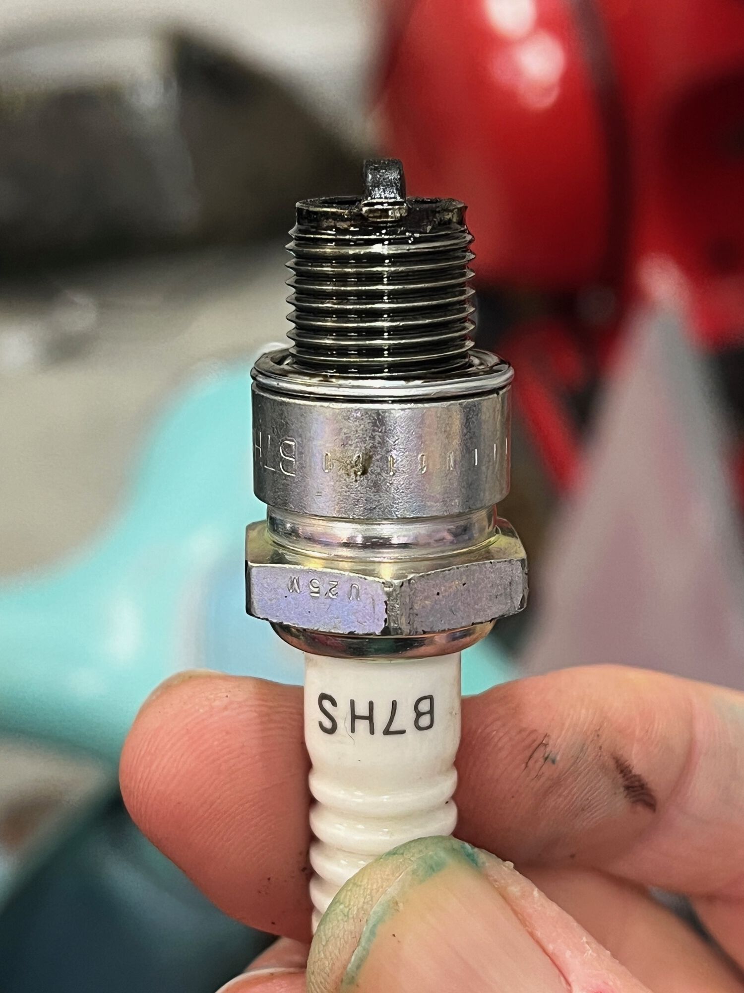

update- got the bike running yesterday, new plug 7HS. would start on a spray of starting fluid then goosed it to stay running but then would die. By holding the choke on it would start again and run but wouldn't idle. This was not the case prior. it would run and idle fine. Should I mess with the idle screw? I forget which way to turn to advance and retard...
Thanks!

Check the gear oil to rule out a seal leak
Thanks!
Turning it in (clockwise) leans it, counter clockwise richens it.

Have you cleaned out the carb ? Complete strip down , carb cleaner , compressed air, air filter , filter to float bowl, gaskets, float etc . Take it off and give it a good going over. Then whilst carb out adjust mix screw to 1.5 turns out for starters . As jack said , drain off gearbox oil into a plastic pot, if it stinks of petrol you've got a leak, maybe crank seal flywheel side.
I think you are both referring to the mixture screw, the idle screw affects neither advance nor retard, nor how lean or rich it is.
Maybe this would help you dial it in: Mixture screw adjustment, got a good link?
