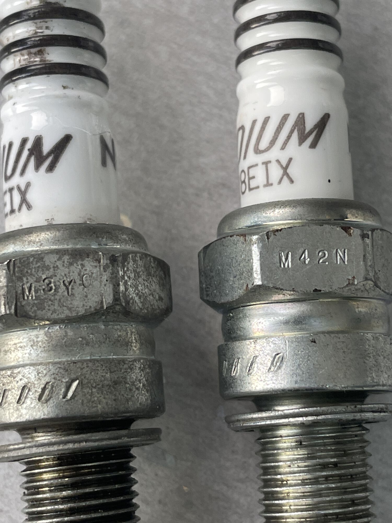

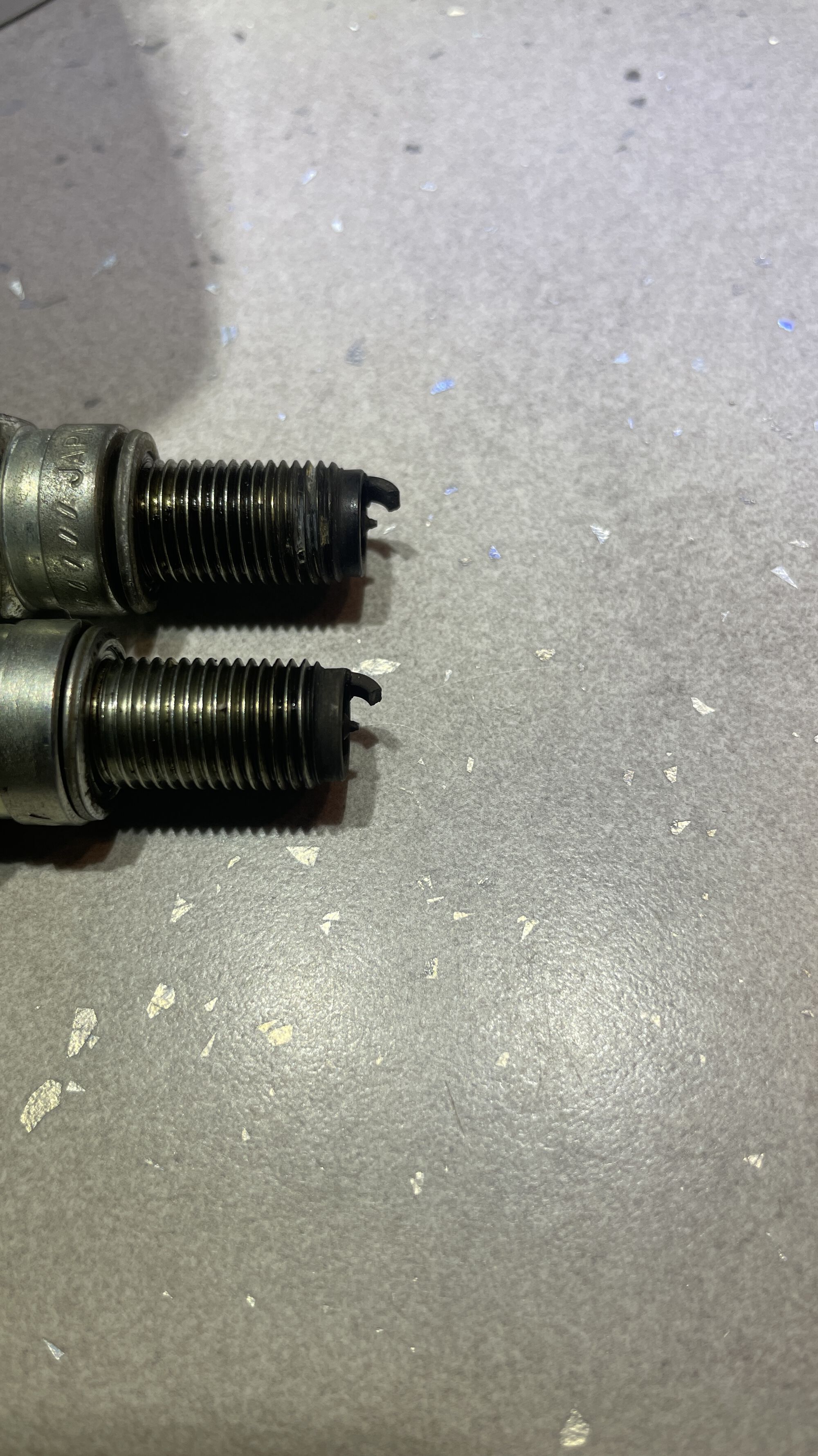

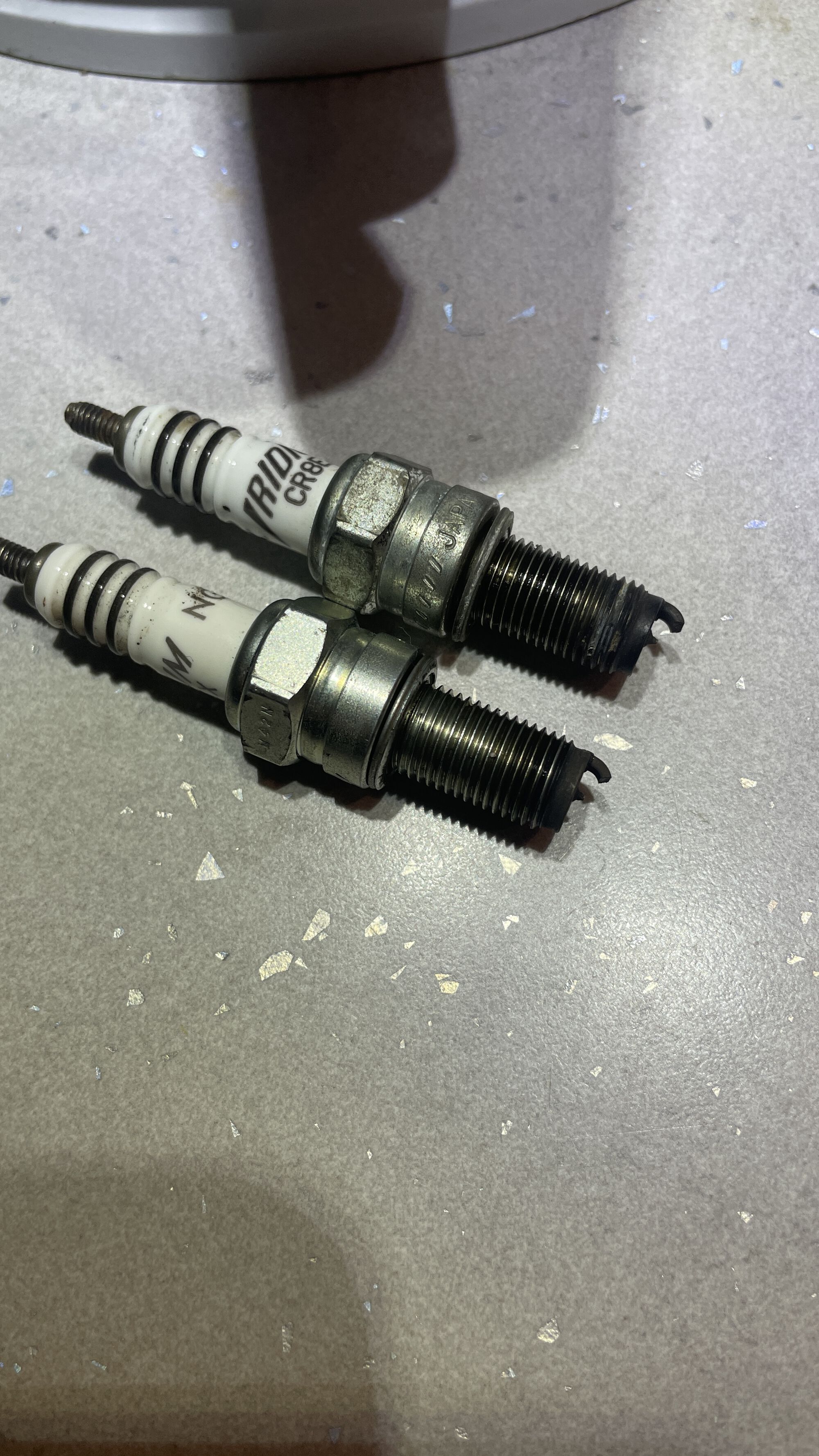

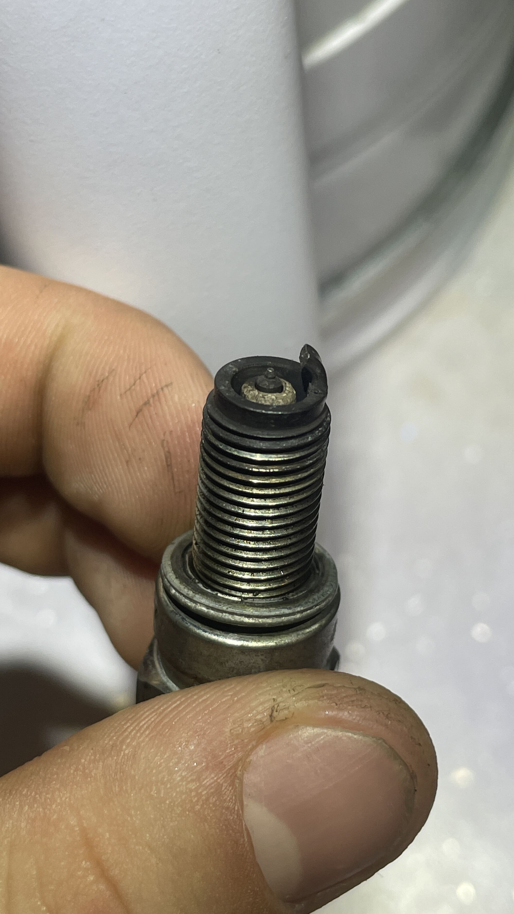

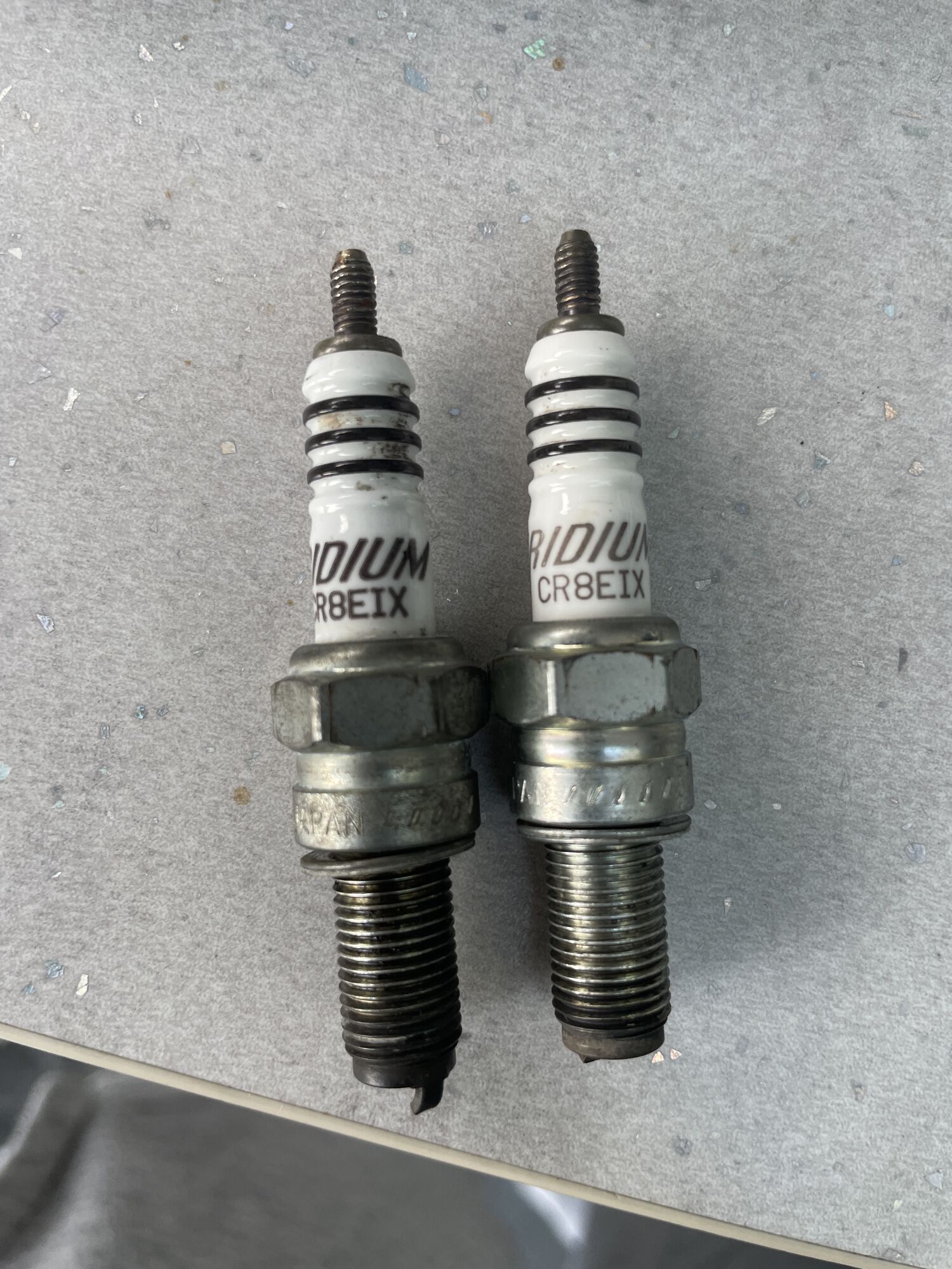

I've attached a picture below of two spark plugs that I've purchased at Halfords about a month apart from each other both of which have broken in the same place I've been trying to think of my reasonable explanation for this but nothing comes to mind the plugs are perfectly colour so mixture is good I have my eyes on temp gauge and it never goes past half way what could be the cause for these spark plugs to break this way?
Posts: 735
Location: UK
Posts: 735
Location: UK
Is it the correct grade of spark plug? If not, is it too long and the piston is hitting the electrode?

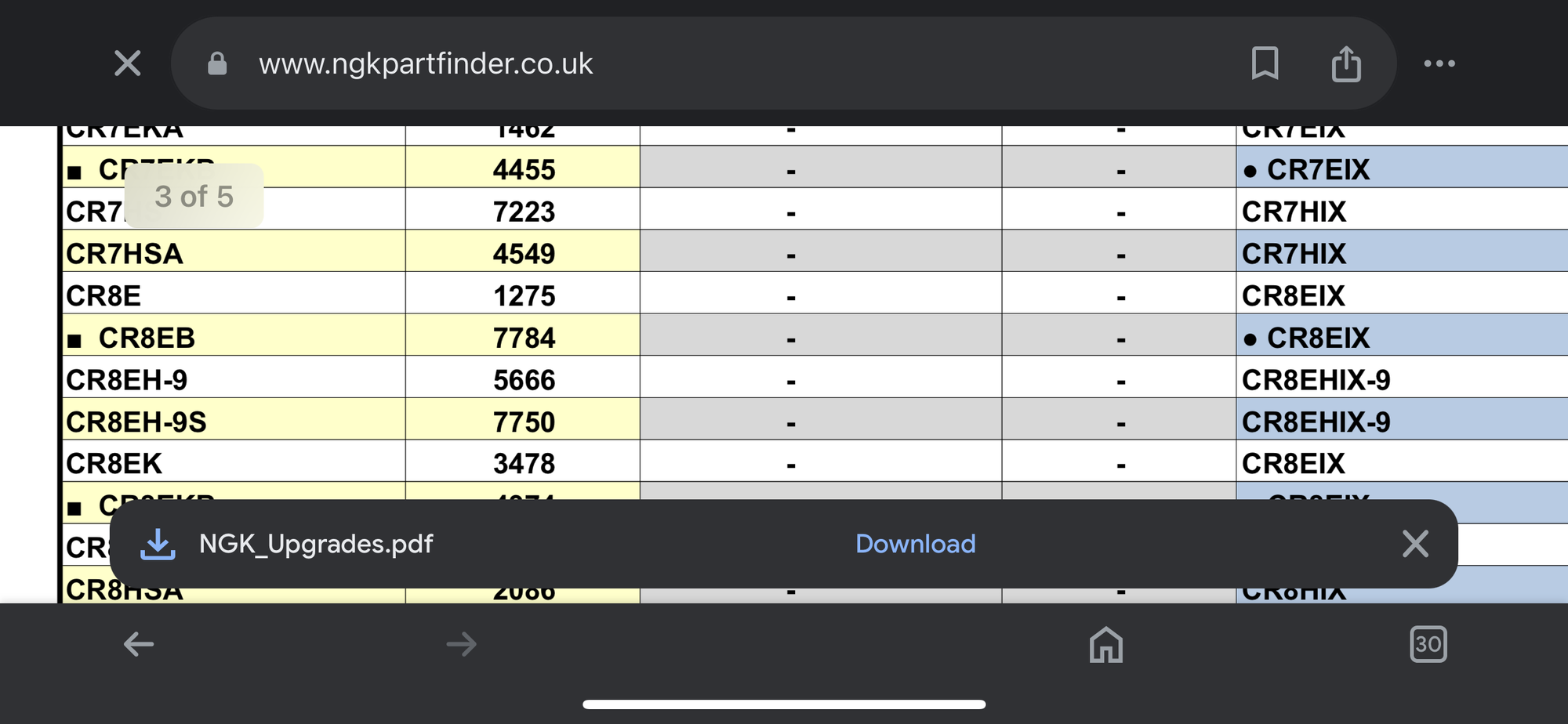

The original plug is a cr8eb and the ones I have are cr8eix which on ngk's upgrade chart are the ones I need

Only thing I can imagine is that the Iridium fine wire 0.6mm center on the CR8EIX is doing this, they both have same specs except this, the CR8EB is Nickel and 2.5mm thick center, see specs in links below.

where does that tip end up? bouncing around in the cylinder? could the first one bouncing around have damaged the second? or did you rip the head off to get them out?
Posts: 22936
Posts: 22936
defiantly put a camera down the hole and inspect the top of the piston and the cylinder walls.

Really bad pre-ignition (detonation) can cause this. But it's more commonly caused by the piston colliding with the electrode. Do you have the original spark plug? If so, compare the length of the threaded section to make sure the new plug isn't extending too deep into the combustion chamber. Also, you might take a look at the top of the piston to make sure there isn't a thick buildup of carbon causing the piston to hit the electrode. You'll need a scope to look for carbon buildup on the piston.
@caschnd1 avatar
Grumpy Biker
Posts: 5627
Location: Sparks, Nevada, USA
Grumpy Biker
@caschnd1 avatar
Posts: 5627
I'd definitely go looking for the broken bits. Best case,they get blown out the exhaust valve. Worst case, they get lodged between the valve and the valve seat leading to a bent valve. Facepalm emoticon

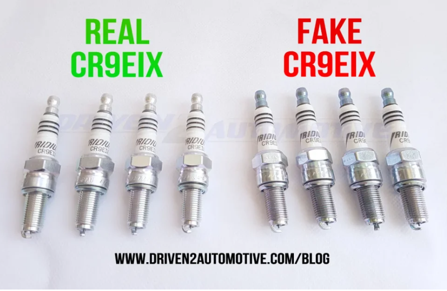

the body above the threaded area, you can see the fake ones are thicker than the real ones as it gets closer to the hex area. also the printing looks slightly larger.
Posts: 22936
Posts: 22936
Abner_Bjorn wrote:
I can't really tell the difference. Maybe they are a knock off.
so when comparing to the failed ones from the OP looks like the failed ones might be fake to me

What work was done recently to the bike? It could be that the cam is off a tooth or so, but then you would likely notice a big drop off in power. Are you re-gapping them yourself, instead of taking them out of the package and installing them as is? If so, what are you using to gap them? Does it come into contact with the electrode near where it's breaking off?
If you are setting the gap, try not doing that next time and see how it works out. They are pre-gapped from NGK.

I thought the knock-offs were only CR9EIX (meant for big inline4 sports bikes, etc. I'm about to buy some for my MV Agusta)
And there are SO many threads on this, the easiest way to tell is by the outer boxes:
https://www.driven2automotive.com/shop/blog_img/uploads/2018/07/boxerrorfakecr9eix.png
and the tip:
https://www.apriliaforum.com/forums/showthread.php?366972

Iridium Plugs are not to be gapped EVER. If the gap isn't within spec than it's the wrong plug, or damaged.
Regardless, if the guy gapped them and it damaged the electrode it hasn't been mentioned as I've read it. From spark at the plug gap (so were perfectly clear) to the coil every bit of the path has a spec. I'm not being a purest in this talk, it's electrical engineering that should never be "souped up"

Sorry all been busy with life I have purchased the original cr8eb and it's running albeit a bit slower on acceleration but it runs like normal I didn't investigate where the tip ended up but seeing as I've done a few hundred km since then I'm pretty sure it's all okay I will take a look later at the lengths but the cr8eix is meant to be a replacement for the cr8eb

As too if their fake or not I have suspicions one of them is you can clearly tell their not the same one has nice sharp writing where as the one I believe is fake has a bolder darker writing on it
