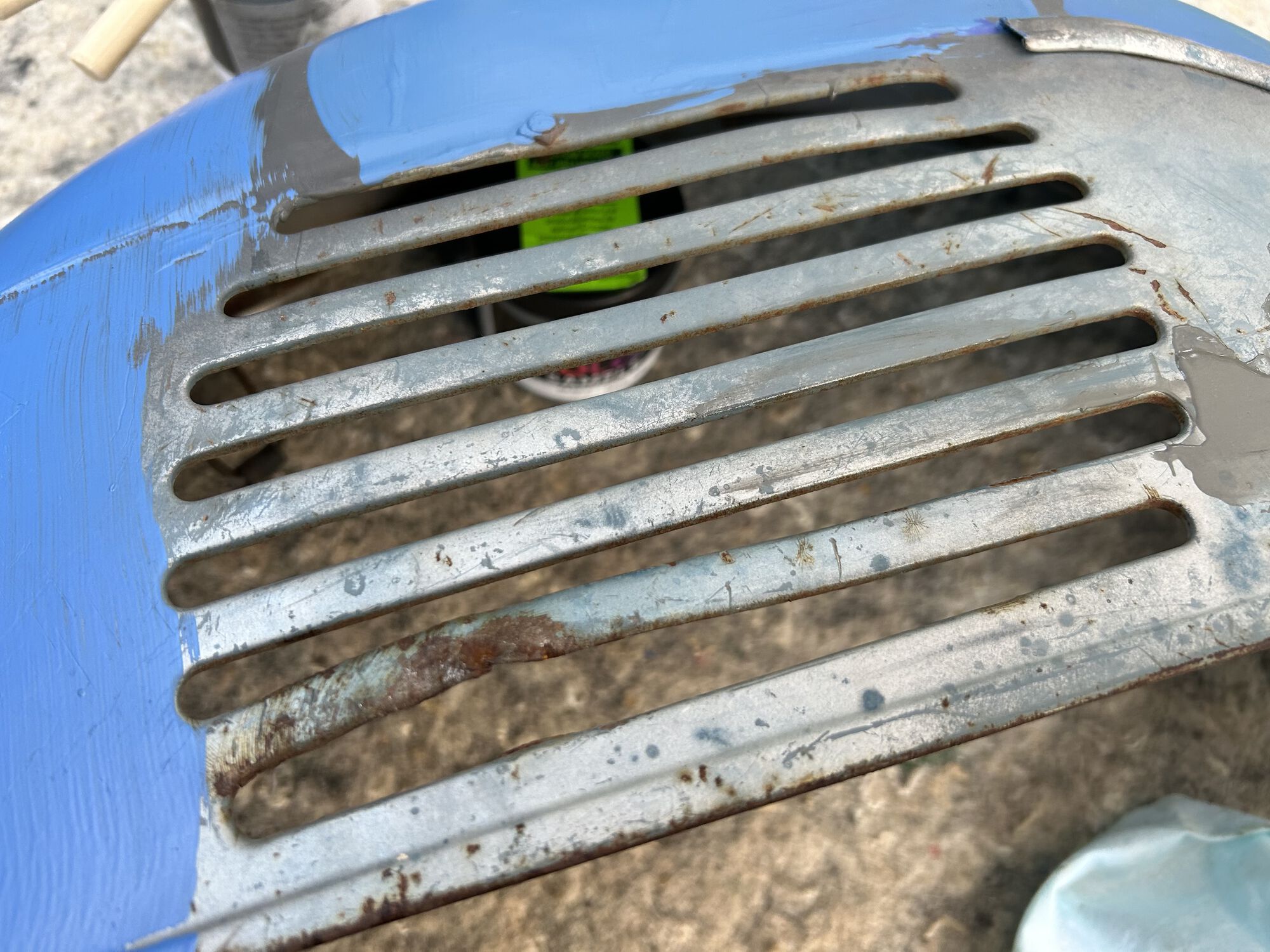

OP here. Hmmm. I suppose I'm now leaning toward rehabbing the original.
But, just out of curiosity:
What "metalwork" will need to be done on the Vietnamese replacement cowel? The spot welds along the top need to be dealt with, obviously. But what else?
Here are pix of the new cowel and of the dinged louver on the original (ignore the weird paint. Was testing colors. Will take to bare metal before real painting).
Not a rat rod, but not a hot-shot restoration. Just the best I can do, 2nd time out, as an amateur rebuilding a junker in my backyard shed. I want to do the painting myself. Likely single-stage.
Thanks everybody.

Find-make a dolly that fits perfectly into one of the good "fins", and slowly hammer gently to arrive at a closer appearance, don't try to knock it out quick. A little oil on the fin dolly so it can move easier across the metal. The dolly should be about twice the size of the hammer head, and you should use a real body type hammer, with very clean flat surface mirror shined on both. Intuitively work it out, like two beers make a better pool player. Use light to see minute changes, look at both sides at every hit. Do not start at the worst spot. That all I can think of for now
Edit,
It's "fin" will get bigger over all and get floppy, if you notice this, tell me what types of heat you have access to. And I'll tell you how to use it to shrink it back.
Edit 2
The dolly, can be a piece of plywood, cut just right so act like an anvil of sorts. Much lighter taps. Use a good fin for measuring. Keep an eye denting the wood.
⚠️ Last edited by Veloce Vulture on UTC; edited 1 time

Looks like you could use either w/ not too much work, a good spot to be in. But I think the old one should be saved and good enuff so only you can tell up close, coz it's not all that bad. Then you have the original on there and that would be worth it to me.

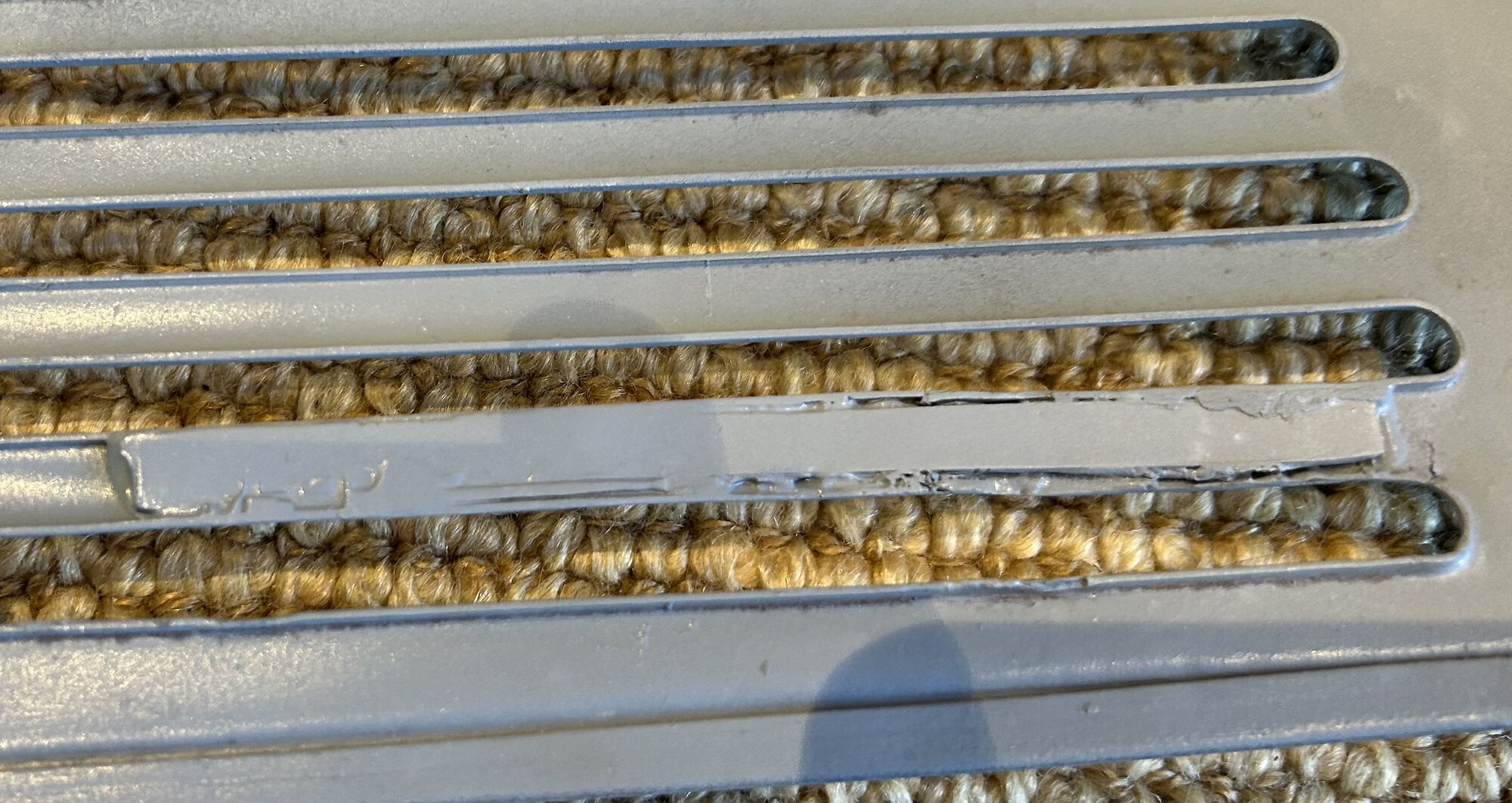

junk metal replacement formed on steel dolly and carefully fitted & welded = decent junky repair
magnet trick to pull it flush for tack welding
Posts: 10082
Posts: 10082
Oh JOY! I found the rest of the pics on my phone to help you at each step if you need.
Step by step:
weld detail
weld detail
other side where you can see better the slight step I ground in the connection to better get their surfaces flush, same on other side and gentle welds PLEASE!

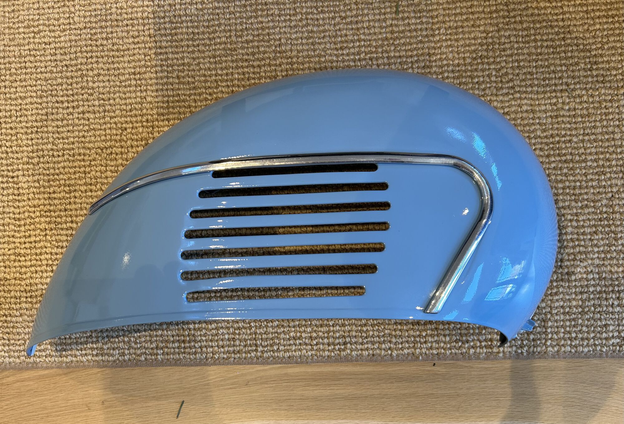

all welded
all welded
ground smooth
ground smooth
and fake painted w/ THREE color blend that still doesn't quite match original. I really don't care, good ENUFF and better than was!

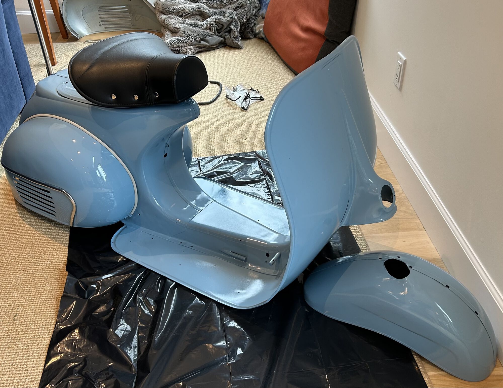

Scruffy AllState, crappy headlight finally fixed!
Same bike I fixed the cowl on.
It feathers out so nice.

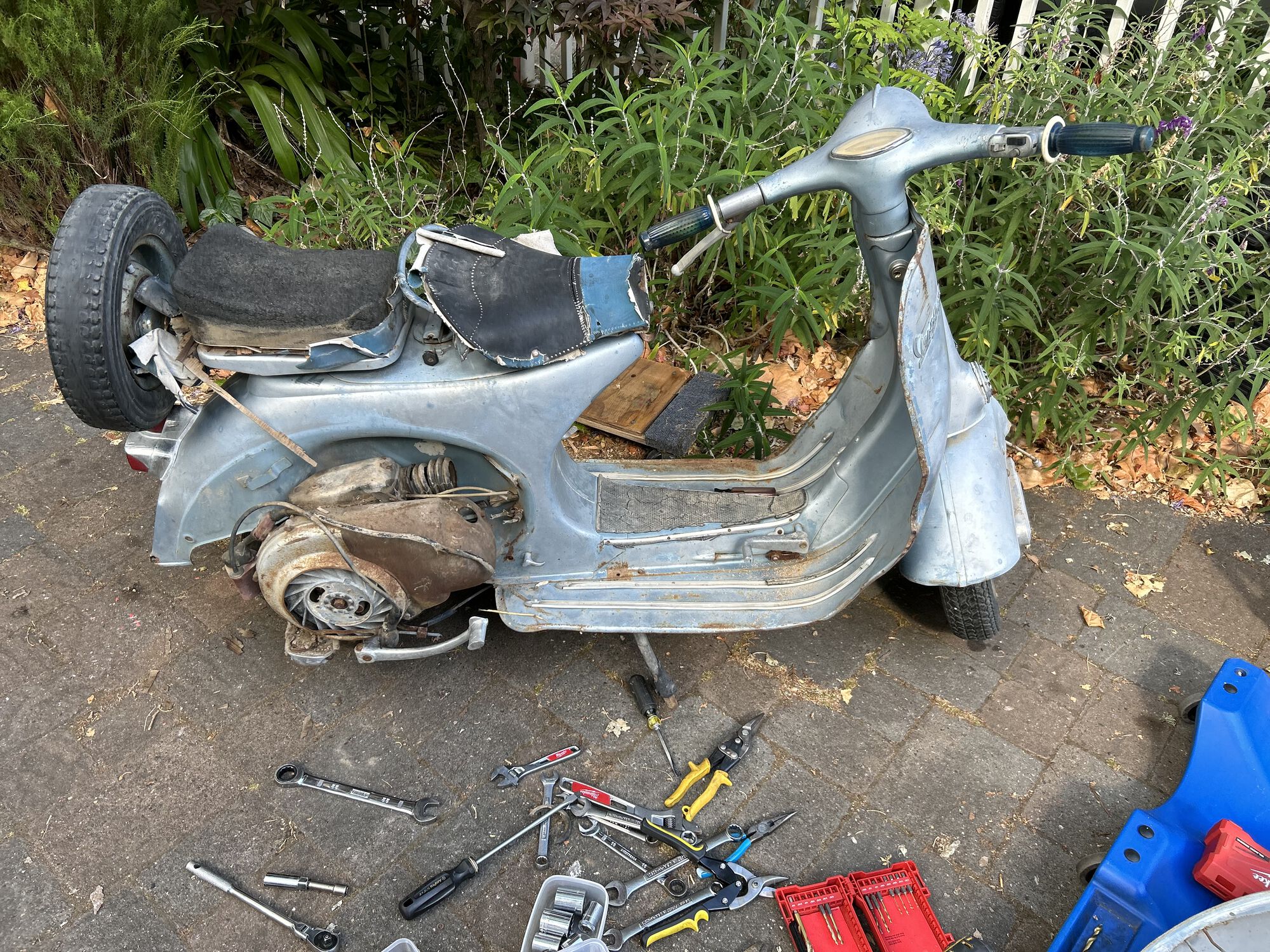

My VBB was a barn find with mouse nests in the well and the smell of twenty years of dried rodent urine (my wife thought it was just old gas . . .). Head & piston were frozen with rust but gears et al were fine. Headset was frozen on but came off with lots of heat, a jig and a rubber hammer.
All new to me! Your Allstate thread gives me hope. Tho I wish you hadn't shown me a pic of a roundtail. Gives me something to think about for the future, and I'm not halfway done with this!!
And, next time: Patina, and save all the old parts!!!
How mine looked fresh from the (literal) barn, and where I'm at now:
Posts: 10082
Posts: 10082
ROFL emoticon That that thing's a dang MESS ! Facepalm emoticon
Give it to me? Eyelashes emoticon

OP here. Just wanted to say thanks to everyone who urged me to see if I could save the original cowl.
I did, and I'm really happy with it, but please keep in mind that I'm a semi- newb working in a leaky shed. One makes do. And I don't have a welder.
The problems with the cowl were lots of dents and, in particular, a louvre that was so bent/stretched it was beyond my skills to hammer it back to normal. For the dents, I continued my education in Hammer & Dolly 101, then got more practice skim-coating with Bondo.
For the louvre, I cut it with a Dremel, hammered each side of the louvre back in shape, then filed the ends until they matched up. Then I epoxied an aluminum strip on the back (purists look away!!!), filled the cut on the font and any remaining dings with JB Weld putty, sanded, primed and painted.
Not perfect, but I'm happy. Learning to spray single-stage, too. Exceeding my expectations so far, but a key to that may be reasonable expectations!!

Nice work!
In other news, that is one chonky spare ya got there.

That looks fantastic.
The only reason I can tell which louvre was repaired is because I already knew.

That's an excellent job. You can do a lot without fancy tools. You should be proud of that scooter.

Chandlerman: As you know, I (quite literally) couldn't have done it without you. You lent me your wonderful edge crimpers, which was a key step in getting the bike back to presentable. Thanks again.
I've also learned from your paint videos. Never used anything but a rattle can before. Trying a Harbor Freight compressor and an LPLV gun for the first time. Practiced on an old car door panel. Came out way better than I had hoped. The epoxy sealer dripped (had to sand those out) but the single-coat went on smoothly and evenly. Not a drip, and pretty good shine. Big relief! It seems that a key to smoothness is making sure the last coat is really wet. At least, that's what worked for me.
There was one weird, inexplicable flaw: The paint on the top of the floorboards has a kind of "crystalline" effect—not orange peel. More like zillions of miniature diamonds. Tried sanding it out, but that didn't do anything. ONLY happened on that horizontal part of the bike. All vertical surfaces were shiny and smooth.
The day was coldish and I left the bike outside for about five hours after painting. Maybe the shrinking of metal had an effect, or maybe the cold caused the parts of the paint to separate or dry differently.
It's really only noticeable to other people if I point it out. Still, I'd like that area to be as smooth as the rest of the bike, so I'll redo it, in warmer weather.

Could be dust that got in the paint. Paint always does funny things. I always see lots of flaws when I finish a project. Other people wouldn't notice. I stop noticing once I start riding / driving it.
It really came out crisp.

I'm always glad to see wins, and if I can be a part of that, so much the better.
Paint is weird. Sounds like you had some sort of contamination, either in the paint itself or on the floorboard. If it was localized within the batch, it was something on the floorboard.
When I painted my GL, for some reason the clearcoat on the glovebox cowl kept getting fisheyes. Fortunately, they aren't really noticeable because it's metal flake anyway, but I sanded down, then prepped and repainted that panel twice and never could get them out. Paint is weird stuff.
