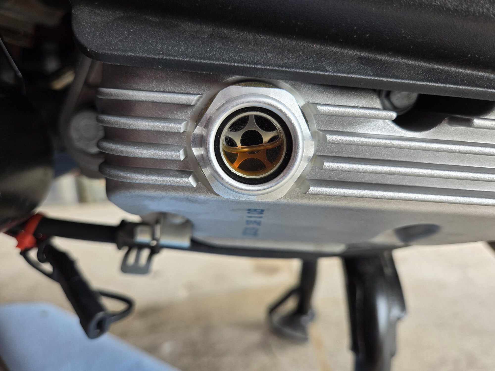

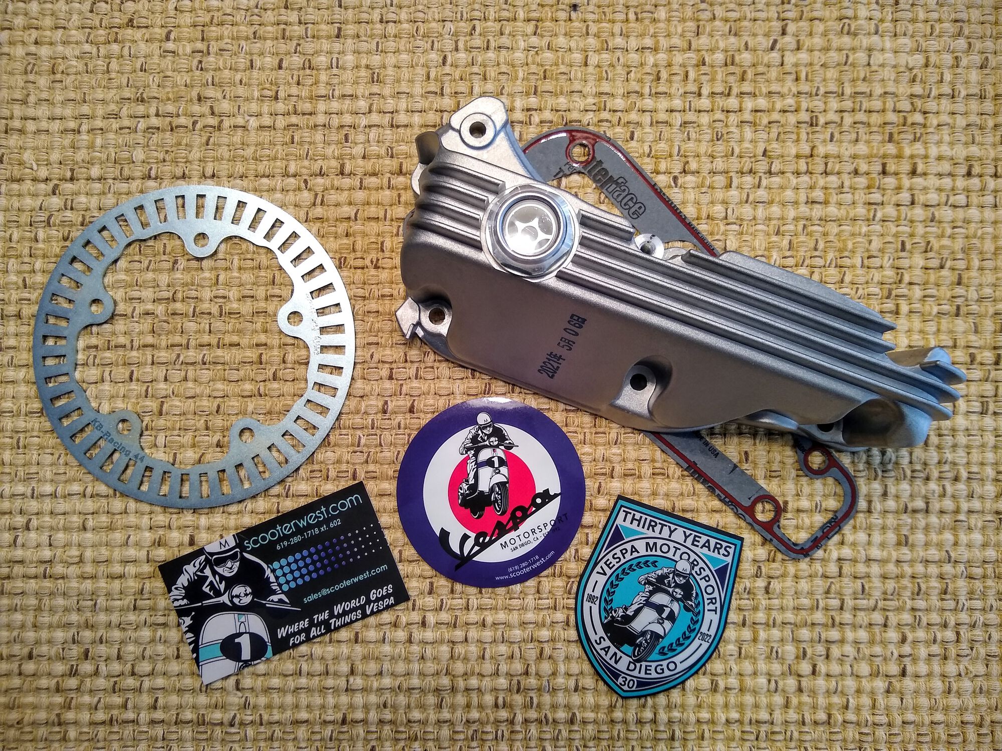

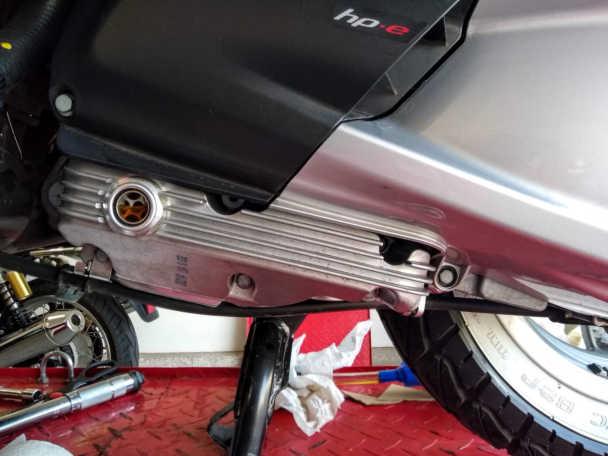

I hated struggling with that damn dipstick, so I installed a sight glass oil pan I bought from Scooter West in San Diego.
Sight glass oil pan
Sight glass oil pan

I had Scooterwest install the site glass oil pan at the 600 mile service. Excellent addition to the scoot. That and heated grips.

I'd advise every 300 owner to install that sight glass oil pan, however they do it (DIY or dealer).
The only time I have to deal with that #@^&%^ dipstick now is when I change the oil. (Or top ups which hasn't happened yet, doesn't seem to use any oil despite what Robot said)
I can check my oil level now in about 3 seconds by bending down and looking at the oil pan.
Don't know why it's such a PITA to get back in but it is what it is.
You have to be very gentle with it or it gets stuck or breaks.
It's all about getting just the right angle and placement and then it drops right in.

This should be standard on the GTS, and other Vespa as well, but it's not.
So be it.
But, it's not particularly expensive ($150 USD?) and even an all-thumbs mechanical buffoon such as myself had no problems fitting it to the scooter. Installation is very straightforward.
I bought mine from Scooterwest.
