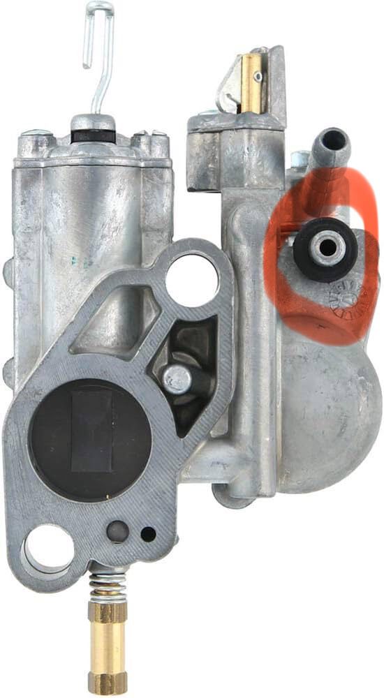

(when you said you "removed the rubber," do you mean that you removed the gasket under the carb? If so, put that back. You're going to be leaking air.) .

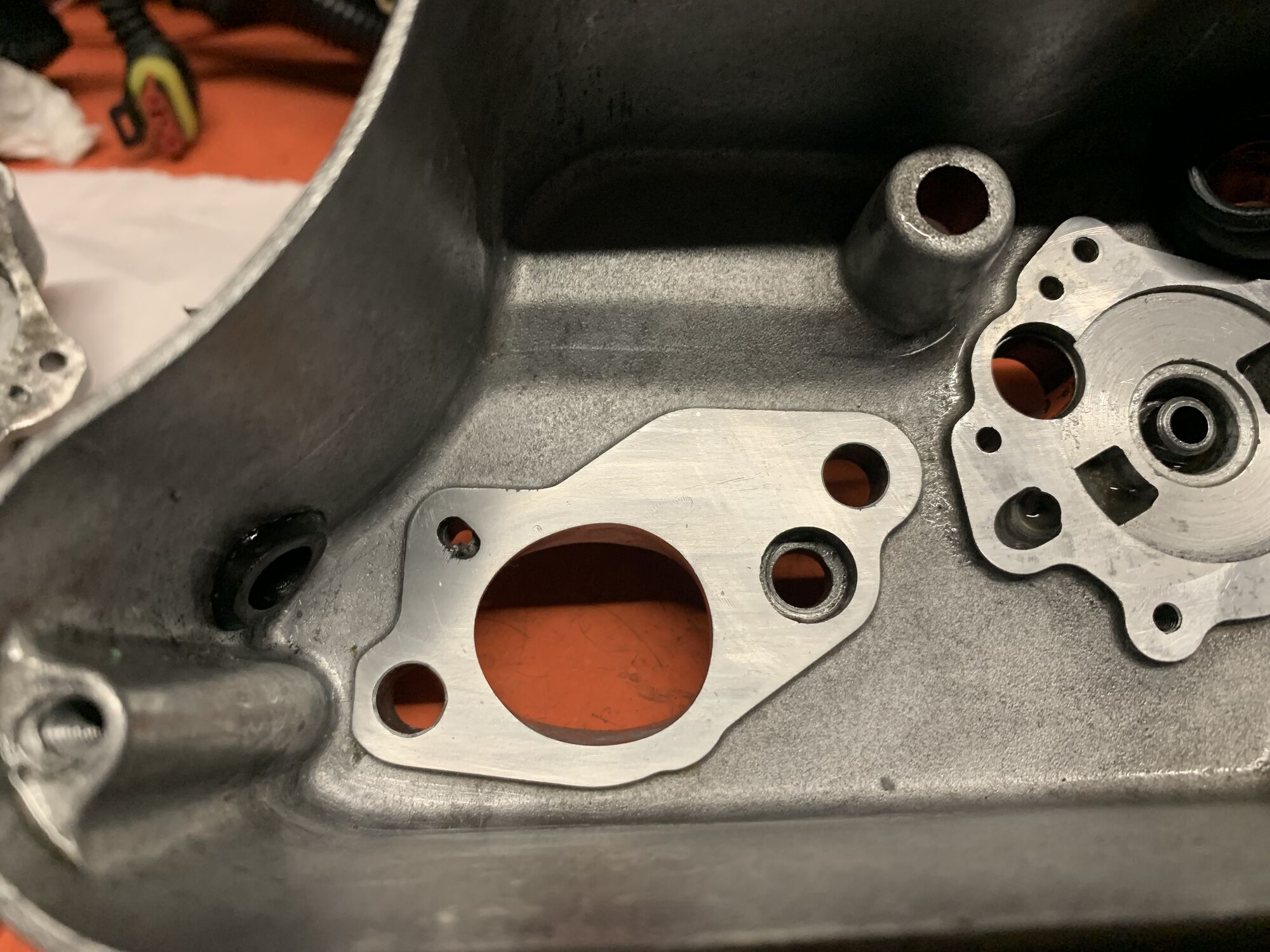

no no, not the paper gasket, the square o-ring (see the attachment)

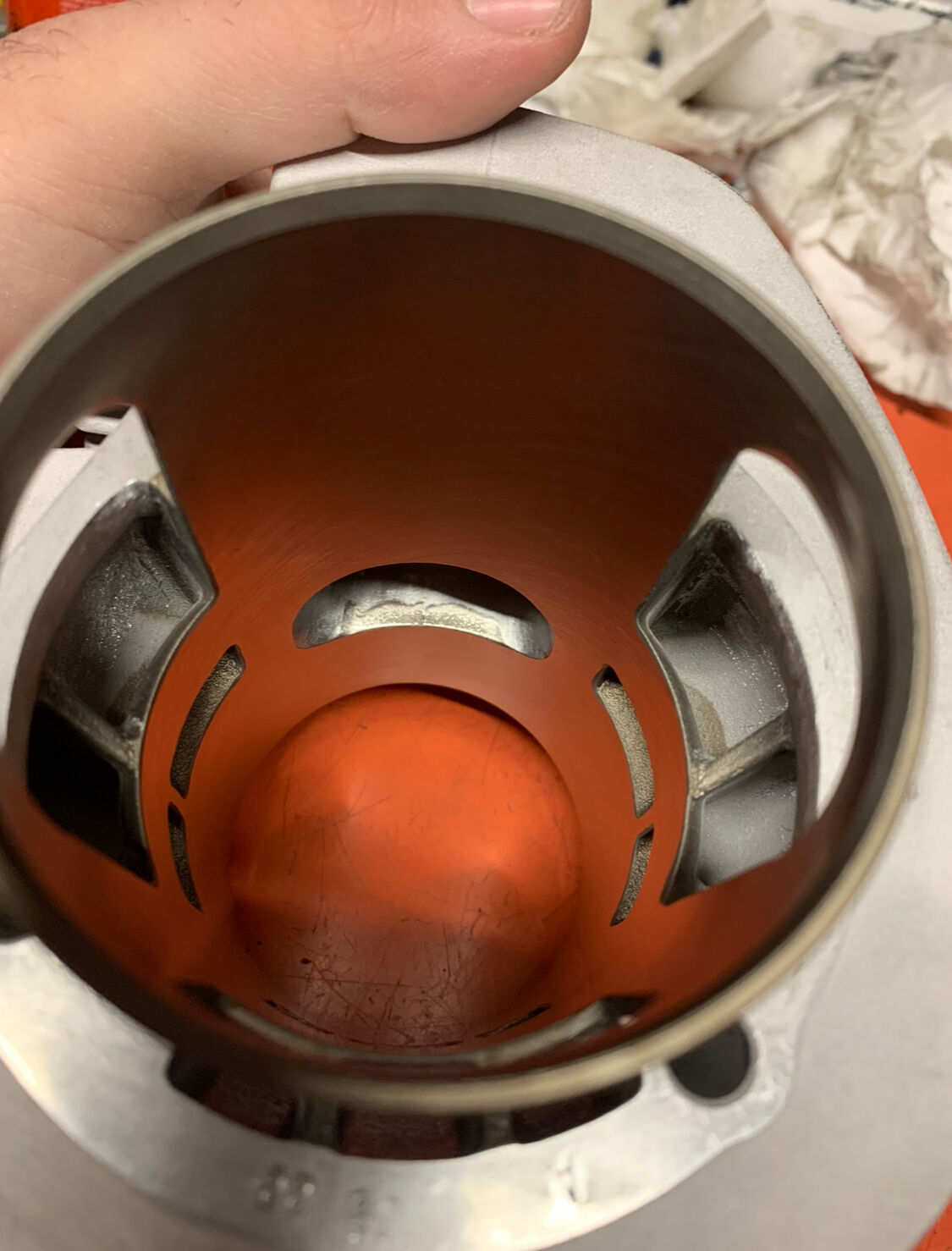

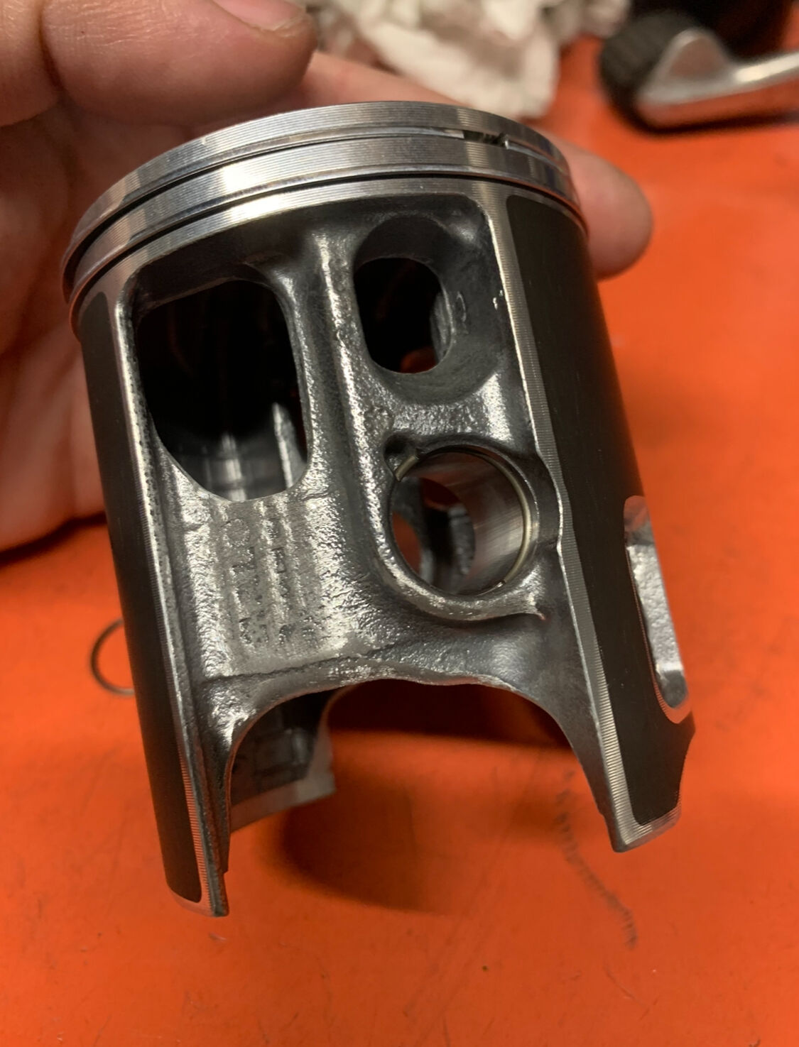

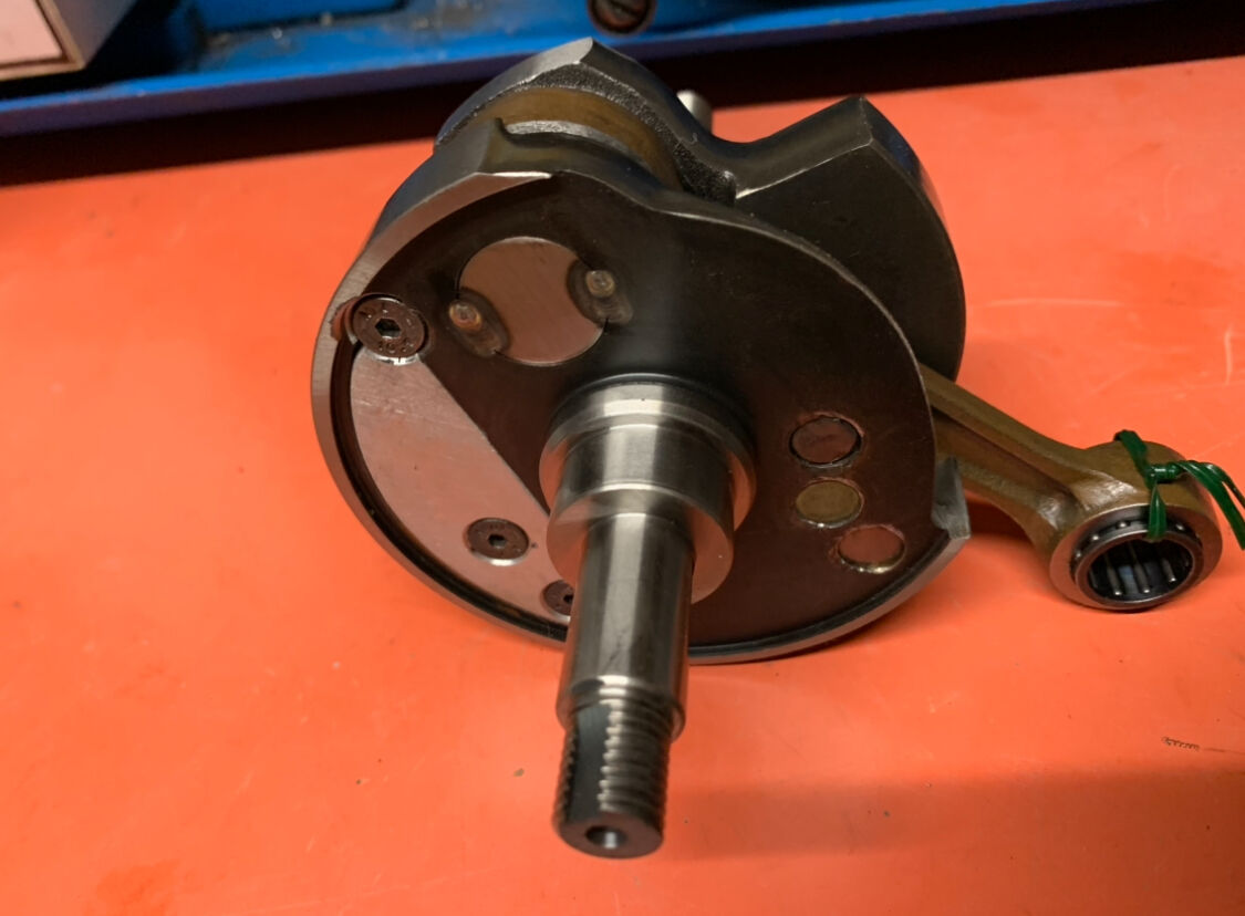

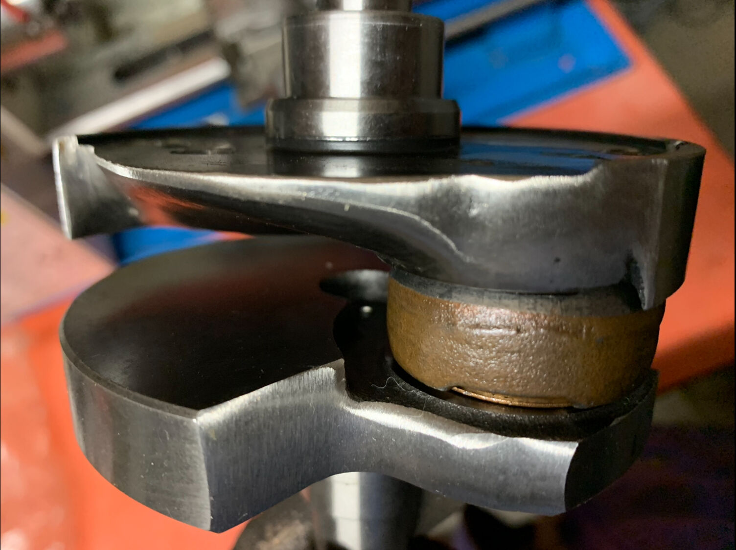

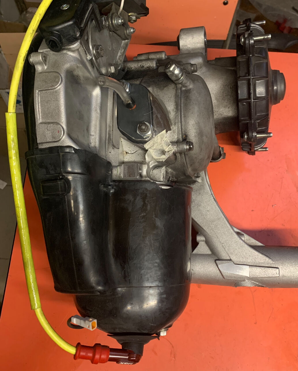

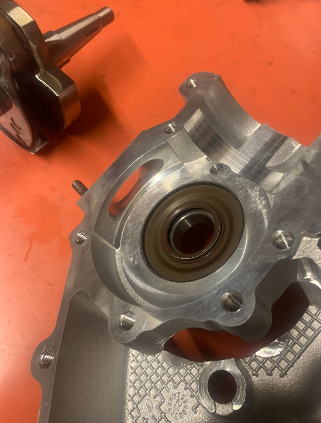

I usually don't take many pictures, I'll attach some of the engine

The workmanship on there looks really nice

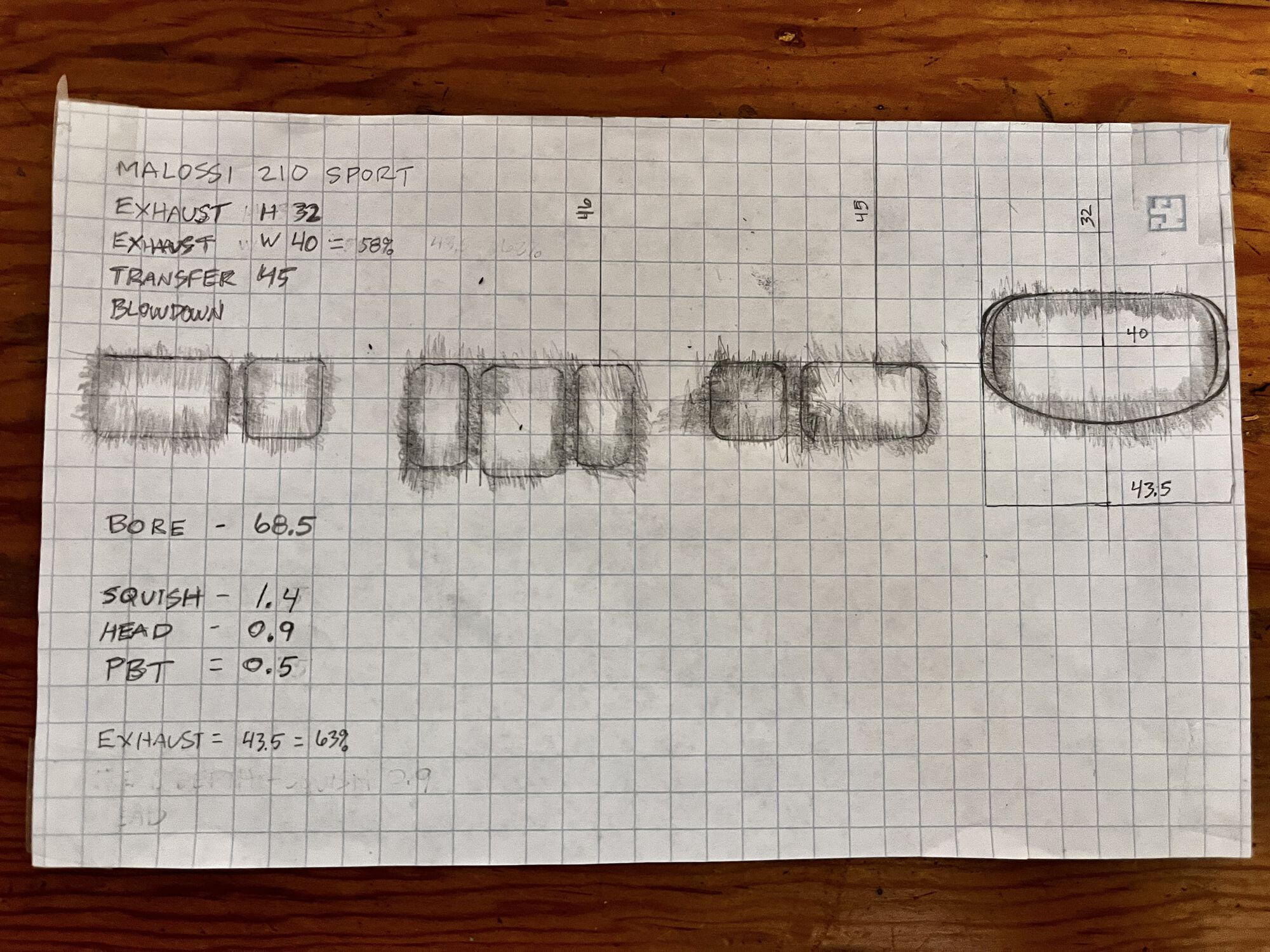

Here is the port map for my new Malossi 210 Sport.
Main Transfer height: 45mm
Center boost Transfer height: 46mm
Exhaust port height: 32mm
Exhaust port width: 40mm (58% of 68.5 bore)
feel free to ignore the other written stats , I'm still working things out for my build.
port map for Malossi 210 Sport
Thanks, Jesse!
Those numbers work for the timings, but only if I put in a deck height that doesn't really make sense. (2.7mm piston ABOVE deck) I'm going to just ignore that for now. I'm wondering if that's somehow related to the whole 210/221 thing Malossi does, as if anyone building a long stroke 200 should be trusting others to set their port timings for them. Razz emoticon
That also confirms installing a 0.5mm base gasket. That would get the timings up to 125/180, which is a lot healthier, and also get the squish up to 1.4mm, which is going to do better for heat management.
Then we can start to worry about the carb.

chandlerman wrote:
My exact measure on your timing was 121.8 TD. I still think you need another 0.5mm of base gasket. You want to be about 124-125(max) TD and not worry about ED. You will have plenty of blowdown with the widened exhaust, regardless of the measure.
sure, I could do it both adding and a 0.5mm base gasket and keeping 1.5mm head gasket (actually there are 2 gaskets 1 + 0.5mm) or adding 0.5mm base gasket and removing the 0.5mm head gasket
but I don't have great expectations, I think it will be in the middle to the current configuration- and the 128 - 184 one. Compared to others, this engine does not change much with the various setups, I also see this with the ignition timing, the changes are really minimal from 23 to 16 btdc
btw I will do that to have a more correct cylinder timing
chandlerman wrote:
No surprises here. 126 is too high for that box (really, most boxes) and 128 is definitely tuned pipe territory--if you want peaky, get a peaky pipe.
I still have JL right hand I used with Polini 208 and 30 PHBH carb, I already tested it and with this engine it doesn't rev more than 7500rpm, Polini box is much better with this setup. Maybe this engine has a problem somewhere. I will do the air leakage test again and check gaskets under the carb
I could have for testing Malossi box too, but from what I know it shifts the torque even further to high revs
chandlerman wrote:
I built a series of motors with BGM177's that had squish in the 0.8mm range and they always struggled with heat when I used them for touring. They were great for raw power and acceleration, but tended to get hot like yours when running on the highway for more than a couple miles.
They were reeded with big PWK's, so not a like-for-like, but similar challenges.
Recently, because the build docs called for 1.2-1.5mmm squish, I decided to change it up and have now built two ~30HP motors (Quattrini TV210 lambretta & Vespa M1XL) that both run with 1.4mm of squish and stay really cool, even running uphill at 65 MPH, so maybe trust me on this one
(It also puts your port timings where they should want to be)
Yes definitely it worth a try on 1.4mm squish, actually I've never managed to test this engine for miles at mid throttle without high temperature problem so I didn't test it also in full throttle.
chandlerman wrote:
I can't do much with bowl size on the head because I don't have access to a good machine shop here. Truthfully, though, I've never built a motor where I really needed it, so I don't consider it to be a problem.
For some reason, the Malossi 210 seems to be the Mount Everest of tuning. For instance, take a look at sdjohn's P200E build thread. 42 pages of effort and he never REALLY got there.
I completely agree with you, when i decided to treat myself to the new engine i read a lot about the cylinders available on the market in 2023 and the choice fell indisputably on the Malossi Sport in C60, because according to almost everyone I read it is the cylinder that makes the vespa a rocket. Now i don't know what kind of rockets everyone is used to, but honestly I am very disappointed. I really hope that my engine has some problems, so maybe i will have a chance to change my opinion
chandlerman wrote:
Like I've been saying, I think your best bet for now is a .5mm base gasket and ditching the Venturi. Then you can get back to the carb with a setup that's much more in line with expectations as a baseline.
I tested small AC with big MJ and this engine swallows everything, I am going to try your suggested configuration 24-24 with 140-BE5-130/135 and without venturi
chandlerman wrote:
We've never discussed what your tuning goals are. I just assumed you want a fast touring or city bike since you're running a box and mentioned riding two-up.
If that's the case, you should consider accepting a slightly de-tuned, but more usable build as the eventual outcome. So long as you're on rotary intake and an SI carb, you're always going to be challenged to really build a winning motor. Same with the Polini box.
You will have to get some reeds, a better exhaust, and a proper (side draft) carb that has significantly better tunability if you really want to max things out.

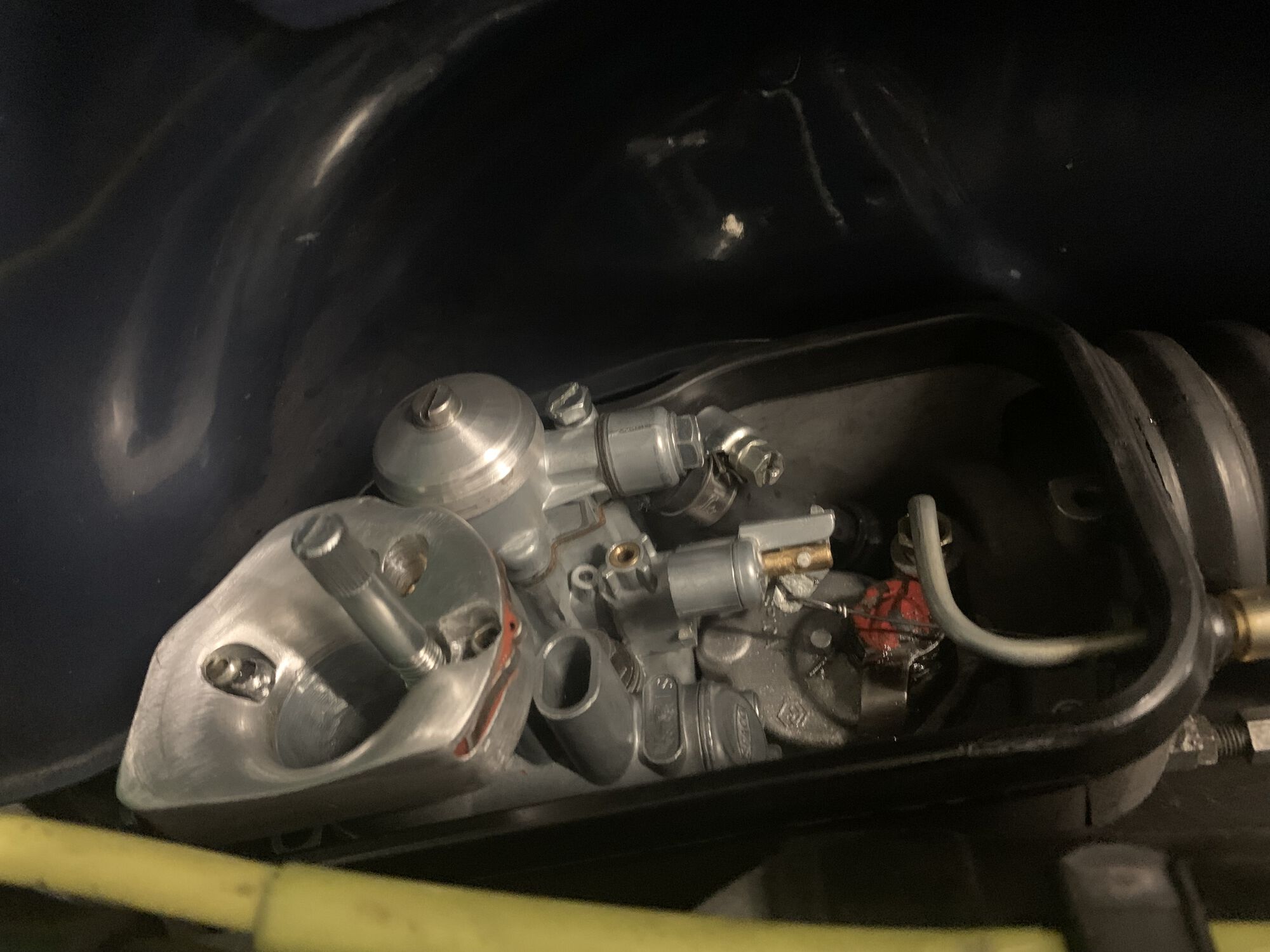

Hi all,
thanks to your advices Clap emoticon I checked my engine and the carb, especially without gasket, was swinging in the box (the gap was more ore less 0,15mm).
I bought the carb box on eBay because only one I had for spare was enlarged for PHBH 30 (test for keep mixer) and probably previous owner did some experiment or had screwed it very hard. I had noticed that the was moved, but I didn't give it much weight because I thought it was the rubber gasket that after I had removed.
I built a tool to smooth the box surface that was not on plan and now the carb doesn't move anymore.
I've just tested Vespa, for sure it has more torque at low rpm, more nervous. At high rev and full throttle didn't change, but I think it's normal.
The strangeness is that I can take high rpm also with very rich configuration in first and second gear too! Is that normal?
For understand what changes I set it leaner with 140AC-be5-150, it seems to be better but I didn't try at high rev and 1/4-1/2 of throttle, it's really too cold outside, will try to do that test this weekend.
I will try also with 24-24 without Venturi and to add a 0,5mm gasket under the cylinder.
Again, thank you all a lot for putting me on the right path and making me think
if one day I have the pleasure of meeting you, I'll pay for the beer at least 🍻

Andrea the planning looks great can you show us the tool and how you did it?
