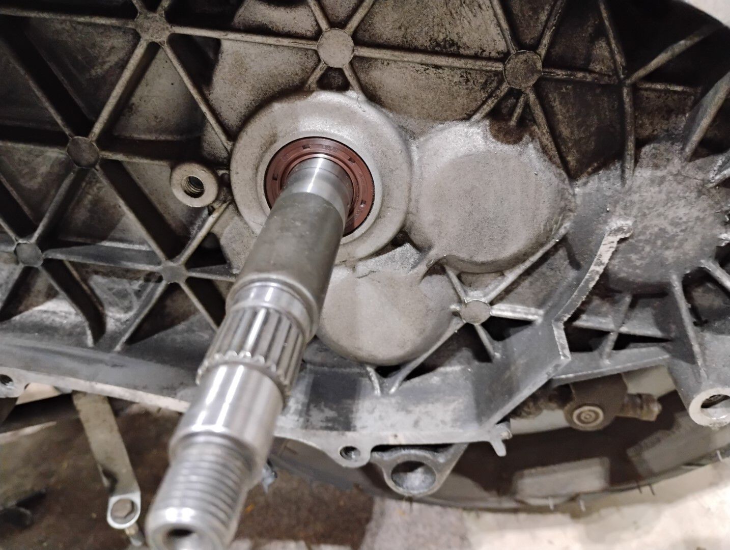

I noticed a bit of oil weep on the driven shaft inside the transmission of my 2006 LX150. The leak is minimal at the moment. But if the oil seal can be easily changed, it makes sense to do so while the transmission is open.
Can this oil seal be changed from the transmission side with the gearbox intact? I'm thinking like some motorbike clutch seals where you can pull out the old one with a drywall screw and then drive in the new one with a length of pipe.
Or is that doomed to fail, and this job requires removing the clutch shaft first (i.e. removing the exhaust, wheel, gearbox; new gasket; etc)?

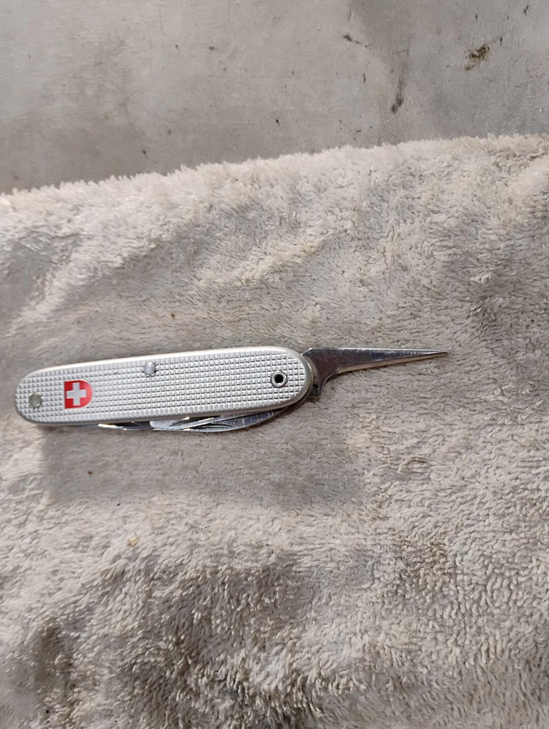

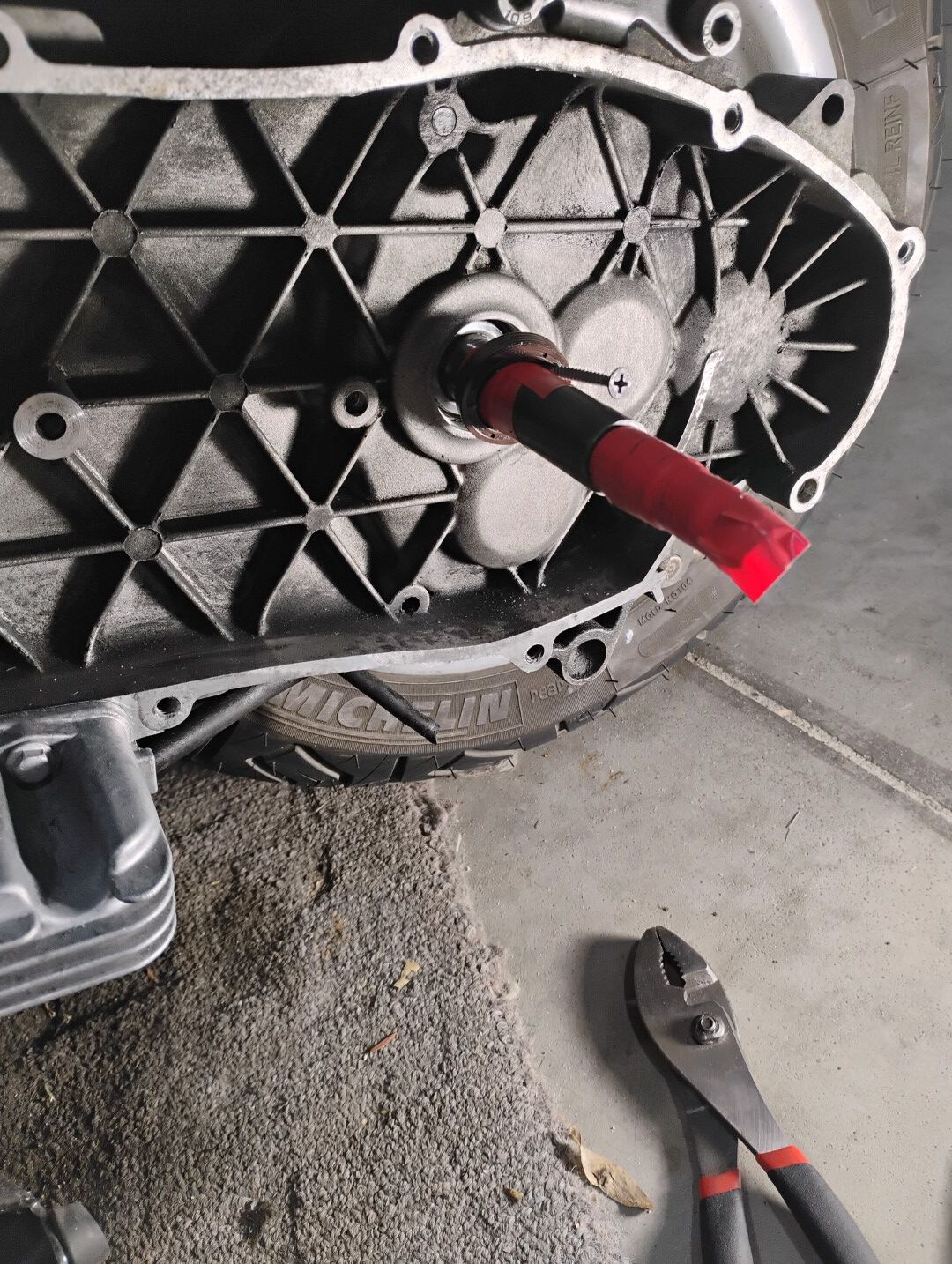

I replaced the oil seal today. As puno advised, I was able to pull out the old seal with a drywall screw. I used a Swiss Army knife reamer tool to make the small hole.

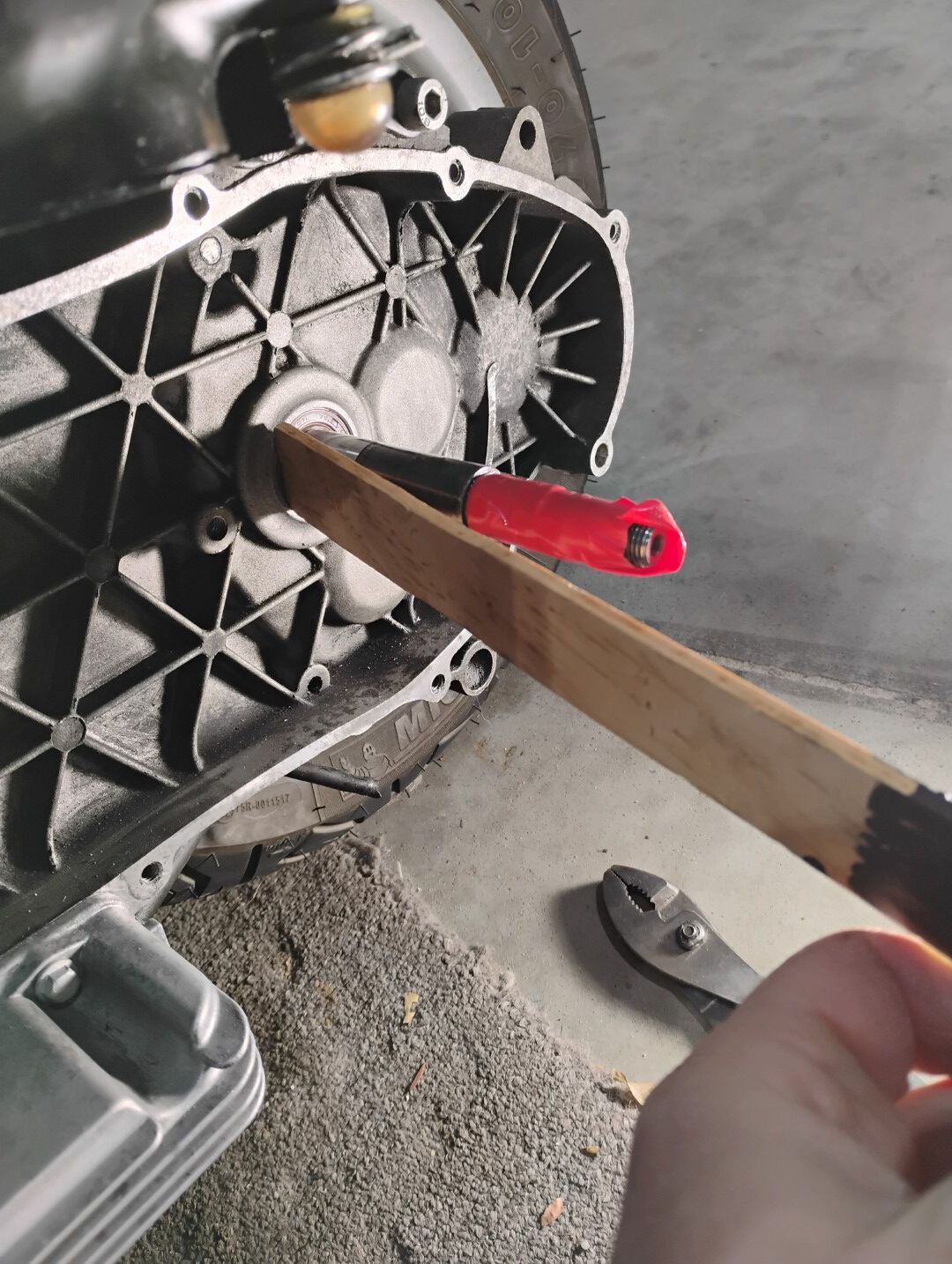

After lightly oiling the shaft and both surfaces of the seal, I was able to push the new seal in most of the way with my hands. Gentle tapping with a paint stir stick got it the rest of the way.

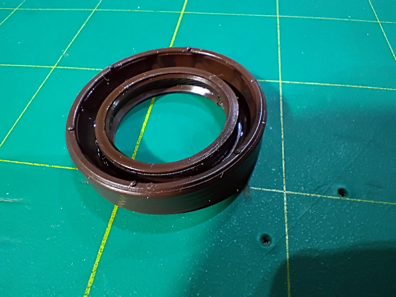

I wrapped the threaded part of the shaft to protect the new seal from rolling the inner lip when installing.
I wrapped the main shaft to prevent any nicks when making a hole in the old seal. I found a drill wanted to "skate" and I was afraid of damaging the shaft sealing surface. I ended up using the hand reamer as a safer option that actually did a better job here.
The seal has a cupped inner side and flat outer side. It's very easy to determine the orientation based on the existing seal.
Here's the inner side:
