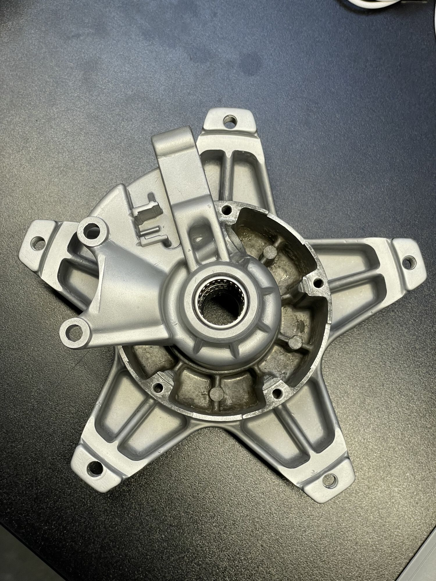

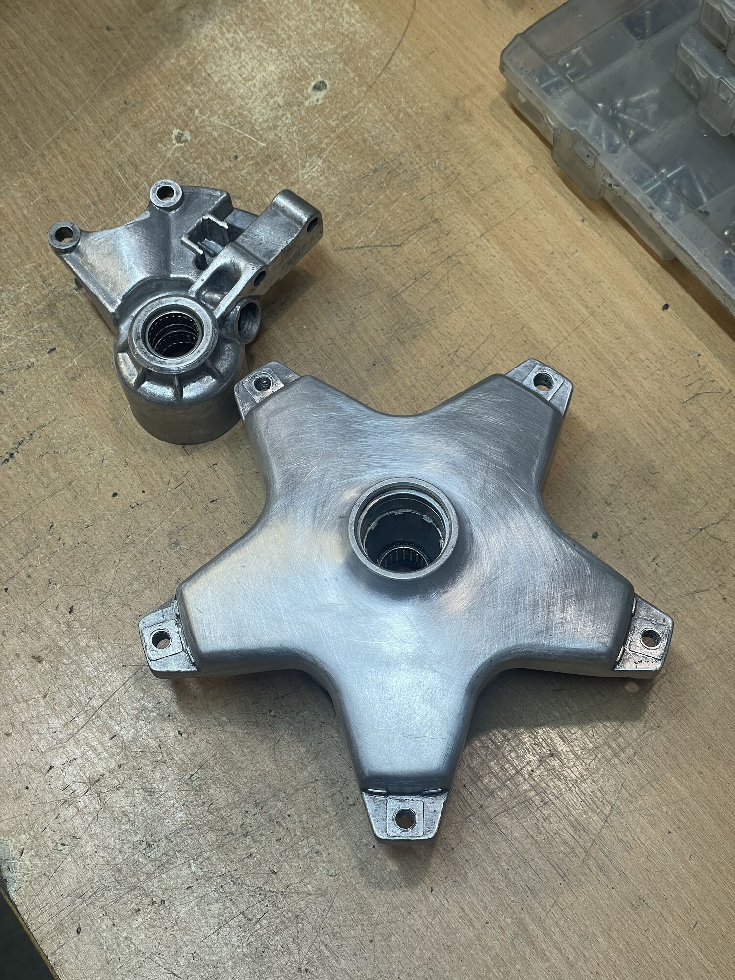

Absolutely exhausting half day of grinding, sanding, cleaning, grinding, sanding, cleaning, grinding, sanding, cleaning...
But now hub is ready for the glass blasting finishing. It is not perfect, but better than I expected.
And carrier still need more sanding, sanding, sanding...

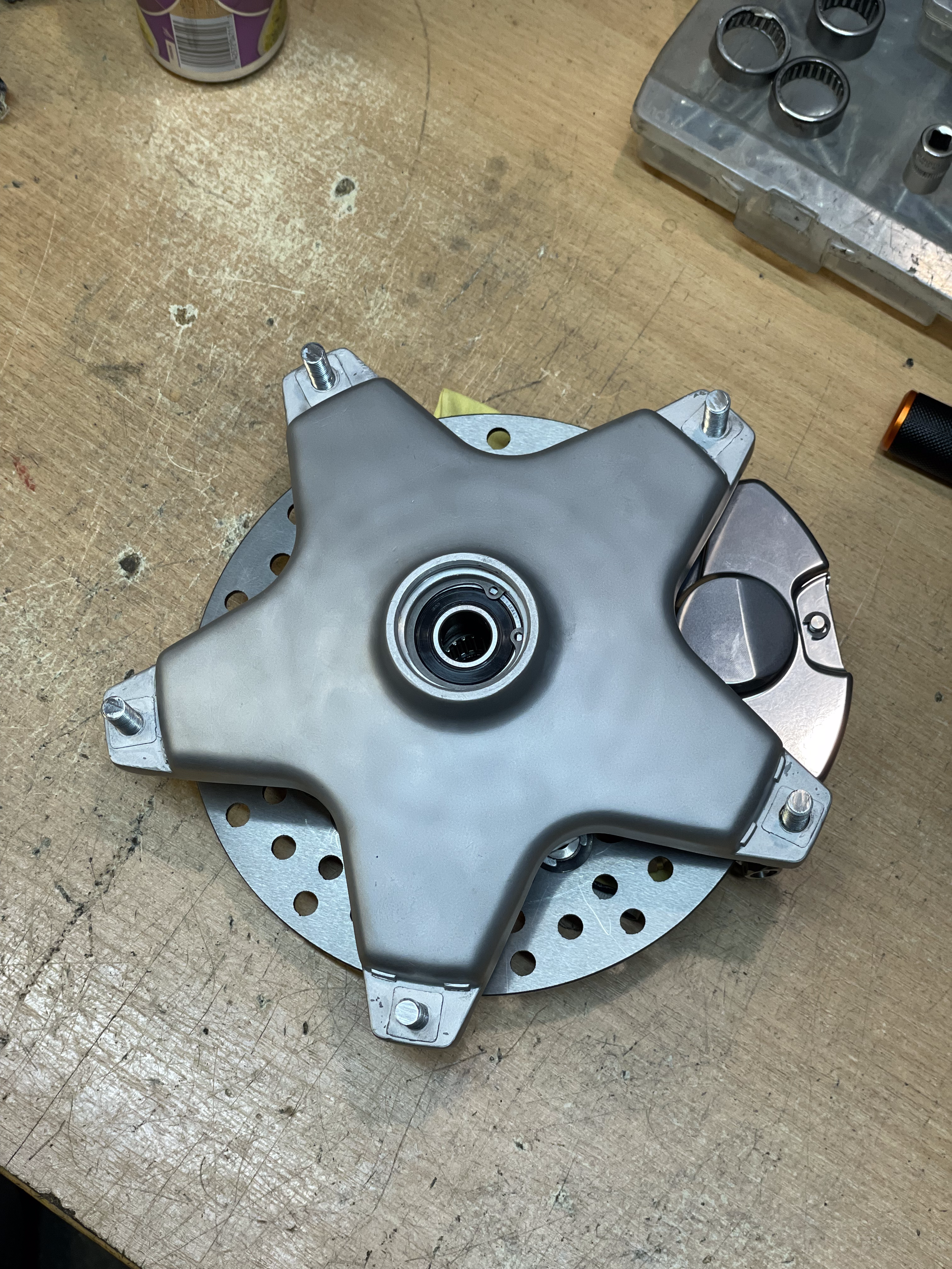

roland87 wrote:
The story continues - SIP 40mm studs and VMC DTM brake disc arrived.
To mount brake disc it is need to cut five notches for rivets.
I also start to grind off that ring on the hub.
ohhhh! I like how that 5 star is looking without that ring! Definitely the smart choice on that Roland. Now i want to do the same thing on mine.
I was in doubt about that ring. 50/50 remove or left. But when you pointed on it I decide to remove. Absolutely not my favourite work but now I'm happy with the result.
Looks like it will finish out well. Personally I like the ring, as an extra detail; but it mosdef looks super clean & custom all smooth. nice work!!

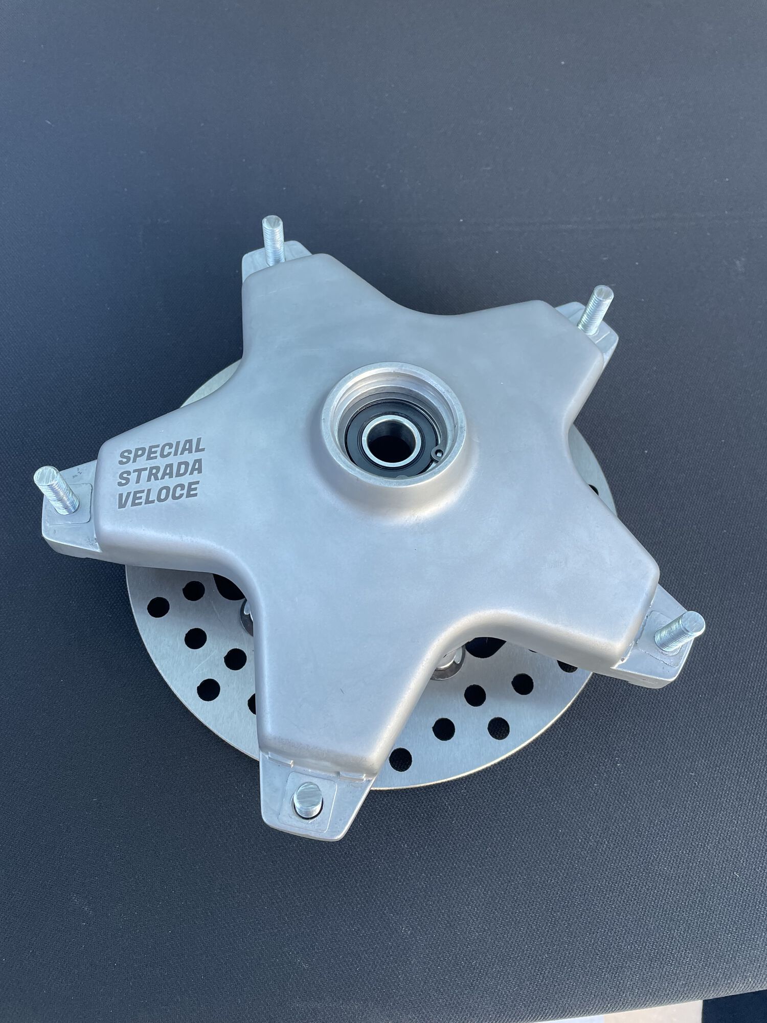

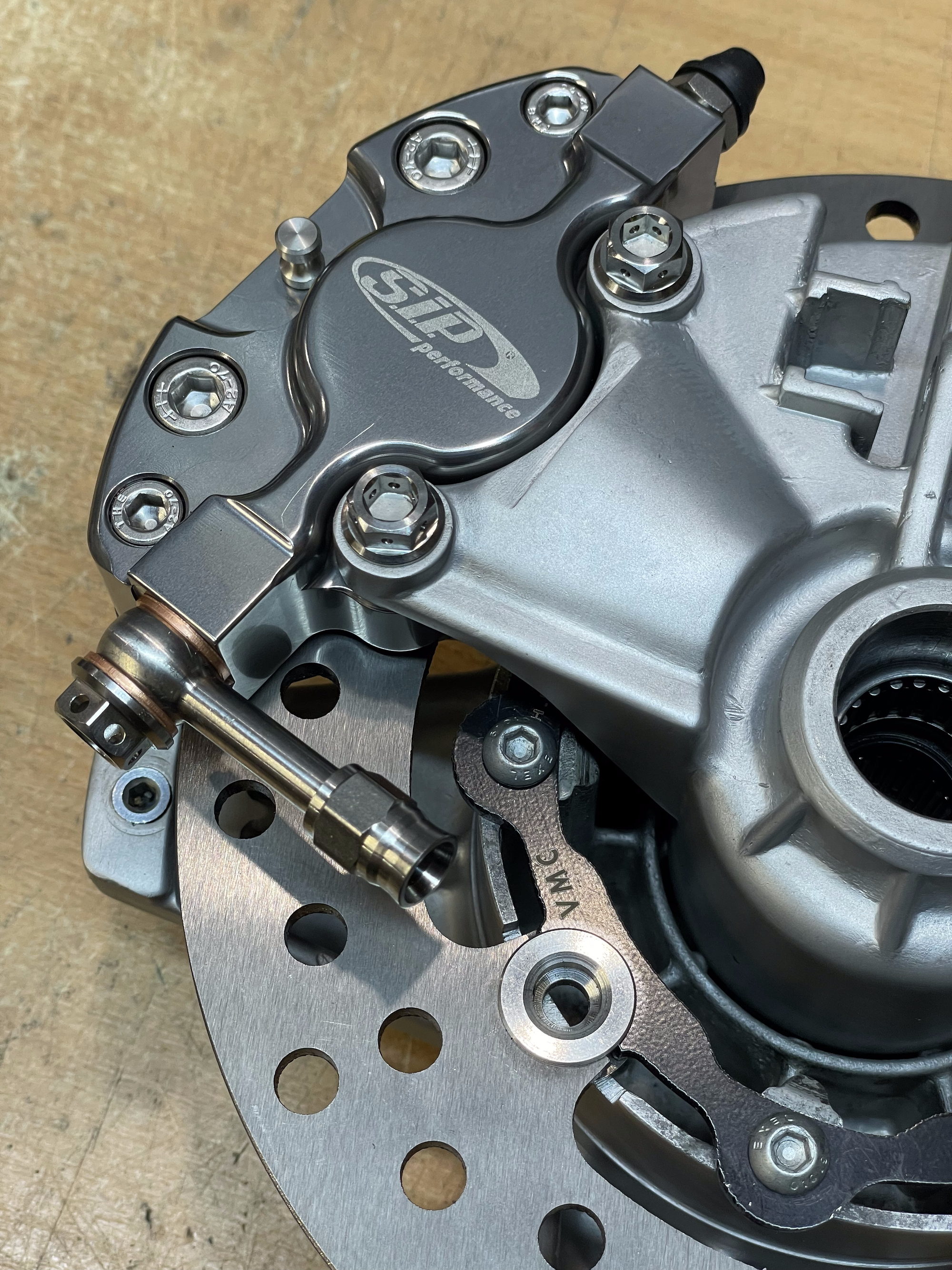

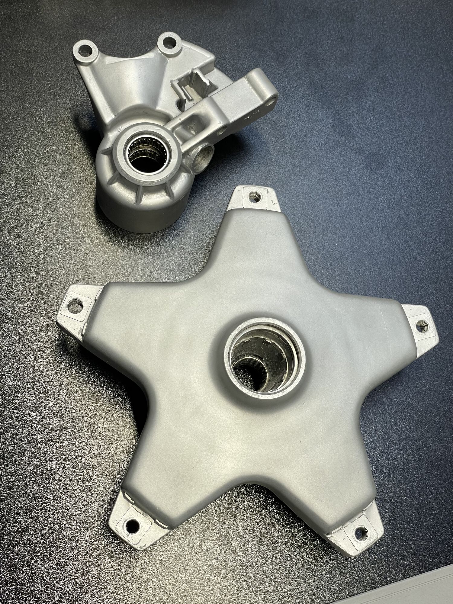

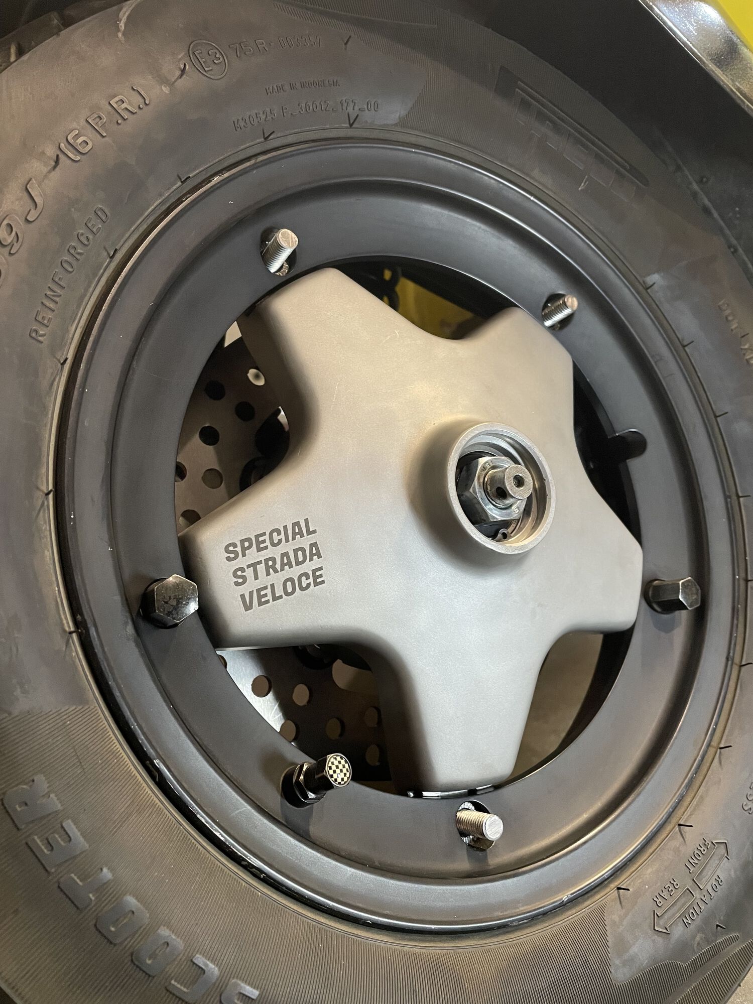

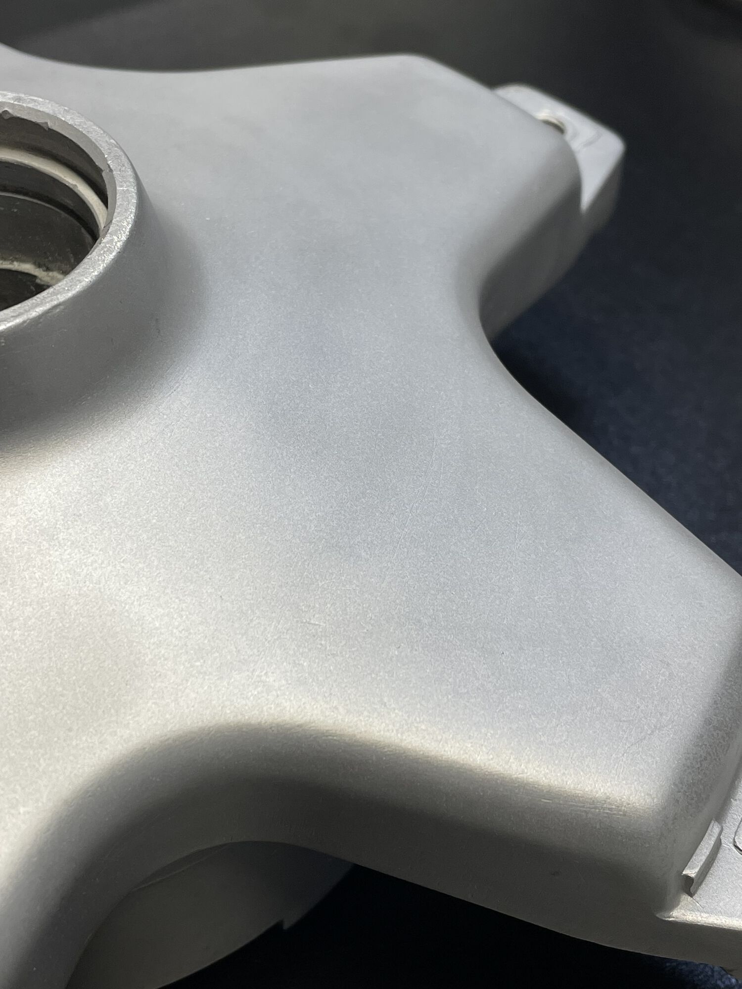

Just received parts after glass blasting.
Of course not perfect but absolutely acceptable for me.

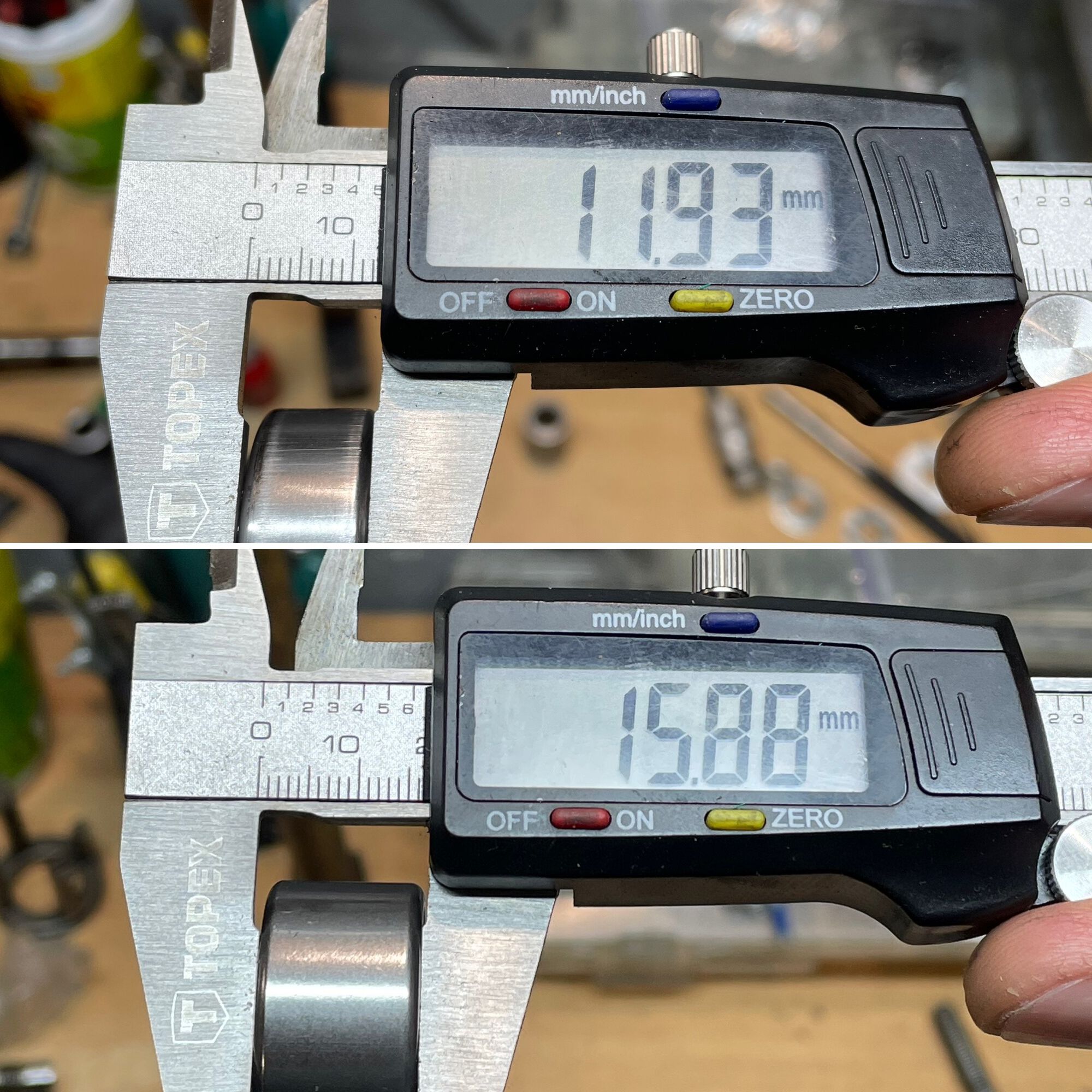

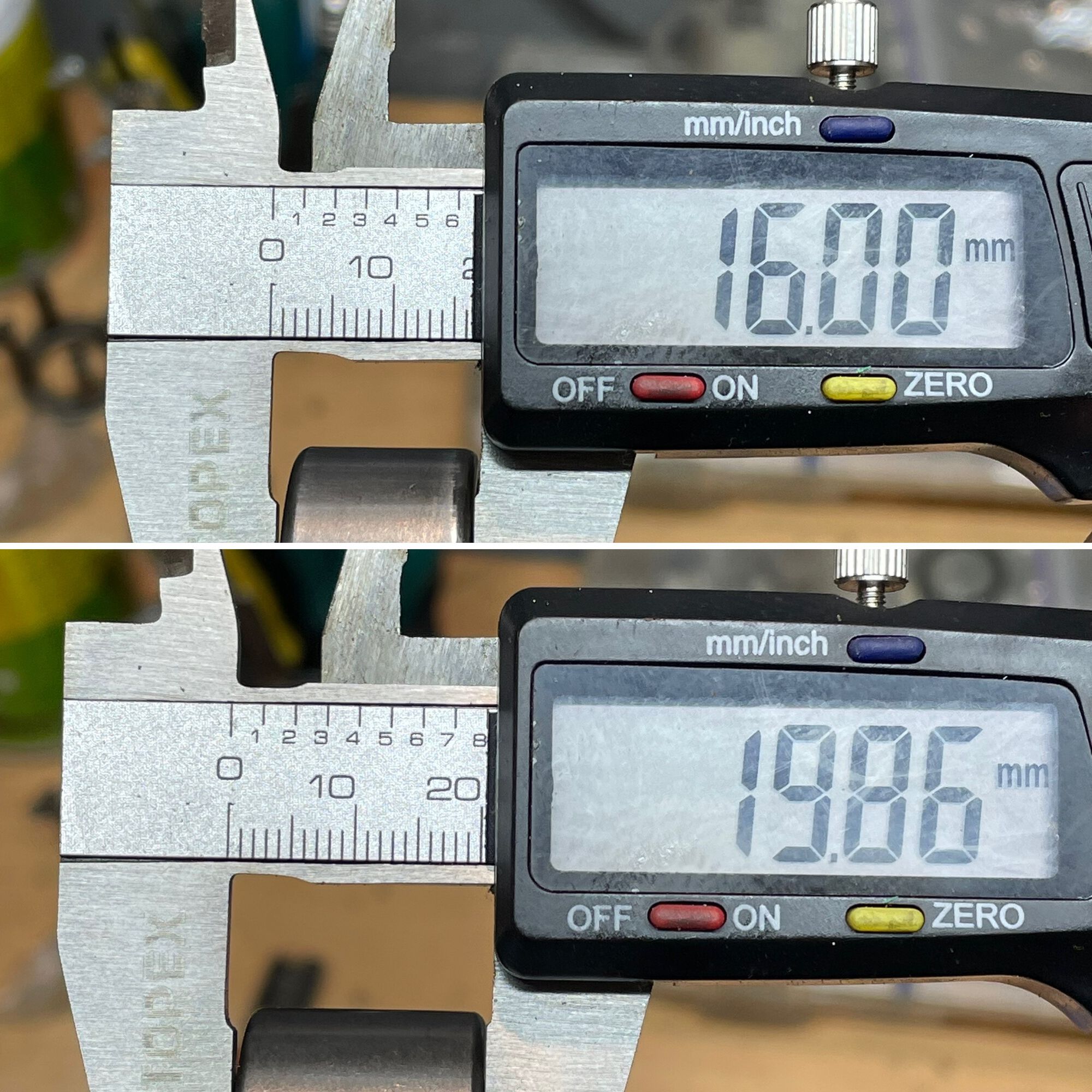

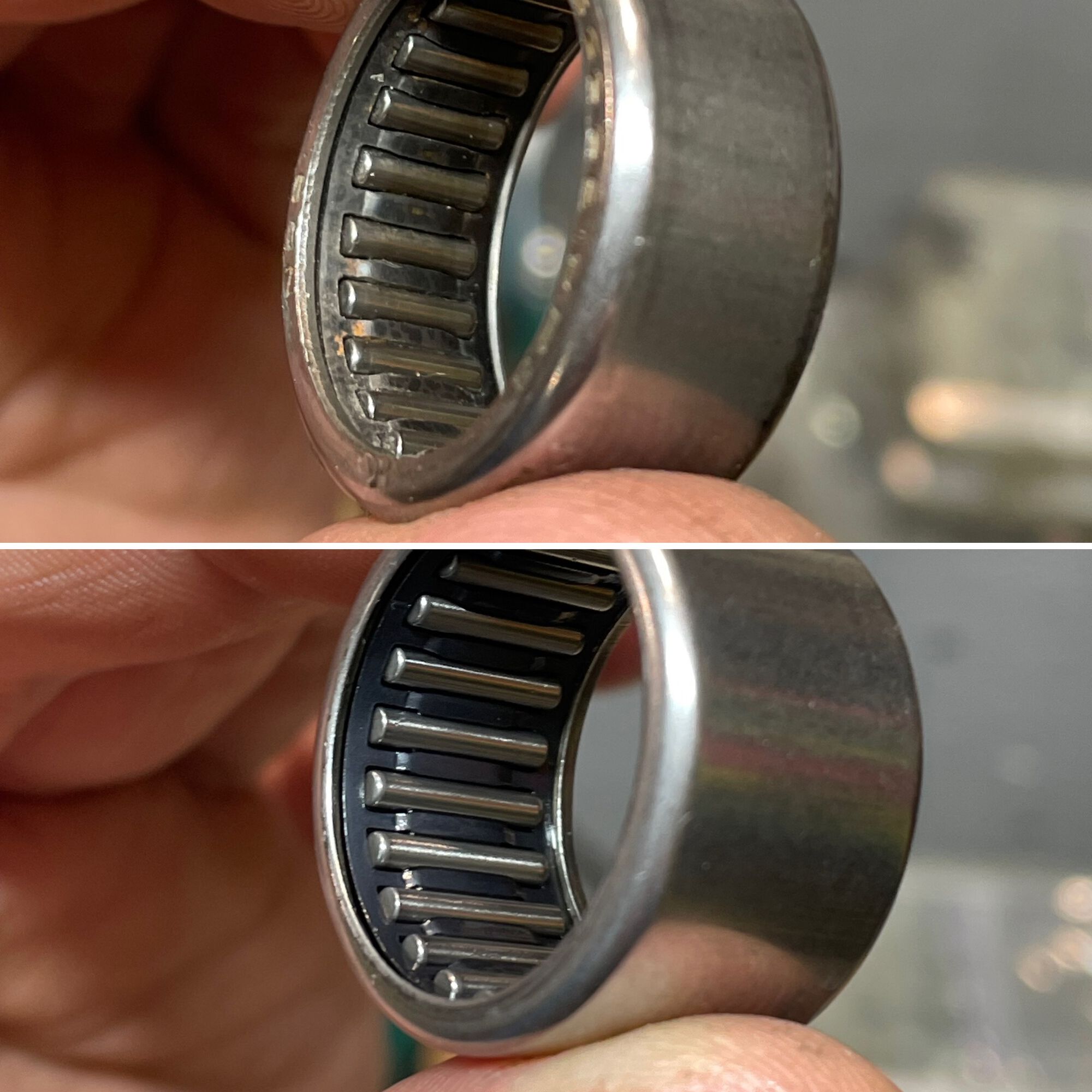

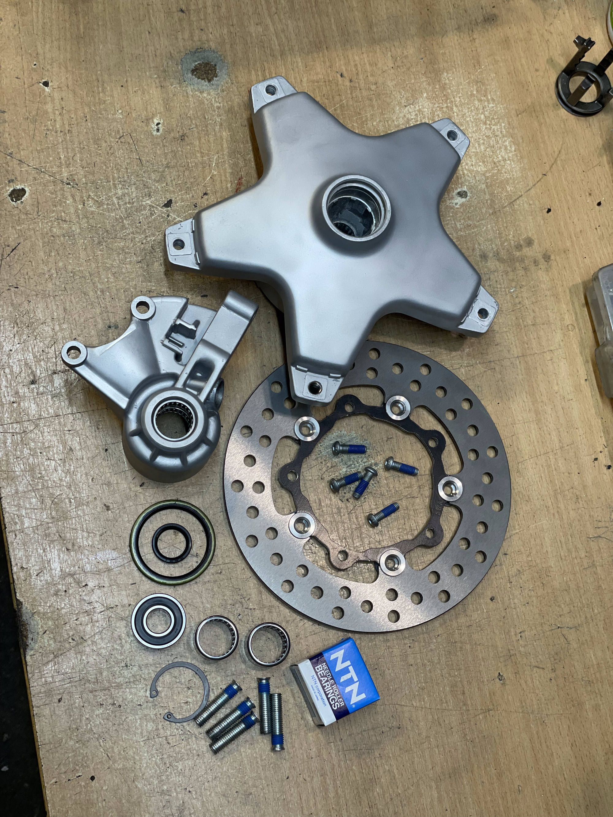

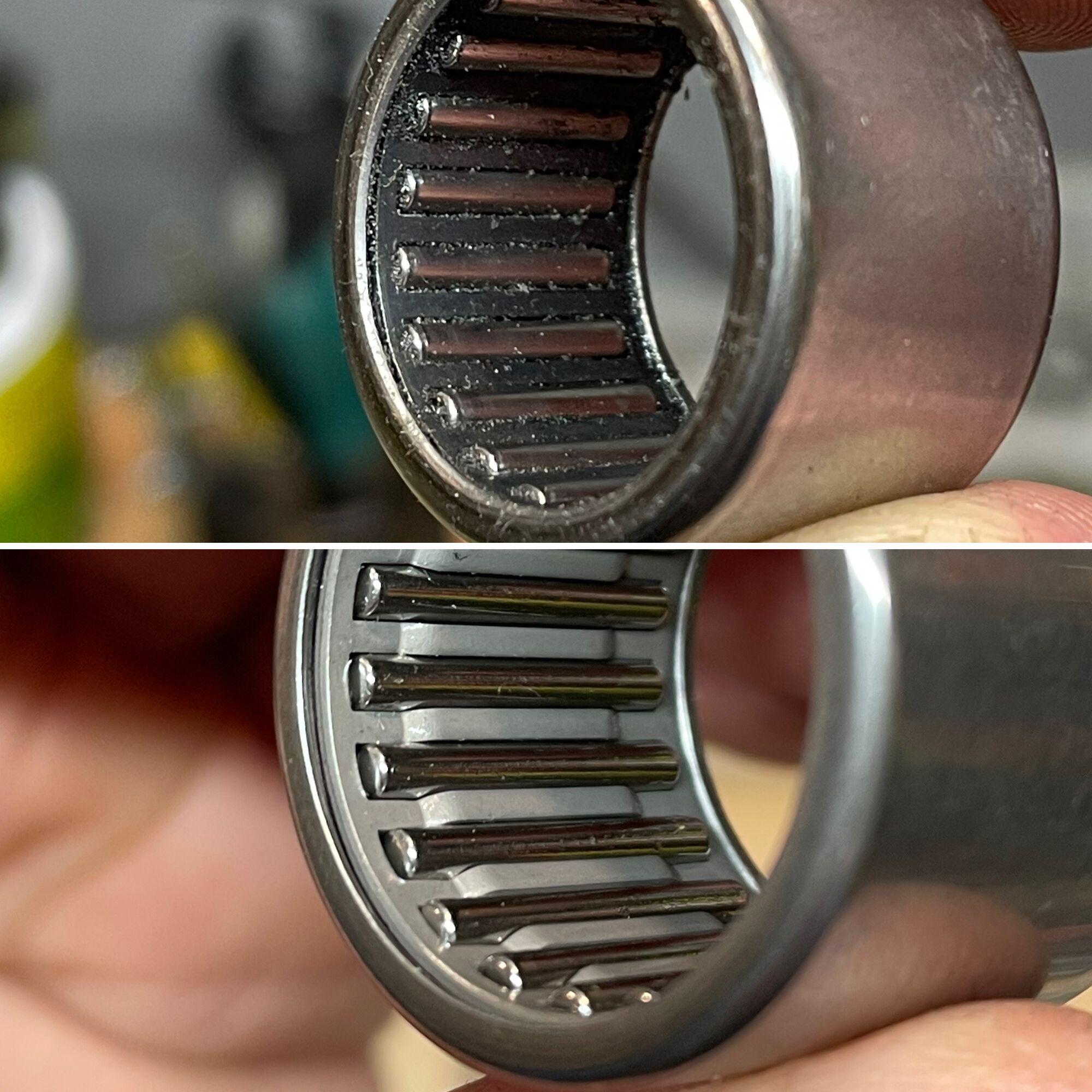

More progress.

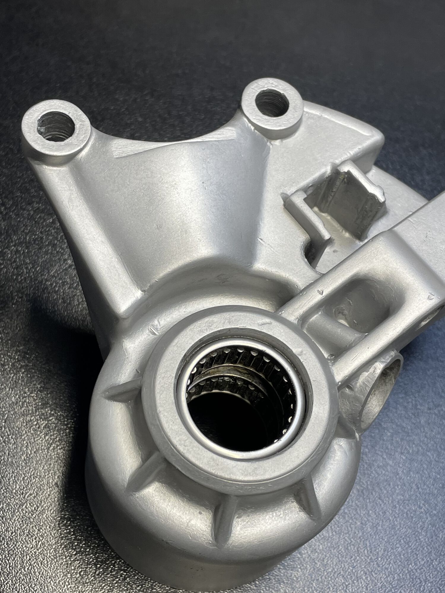

SaFiS you was right - 40mm studs is too long. So I cut them to 35mm and mount into hub.
I also put new bearings and seals. I decide to use wider needle bearings.
For the hub HK2020 instead of HK2016.
For carrier HK2216 instead of HK2212. Then it turned out that there is no space in carrier for two HK2216. So I put in HK2216 and standard HK2212. Another option is HK2216 and HK2214 but I couldn't find the last one in decent quality.
HK2016 vs. HK2020
HK2016 vs. HK2020
HK2016 vs. HK2020
HK2016 vs. HK2020
HK2212 vs. HK2216
HK2212 vs. HK2216
HK2212 vs. HK2216
HK2212 vs. HK2216
⚠️ Last edited by roland87 on UTC; edited 2 times

Lookin real clean n mean. Nice touch and good tip with the wider bearings

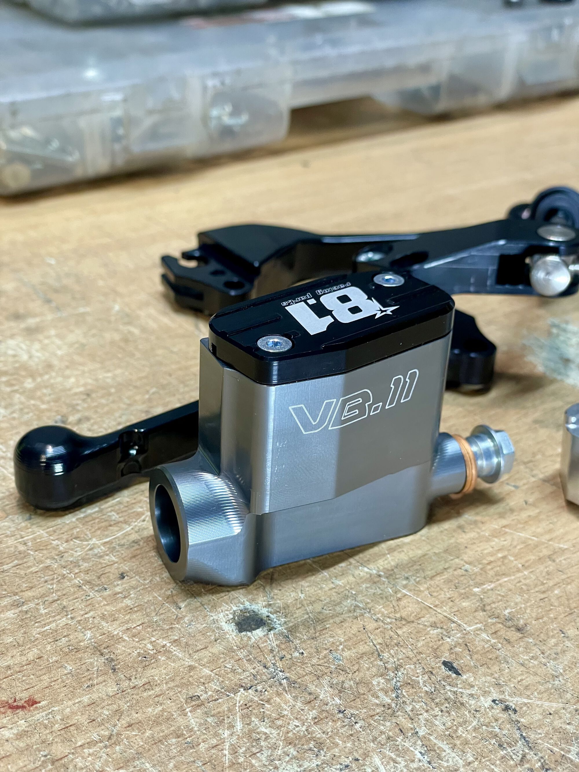

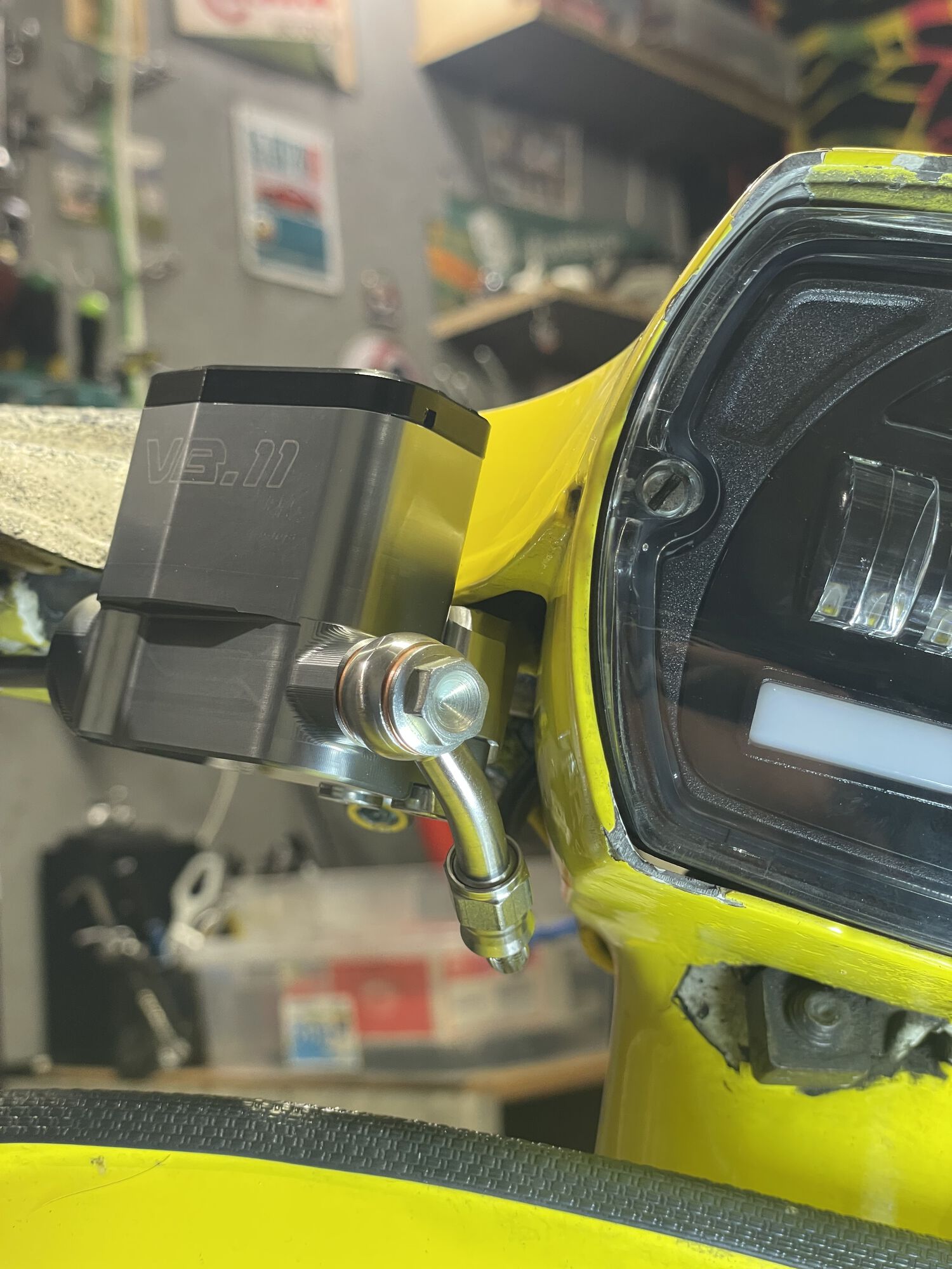

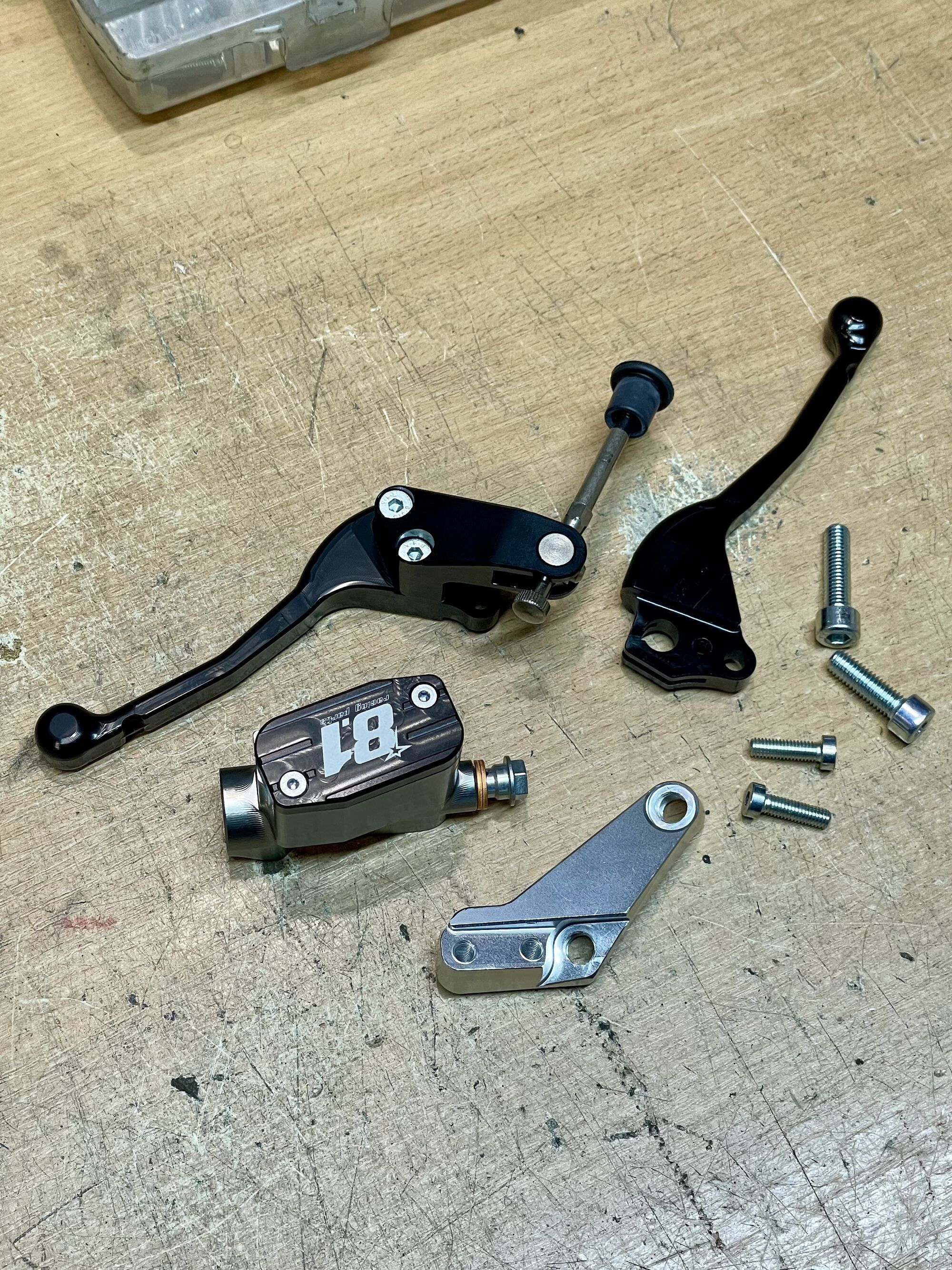

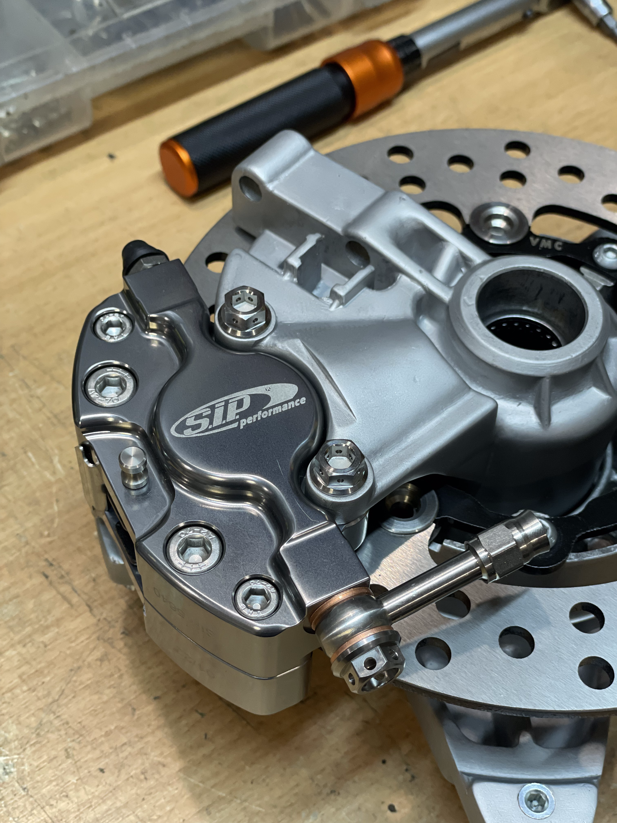

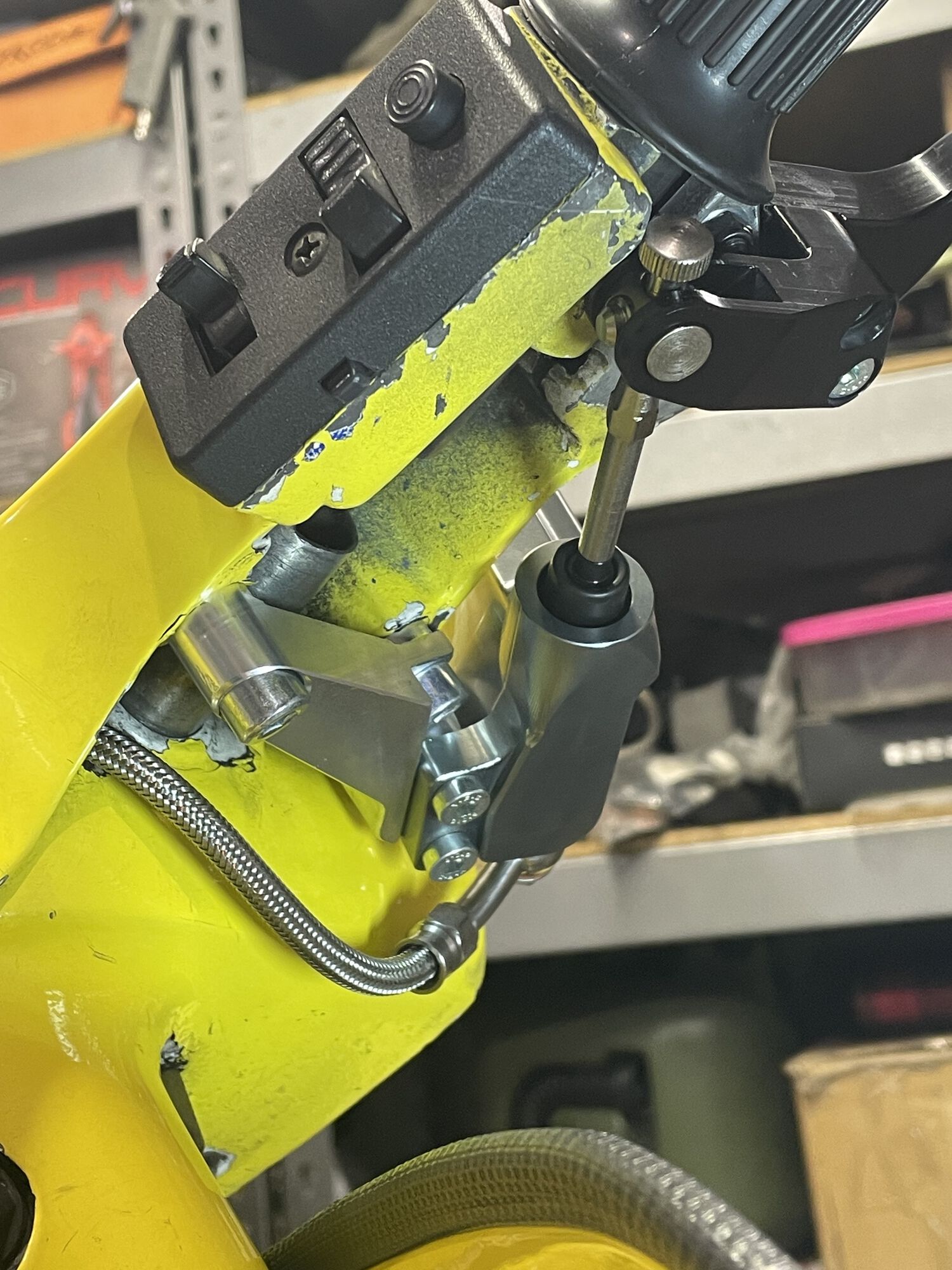

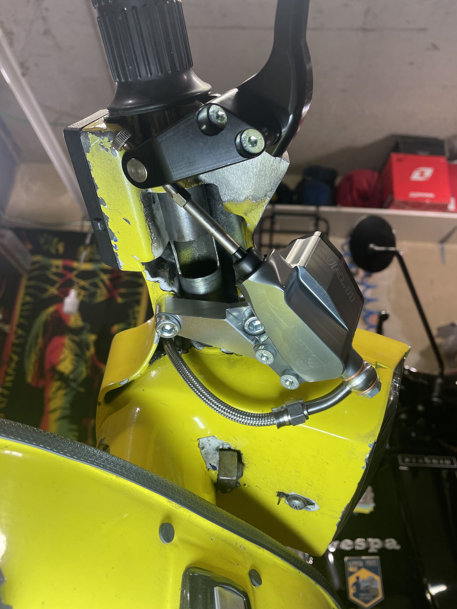

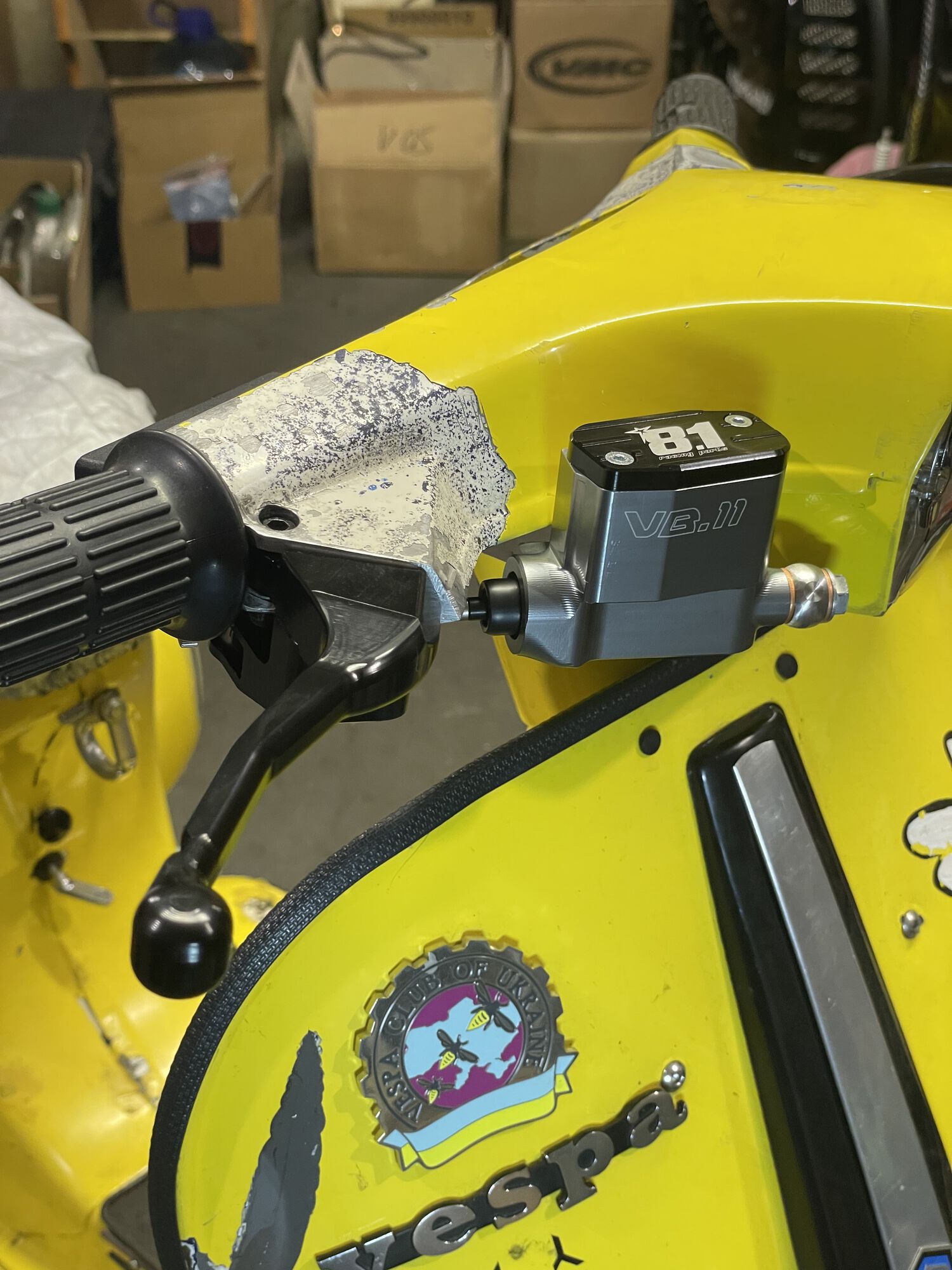

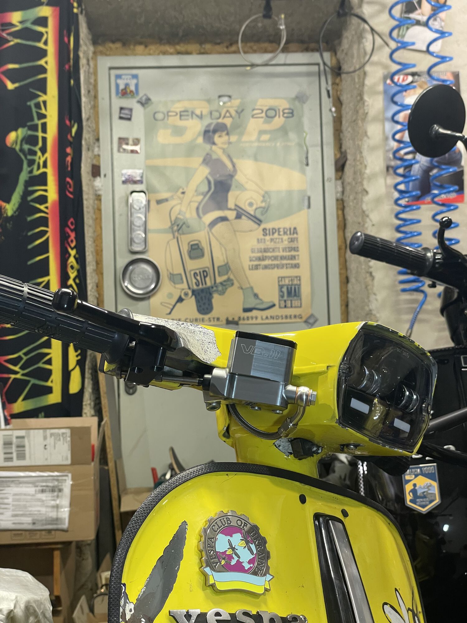

Hours of googling, reading, thinking and comparing and in the end I decide to choose Ottopuntouno.
Today it arrived. Nice overall impression, in hands better than on pics, but still I don't like levers.

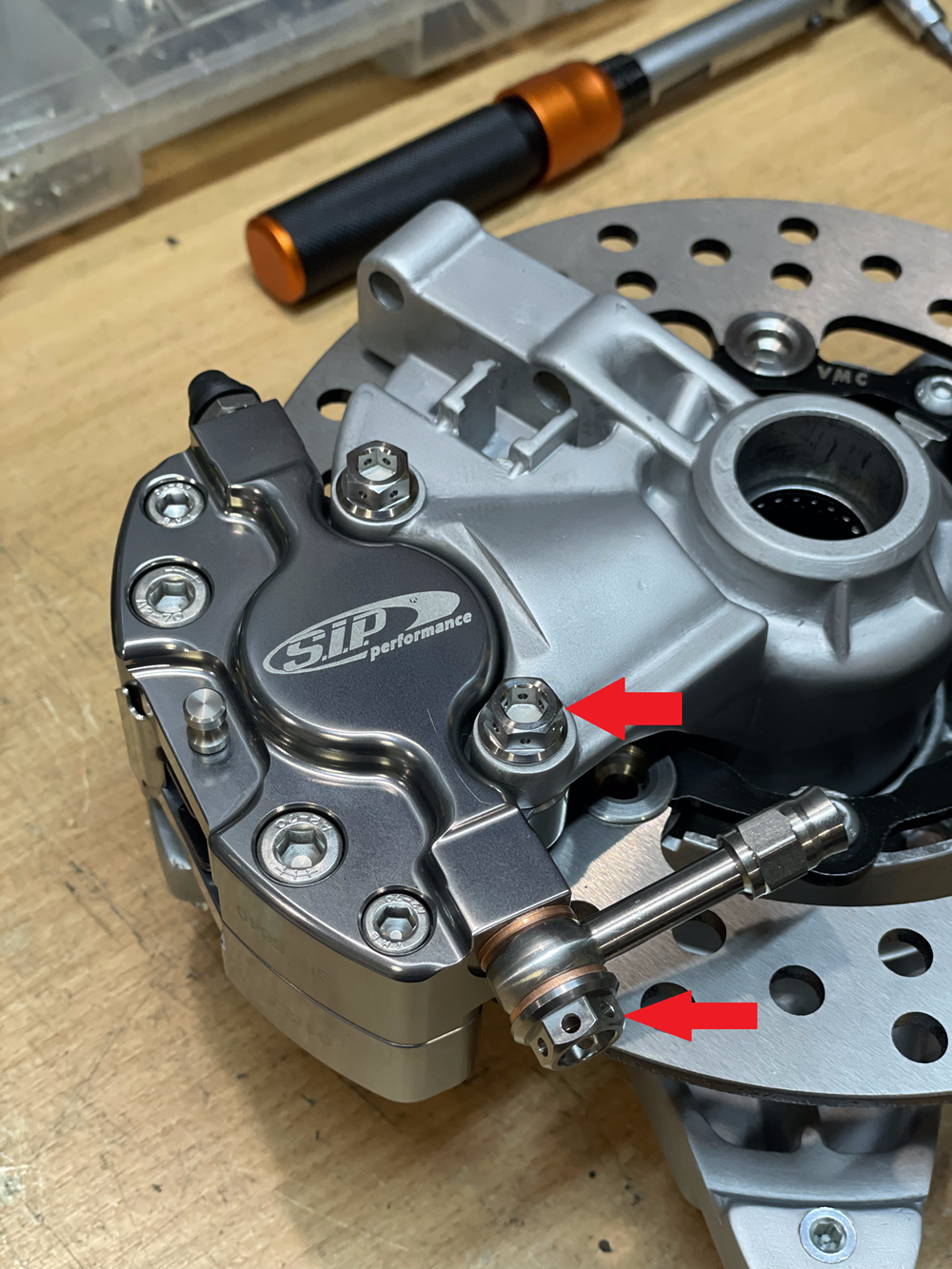

SaFiS banjo bolt and caliper bolts. Tell me if links works, Aliexpress is terrible.
BTW banjo bolt was too long, I need to cut it down.

Titanium Good luck cutting them down. Beejeezus did I have struggles with that weird metal. Also always use anti galling/seize when fitting, ALWAYS, even just grease.
Only caliper bolts is titanium, and them is proper length. Banjo bolt is stainless and need to be cut.

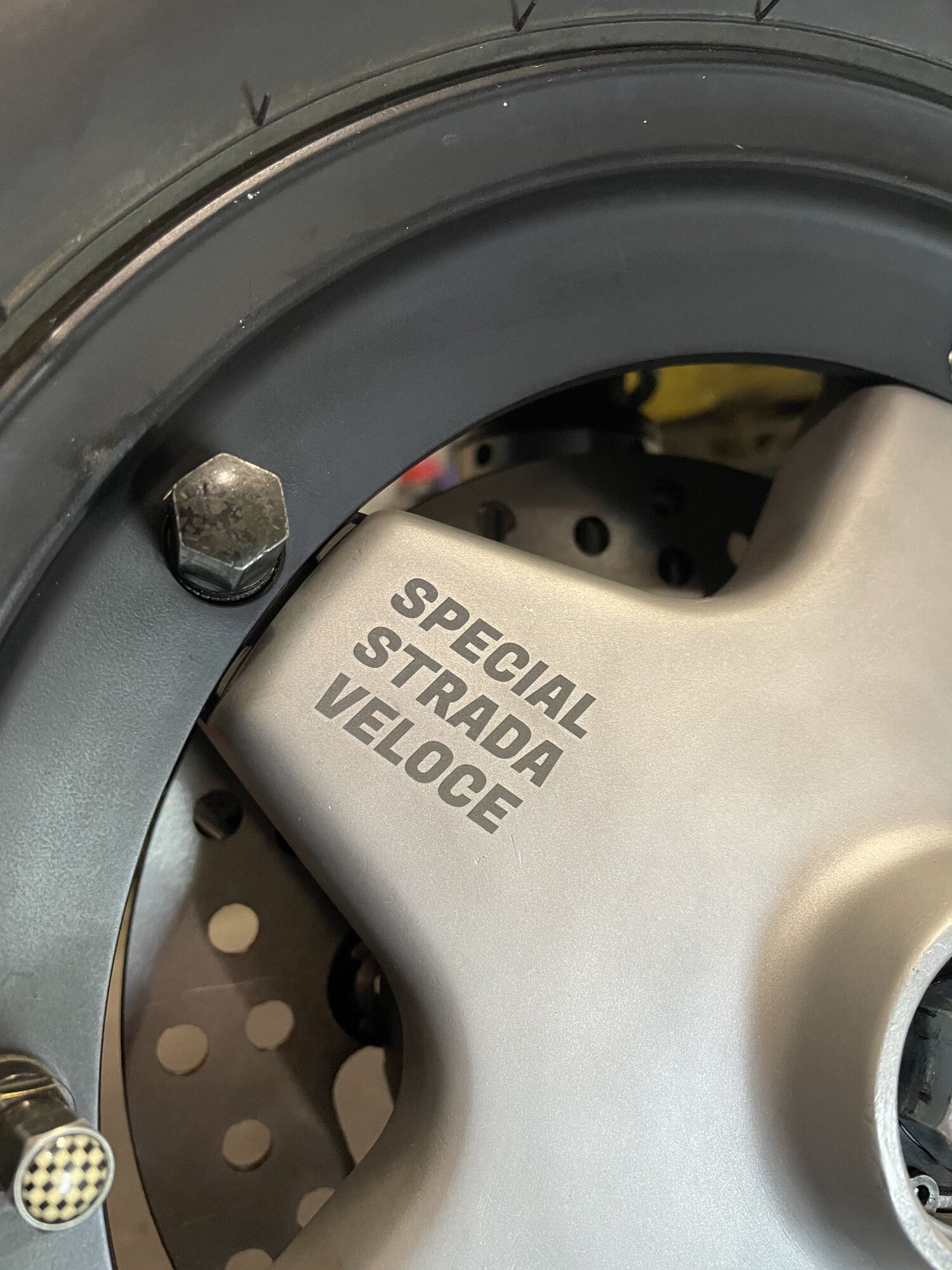

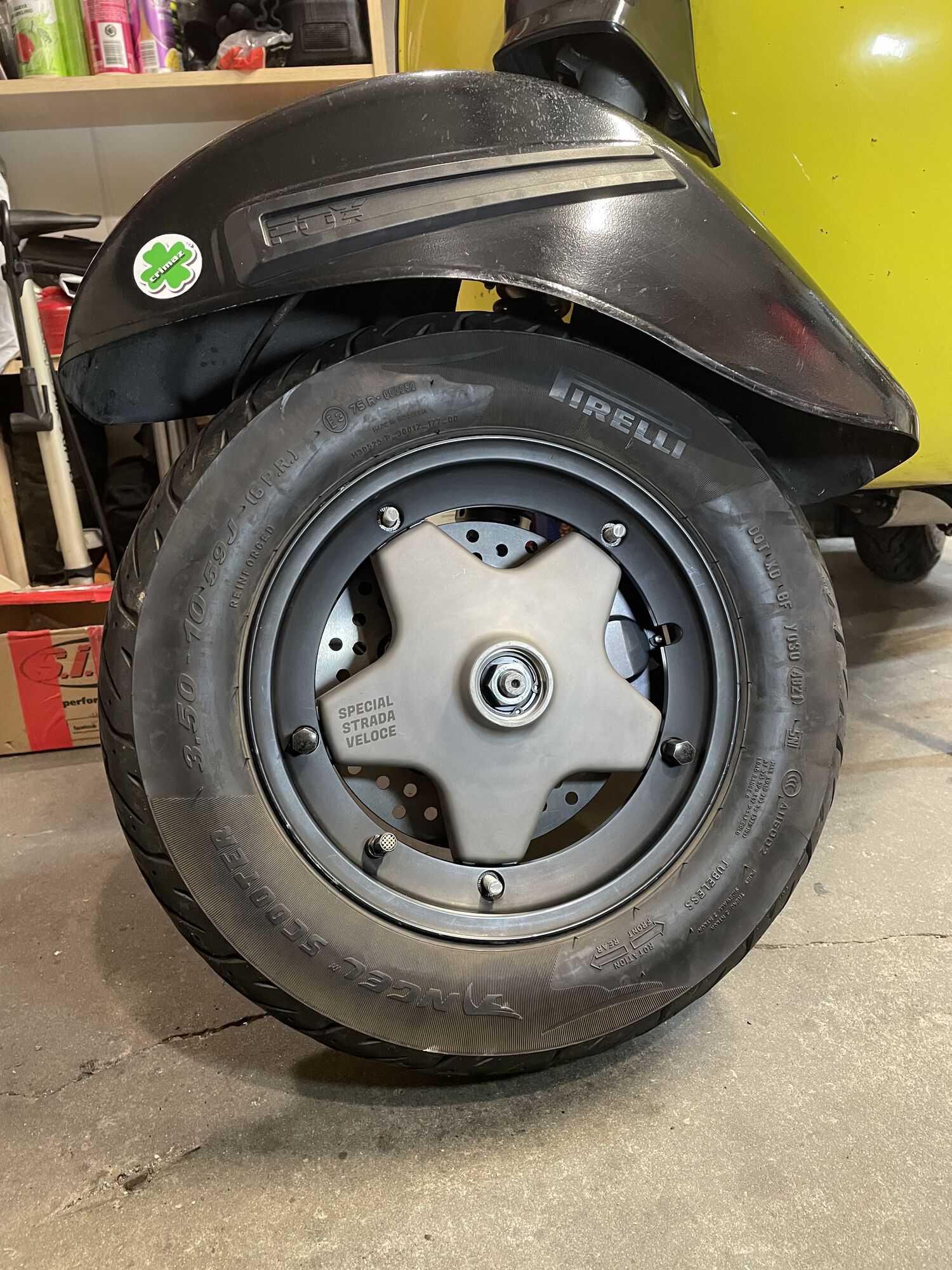

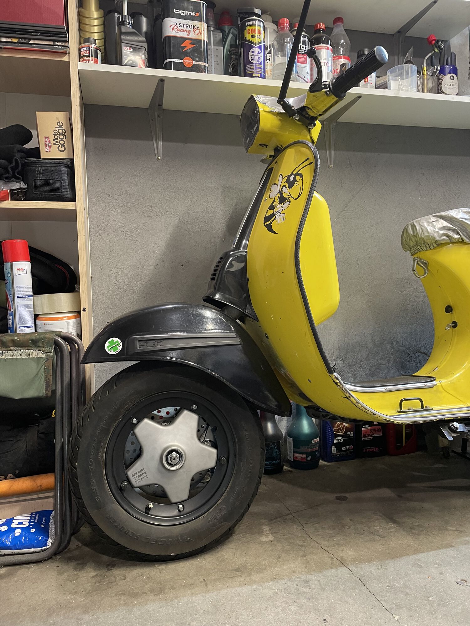

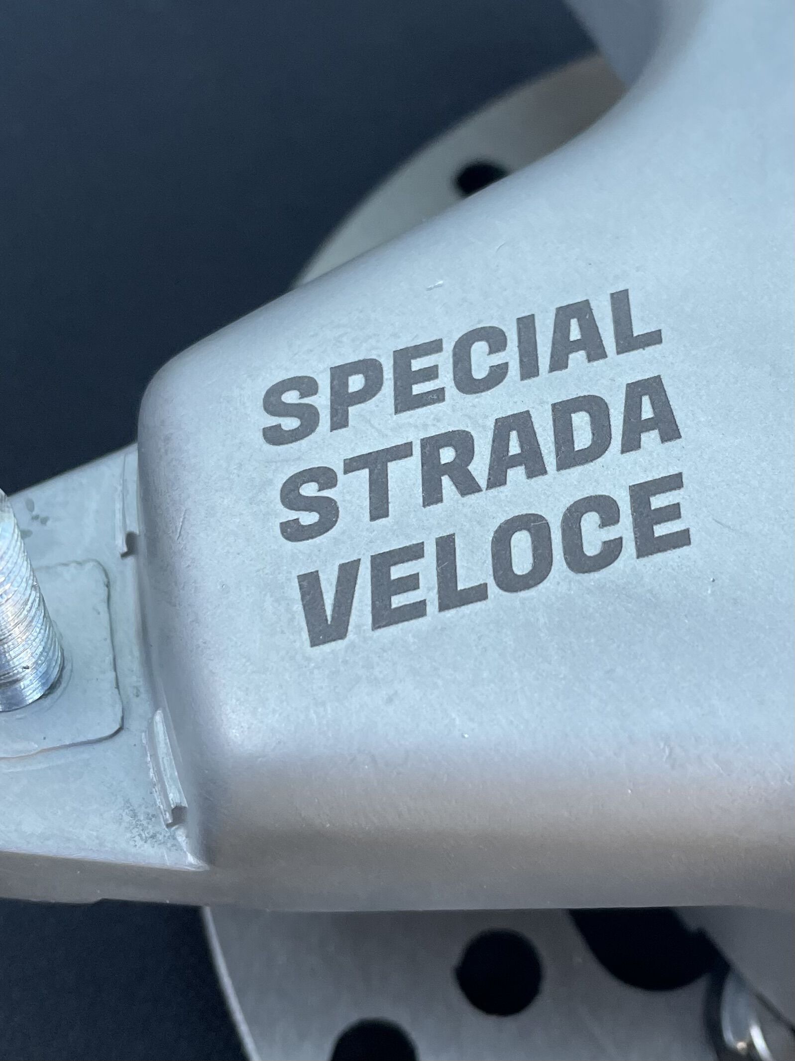

Added a bit of individuality.
Very cool. Now you'll have to check every time you park to make sure people can read it! 😁

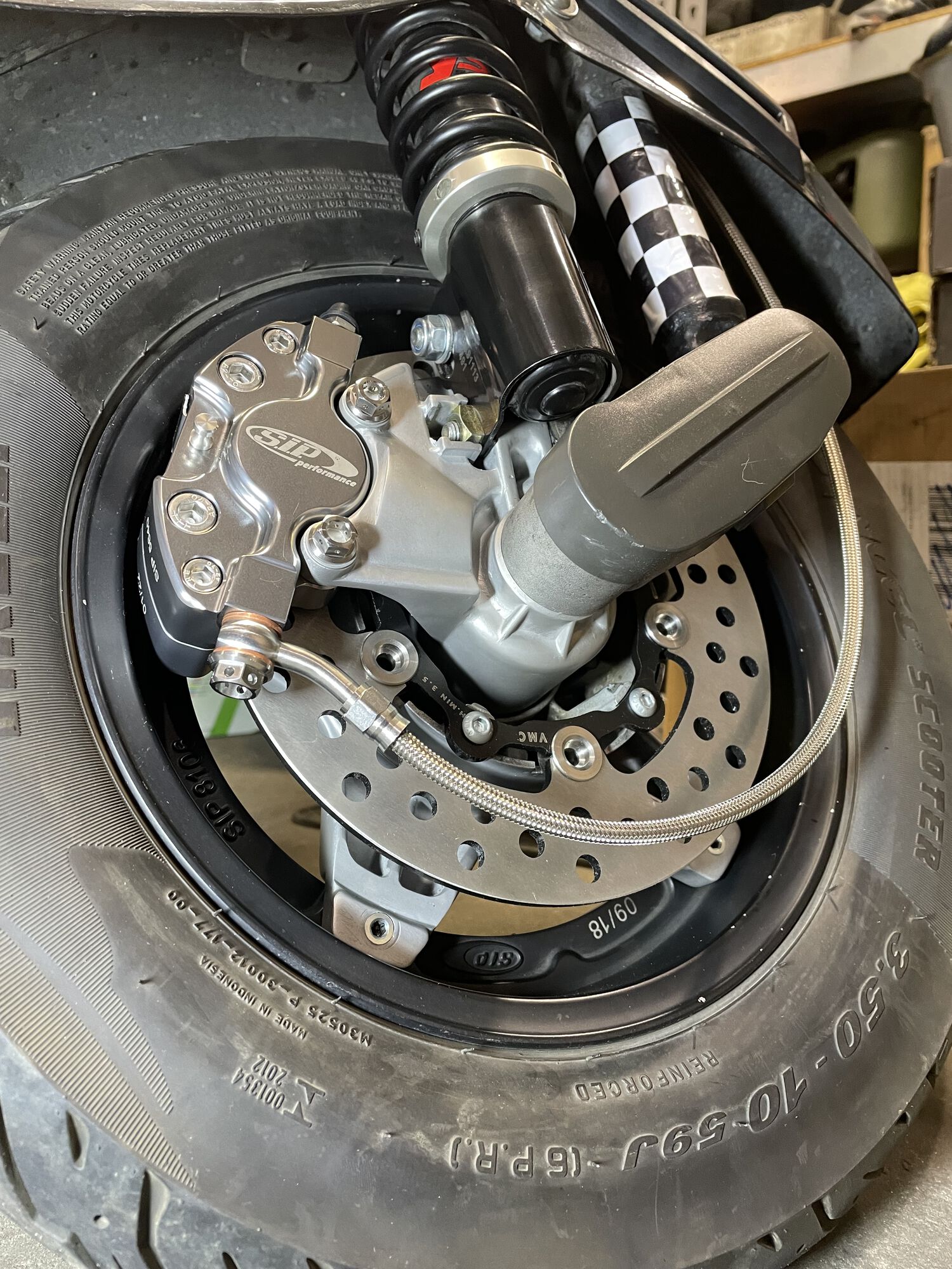

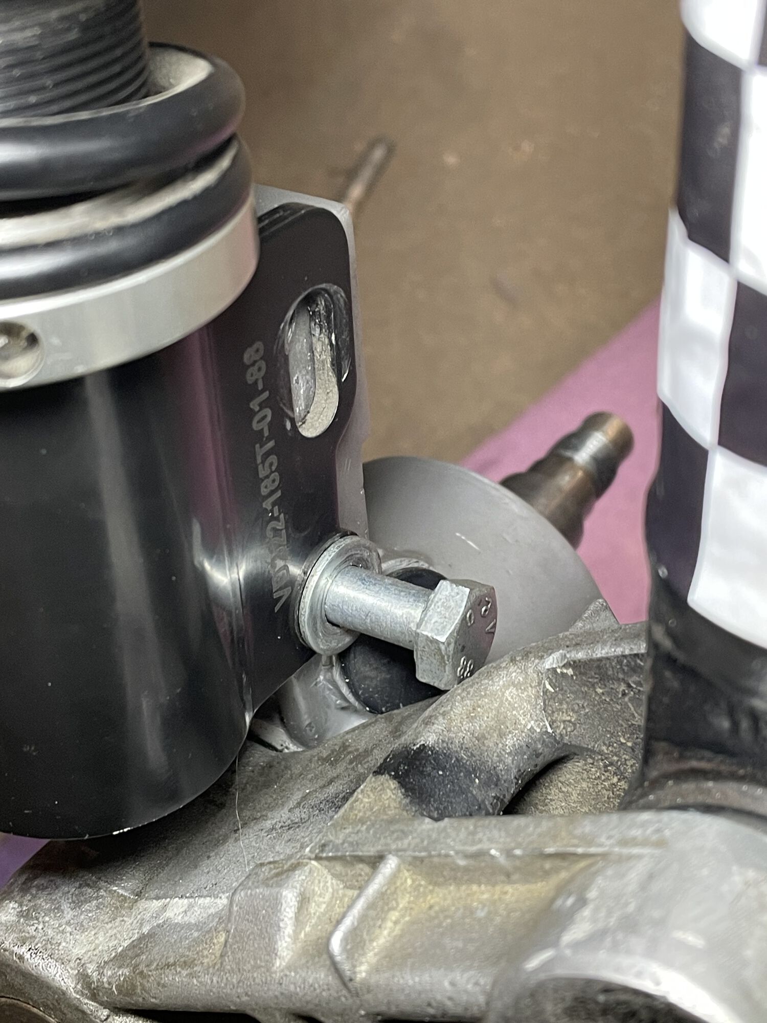

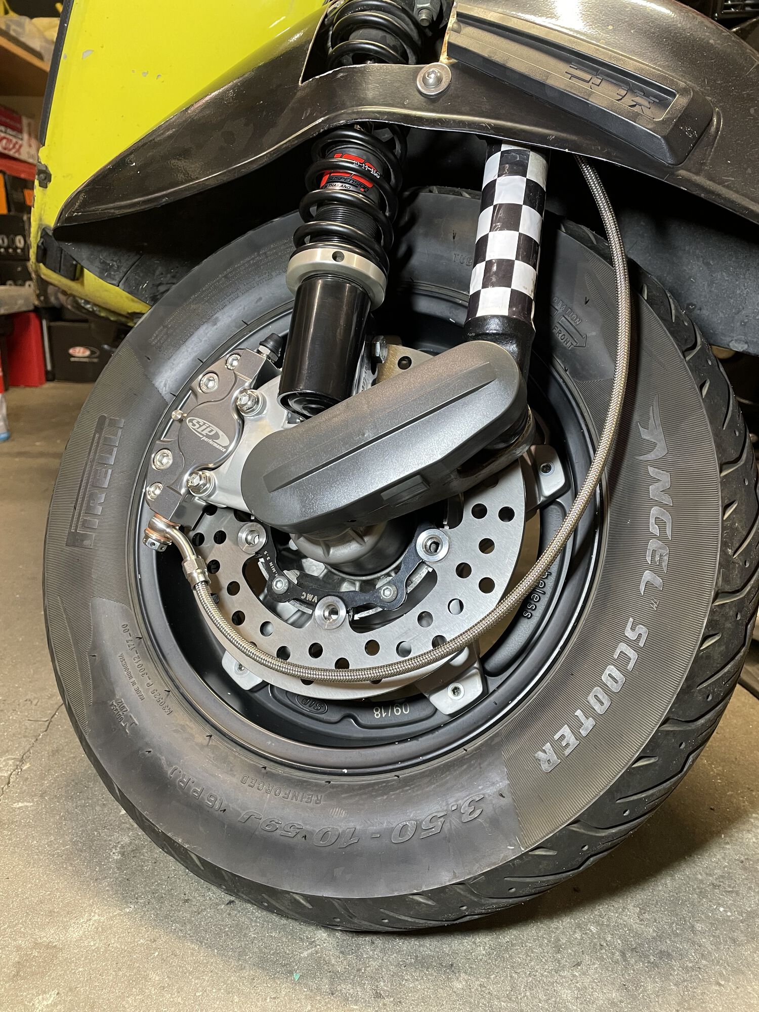

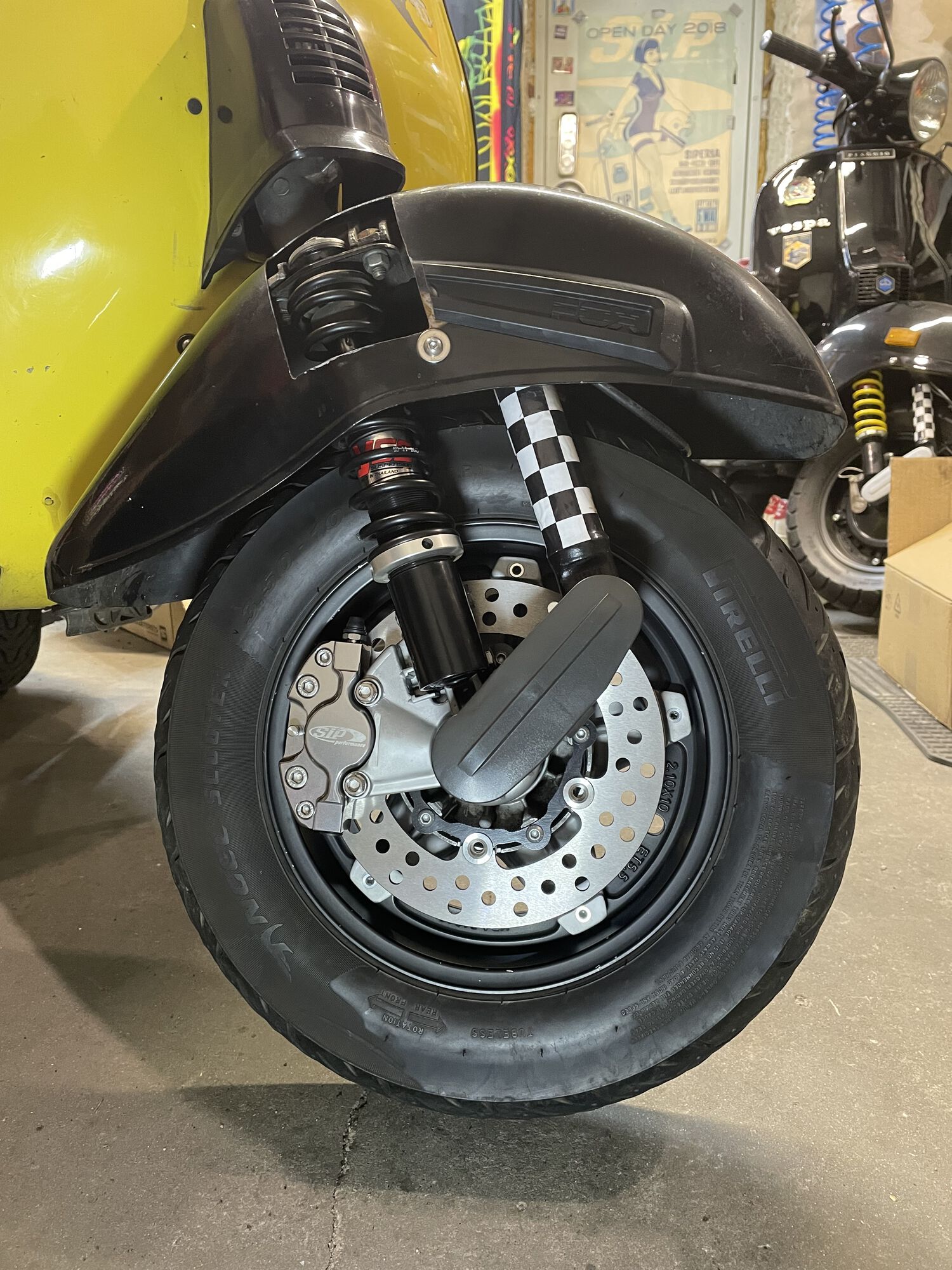

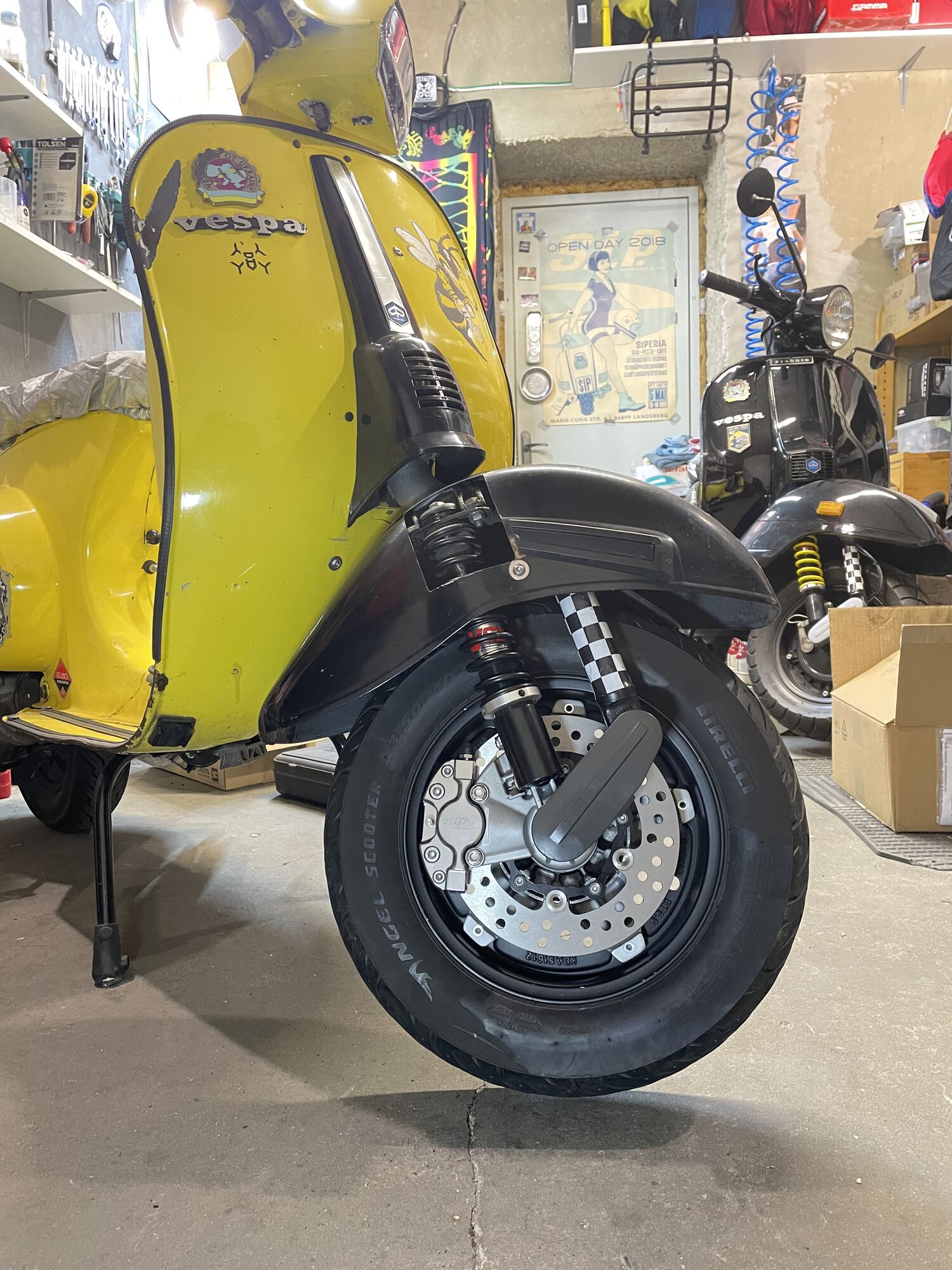

Bottom end was mounted.
It was harder than I thought and took all my free time this evening.
Absolutely unable to put in lower shock absorber bolt and here cut out on mudguard help a lot. I unscrew shock, compress spring and turn it down with carrier. Inserted bolt and turn it back. I also was need to grind a bit holes for bolts on the shock absorber mount.
In the end all good and much better than I expected about LML hub looking.
I think that removing ring from the hub is main gamechanger, thanks whodatschrome.
It was harder than I though and took all my free time this evening.
WOW! That whole front end looks very handsome. Nice work. Now i'm extra motivated to take the LML 5 start hub off of my PK fork and remove the ring off of it!

Looks great Roland!
I find it easier to put the bolts in from the opposite direction.
Impossible with LML carrier )

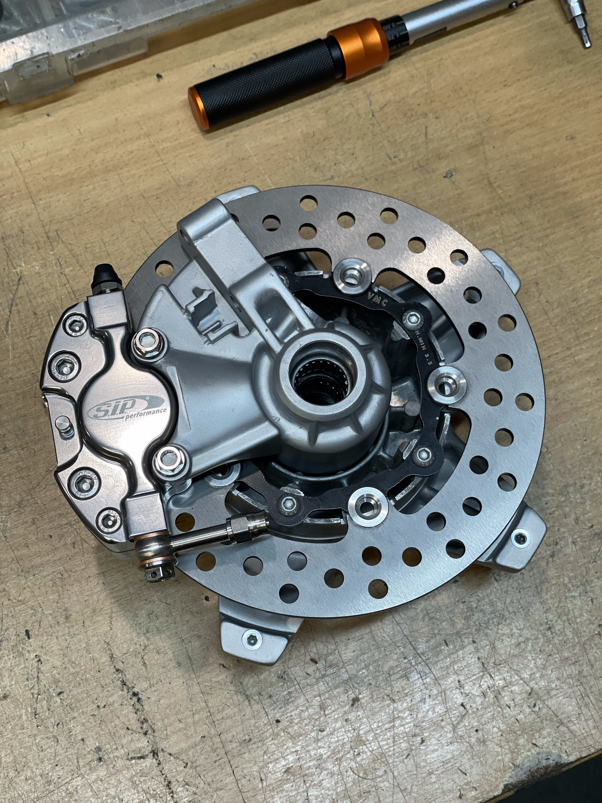

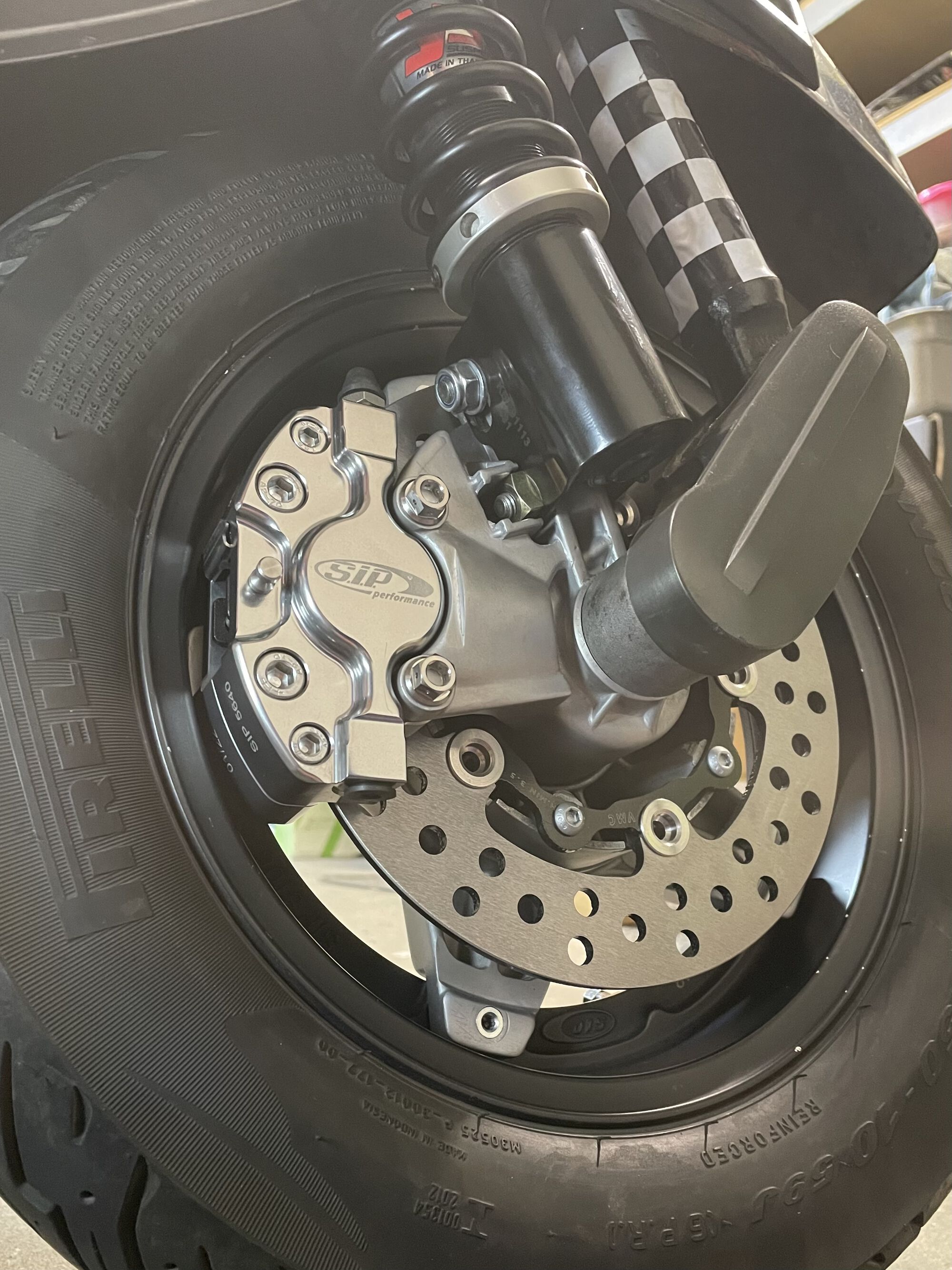

Bottom end done. Only one question - what torques for caliper M8 bolts and banjo bolt?
parallelogramerist
Posts: 6023
parallelogramerist
Posts: 6023
I'm not going to make it too easy for you, so here's where i get my torque specs from. The caliper torque spec is listed here..
https://beedspeed.com/en-us/pages/vespa-recommended-torque-settings

Great. Thank you whodatschrome. I even need to convert LBF. FT. to Nm

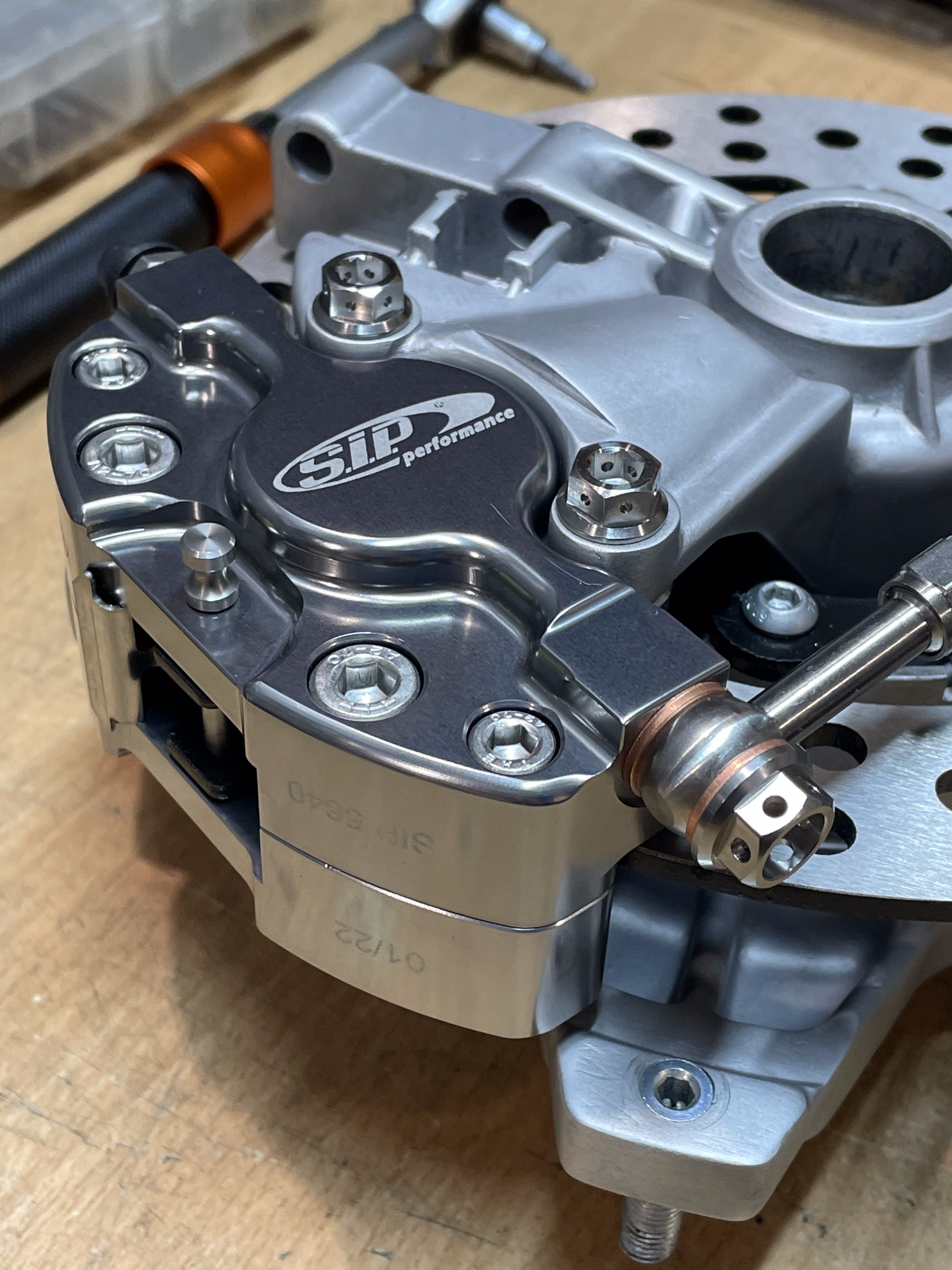

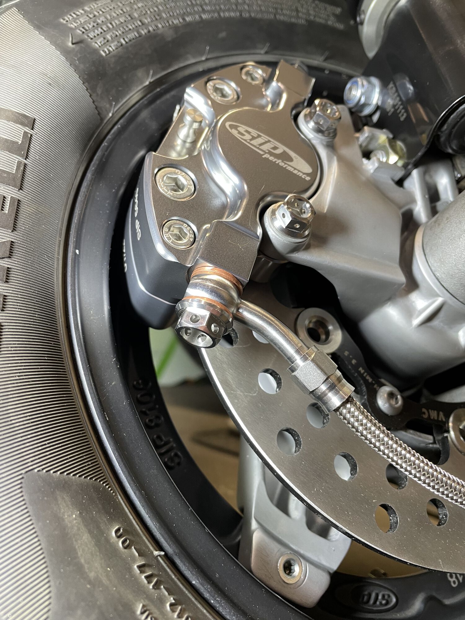

Almost done.
It turns harder than I thought.

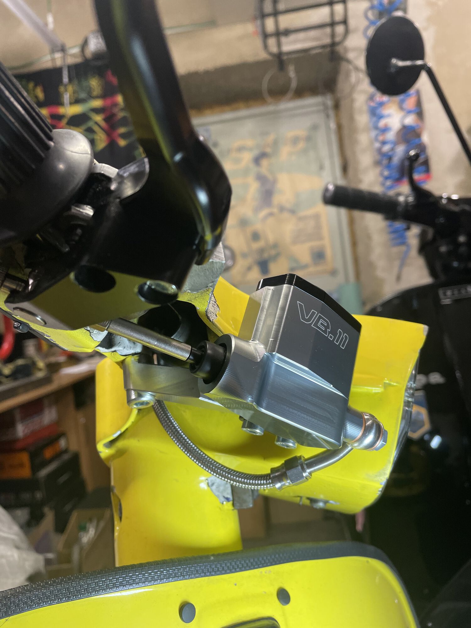

When I mounted bottom banjo to hose I had some doubts about its tightness.
But there was surprising that top banjo started to leak a bit during brake bleeding. I redone top banjo with cut hose a bit and new olive.
After that I understand what I did wrong with bottom banjo. I was right and it started to leak very little. Result the brake is work. How good nobody knows before spring. But it feels strong.
Too cold now so I have lot of time to redone bottom banjo.
Anyway not so bad for the first time working on brake hose.

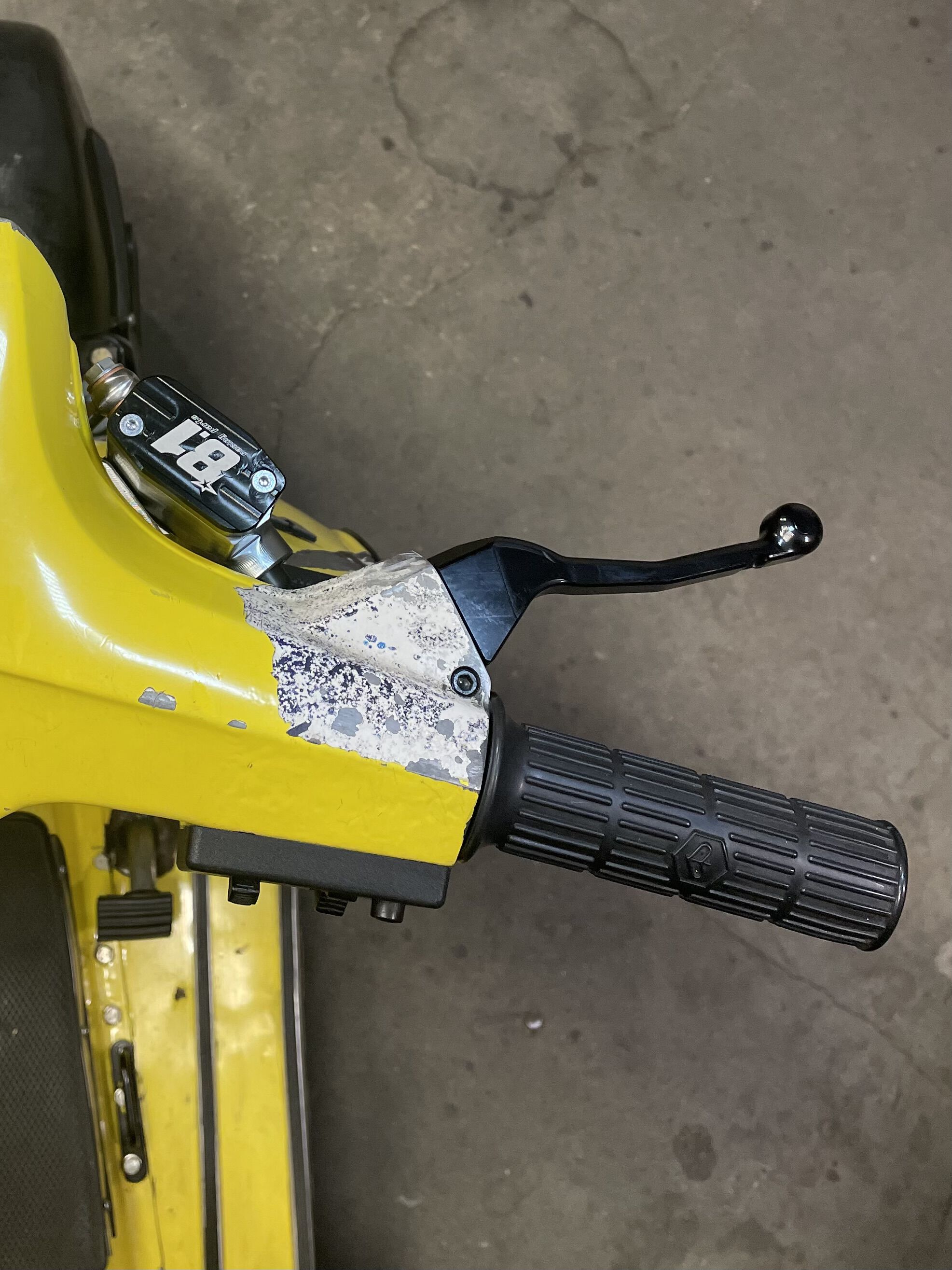

Lever is catching something inside handlebar and not smooth moving. Need to file a bit.
