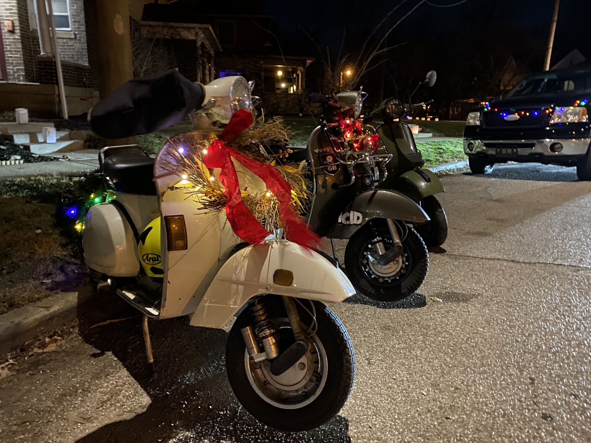

My arm chair guess is he wants to put LEDs on it for Christmas
There are way easier ways to do that, but I like your thinking.
