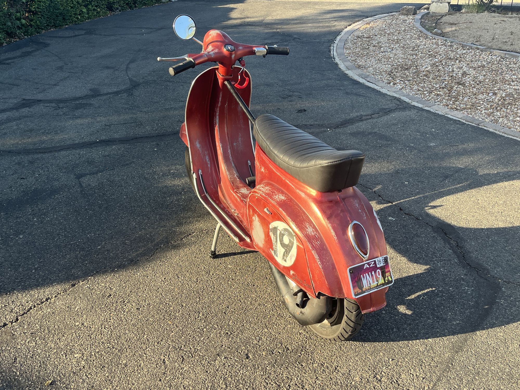

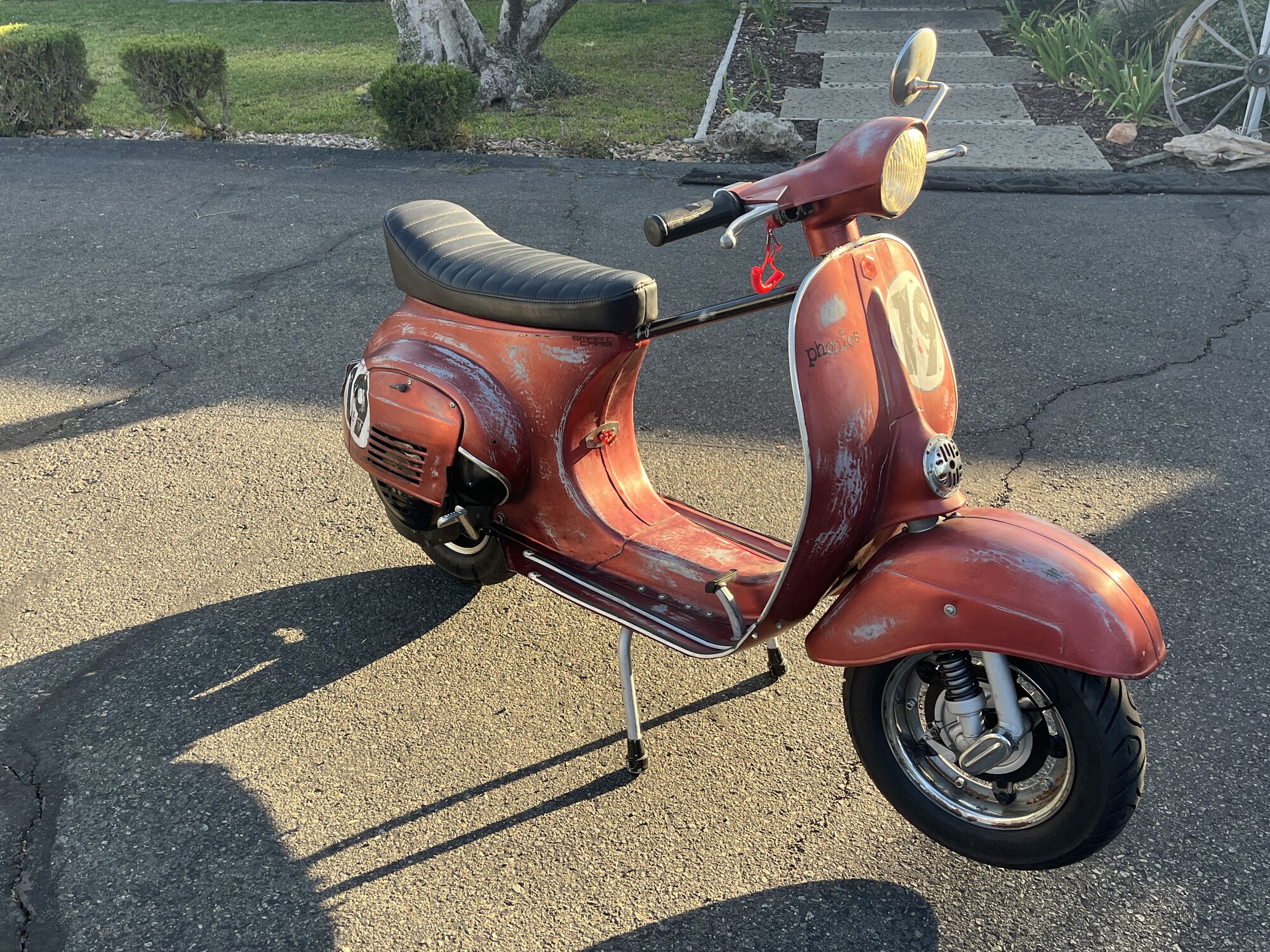

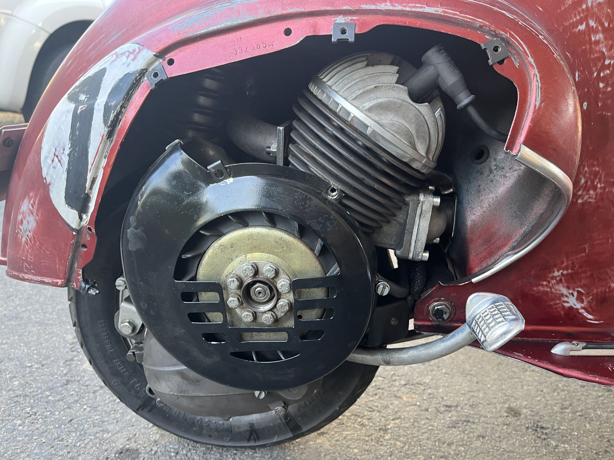

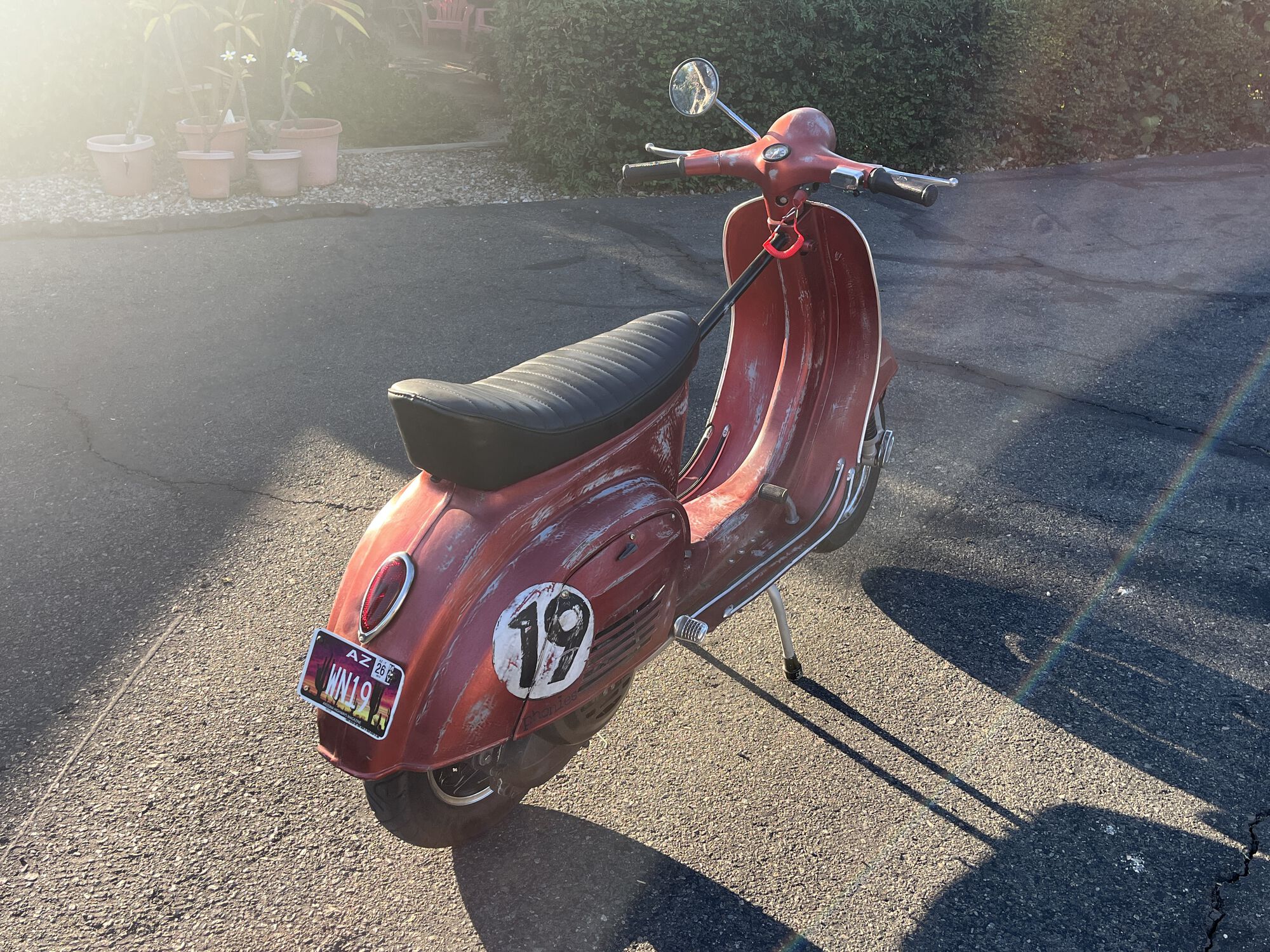

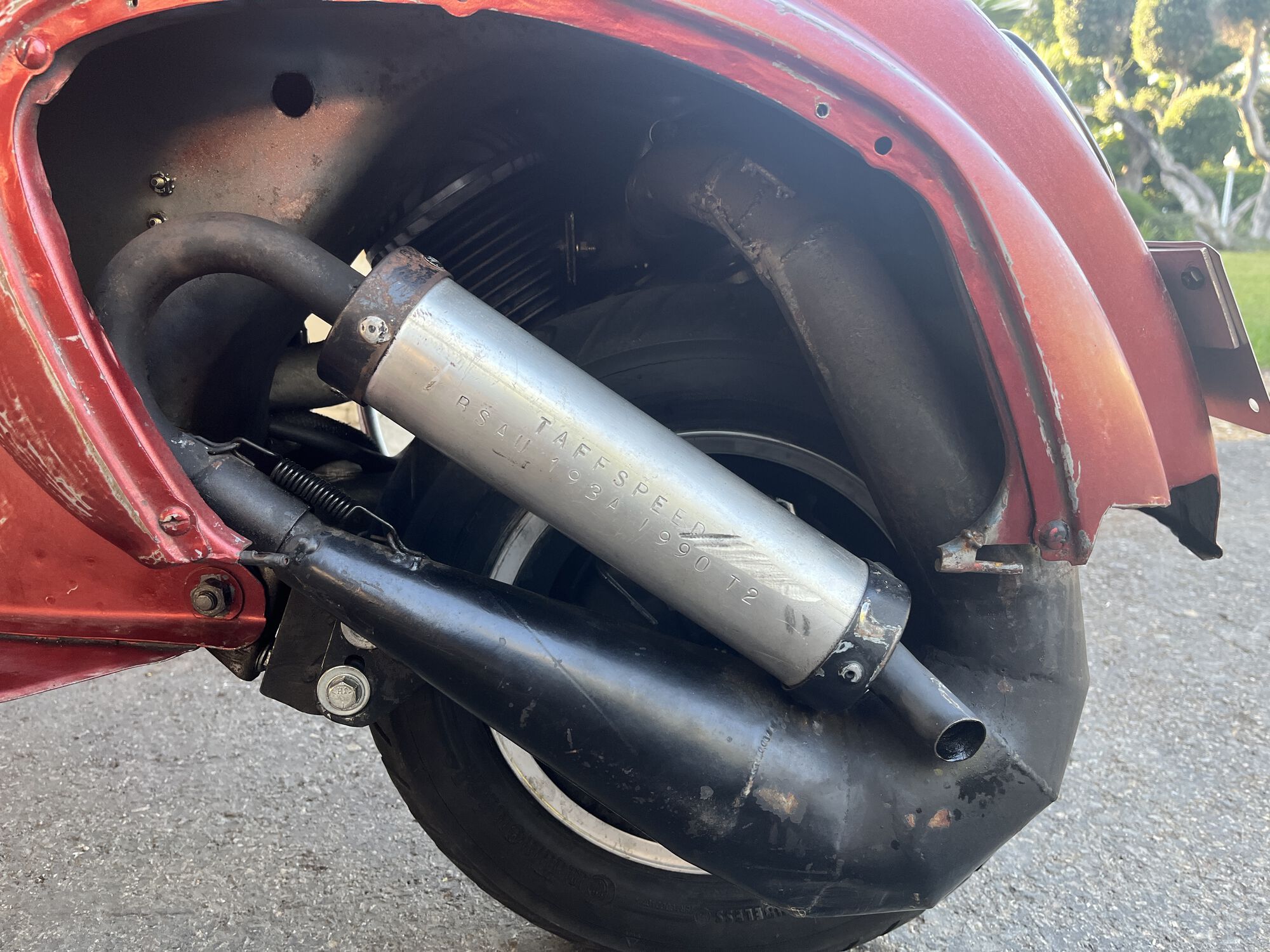

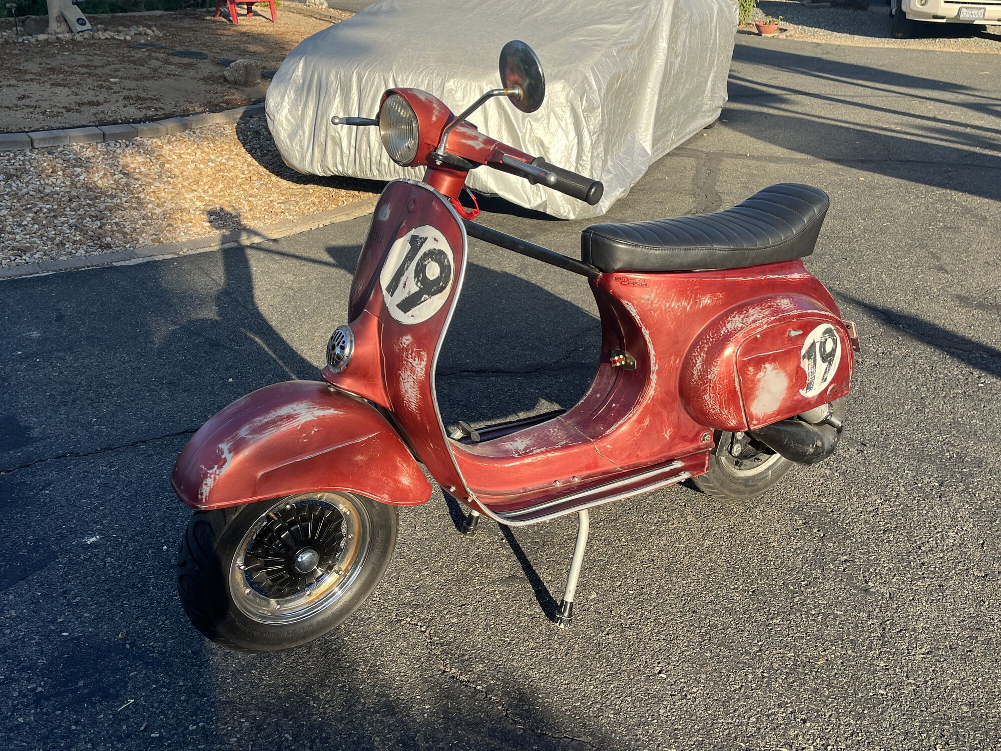

Hi all, thought I'd restart this thread. Picked this up yesterday, 1980 100 Sport modified and cut down to look like a SuperSprint, it has an ItalKast 135cc cylinder kit, Mazzucchelli crank, 27/69 primary, VMC clutch, 4 Speed conversion, 28mm SmartCarb SC2, Taffspeed pipe, and P200E ignition with a lightened flywheel (which I will eventually replace with a SIP Vape).
Will be repainted eventually, and I am wondering if it's possible to run turn signals with an AC ignition, which the Vape will be AC on this one. Also still have the bone stock beige 100 Sport as well that eventually will get modified as well. But I found this one for sale and it was such a good deal, I said why not.
What I might end up doing is eventually moving the cylinder on this one to that one and run a Quattrini M1L-60 GTR on this one, as this one already has frame bracing for more powerful engines.
If anyone can give me advice on running turn signals on an AC ignition if possible, that would be great.

AaronA wrote:
100 Sport
With V50 handlebar... Add switch and relay.

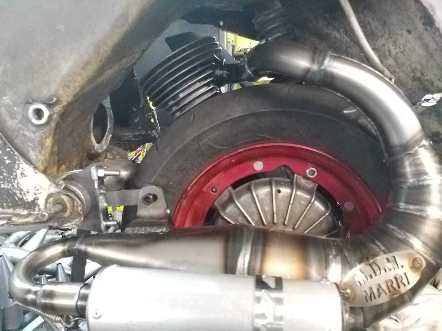

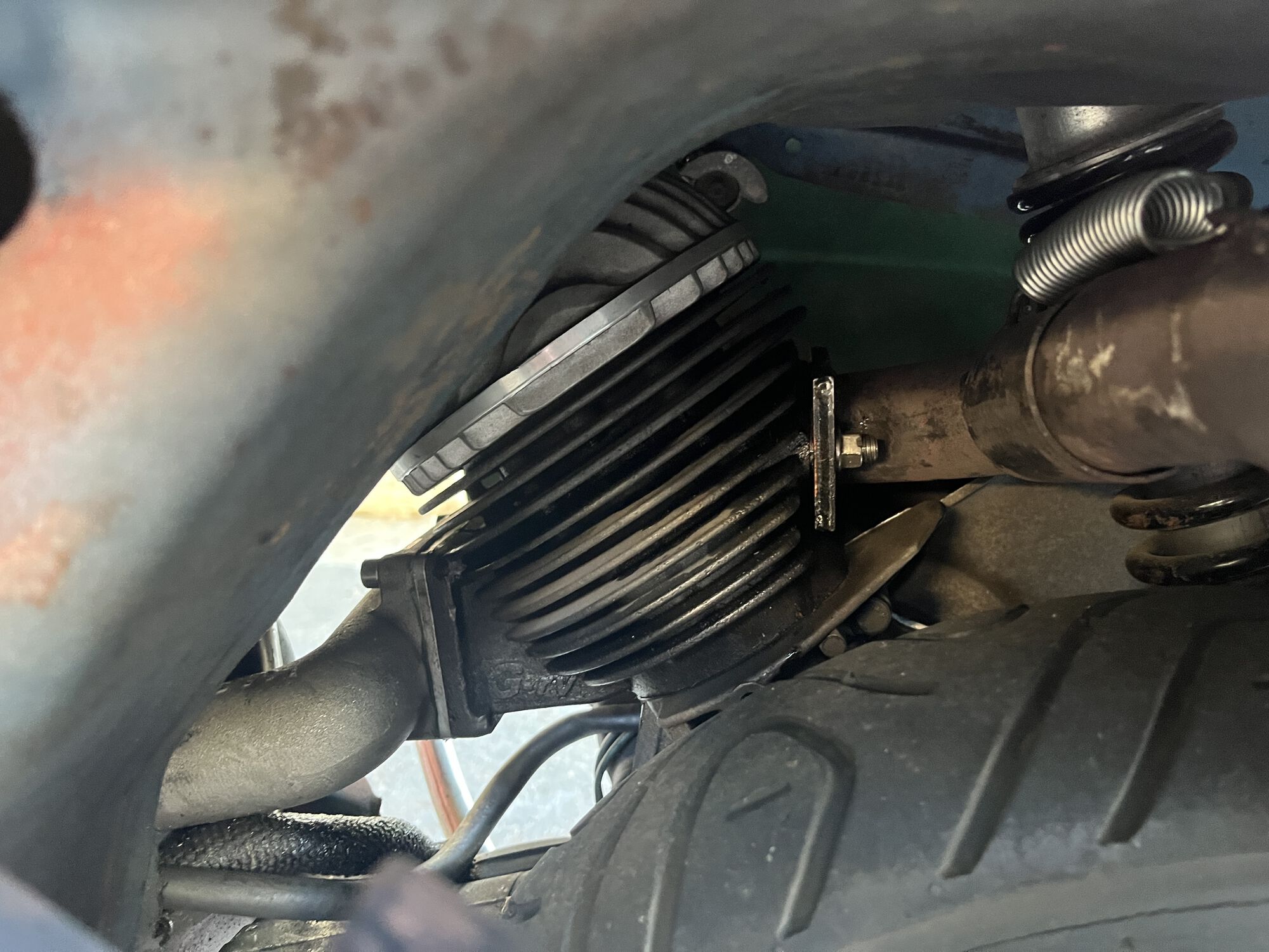

Why doesn't the engine have cylinder cowl?
