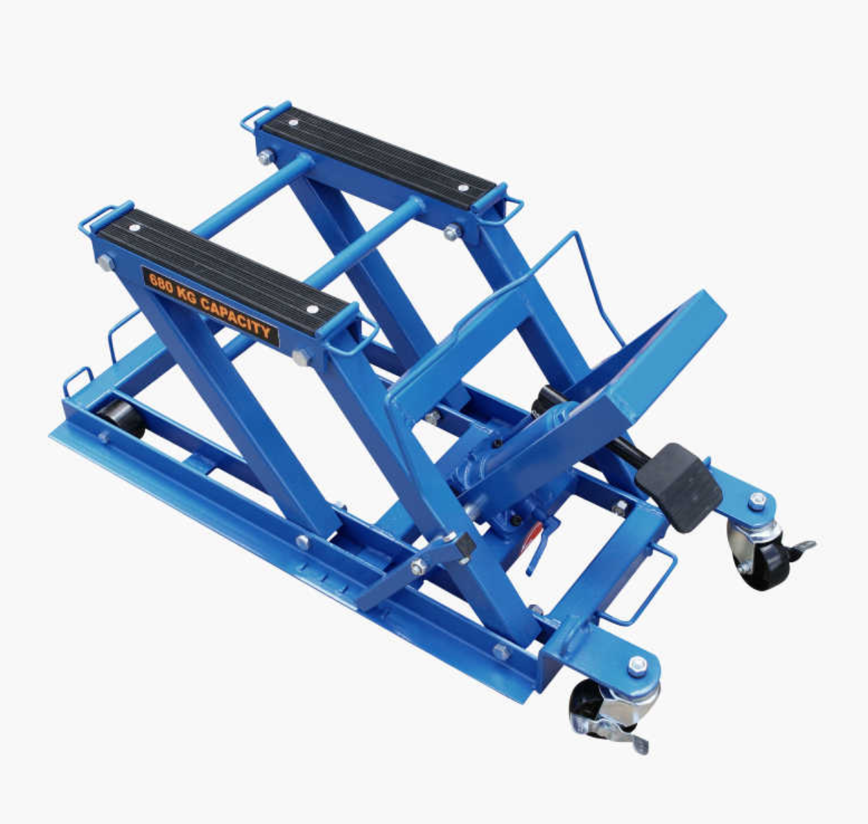

Picture 1 is the one I thinking most of, since it's probably the one where the scooter will be standing best on, also the most expensive.

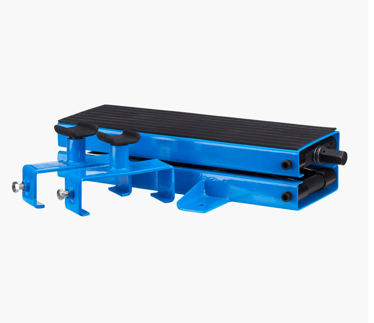

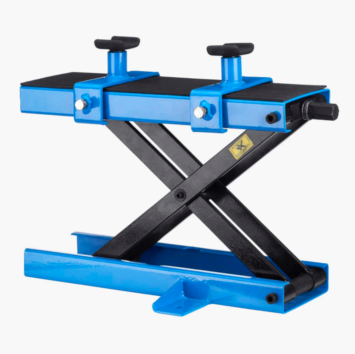

Picture 2 is half of the price of the other and I think it maybe make the scooter more wobbly when it's lifted up
Looks to be the one make the scooter most steady, it's also the most expensive one and take most place in my stall
Looks easier to store, not so steady, but cheaper. Can also be mounted to a 2" x 8" to make it more steady

I have the second. You can take those two things off the top. It's stable - very.

I know those on top can be demounted
Do you do anything else then just put it under and lift it up?

Depending on where I'm lifting for what purpose i also have to anchor the front down.
Keep in mind that two thirds of the weight of a Vespa is over the back wheel.
eg If lifting the front wheel then just stick it under the front of the floor.
If removing the engine then anchor the front wheel and lift at the rear of the floor where the swingarm is.

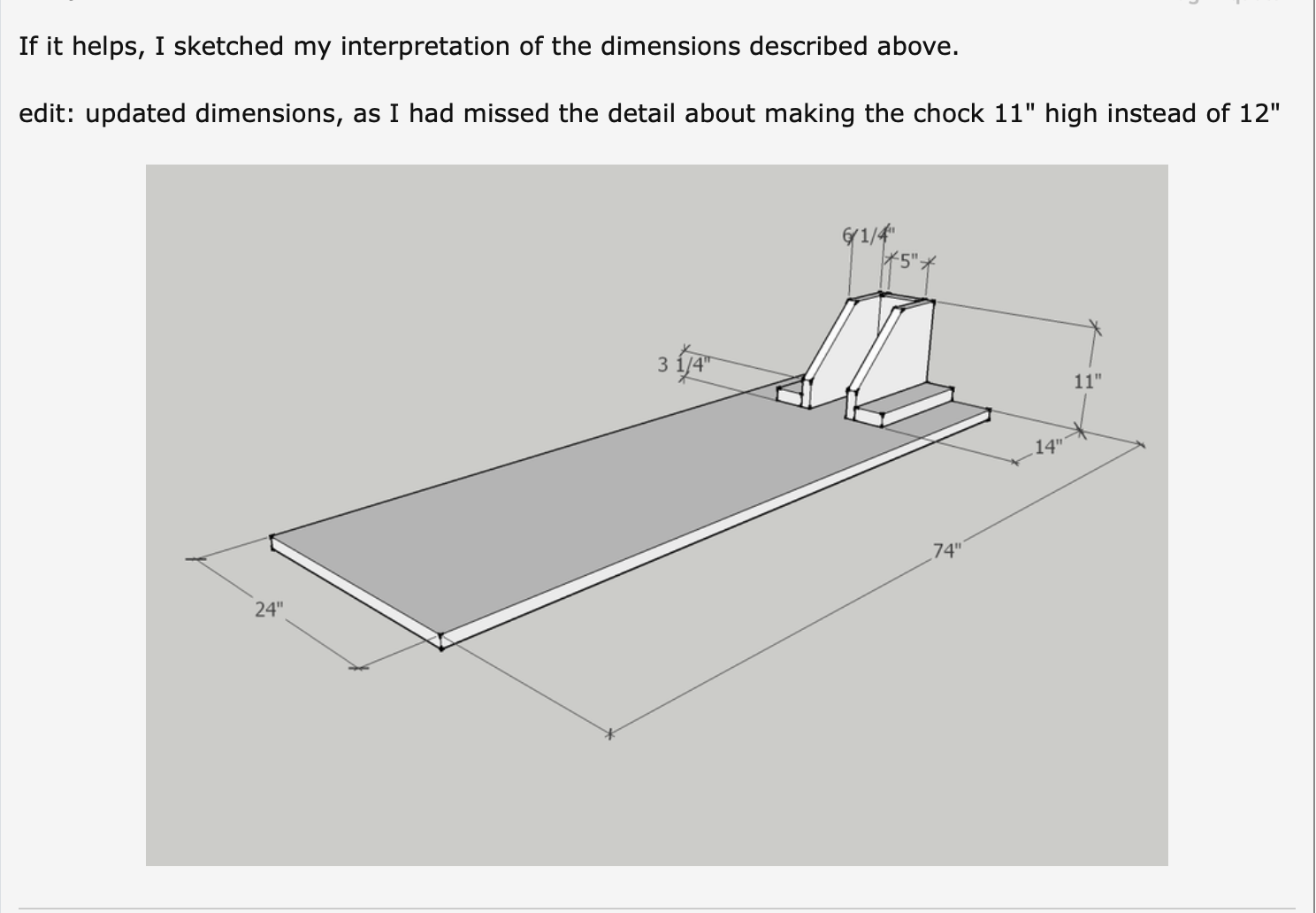

If I go for the second one I will probably make something like this to mountie to and to anchor front wheel to then it will be steady also
From this post: My DIY Knock-Down Work Stand

Probably better solution than using the first lift. With the first I'd be worried that even strapping the scoot to the lift before lifting that it would still tip backwards due to engine + cvt etc weight (unless disconnecting rear suspension ect first).

I have an orange version of the second one. It's even worked fine for my Bonneville, which is substantially heavier than the GTS. Both were perfectly stable on it. Granted I wasn't torquing things to 309 ft-lbs or anything but....worked fine for general maintenance.

I've had both of those lifts.
The top one is really for motorcycles. It works only OK for scooters but didn't lift up all that high, and takes up a lot of space in the garage when not used. It just wasn't worth it, and I sold it to a motorcycle owner.
The second one is at least as useful, if not more useful, for scooters and is far more efficient in the space that it takes up. I will say, though, that the one in your photo looks very narrow. The base of the one I have seems to be wider.

I have the second one.
Using it on my VROD because the 2 supports catch the frame first. Mine has holes on the base for the "safety pin" to avoid a failure.

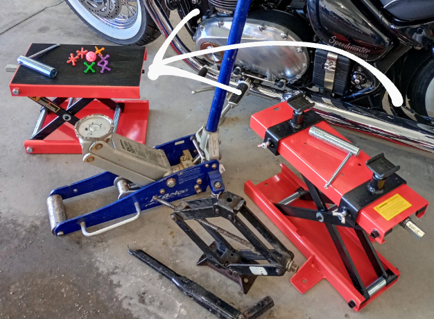

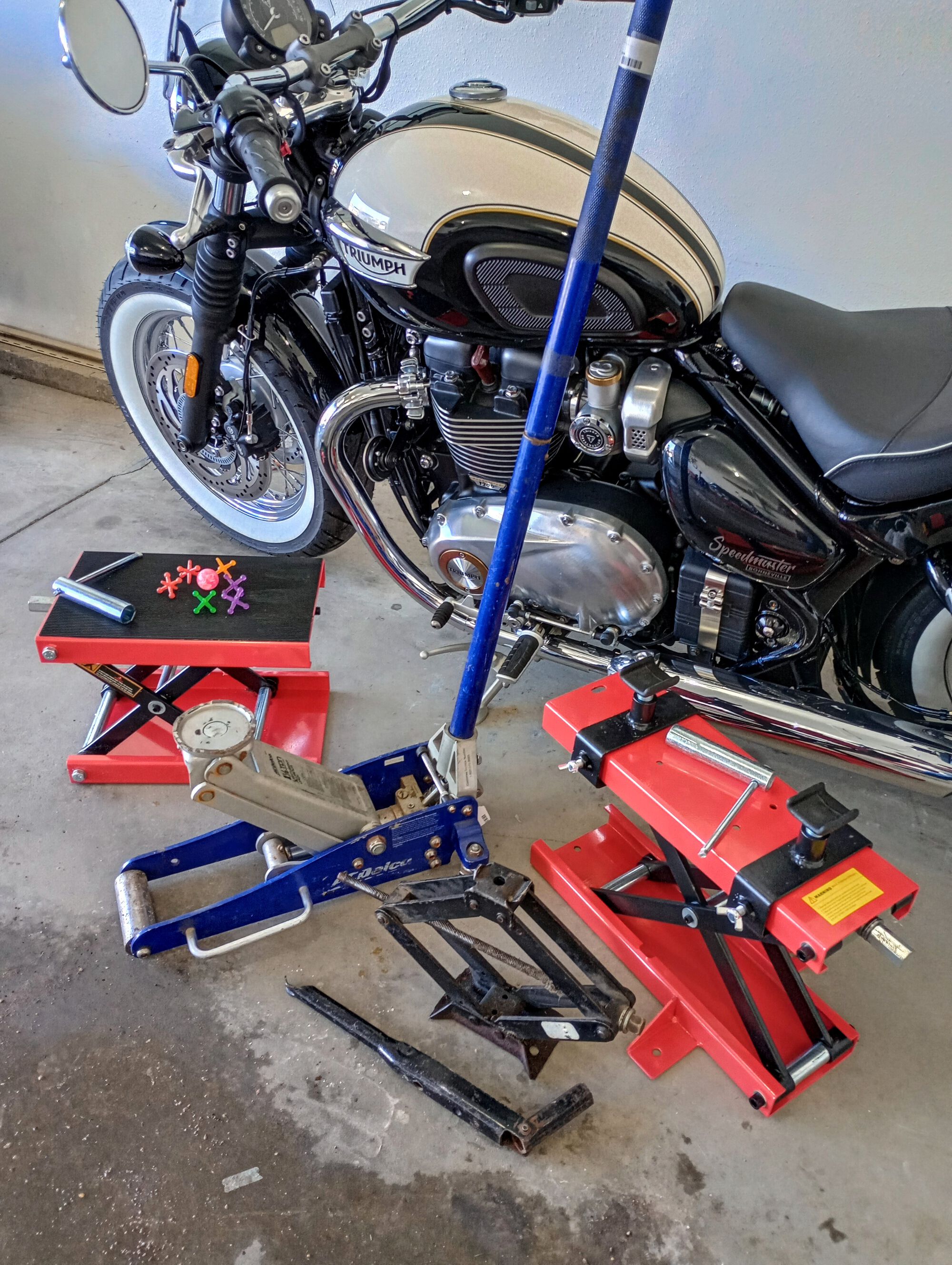

I have a plethora of vehicle lifting devices, including a well-used, decade old, Harbor Freight lift table.
Not adding anything particularly constructive to this topic....just wanted to appear boastful.

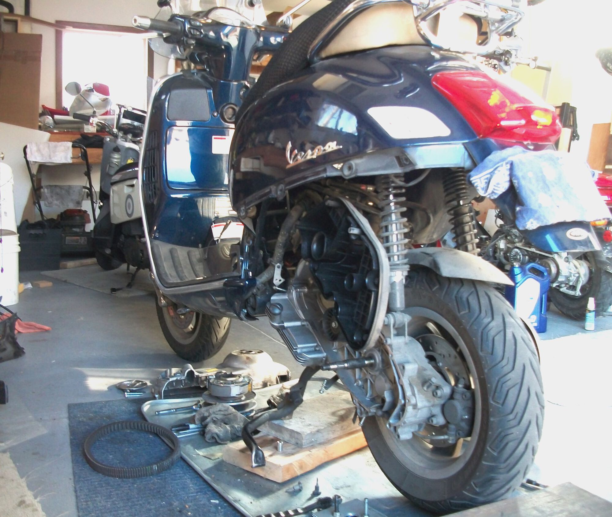

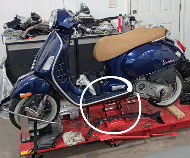

For this job, I used the scissors jack with the rubber-topped, broader platform to lift the rear end. I also secured the front wheel in the chock this time.
I don't remember why I didn't just have the scooter on its centerstand, but apparently needed more lift height than that would have provided, so the jack was used. This might have been when I was going to check the valve clearance and needed the engine/swingarm to pivot as far down as possible.

I dunno about the modern Vespa's but I have 2 oldies and had the first lift you posted. Doesn't work so well honestly. Like someone above mentioned it doesn't lift very high first off and secondly 2 parts the scoot sits on when lifting don't work with the exhaust and the support rails on the underside of the floorboards so when you use it the balance is way off as it's gotta be shifted way forward of the center point of the bike.
I'd have to lift the scoot and then grab the rear end and lift that up and put a bucket under it to hold it. Not ideal. Got a flatbed motorcycle lift and haven't looked back. But those take up way more space and are ridiculously heavy.
