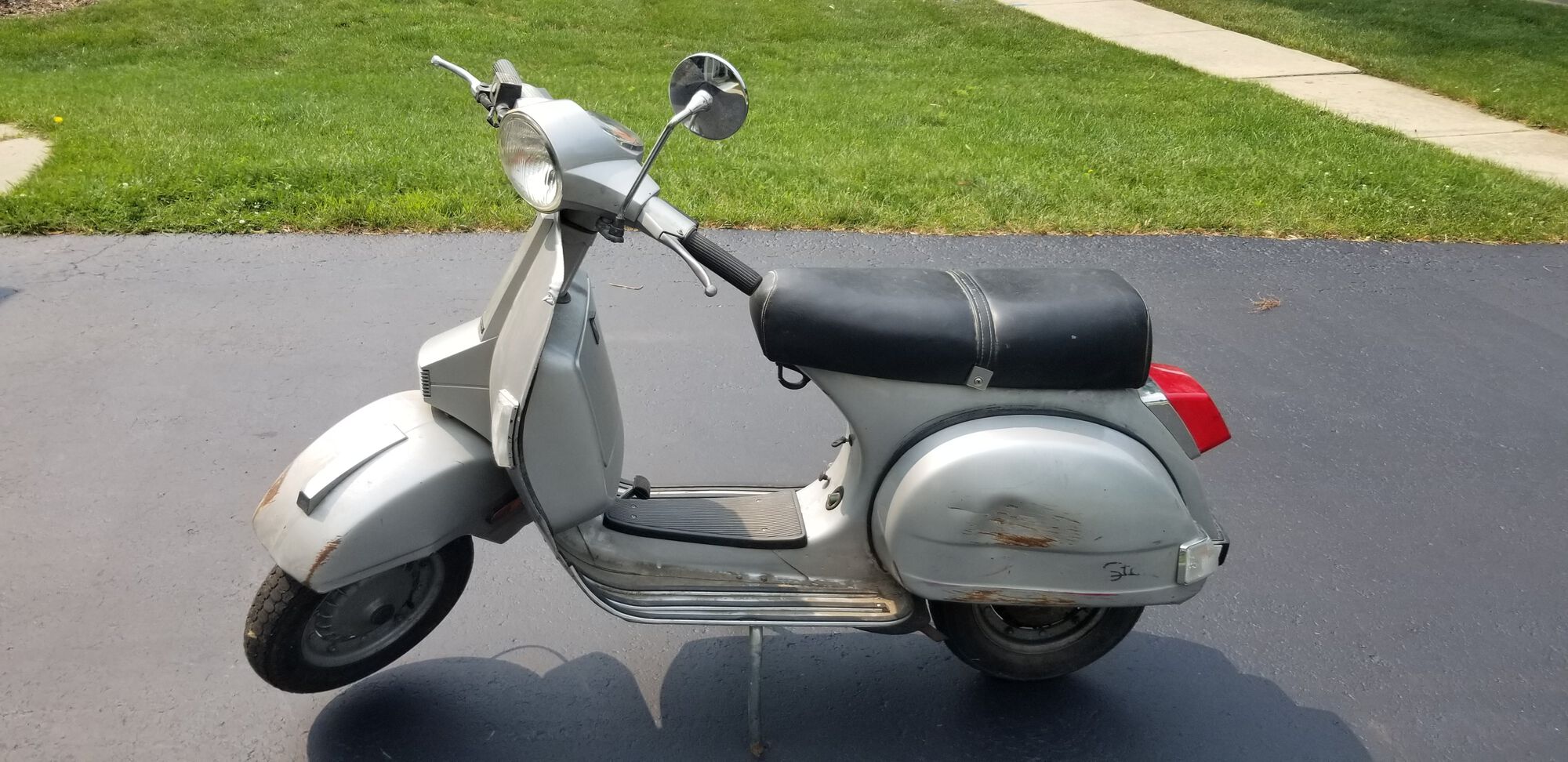

I picked up a 2005 Stella from a buddy that wanted it out of his garage. It was dropped several times, he lost the keys, title, etc. I was able to get a new title and installed a new lock set. I rebuilt the carb and got it running last summer but now it's time to make it look pretty.

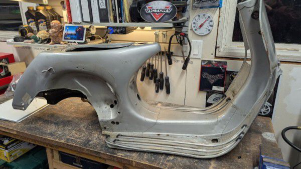

As expected, the scoot is a grease pit and 90% of the rubber is shot. I've broken down the entire scooter from engine to frame. I need to get the rails off the frame but that's about it. Everything is bagged and tagged. Currently, I'm inventorying what needs to be ordered for replacement but am going to reuse as much as I can.
My goal isn't to make the Stella look like new. I've been riding and working on motorcycles for years and just enjoy the process. I do plan on working out the road rash and eventually paint it once the weather here in NW Chicago warms up. I'll post updates as I go along.

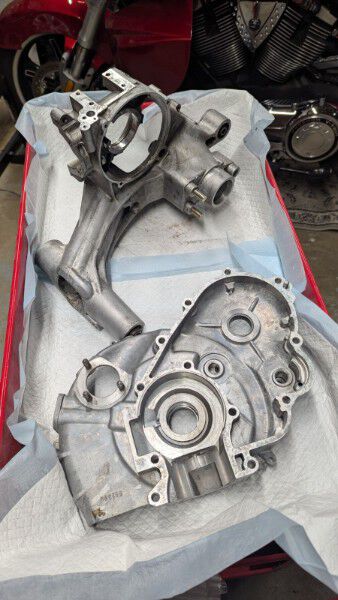

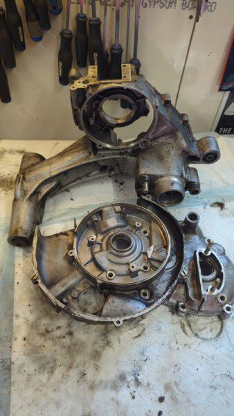

Had some time to wrap up cleaning the engine case. I've got a 15L ultrasonic cleaner so it took three rotations in the cleaner to get to most of each side of the case. The rest was done with brake clean.
Before and after.
