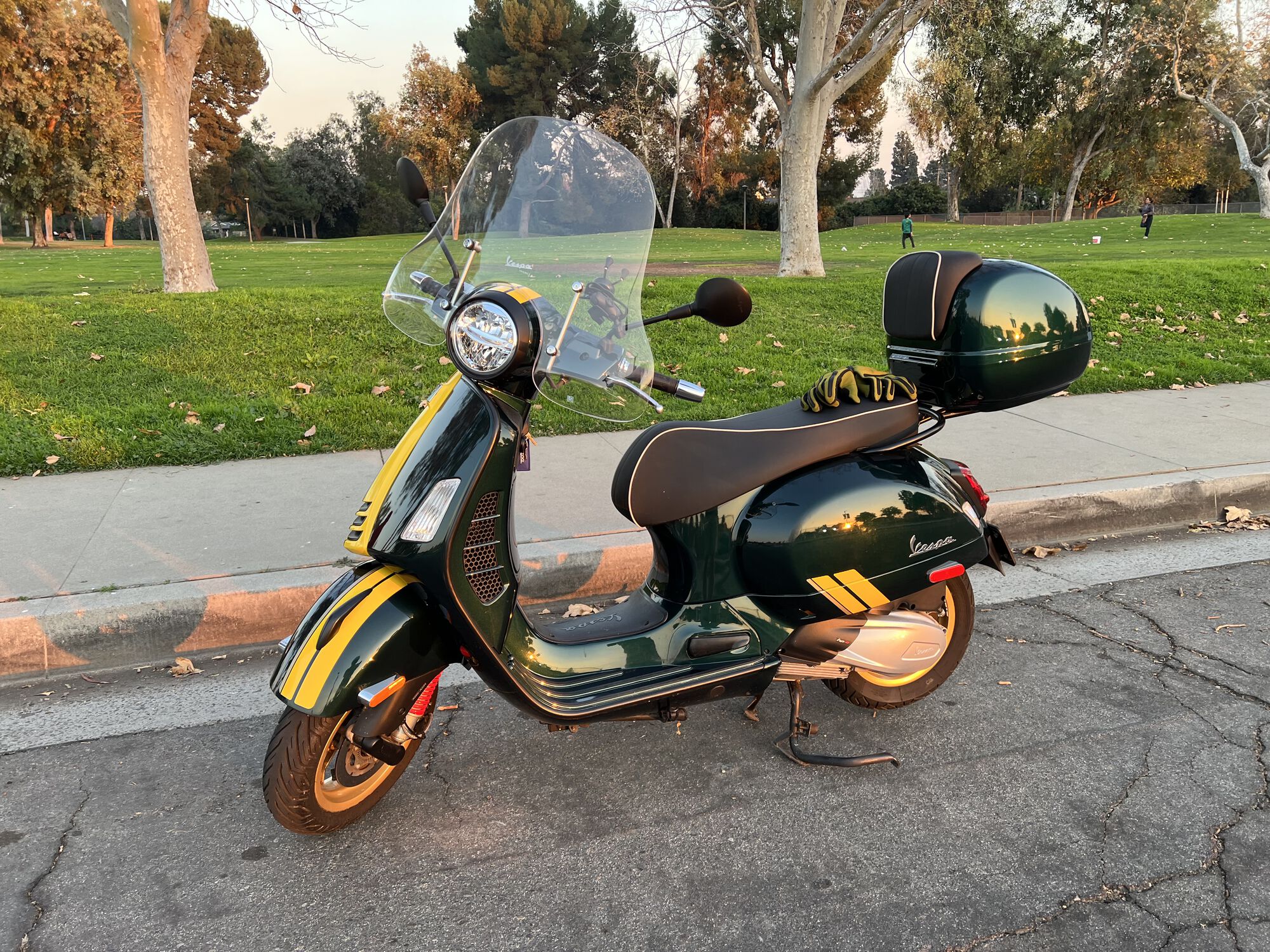

I was unable to ride for an extended period of time and my GTS sat covered for over 2 years. I would start it occasionally until the battery died. Got a new battery and it was pretty run down last week when I decided to try again. While I expected some difficulties the results were for the most part quite good.
It was pretty dirty even though covered. After an overnight recharge and battery check I drained the old gas and put in a fresh gallon along with a small amount of seafoam. At the moment of truth it fired right up and sounded like a sewing machine. Amazing!
I gave it a quick wash and checked the fluids. Oil was low so I added 200 ml and it came right to the top of the crosshatched level. Coolant was below the minimum mark so in with a bit of distilled water. Hub oil looked good. Tires were 6 psi each. Yikes!
After topping and washing and inflating and such I went for a ride. A bit wobbly at first but not bad. After a few miles the check engine light came on. I pushed it home from there because I didn't want to damage the engine. It was less than a mile so a bit of good exercise I would say.
Combing the forum and watching more Robot videos (Love that guy) I ordered an adapter for my OBD2 reader. P0130 - oxygen sensor. I still have fumbles putting gas in so perhaps some went in the evap? I reset the code and it hasn't returned.
I haven't hit 6k but plan to do some refreshing based on time. Plan is to install oil sight glass cover, update the fluids and air filter, maybe a few more things, and hope my riding gets back to normal with no more lengthy interruptions. Currently waiting on some parts and then it is on.
Hmm ...
coolant doesn't just disappear. Check all hose clamps are tight. And then keep a close eye on the level
