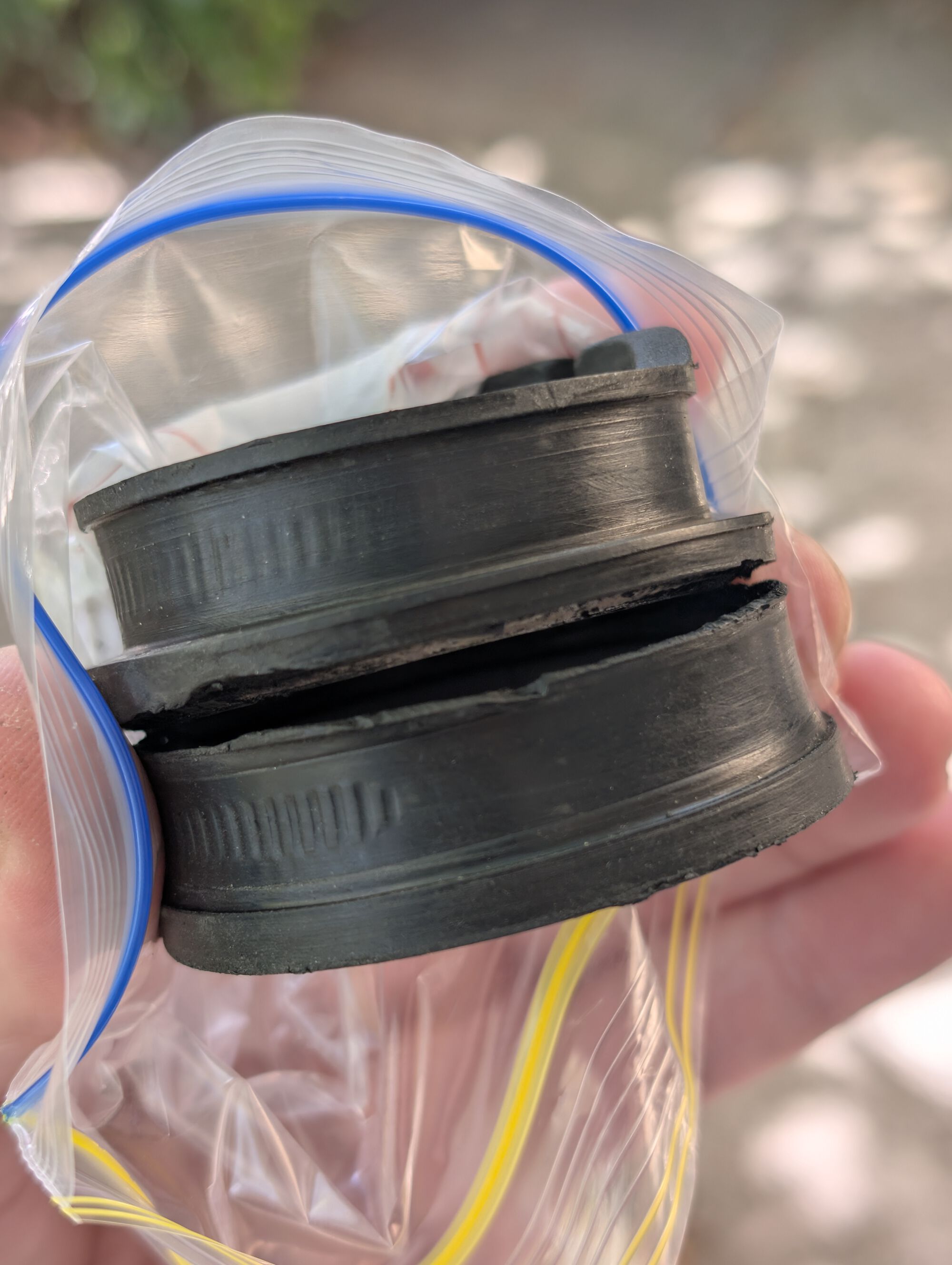

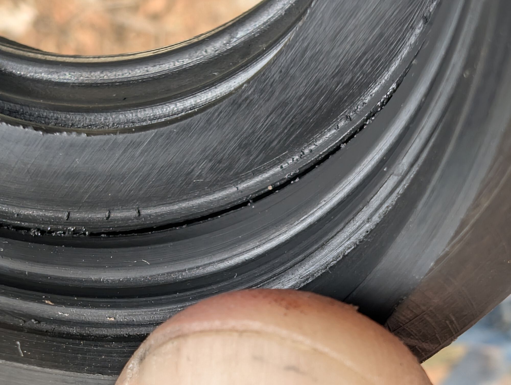

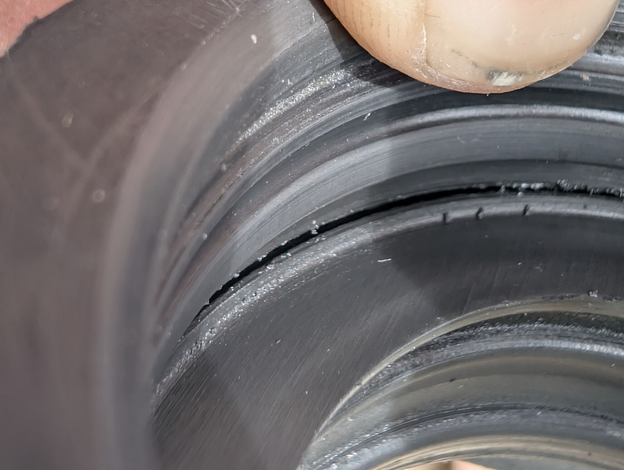

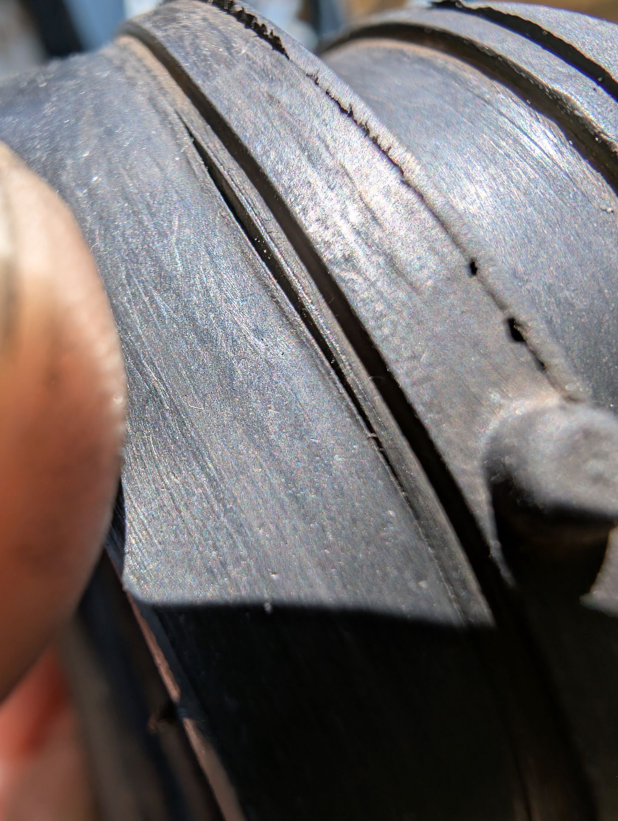

The very short hose from the throttle body to the intake manifold cracking. Not all the way through but this is only 13,000 km (*).
So how many potholes and rocks on 4wd tracks speed bumps and manhole covers etc before it cracks all the way through? Not many.
Replacement will be ordered this week.
(*) only 13kk? yeah, when I was replacing the head gasket a year ago, I saw that it was cracked all the way through so replaced it.
Good find! Clap emoticon
I guess you need to be especially proactive on the inspection and preventive maintenance, given the riding you do!

Didn't take long.
Idle went obstinately high and thew a P0130.
Checked that hose again.
Fuck.

quick fix with Silicone self fusing tape seems to be working for now ...

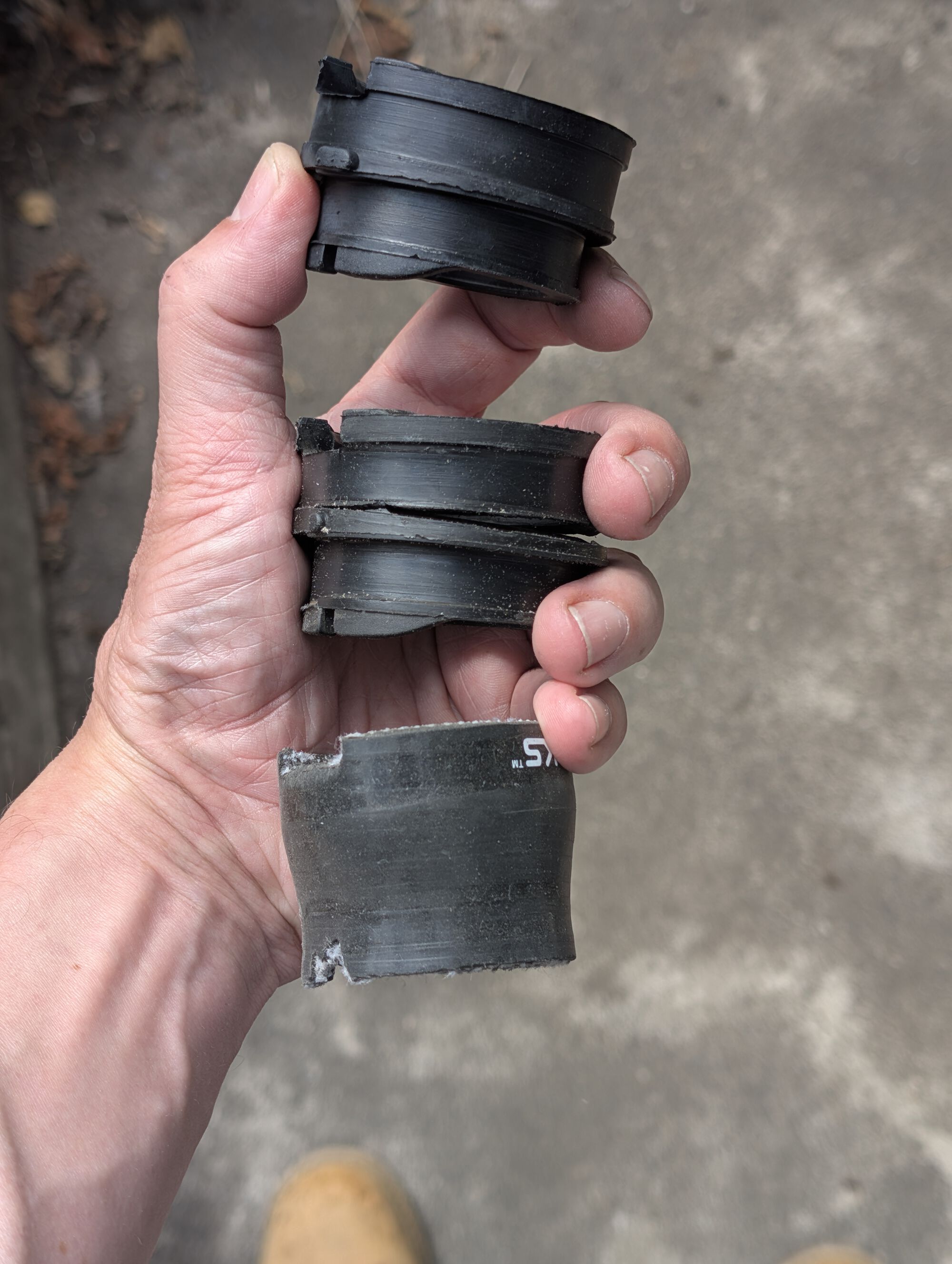

toast.

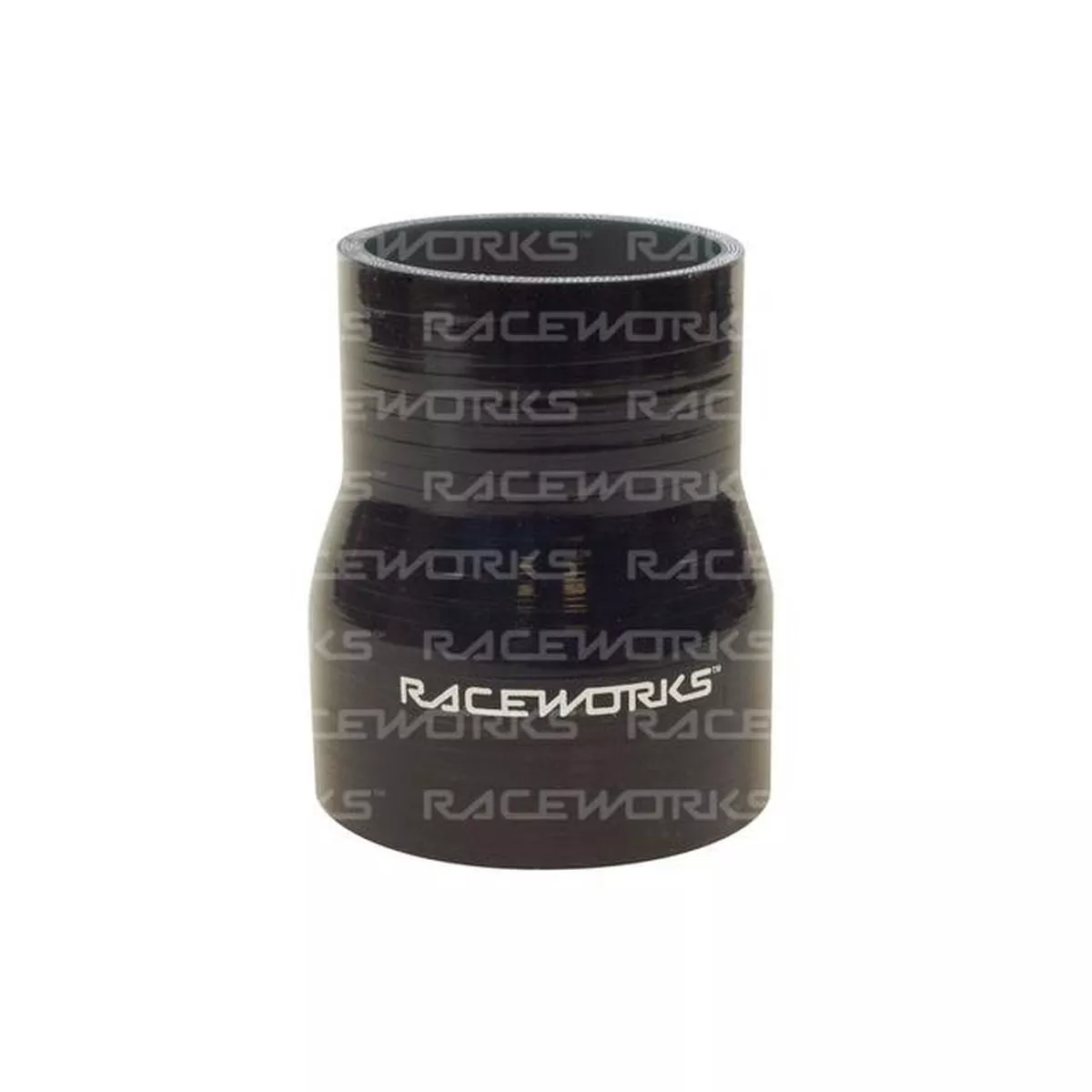

so have just ordered a silicon joiner that I think will be the right size once I trim about 2cm off each end.
probably will also walk over to the local vespa shop to see if they have one but I doubt it.
Update:
When I measured I thought 38-48 was about what I need. 38-44 and 38-51 seemed common so bought 38-44 as I hoped it would stretch whereas the 51 wouldn't squeeze enough with the clamp.
38 is perfect but the 44 doesn't fit.
have now ordered a 38-48 from overseas.

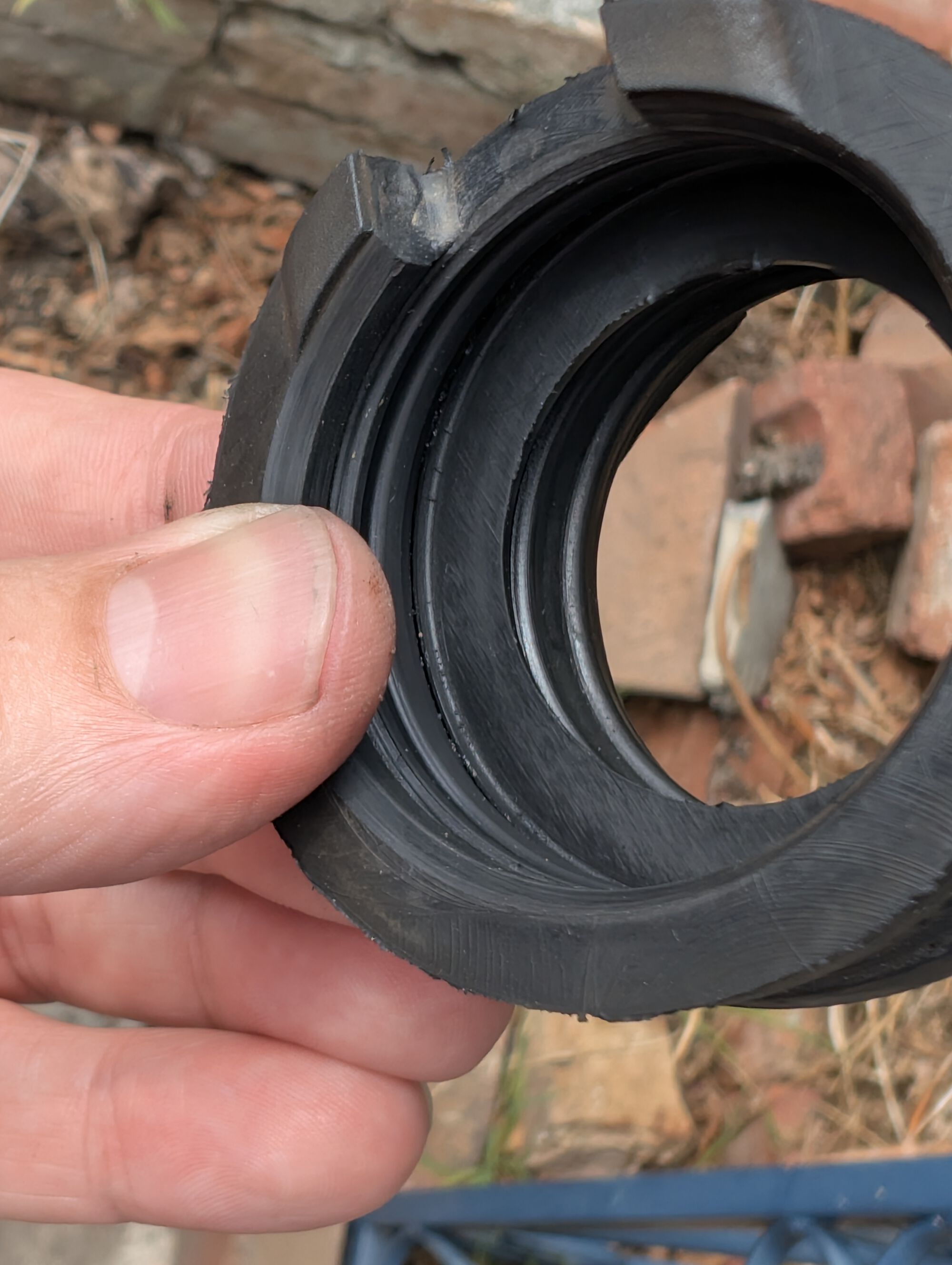

New.
Old.
Custom.
Posts: 8763
Posts: 8763
I've given up on the oem part. Broke another, I blame the road in https://www.instagram.com/reel/DVSzJ4ZkeV9/?igsh=b3R4bzB4dTExNm5s (see section with the 70kph sign).
Gone back to my custom silicone.
