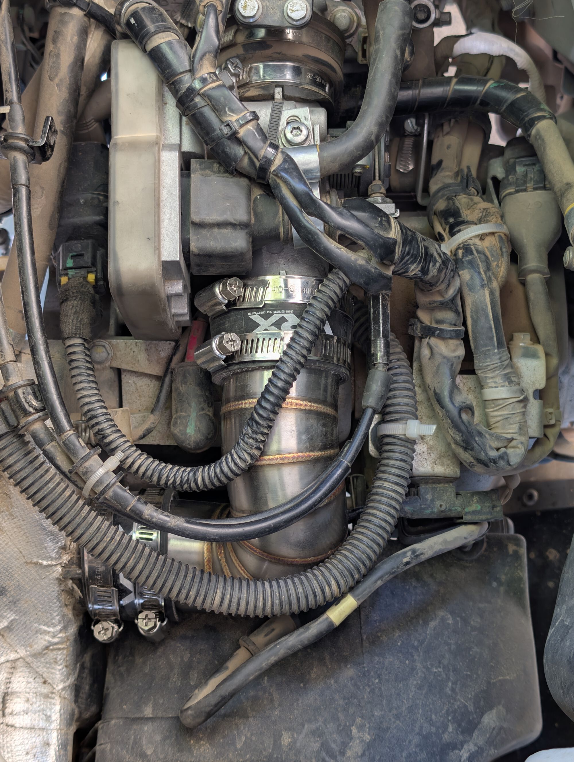

Purchased to remove bounciness of the throttle body cracking the short hose that connects to the manifold. This is the reason I installed it, not performance reasons. GTS intake hose cracking (throttle body -> manifold)
Way fatter than the skinny arse hose on my E3 HPE which has a different part number vs the E4 & E5. On mine the oem was about 32mm internal at the airbox end and gradually widens as it goes to the throttle body. This is 47mm. I don't know what sizes other GTS hoses are; take your own out and measure the inside and tell us.
I have an Arrow exhaust and will be installing the Malossi cylinder kit etc so extra breathing could be of benefit.
Where and how much? Cheap unless you buy from an expensive place (hint hint). Most places that have it call it a 'cold air intake'. It is not.
zipties installed in normal locations after the photo

Is the steel and welding of the same quality from ali as it is on the unit falan sells though?
I would bet yes, probably even from the same factory. Certainly looked fine to me. I'm not interested in paying three times the cost for a can of black paint, I'm think of doing a thermal wrap on it anyway
I think the raw metal looks badass the way it is. Way better than the black from Falan.
Why not the blue tinted one?
Do you expect the metal will bring more heat to the engine compartment, hence the wrap?
I did not buy it for bling
Opposite direction. The engine bay gets damn hot - stuff like the TB reaches around 60C. I don't want the bay to heat the pipe and that to then heat the air going through it. Cold air is better for oxygen density. I did also touch it after a bit of a ride and f it was hot

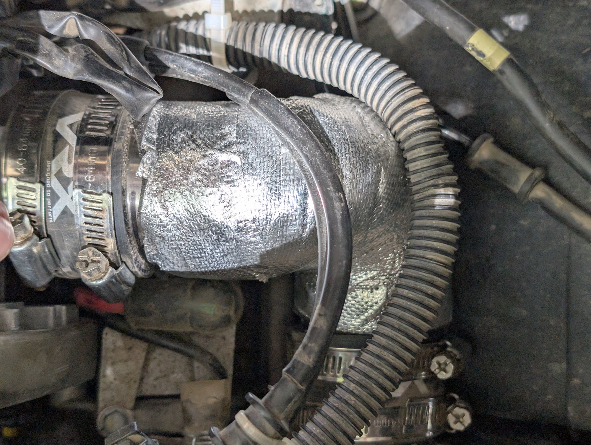

Wrapped it.
Layer of PU foam* tape 5mm then layer of silver tape.
* Think it's called 'closed cell'. It's the dense stuff

It seems to me that the air being sucked in is in the pipe for such a short time that it doesn't have a chance to warm up

SteelBytes wrote:
Wrapped it.
Why did you go metal again? To keep the rubbery bits from disintegrating into your engine?
Why did I order the same metal-y bits..? Oh yeah, the fun bling factor.
But now that it looks like HVAC ductwork.. which is basically what it's supposed to be.. not sure if I want to install it anymore. 🙃

When adding bling you always need to think about if there is a side effect (apart from cost). One which bugs me is why people replace plastic parts of trim with aluminium. Rizoma is especially bad for selling these and some from Zelioni etc.
Back to my story ...
When I took it for a proper spin the other day after stainless installed but not yet wrapped I saw that the air intake temp as reported by the ecu did warm up quicker and would sat higher. This is on the same roads and speeds.
How hot? It was sitting at 60C instead of the more normal low 50s for the same test.
Not ideal.
So wrapping is not without purpose. Haven't given this a test yet (apart from a trip to the shops).

Many hours of 110-120 kph and the intake temp sat around 52c.
good, seems the wrap is doing it's thing.
still need to do some long slow speed tests with a heat soaked bike eg turn of highway on to long stretch of gravel on a hot day.
Have you done the 'sitting in traffic' test?
Not enough sitting in traffic to judge. Filtering at the lights reduces this
