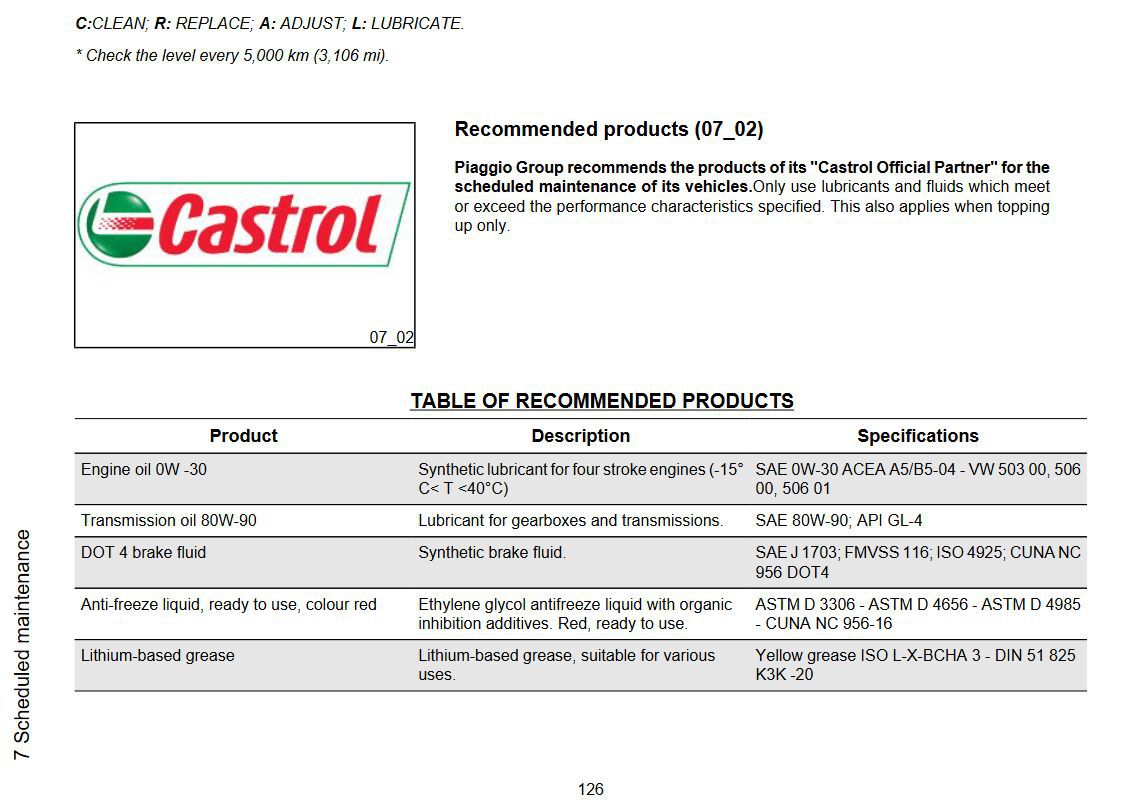

And what type of oil should i use for the engine? I couldn't find user manual online for 150 version

Same oil as the 125, it's basically the same engine. https://manuals.wotmeworry.org.uk/Piaggio/Medley/

You can download the operating instructions for your vehicle here:
https://manuals.piaggio.com/
Regularly checking the oil level and adhering to the inspection schedule should ensure that you can enjoy your vehicle for a long time.
