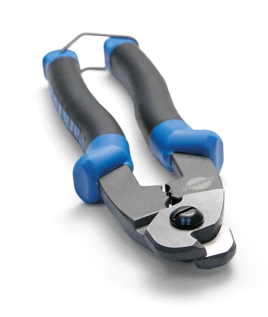

Get yourself a set of cable cutters. I like the ones below from Park tools. These will cut the cable cleanly, without smashing then snipping like when using dykes or electrical wire cutters. A small cutoff wheel in a dremel works well too.
For the ends, if the cables are standard steel, they can be soldered before cutting to prevent fraying. If stainless, I use the bicycle style crimp on caps. They can be easily removed if you need to pull the cable thru the housing.
https://www.parktool.com/en-us/product/professional-cable-and-housing-cutter-cn-10?gad_source=1&gbraid=0AAAAADPeZ3AtFirJupeepxP8MCTTILdML&gclid=CjwKCAiA74G9BhAEEiwA8kNfpTkO_4W5t3KpGdZX3q11T1ZWSsHh9A3LZF2L9RSc8QpZ7U7dErhTixoC70sQAvD_BwE
