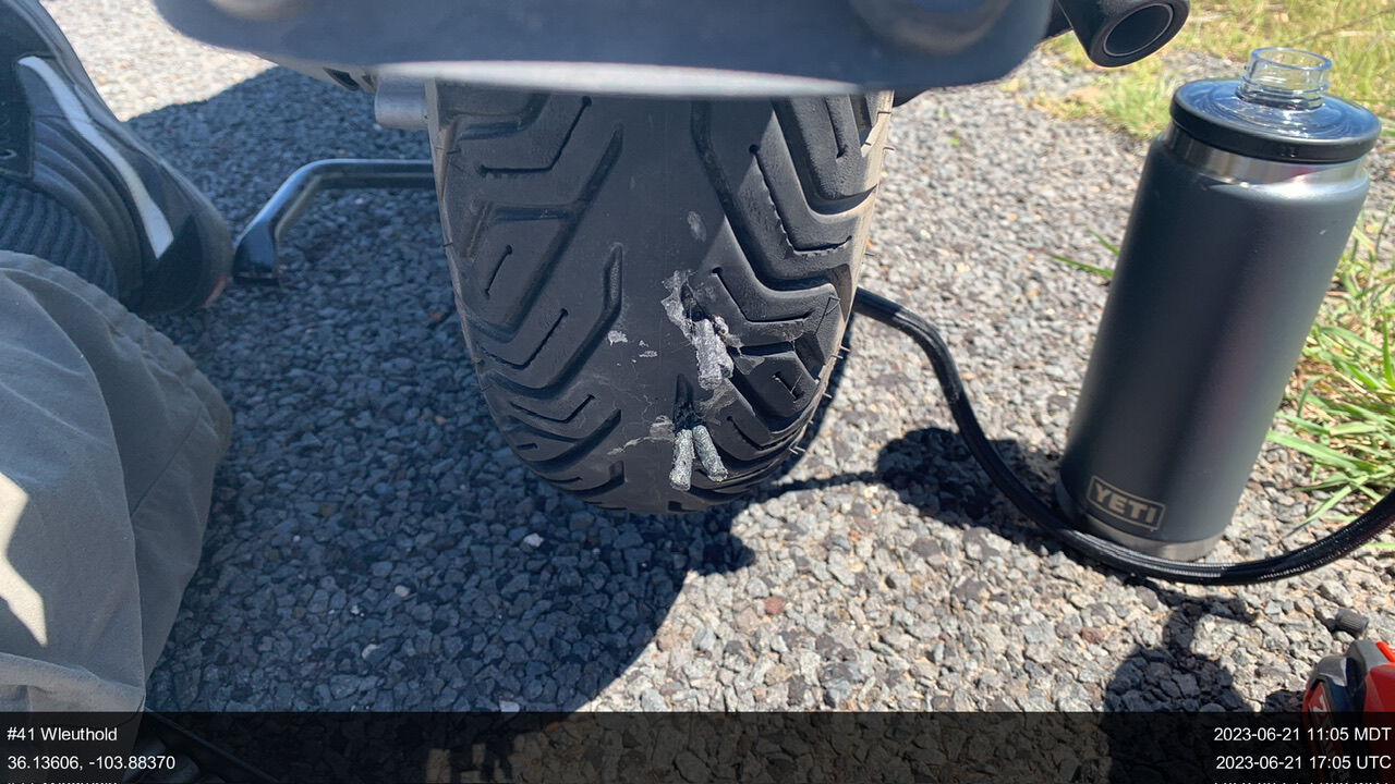

I have had several punctures while riding, always the rear tire.
I never carried anything to repair them for years, but started carrying a sticky string kit with a small self contained pump.
Before carrying any kit or pump, I found that the sidewalls of these tires were stiff enough that I rode several miles with zero tire pressure a few times.
But the scooter rides much better with the tires pumped up properly.
Bill
Flat tire in the middle of nowhere. Glad I had the kit.
